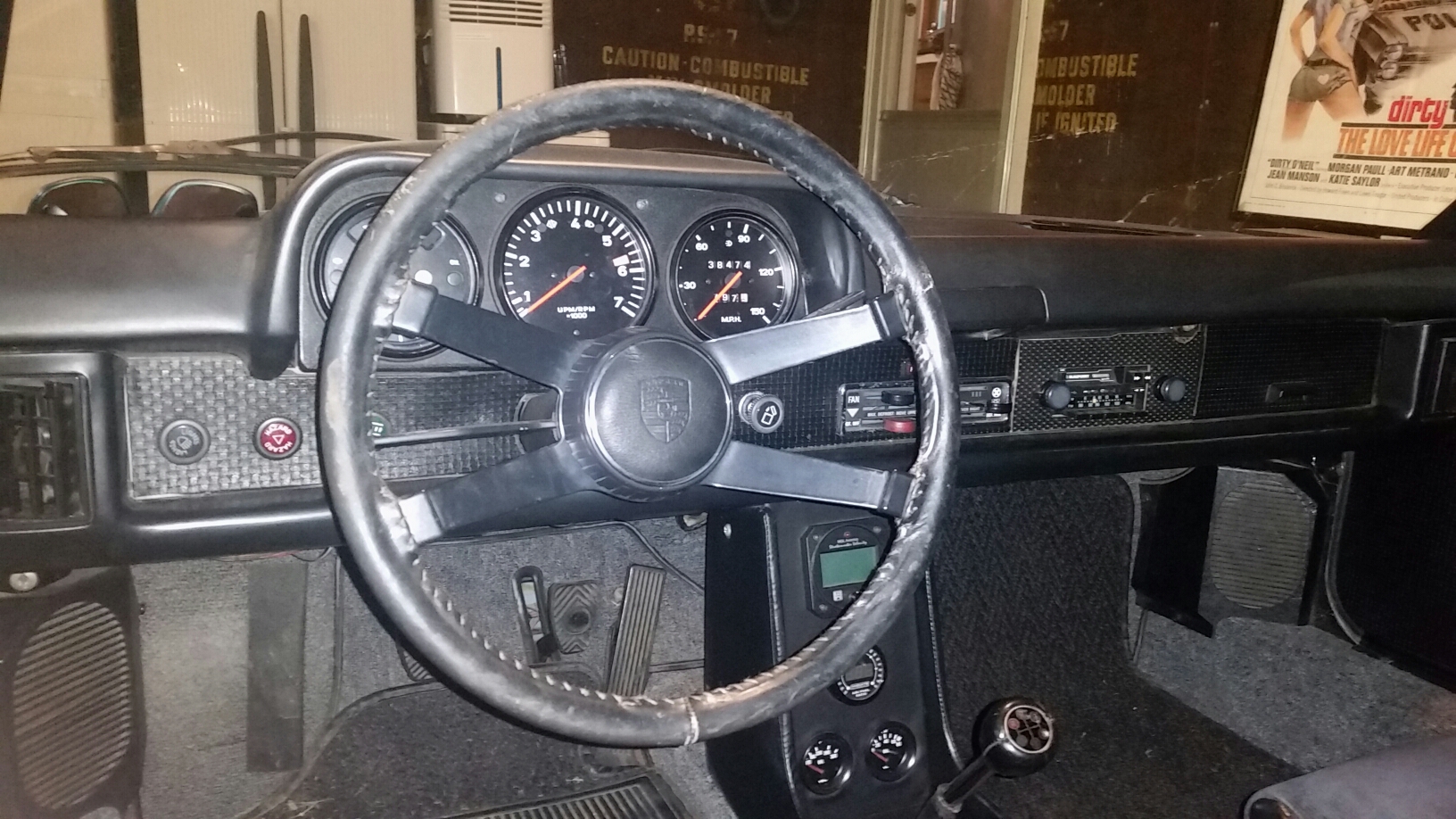

I'm running the MGL Avionics Stratomaster Velocity TC2.
Digital, 4 channels, you can see the temp of every cylinder.
User manual:
http://www.stratomaster.eu/lignes/mgl/pdf/Vel_EN_TC2.pdf
Might seem excessive to some, but it's been a massive aid in tuning and knowing that each cylinder is right on target. I also had an unexpected vac leak issue a couple months back, and looking at the gauge I knew immediately which cylinder had the problem.
Here it is in my center console...
