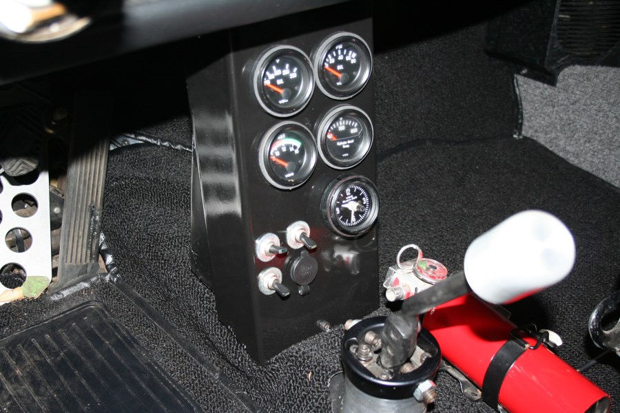

I went with a VDO CHT along with an oil pressure and temp gauge on my stock 2.0L rebuild a couple of years and 40K miles ago. Looked good under the dash. It was accurate in that my head temps were exactly what Len Hoffman and Jake said they would be with the 9550 cam kit and HAM rebuilt heads. I checked it with an IR temp gun from HF by pulling the plug wire and flashing it around the spark plug area. Hard to find an ideal spot to read from as you are shooting the gun pretty much blind and there are lots of angles to reflect off of, but all the readings were reasonable and none were higher than the VDO gauge.
