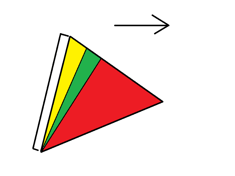

From my 31 pages of trans notes:
*Clutch cable
The clutch cable being too loose is probably one of the most common reasons that people’s shifting sucks. If your cable is too loose then you will not be able to fully disengage the pressure plate from the clutch disk and you will keep power to the transmission. If it is really loose then reverse will grind when shifting into it from a standstill. There is no way that this should happen if the clutch is fully disengaged. To properly adjust your clutch, you need to tighten the cable until the clutch disengages at about 1/4 to 1/3 pedal travel (See figure 1 in appendix). If the clutch disengages too early then it is too tight, too late then it is too loose.

I do everything the Doc has said but also look at the appropriate angle the arm travels along with how close it appears to becoming to engaging the clutch disk; I adjust the clutch to where it appears to just engaging the clutch disk, and back it off always checking with the pedal for appropriate movement and engagement/disengagement. I also added a spring return to make sure the throw-out bearing is disengaging from the clutch pressure plate.
Always test drive and adjust accordingly

QUOTE(Dr Evil @ Jun 13 2012, 11:47 AM) *
*Clutch cable
Hello Dr. Evil.....could you please explain the color graph in more detail? I usually set my cable adjuster to just touching the clutch arm under the car by the transmission.....trying not to hurt the TOB but getting a good disengagement......I really appreciate it. I know a lot of things really well but I trust you and the brain trust more on certain things....like my 914.....thank you very much.

QUOTE(second wind @ Jan 16 2019, 05:11 PM) *
*Clutch cable
gg
Kinda glad I'am not the only person that can't work out the colour graph ,presuming the green area is the sweet spot ??.
