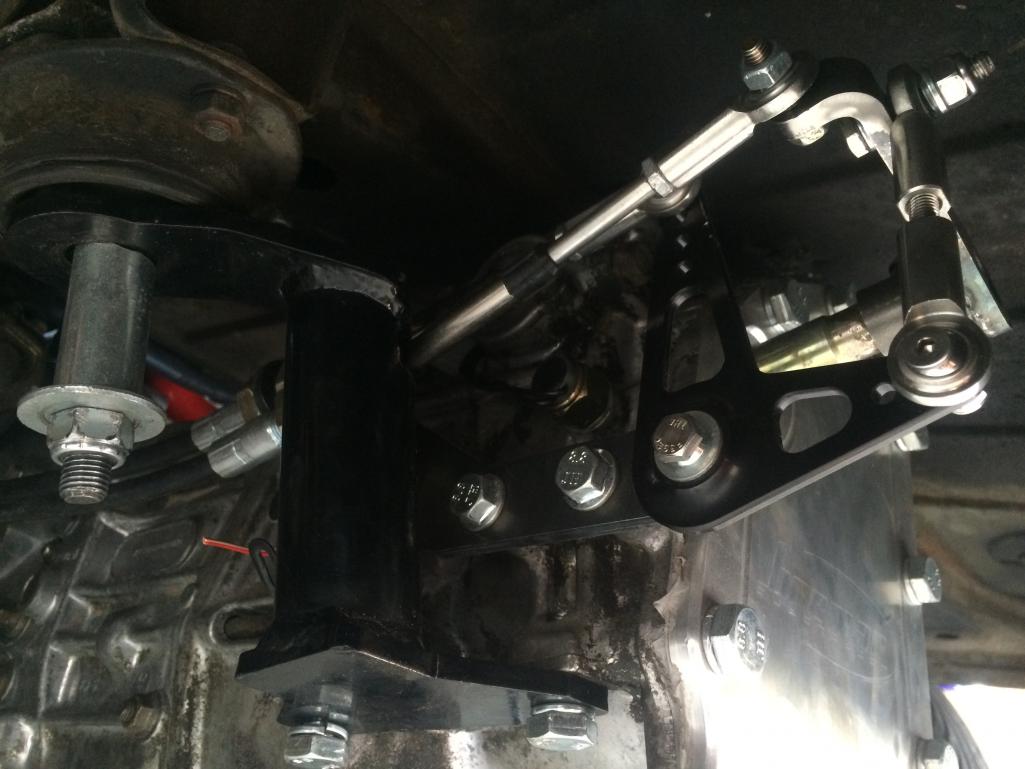

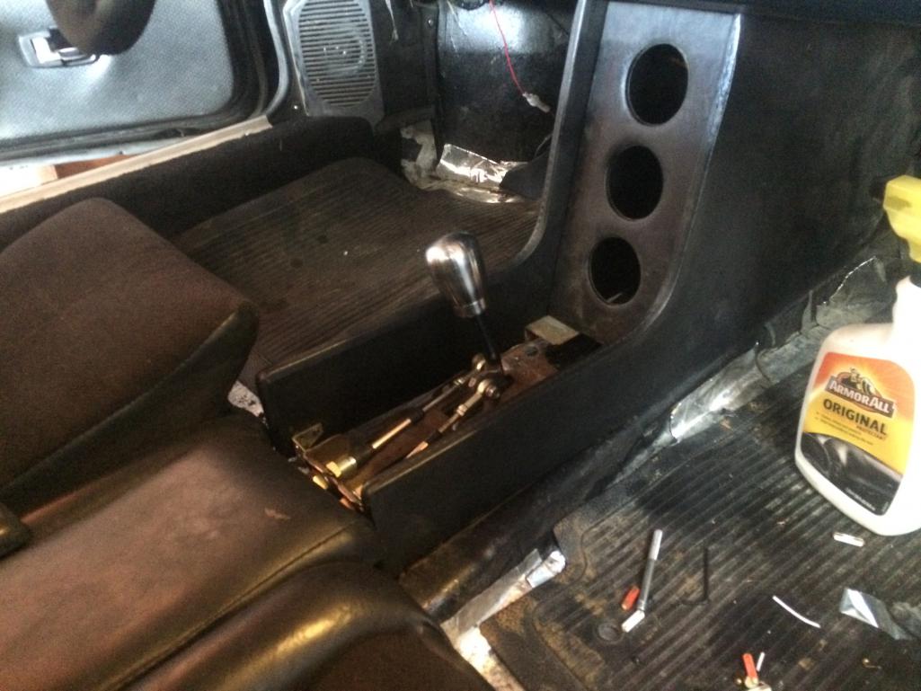

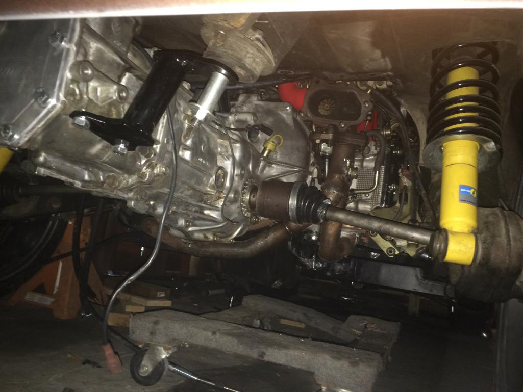

First off in the above picture i haven't cleaned up the hoses it will look way nicer. I have also completed ians cable shift install and man is it fun to bang through the gears of a stationary car!Attached Image Attached Image Another thing is i have installed the axels after having them resplined twice: a 150$ mistake But i will say this OFFICIALLY when using Subaru inner cv the axel is cut to 17 3/4" Attached Image

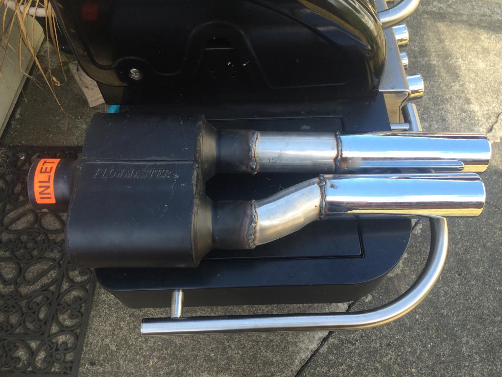

so ive finally got my special exhaust done and its friggin cool. 110$ at austins pro max in tacoma. However tradgity struck while i was towing it, the front oassenger wheel came off but the only damage done was to the inner rim and it tore 3/4 of the flare off (IMG:style_emoticons/default/dry.gif) nothing rivits couldnt fix though, all involved were ok! back to the good stuff though the exhaust is about 2.5' long, leaving me with the certainty my neighbors will hate me more than they already do considering my other car is a straight piped bug but oh well I await their 911 calls (IMG:style_emoticons/default/driving.gif)Attached Image

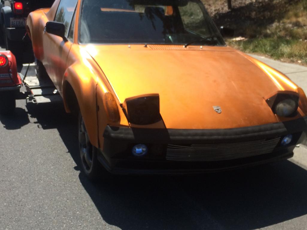

This was the damage from the wheel falling offAttached Image
