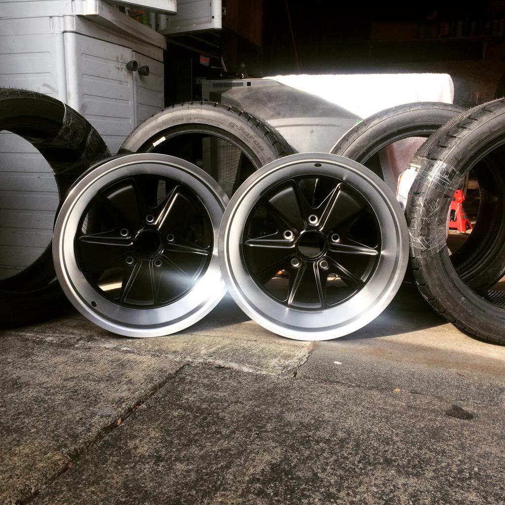

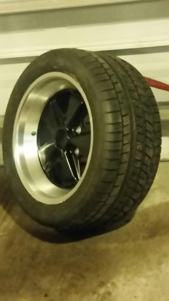

Im finally ditching the ill fitting revolution wheels and turning to the dark side! 17x8 fuchs front with bf goodrich sport comp 2/s 225/45/17s. The rear is getting a fatty 17x9 with 245/40/17s! Back from the dead!

From: Salt Lake City Ut
Member No.: 14,748
Euromeisters were too good of a deal to pass up, right?!

QUOTE(mgp4591 @ Feb 25 2017, 04:27 PM) *
No!......... yes..136$ per rim
