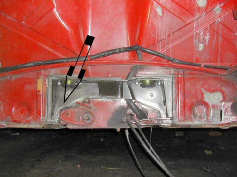

QUOTE(SirAndy @ Dec 3 2006, 11:06 AM) *
voila!
Hi ANdy,
is it a common practice not to use the screw holes for the engine mount? I am on the way to weld in my mount and i am not sure if i should use the screw or weld them like you did.
NIce work on your car Hope you can drive soon
(IMG:style_emoticons/default/smilie_flagge6.gif)

If you've got a welder, why bother making extra holes in the body. (IMG:style_emoticons/default/wink.gif) Set it on the lip, center it and ZAP!
Thats my thougt, but i have no expierience with the rj mount. The instructions says bolt and welding. So you think the welding is enough? It´s also a cleaner installation.

I got my six mount from Rich Johnson. It was never bolted, just welded. If there is a good welder, the bolts are not needed. Rich said the bolt in is just so you can drivethe car to someone who can weld the mount in for you. And I had the body shop do it while it was there. I even had them weld in the holes for the bolts in for extra strength.
I would have no problem putting a 3.6 on one of these mounts with just a good welding job holding it in.

Michelko, I was considering the same thing, plus I have lost the frickin' inventory list which details the lengths of the bolts to buy. So is it necessary to weld as much around the perimeter? I remember in RJ instructions only a couple of inches long in 2 places are req. ?

That makes sense!! Now i have a good feeling on not to use the screws.

QUOTE(thesey914 @ Mar 31 2007, 07:38 AM) *
probably overkill, but while you're in there and the welder is still hot, why not.
it's only $0.27 in gas and wire ...

Thanks michelko, I'm going to bolt + weld. I'd just like to have belt & braces + my welder is only 130amp and would struggle at anything above 3mm. I reckon by 'dipping' into the bulkhead + the steel plate I could weld it very solidly -just would have this nagging doubt.

Another thing I noticed was you also have had to grind a bit off the mount to clear the firewall shift linkage flange, have the tail shift cars had to do this?
nope, my mount was already notched in that area to make it fit early cars, didn't have to grind anything ...

To repeat what Andy said, that mount is universal and doesn't require griding. Drop it in place and weld it.

Maybe I have an early version -I had to grind mine. Not a big deal, but something that could do with amending
