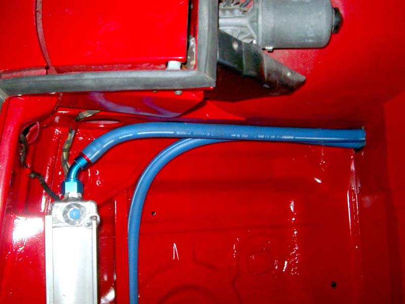

moah pix!
it's amazing what a bit of touchup paint can do for the looks of things!
front trunk all straight, welded, cleaned, primered and painted with rattle can guards red ...
from the front:
oil cooler installed permanently and oil-lines attached:

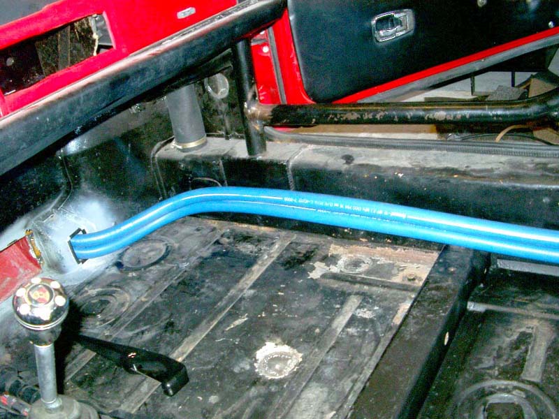

routing the lines inside the cabin to the rear firewall with the thermostat in the box:
(IMG:style_emoticons/default/stirthepot.gif) Andy

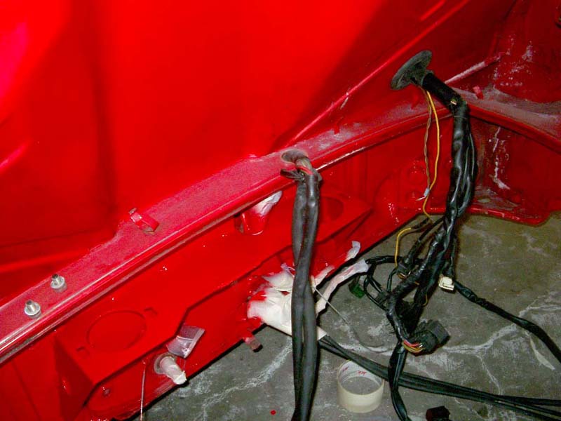

3.6L FI-Brain mounted under the dash and cutout for the door for the 993 fuelpump location:
(IMG:style_emoticons/default/rocking nana.gif) Andy

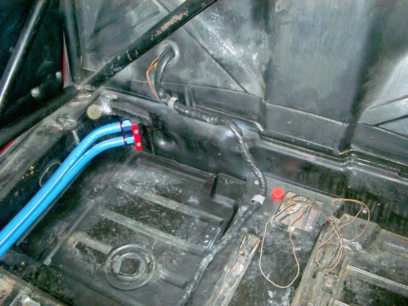

993 brain/engine harness routing. we welded in metal tabs to hold down the harness ...
(IMG:style_emoticons/default/chowtime.gif) Andy

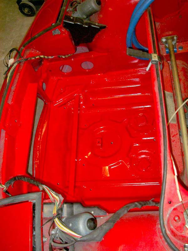

post Apr 26 2007, 09:45 PM
Post #186
Resident German
Posts: 42,473
Joined: 21-January 03
From: Oakland, Kalifornia
Member No.: 179
and a view from the engine bay side of things. engine bay was primered and painted with rattle can guards red touchup paint.
you can see the 993 harness coming through the firewall as well as the two oil-line outlets (blocked off with red caps) on the thermostat box.
(IMG:style_emoticons/default/piratenanner.gif) Andy

What type of oil lines are you using? Are those -16's or -12's fittings?
QUOTE(SirAndy @ Apr 26 2007, 10:43 PM) *
post Apr 26 2007, 09:57 PM
Post #188
Resident German
Posts: 42,473
Member No.: 179
QUOTE(mikelsr @ Apr 26 2007, 07:50 PM) *
-12
(IMG:style_emoticons/default/bye1.gif) Andy

QUOTE(SirAndy @ Apr 26 2007, 08:40 PM) *
Eggs-cellent oil line routing. Fry the passenger, not the driver!
And much better than the awkward, toasty GT/916 oil-lines-as-dead-pedal setup. (IMG:style_emoticons/default/clap56.gif)
Curious on the blue rubber AN lines, though. Never seen em. Cheaper than braided? Easier to work with? Gee, I supposed factory oil lines are rubber and last a little while... (IMG:style_emoticons/default/idea.gif)

QUOTE(mikelsr @ Apr 26 2007, 07:58 PM) *
And the lines themselves?
OD is 1", not sure about the ID ...
i just happen to dislike the stainless steel braided stuff, so i went with the plain lines instead ...
(IMG:style_emoticons/default/beerchug.gif) Andy
post Apr 26 2007, 10:19 PM
Post #192
Resident German
Posts: 42,473
Member No.: 179
QUOTE(horizontally-opposed @ Apr 26 2007, 08:13 PM) *
yes, blue rubber lines are cheaper and easier to work with. a bit more flexible too. and i happen to hate them braided lines, so ...
as for the routing, i'm planning on making a aluminum cover plate for the cabin to go over the hoses and i'll put some insulation behind the cover as well.
that should do the trick.
plus, i don't plan on being a passanger in my car too often ...
(IMG:style_emoticons/default/biggrin.gif) Andy

for those interested, here's a PDF with info on the oil-hose system used ...
http://www.914world.com/uploads/4281_b1.pdf (800k)
the blue hose is their "836 Hi-Temp, Heat-Resistant Hose"
operating range: up to 250 psi, 300 deg. F
burst pressure: 1000 psi
that should be plenty good ...
