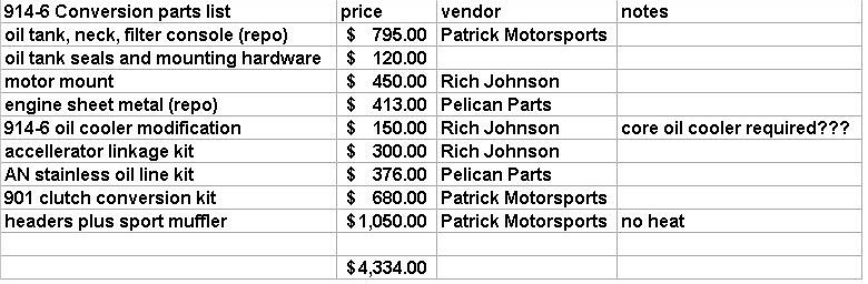

I compiled the following list of conversion parts. This is just to put a six cylinder engine in the car and doesn't include a 5 lug conversion or suspension mods. So for you guys that throw out low total conversion prices please tell us how you did it and how you cut costs. Often I see references to exceptional deals on engines that can't be easily reproduced or incomplete parts lists that don't include all the parts or headers/exhaust.

I think people thow out numbers for bargain sale used Items...
but that not really fair since those kind of things are not readily available or even at all available sometimes.
Also, when compairing used, or very used parts it seams to me that a lot of times these $ figures are thrown out in comparison to new type 4 parts... I never see anyone quoting the t4 used jake motors when they quote used -6 motors or -6 parts.. (just an observation)

Brant, what is the shift linkage mod? I forgot about the tach. What are the costs on those two items?
Trekkor, do you have a spreadsheet of your costs? Other than super deals, can you comment on the list I posted and how you cut the costs?
In one of the other topics Grant threw out some numbers but he appeared to be missing half the parts needed. I asked about it but he didn't respond. Hopefully he will.

I will list prices without tax and shipping. Pulled my actual invoices rather than doing this from memory (I have a shipping sponsor so all my big frieght is free)
Used (35,000 miles) but strong running 2.4 911 E engine with triple webers, 914-6 oil tank, filler, complete 914-6 engine tin set, 912 engine mount bar (sold for $50) $2375 (total cost minus sold part $2325)
MSDS Headers with 914club 20% discount $432 (IMG:http://www.914world.com/bbs2/html/emoticons/clap56.gif)
Used Muffler. $250
Clutch conversion Kennedy Engineered Products Est. $500
I'm still shopping for the other items on your list and hope I will come under the prices you have quoted.
I was patient and shopped for nearly a year until I found my engine and conversion part deals. I lost plenty of ebay auctions and didnt get to classifieds in time for lots of 6 conversion part deals, but I was persistant and feel I'm making a budget 6 conversion a reality. Froogle.com is my freind too.
I remember when Trekkor was doing his budget 6 that some, includling myself, believed his situation was unusual and it wasnt realistic to do a 6 conversion for such low costs. Now I think I'm on track to make another budget conversion at similar cost.
However I may be unique as I'm all about function and budget rather than making a pretty car that wins popularity contests. My conversion 914-6 will be mechnically sound and well balanced track and AX car.

. but your failing to count your tools, skills, labor and time at that price estimate. Its really just cost shifting and bad accounting.
I don't agree. For me, this is a hobby, and the cost of this "project" is simply the expendatures incurred for this and only this "project".
Tools would be the cost of the "hobby".
Time is not included in "hobbies" as they are things done for fun. It is supposed to be something that you can spend time on and not worry about how long it takes to get there. FUN/Enjoyment is what hobbies are about.
Otherwise it becomes a business.

I think that LOTS of deals can be had
LOTS of pieces can be self fabricated.
but Not everyone is going to be able to score a 4K conversion...
Agreed. I see your point.
I just wish the topic starter would help clarify what they were intending to find out here.
A list of parts was posted with what I consider to be high prices for stuff that I can fabricate or source elsewhere. This list was missing one minor component (THE ENGINE).
My post went through all the items I paid for as well as those that I made myself in my shop (or at work). Being a mechanical engineer helps me to design stuff I need and allows me to work closely with fabricators who help me out (by TIG welding for free, etc.).
My conversion (less engine) is fairly inexpensive compared to the list originally provided, but each piece that I make is at least of equal quality to that on the list, and the prices on the list are more or less fair prices. I won't sell my engine sheet metal for less than $350/set because it takes me a whole weekend to fabricate. Sure it's about $10.00 material. I would rather do my hobby than someone elses.
I know others on the site that can fab thier own parts cheaper than they can buy them and others can get these screamin deals that the rest of us can only wish we could get.
I just don't know who comes up with the budget prices in the first place. Mine are actual costs.
brant
post Feb 23 2006, 12:38 PM
Posts: 12,179
From: Colorado
Member No.: 47
Grant,
you spent your time...
not everyone has time to surf the internet or look for that length of time...
agree'd there are Way more used -6's out there.
but my point was that people keep comparing used to new, and those numbers are apples to oranges.
I put a NEW motor in my conversion. Thats Apples to Apples but I didn't get it for $1500 bucks.
all of the 3-4K motors with 90 day warranties are exactly what I'm saying... 4K for motor 4K for parts = 8K
(for the AVERAGE guy...minus 1-2 thousand if they do there own fabrication and search for deals.)
I don't disagree that its possible.
I think your car will be awesome.
I think Trekkor's car is awesome.
I think that its misleading to tell every newbie with less skills, less experience, and less knowledge that 4k total is the norm.
brant
Kerrys914
post Feb 23 2006, 12:41 PM
Dear, the parts I just sold paid for that part ;)
Posts: 1,568
Joined: 26-December 02
From: Williamsburg, VA
Member No.: 16
If things go well you can reproduce close to Trekkor's conversion. My budget conversion was hit by alot of BAD luck...This = $$$$$
Broken exhaust stud = Topend rebuild and re-ringed ($700+/-)
Bad ignition system = wasted $200+/-
Carb parts to get engine tuned = $200 +/-
Good deal on engine mount tuning out to be a bad deal wasted $150+/-
New tools because you need new tools = $200 +/-
Any $$ to by the new items all these DAM 914 parts inventors keep making (IMG:http://www.914world.com/bbs2/html/emoticons/biggrin.gif)
I think I ran about $2000 over budget. I would say plan on $6000 and hope for less (IMG:http://www.914world.com/bbs2/html/emoticons/wink.gif)
(IMG:http://www.914world.com/bbs2/html/emoticons/smash.gif) (IMG:http://www.914world.com/bbs2/html/emoticons/smash.gif) (IMG:http://www.914world.com/bbs2/html/emoticons/smash.gif) (IMG:http://www.914world.com/bbs2/html/emoticons/welder.gif) (IMG:http://www.914world.com/bbs2/html/emoticons/welder.gif) (IMG:http://www.914world.com/bbs2/html/emoticons/welder.gif) (IMG:http://www.914world.com/bbs2/html/emoticons/sawzall-smiley.gif) (IMG:http://www.914world.com/bbs2/html/emoticons/sawzall-smiley.gif) (IMG:http://www.914world.com/bbs2/html/emoticons/sawzall-smiley.gif)
