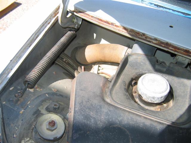

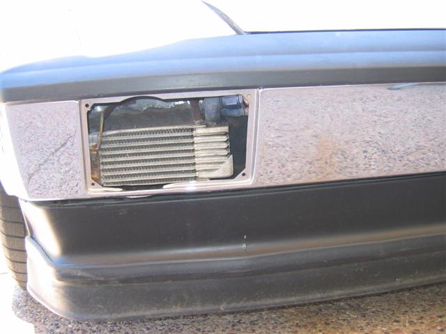

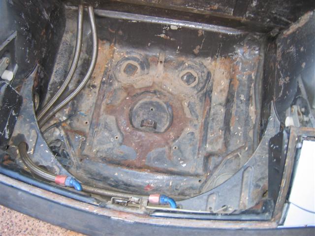

I've have this set-up on my 3.0. The car was my daily driver. Never runs hot.
Fog light/horn grills mount over the coolers. Plumbing's not purdy...but it works. Vents out through the wheel wells.

(IMG:style_emoticons/default/idea.gif) interesting...what's the inside of the front trunk look like? And where to the lines run to get to the engine? Where did your horns go?
Horns??? One is bolted to the interior of the trunk, the other currently is not (note that the front panel of this car has been replaced with a '73+). Lines run under the right rocker panel (jack piont needed slight modification).

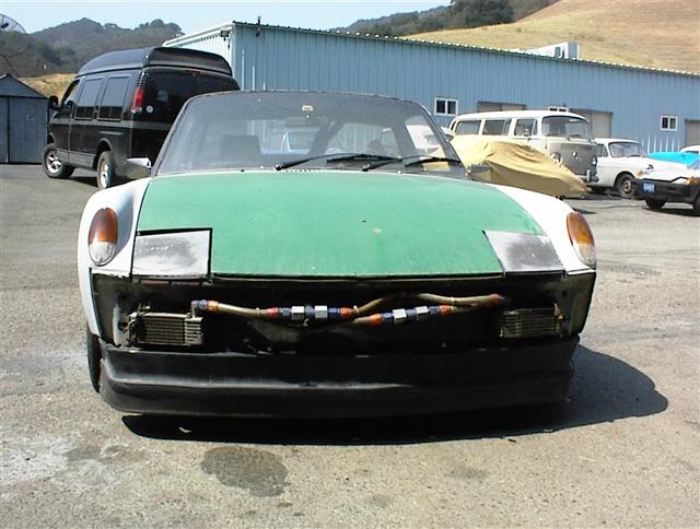

(IMG:http://www.justracing.com/galleries/albums/userpics/10045/DSC03392.JPG)

Terrance,
where are you going to exit the air?
any duct work planned?
brant
