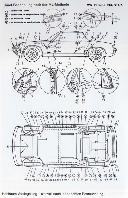

The thread is somewhere I saw it a couple of months back and Andy showed an access hole diagram for the whole car. You use a sprayer that uses wands with tiny spray tips.

Thanks Craig. That's what I'm looking for. I'm trying to find out what the wand was and the tip. I remember it being a real slick setup.

Looks like "Dinol cavity wax" is what the factory used to spray inside the cavities ...

The information Andy has provide is crucial to understanding the different areas where you put the rust inhibitor.

I drilled something like 20 half-inch holes in what I thought were critical areas and where I sprayed into the areas. These were determined by the spray pattern of the gun I used, the physical arrangement of the underlying metals, etc. I also had replaced the floorboards which gave me additional open areas in the central tunnel, access to the stress points on the car, and other related items. I have not done the blind areas yet since I was only interested at this point the areas where the car was connected and had frame/suspension stress points. The blind points as per the information provided by Andy will be followed.
