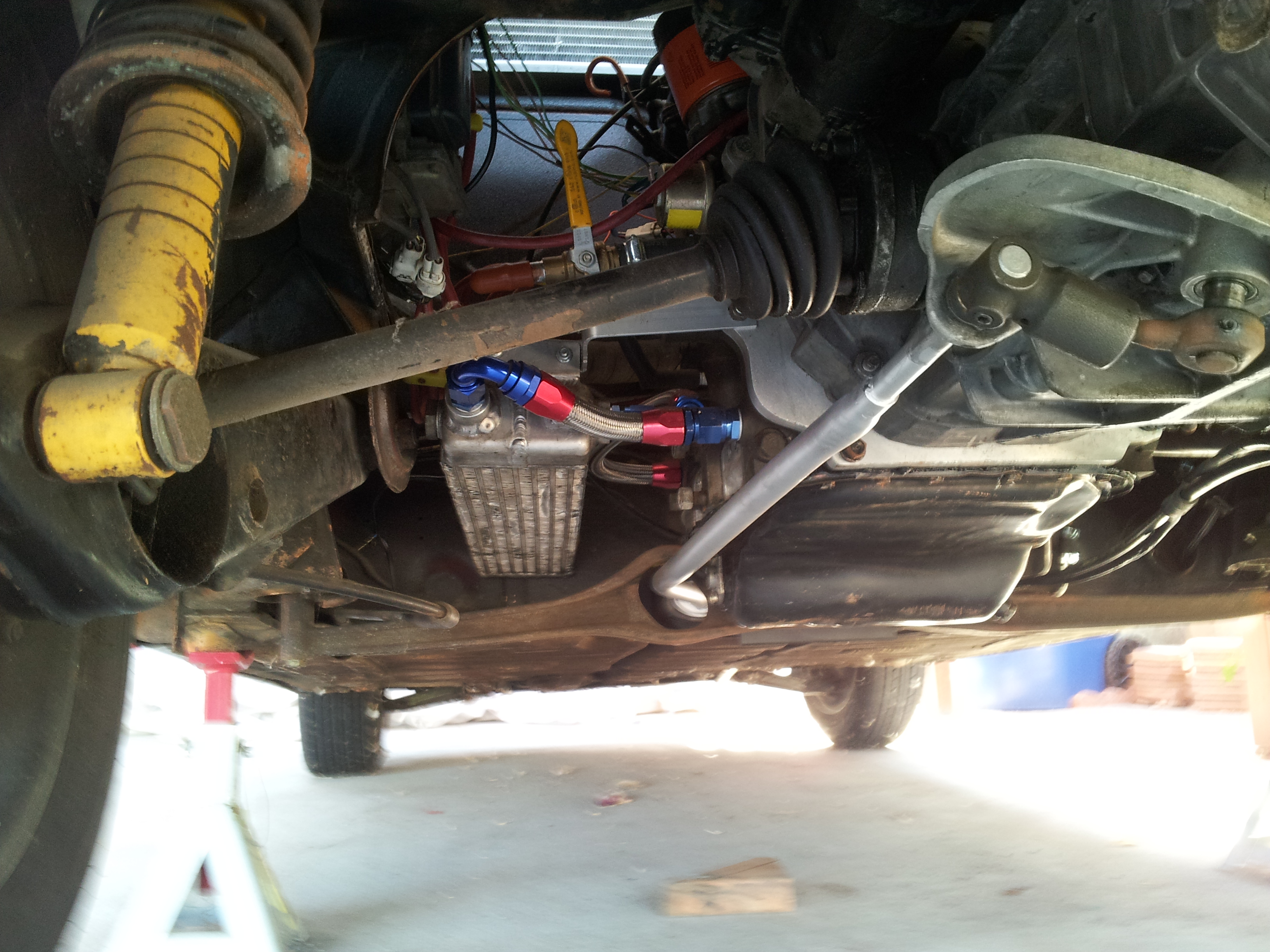

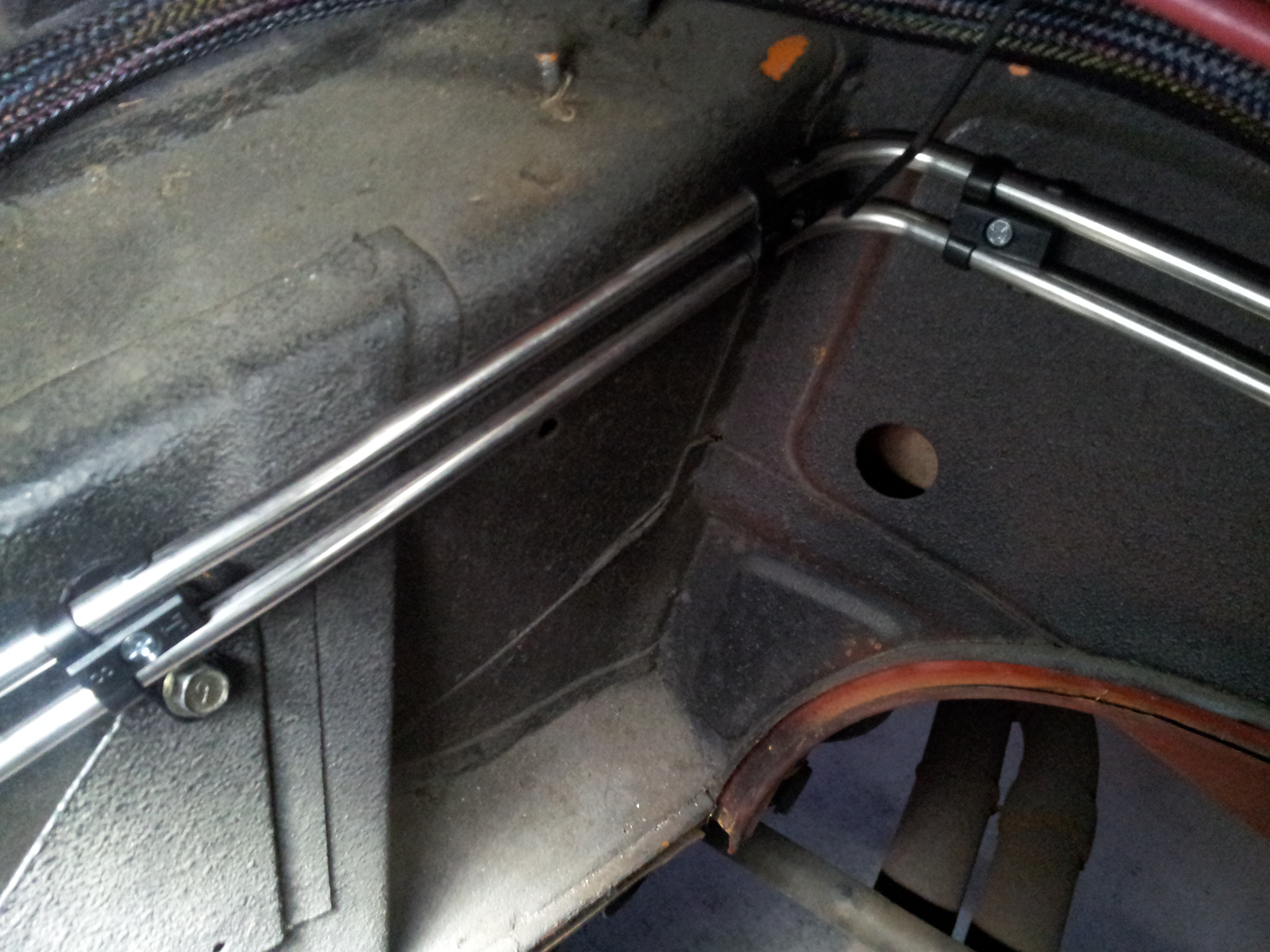

Here's a long overdue update on the cut-less conversion. I have mounted and wired pretty much 90%. Fuel injectors are mounted and my engine bay fuel lines ran.
My fuel lines are mounted and my fuel tank is POR-15ed and ready to go,,,,, but Dirk Write has a hold of me and I want to fix my fresh air blower "since I'm there". I have sat on this long enough for my foosball addiction (from a previous life) to side track me and derail me getting my car drive able to the great G&R this year,,,, BUMMER!!
I some how plan to wire up an "external" fuel source and try to fire up the ole girl. There's water in my coolant hoses,, and a mysterious loss of water to go with it,,,,, but nothing external that I can see,, and it's really slow so It might be thru my engine (because it's been sitting sooo long). I hope to fire her up and heat cycle it a bit and see if the leak goes away.
I need to find a machinist who can make a throttle arm for me,, I need a .25" X 2.5" 1/8"thick piece of steal shaped into a throttle arm with a "D" shaped hole on one end,,any suggestions in So. Cal.?
I will post some pics soon as they are on my phone,,
Rotary'14
post Oct 1 2012, 08:39 PM
Post #34
Posts: 753
Joined: 24-April 05
From: Los Angeles
Member No.: 3,977
Engine bay fuel lines,,
Rotary'14
post Oct 1 2012, 08:41 PM
Post #35
Posts: 753
Joined: 24-April 05
From: Los Angeles
Member No.: 3,977
Engine side,,

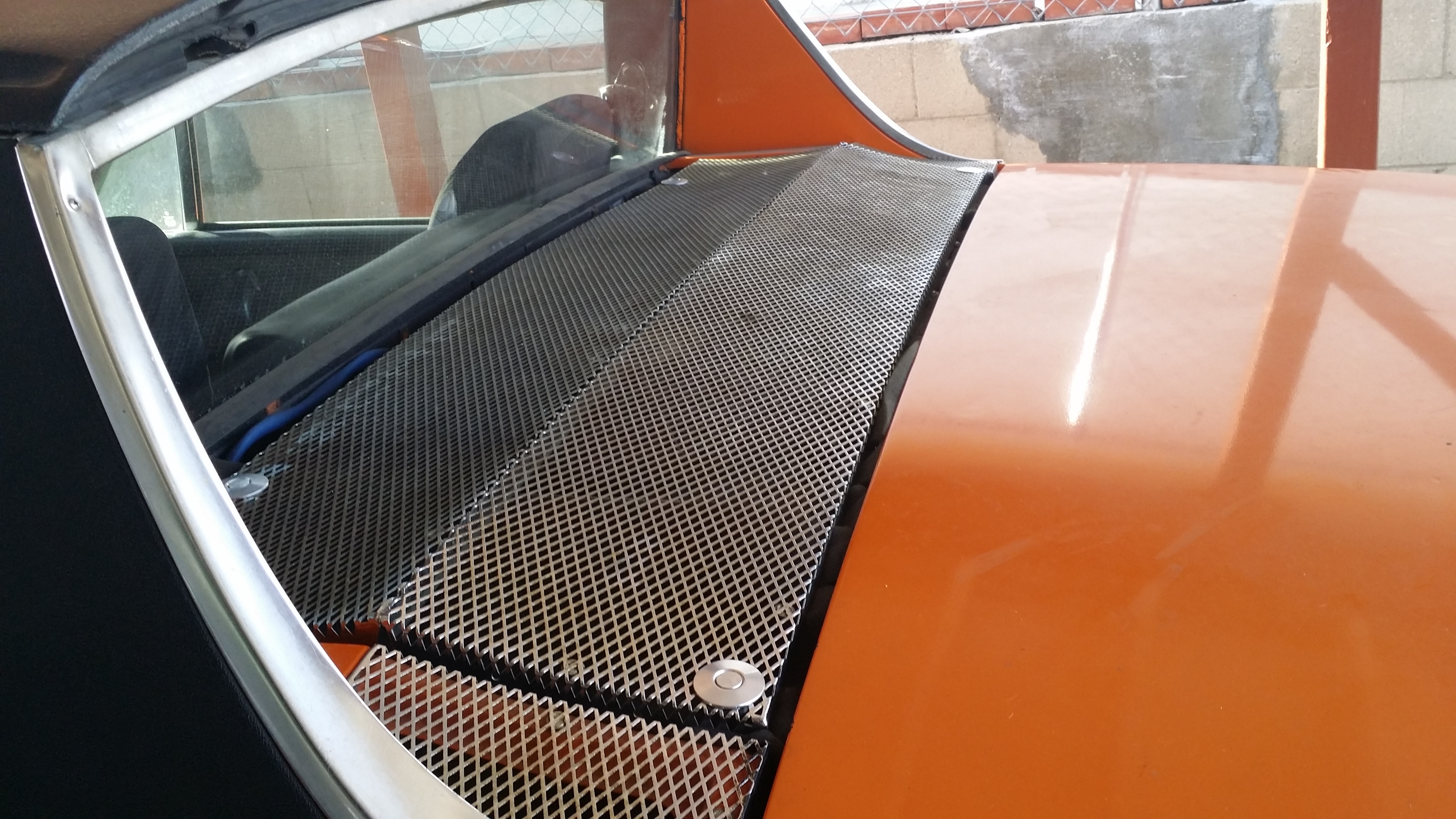

post May 18 2014, 06:52 PM
Post #38
Posts: 753
Joined: 24-April 05
From: Los Angeles
Member No.: 3,977
I have made my own GT style lid from two chrome grills. It's held down with quick-latches. I think it looks OK for now. until I clean up my cooling system a bit, speaking of which,,,
I've driven her on 100 degree days now, still no overheats. I was a bit low on water too. On normal days my car is a cool running cat. I want to sort my suspension, but I don't know where to begin. I had a fellow teener hop behind the wheel of my car for an evaluation run. John was pretty impressed, despite the fact that he wasn't used to my gear box and couldn't find 1st. When the test drive was over,, I suggested that he pull on the ebrake lever with some force,,, only one side is currently working. Pop! went the cable inside the cabin. bummer,, oh well I have a wtb add up.
anybody local want a ride? I have the FI 95% done and she feels pretty good! I'm thinking about adding heat now,,,,
-Robert

mikesmith
post Jun 3 2014, 04:35 PM
Post #40
Posts: 202
Joined: 5-September 13
From: SF
Member No.: 16,354
QUOTE(Rotary'14 @ May 18 2014, 05:52 PM) *
I'd love to see more details of your latch setup...
