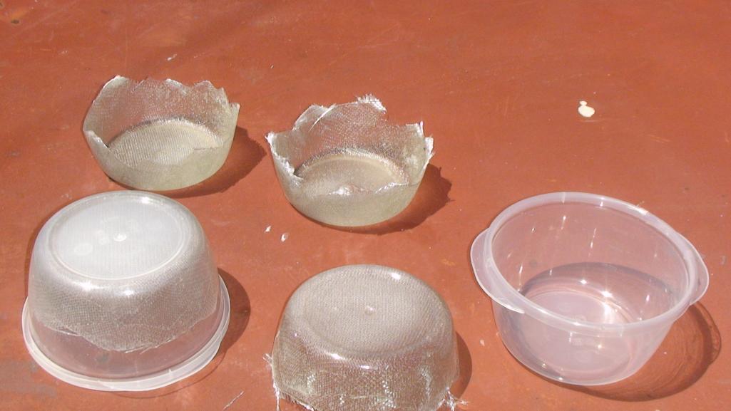

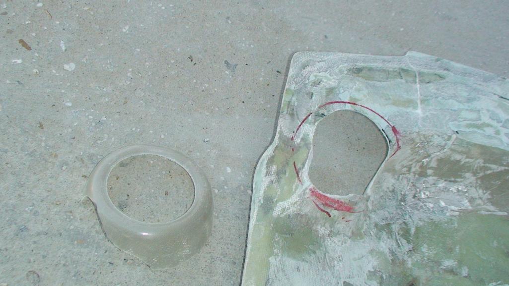

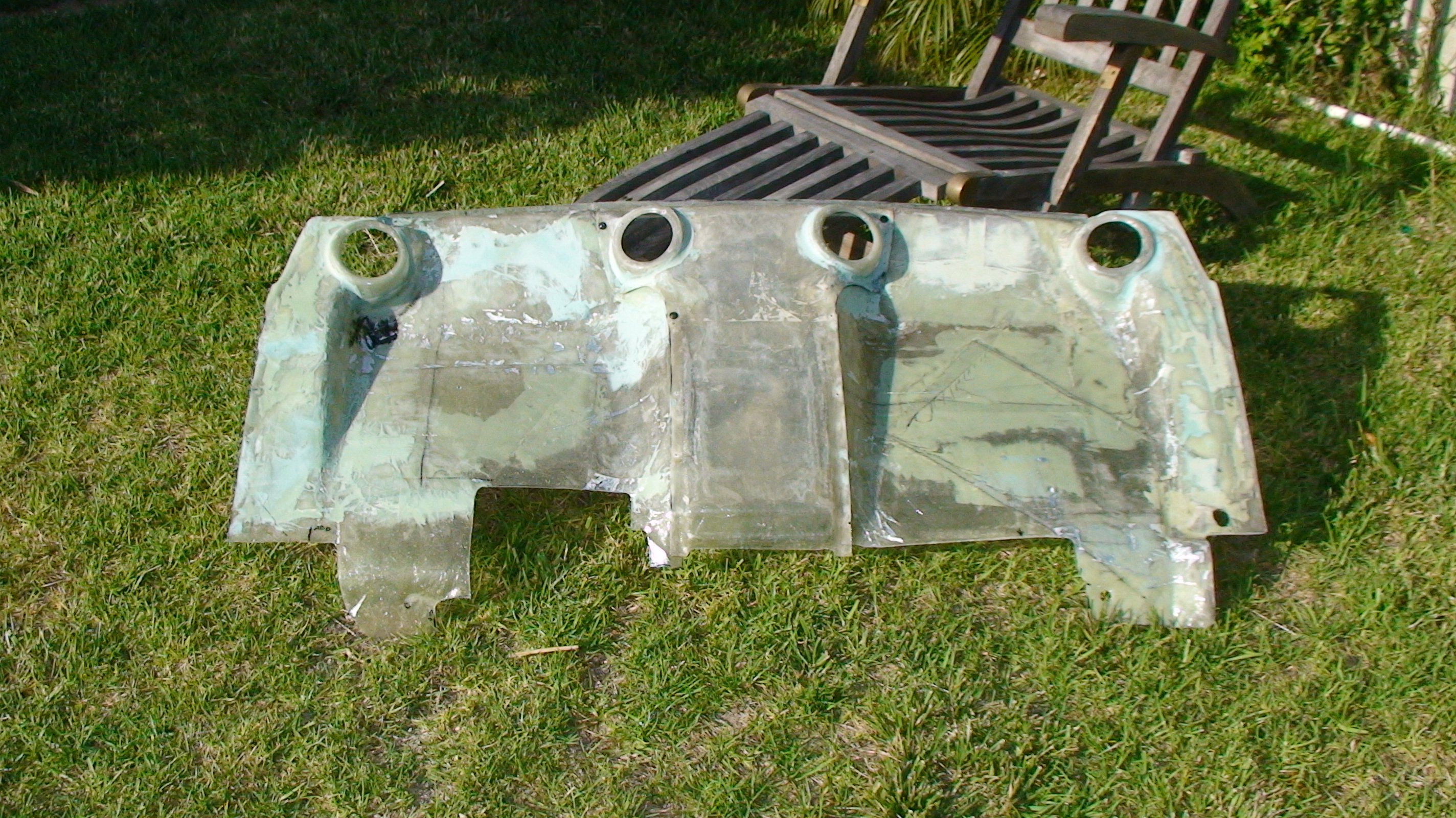

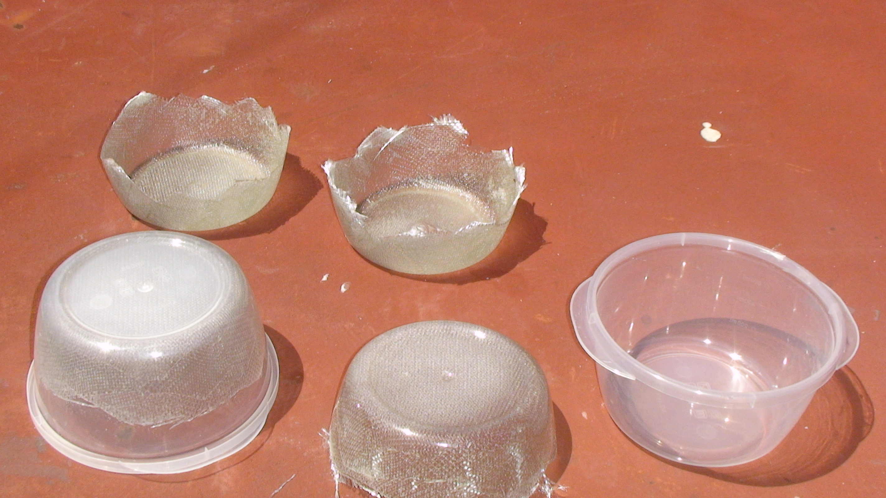

I got my new Vidsonix 3.5 speakers.
As they were in the mail, I started on the back pad and speaker bosses.

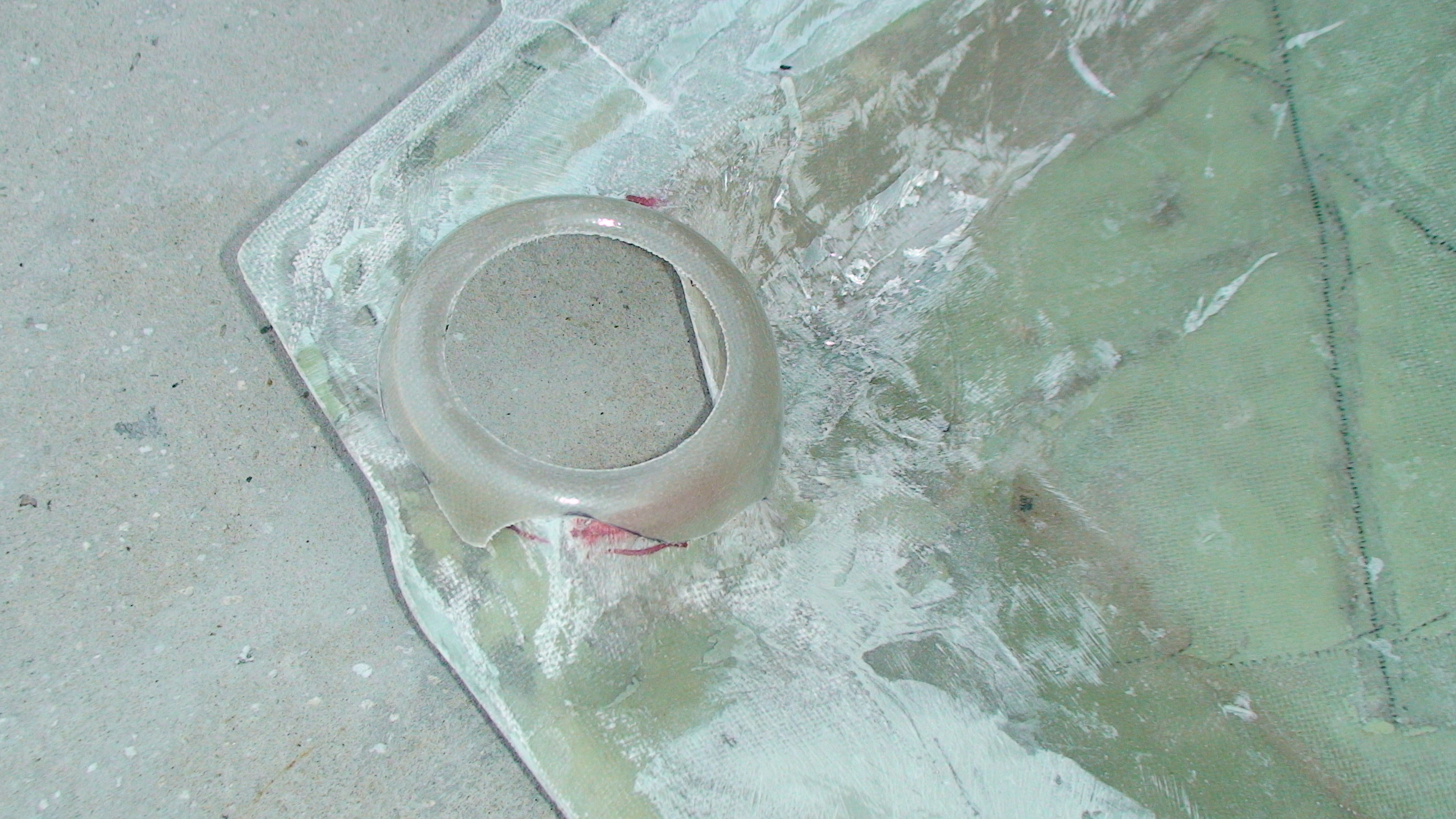

ruby914
post Apr 19 2012, 02:03 PM
Posts: 720
Joined: 26-April 09
From: Hawthorne, Ca
Member No.: 10,305
One more shot before work.

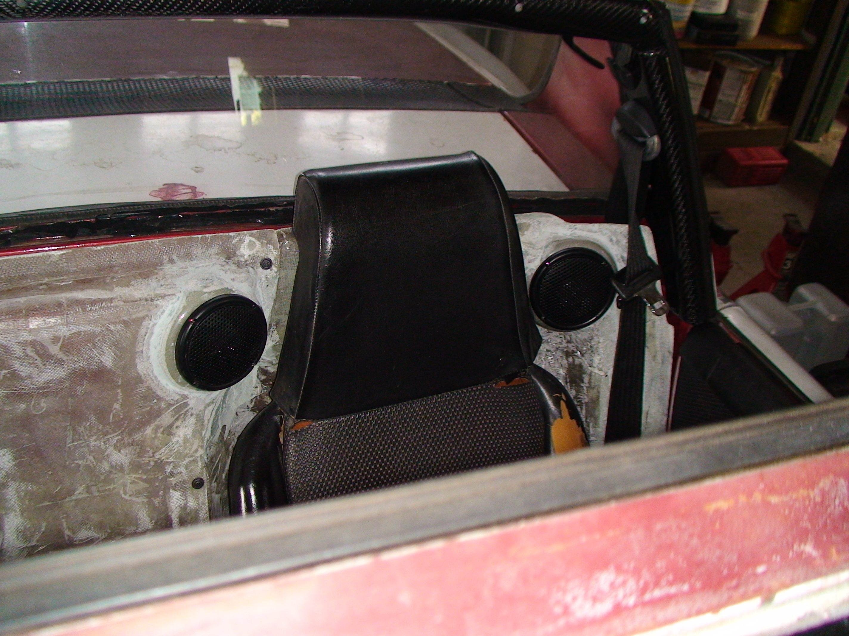

ruby914
post Apr 20 2012, 01:51 AM
Posts: 720
Joined: 26-April 09
From: Hawthorne, Ca
Member No.: 10,305
I got the drivers side speakers mounted. I am thinking of covering the back pad shell with Perlon felt. It will look a lot better at that point.
As the 3.5" speakers were in the mail, I also put together an 8" Sub woofer for the passenger foot rest. I had some old amps laying around so I used the 110 W for the Sub and a 50 W RMS X2 Alpine to power a set of 6.5" Alpine S component speakers up front. The tweeters are in the "A" pillars. That alone was a huge improvement.
Originally, I was only powering the component speakers with the 22 W RMS head unit.
Now the rear speakers will be powered with only the 22 w from the head unit.
That is more than enough.
I cheated and hooked up the drivers side rear speakers and had a listen.
Wow, I didn't think a 914 could sound so good.

QUOTE(GeorgeRud @ Apr 20 2012, 08:19 AM) *
That might actually be something that could be put into production by some of our uphostery vendors as an optional accessory. Would go nicely with front kicker panel speakers!
I agree Appearance and Performance could have an optional speaker boss added to their existing FG back pad. I made basically what they are selling now. It would not take a large new mold, just scab on the boss. Or it is not that hard of a DIY project with their back pad.

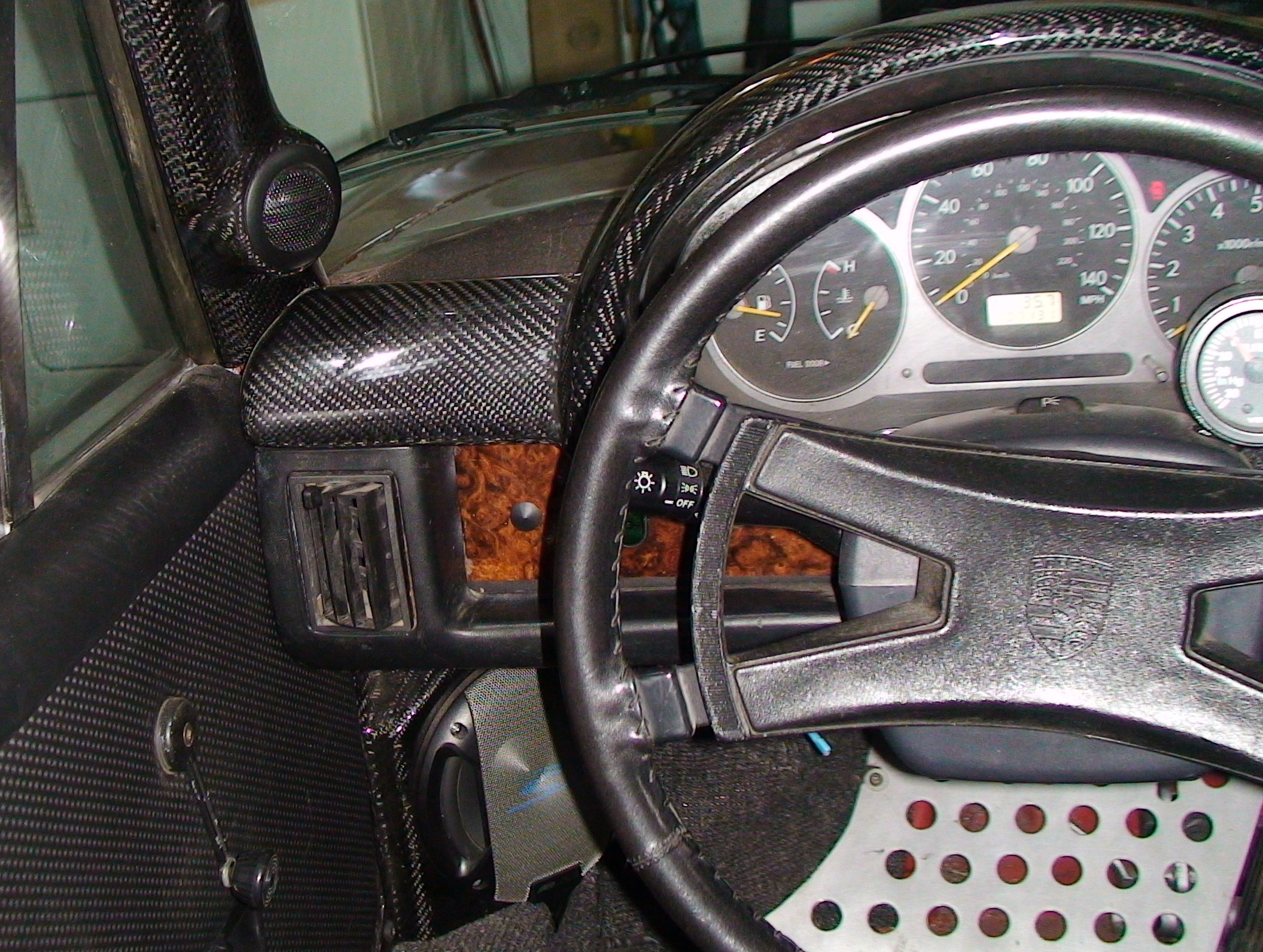

Here is a view of the front set up.
Come to think of it, in the end I will have 9 speakers in the car.
Yes, the 6.5 kicker panel speaker is the start of getting real sound in the car.
I took it one step farther and made A pillars for the component tweeters.
I have revamped a new plug to angle the tweeters back a little more but have not gotten around to making a new mold yet.
I need to look into something other than CF to make it affordable. Something as visible as an A pillars, I would rather be looking at vinyl rather than ABS or painted FG.

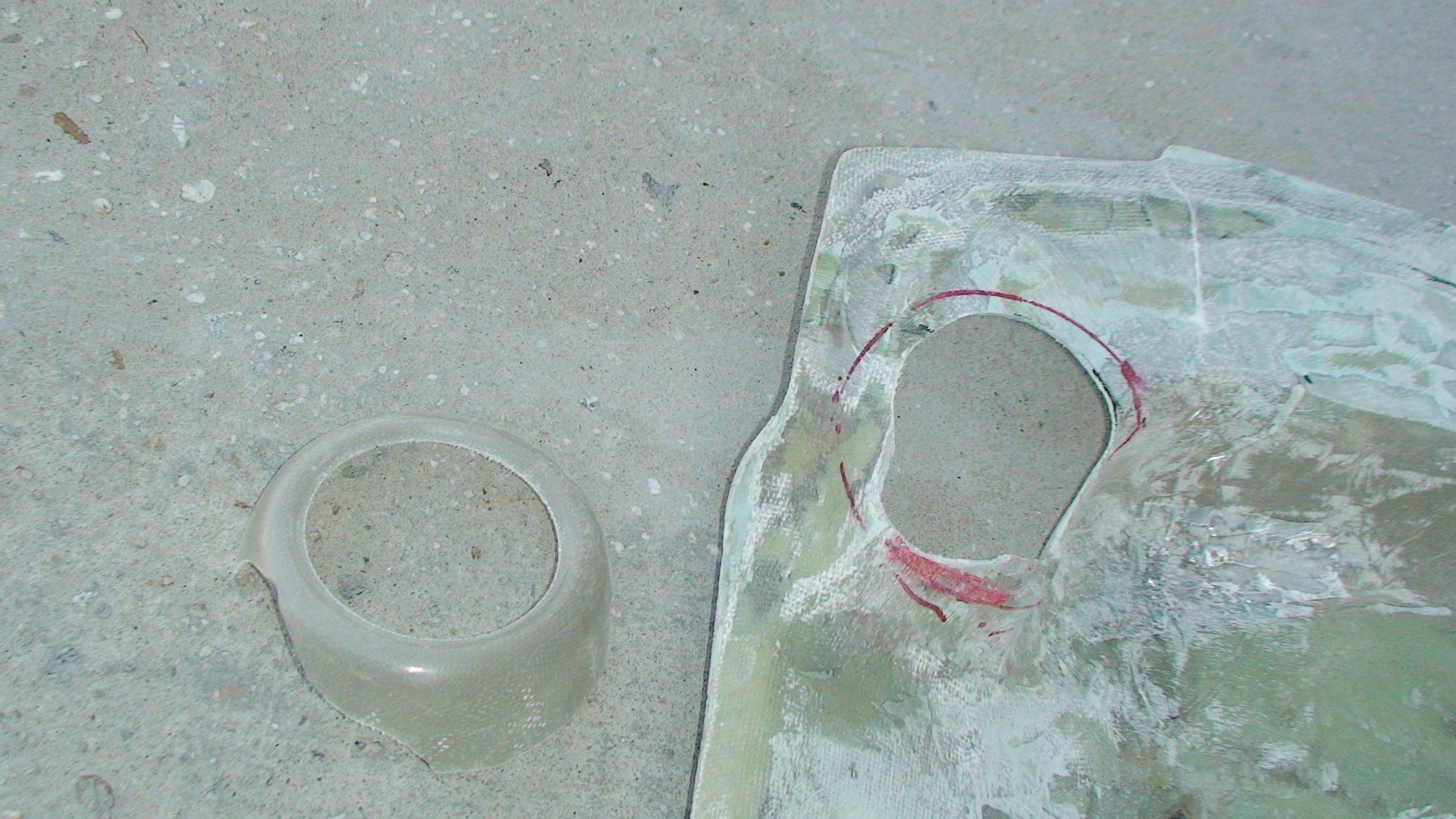

Made some more progress.
The bottom cutouts are for the Suby ECU and fuse box.

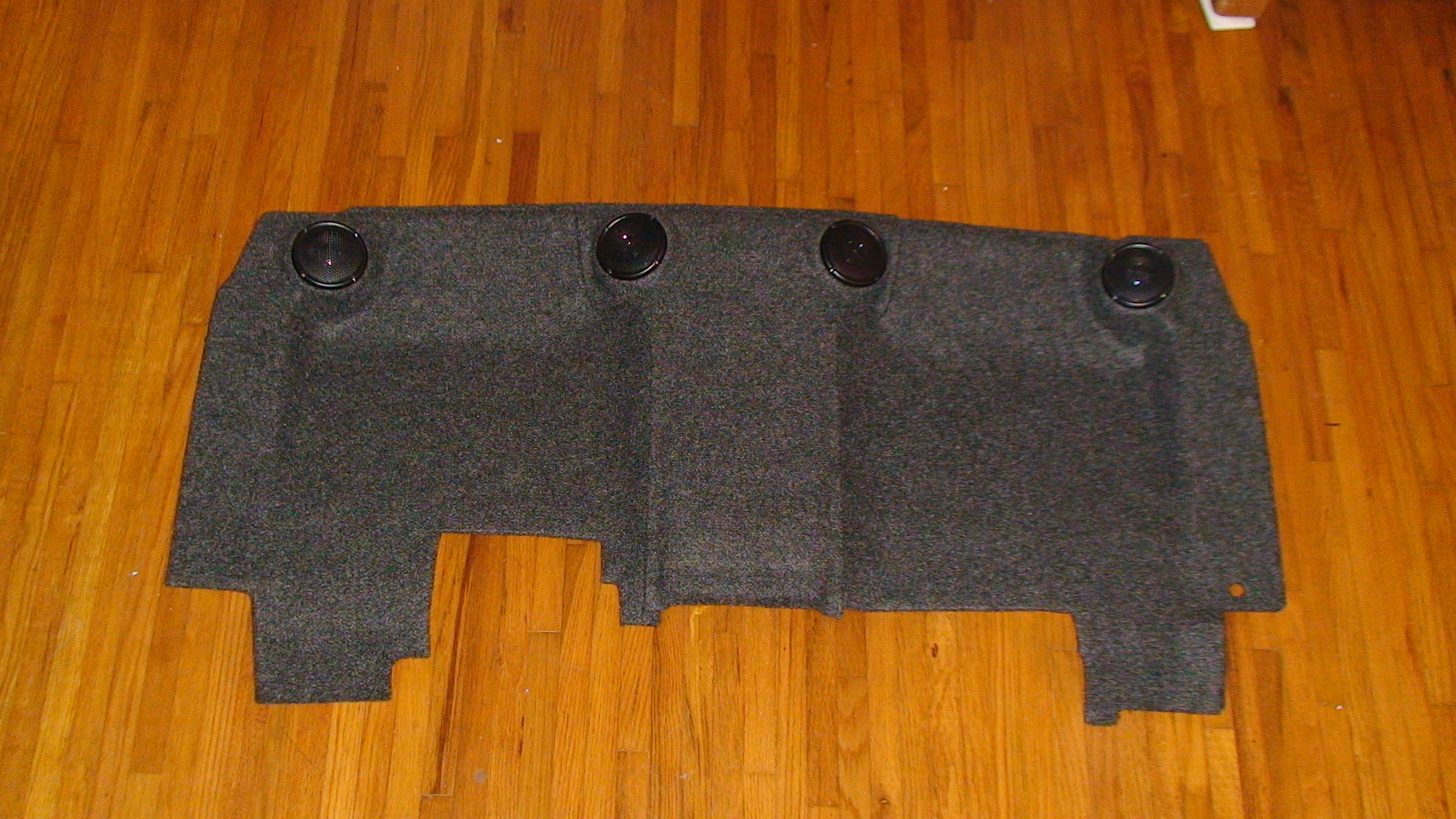

ruby914
post May 1 2012, 12:50 AM
Posts: 720
Joined: 26-April 09
From: Hawthorne, Ca
Member No.: 10,305
And it cleaned up well.
