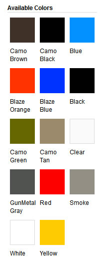

Standard colors from the Plasti-Dip site

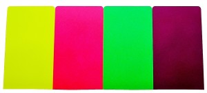

And their new fluorescent colors, for riced-Hondas wheels (IMG:style_emoticons/default/confused24.gif)

I think the NEON green would be great with some contrasting black. Maybe the orange and white for cup-car colors. I dunno (IMG:style_emoticons/default/confused24.gif) Blend up Yellow + Red for orange, choose the lighter blue and you can get GULF-PORSCHE colors (IMG:style_emoticons/default/biggrin.gif)
