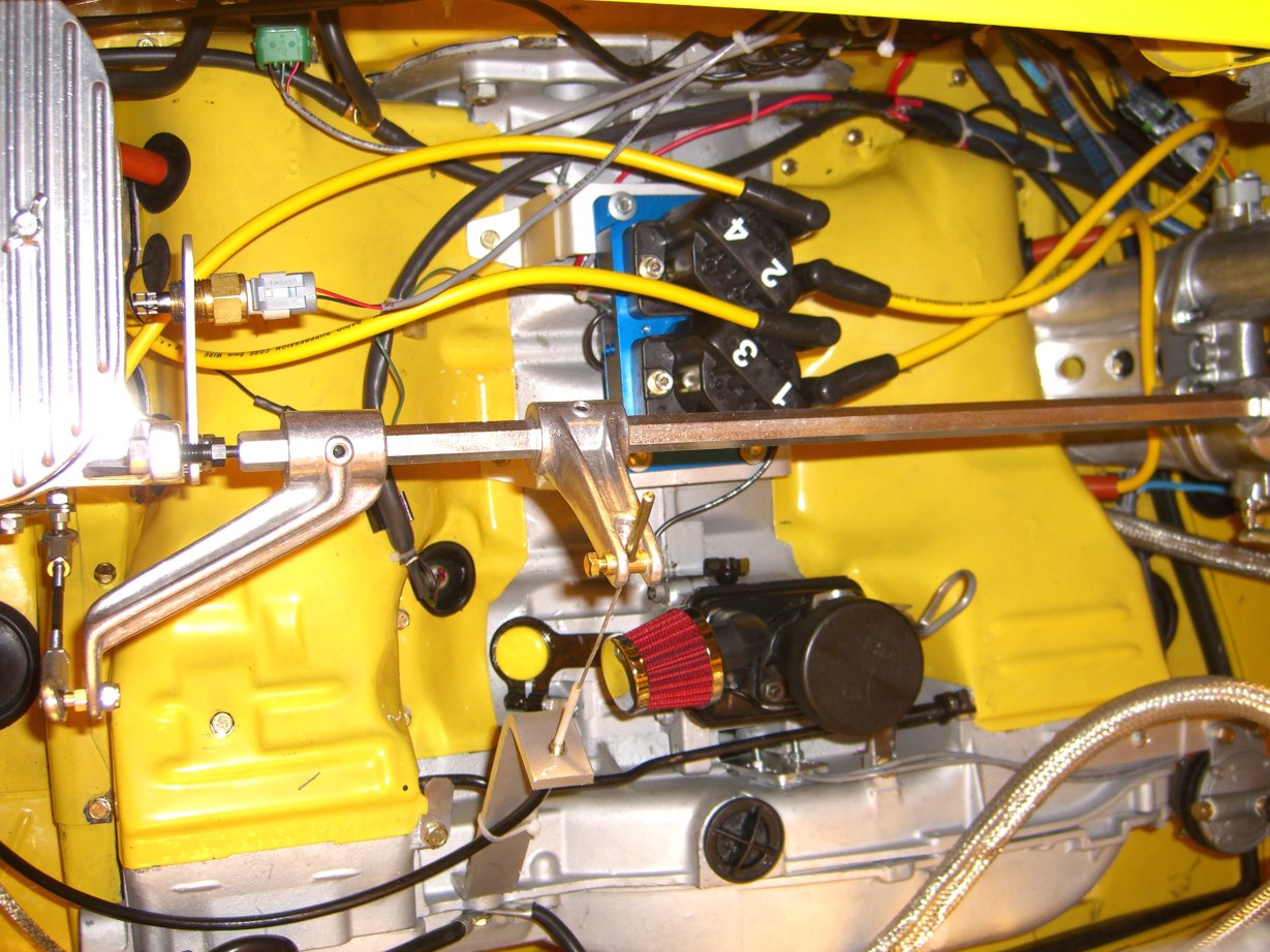

why use them , they just get in the way.

QUOTE(41ghost @ Apr 23 2007, 05:36 PM) *
So do hex bar linkages...
