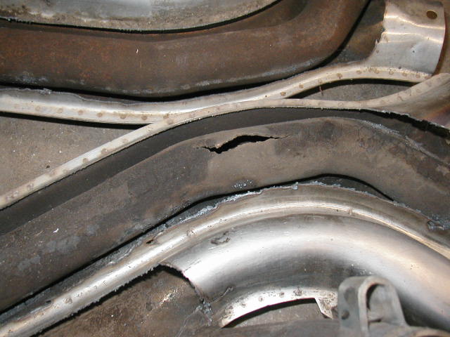

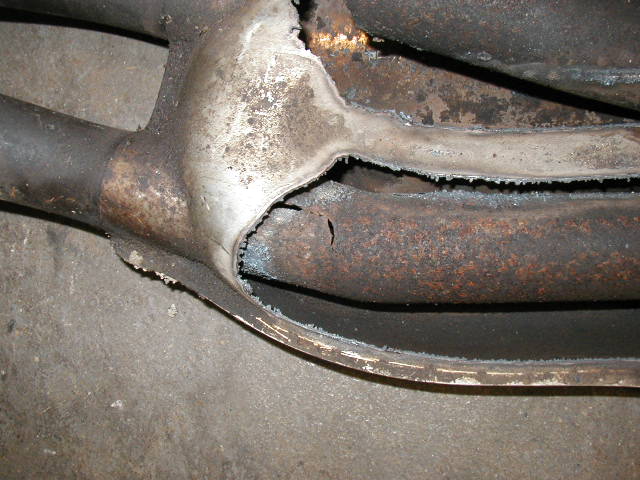

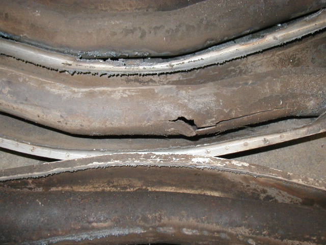

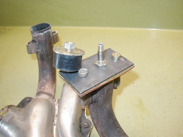

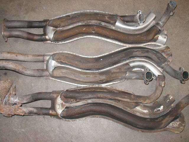

I posted this last year, heating season is here again. These are big cracks, a tiny one you would not be able to hear would still be dangerous. These are not accident damaged. If you have a set on your car, grab the carbon monoxide detector from home and take a ride with the heat on and windows rolled up. There is a detector used in small aircraft also available. The last photo is how we now test for leaks using air pressure. Brad

wingnut86   Just assuming here, but is the washer/rubber dongl...   Oct 6 2011, 07:27 AM
rick 918-S   Just assuming here, but is the washer/rubber dong...   Oct 6 2011, 07:40 AM
VRROOMM1   Just assuming here, but is the washer/rubber dong...   Oct 6 2011, 07:42 AM
76-914   Just assuming here, but is the washer/rubber dong...   Oct 6 2011, 07:47 AM

GeorgeRud   If the exchangers are on the car, a simple battery...   Sep 24 2014, 12:23 PM

914ltd   The header pipes can be filled with water to check...   Oct 16 2020, 09:32 AM
