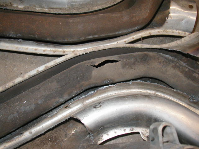

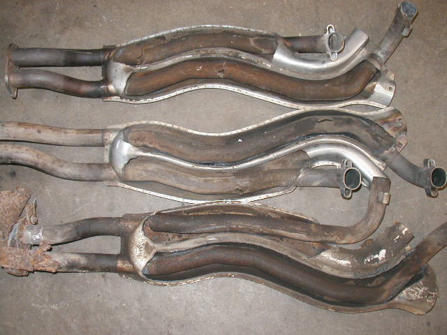

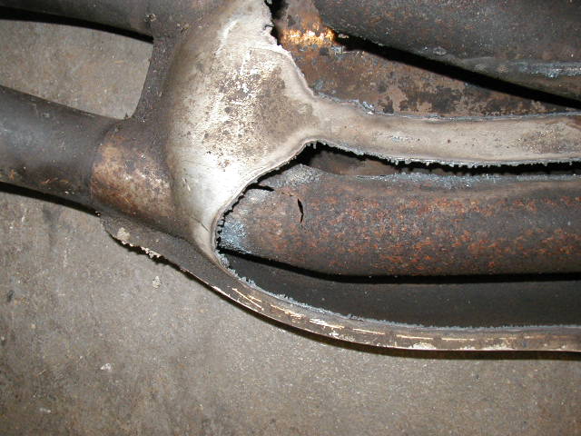

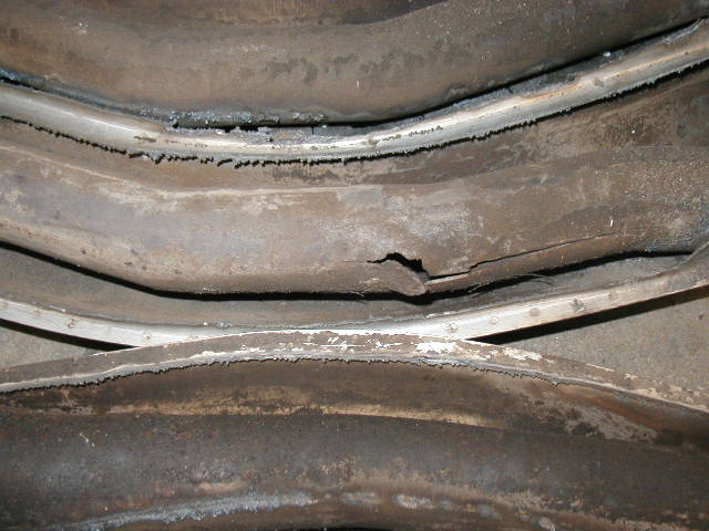

I try to post this every year at "heating season" I've only seen this type of damage on SSI heats, never the stock systems.
Most everyone knows carbon monoxide is extremely dangerous. It will eventually kill but probably more dangerous to us, it can impair driving skills similar to drunk driving. A home CO detector riding with you with the heat on should be sufficient but there are other devises (as small airplanes) that are better solutions. In the past several 'teeners have posted good information on this subject. Please, try to inform everyone about this potential danger. Brad Attached image(s)

walterolin Thanks for the post Brad.
CO poisoning is one o... Oct 19 2012, 07:25 AM
914itis Thanks Brad, for this priceless info.
From my un... Oct 19 2012, 07:28 AM
rnellums
From my u... Oct 19 2012, 07:38 AM
Bartlett 914
From my ... Oct 19 2012, 08:01 AM
ConeDodger
From my ... Oct 19 2012, 09:30 AM
914itis You learn something new everyday , I was always un... Oct 19 2012, 07:41 AM
GeorgeRud Thanks for posting these very scary pictures. It ... Oct 19 2012, 08:09 AM
Black22 You can get a CO detector the size of a pack of ci... Oct 19 2012, 09:00 AM
bigkensteele
You can get a CO detector the size of a pack of c... Oct 19 2012, 10:24 AM
Krieger This may not be a SSI brand heat exchanger. The h... Oct 19 2012, 09:05 AM![]() ![]() |
