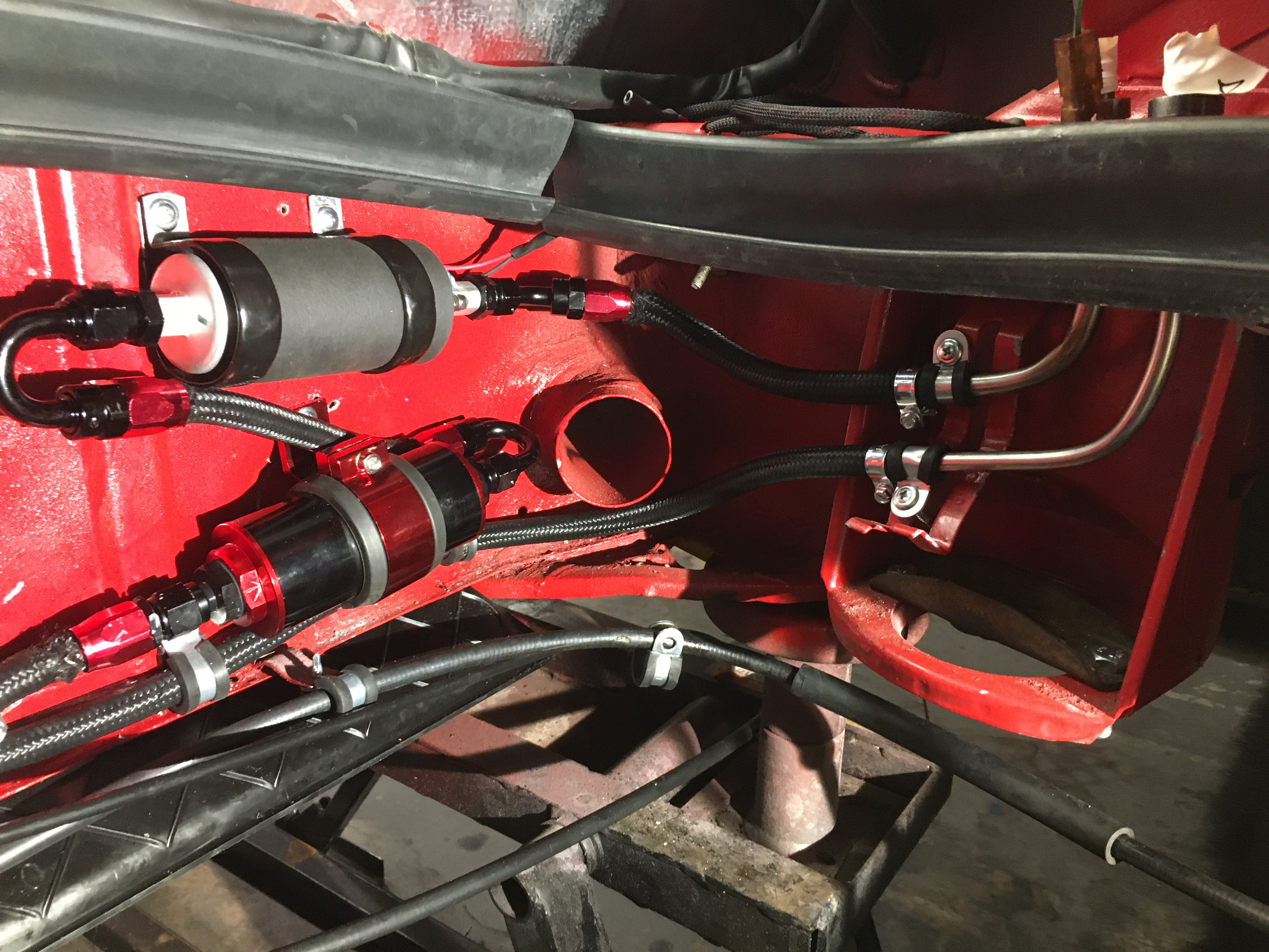

I completed installing my fuel system.
Cleaned and painted fuel tank. Installed Stainless Steel fuel lines.
Installed fuel filter and pump and all associated lines.
Ready to test the system
Onward thru the fog.

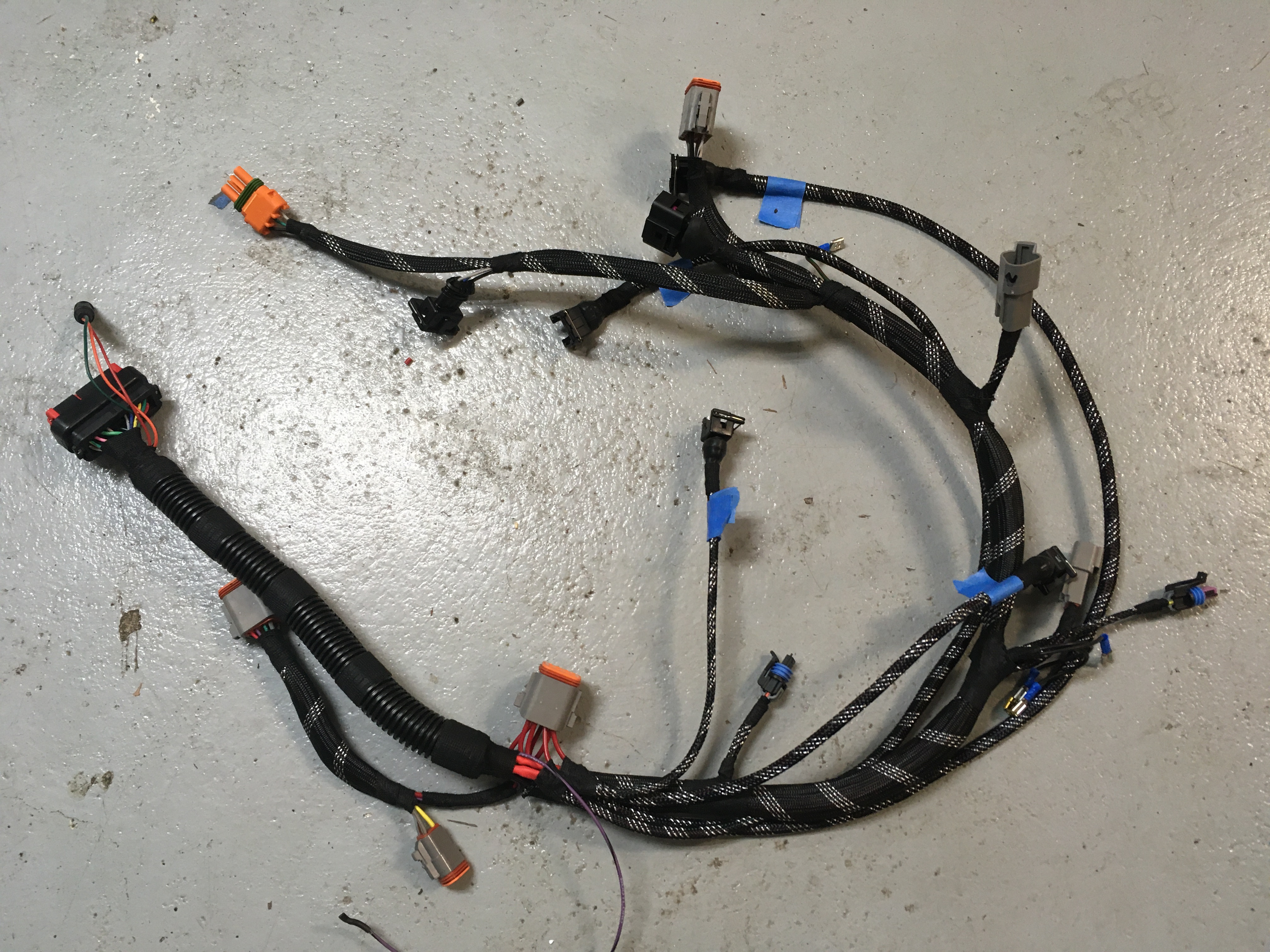

QUOTE(GregAmy @ Feb 12 2020, 06:59 AM) *
"vaguebooking"...
Is that harness for Microsquirt? Where did you end up placing the ECU. I need to get started. Looks very clean harness.

@Rikyrat
Nice setup but one thing to fix here. The make AN flare adapters for tube that do not require welded fittings.
It will fix this issue the could and most likely will leak.
Like these just for reference

QUOTE(913B @ Feb 13 2020, 07:01 PM) *
Si, Gracias.
I'm coordinating with @Montreal914 (his build thread here) and should have it running in a couple weeks, depending on available time. Drivetrain going back in, next.
If someone wants to sell a kit I'll give them all the design info (including detailed harness specs), otherwise I'll do a full write-up on the design with pics, parts list, and instructions so others can replicate it.
I'm looking to be into it for less than $1500 plus time.

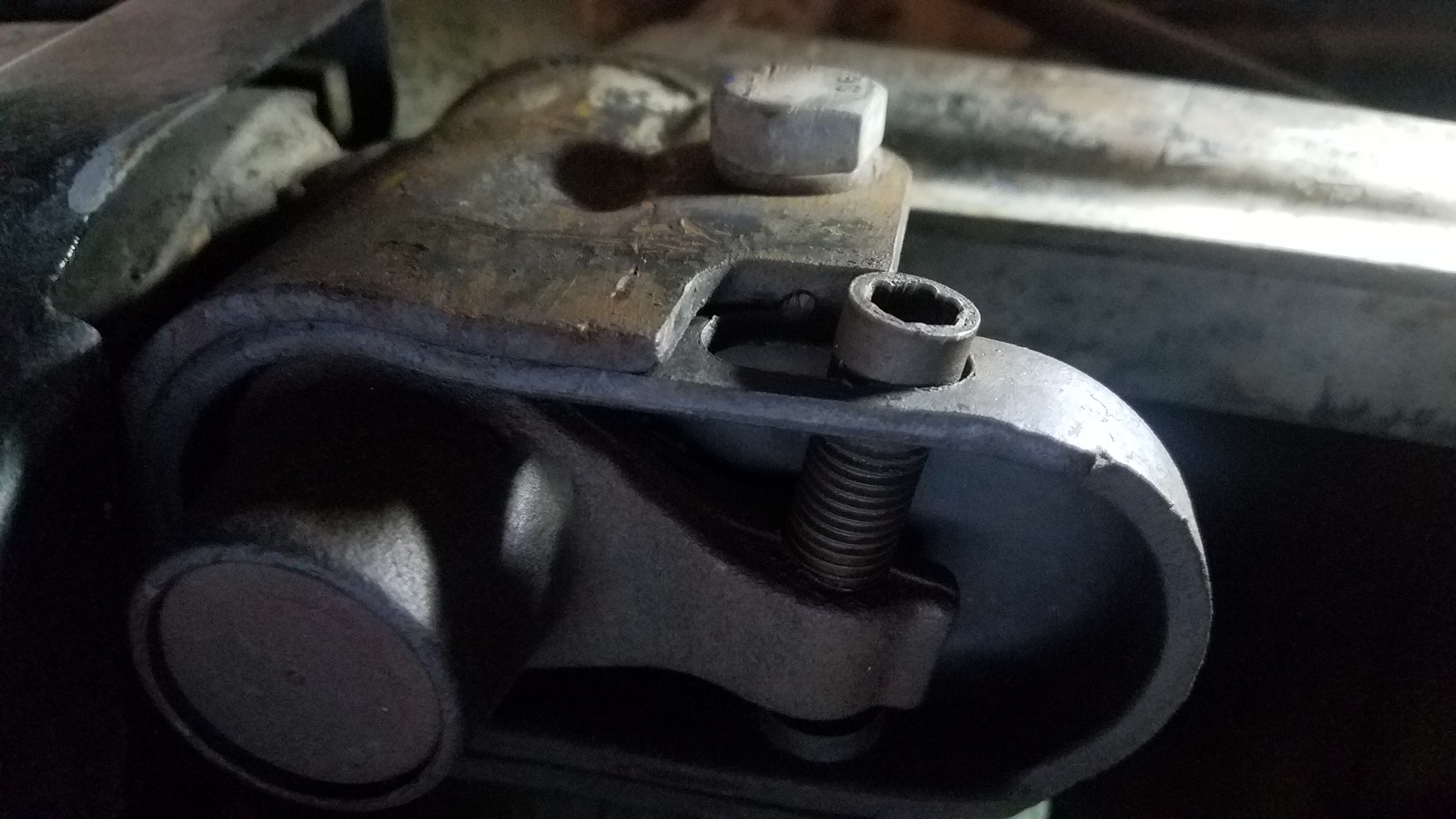

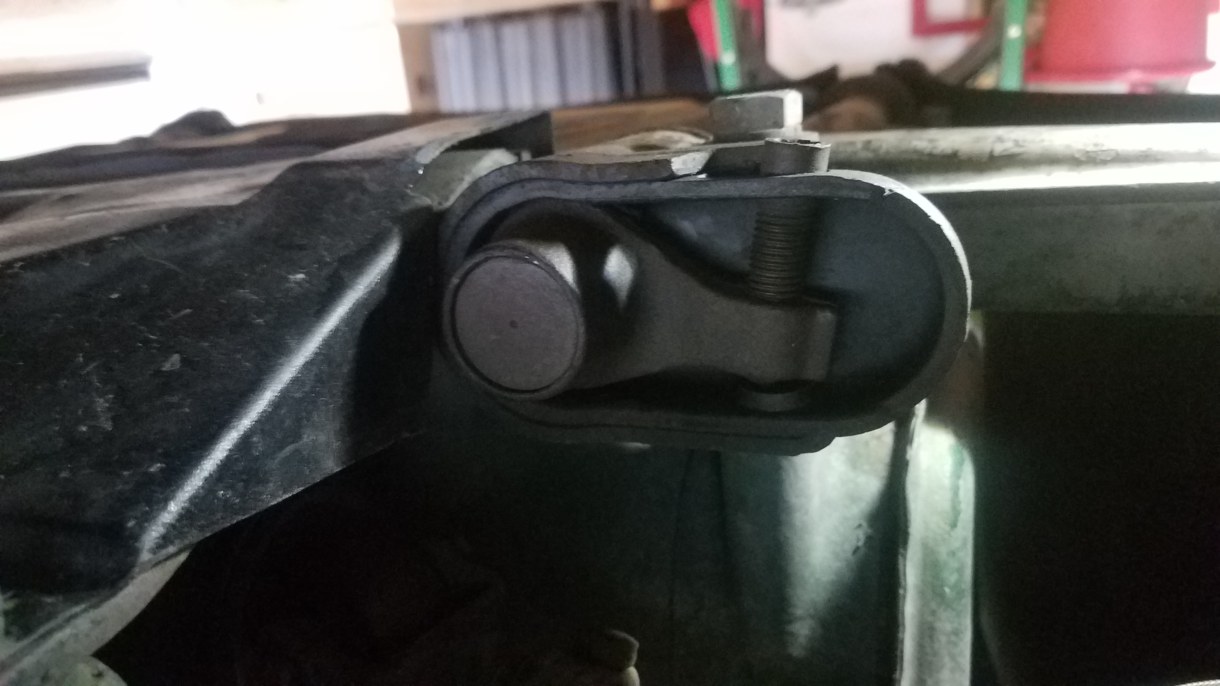

This is how the torsion bar caps look now. They are the same on both sides.
I don't know why the picture is upside down. If you click on the image it will show up with the correct orientation.

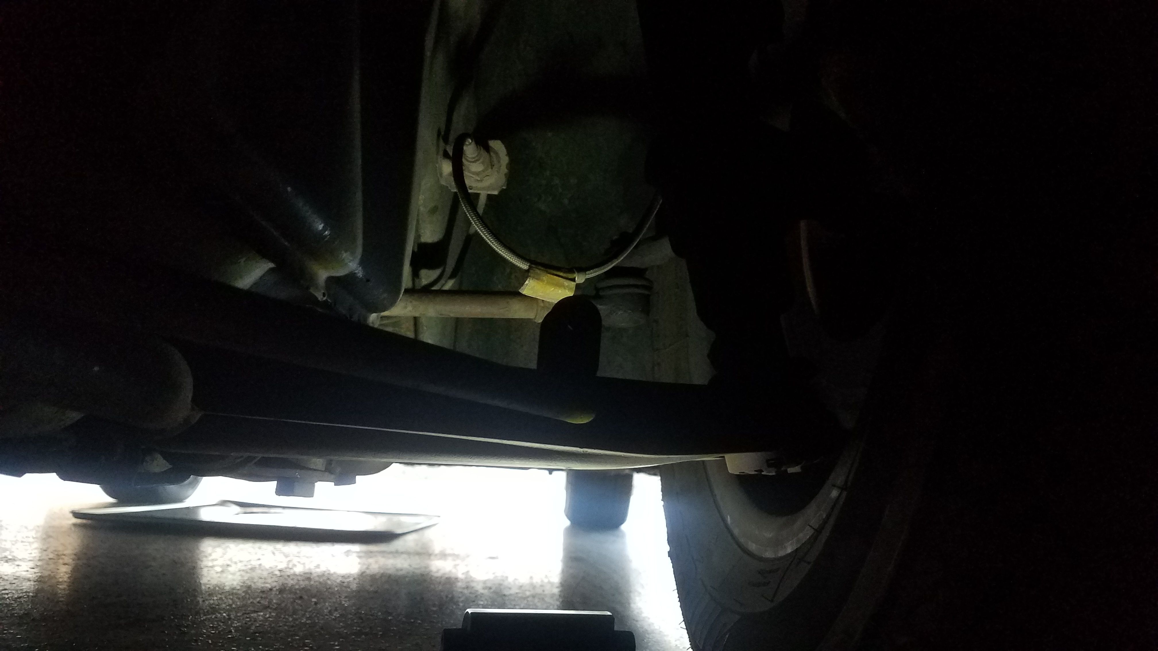

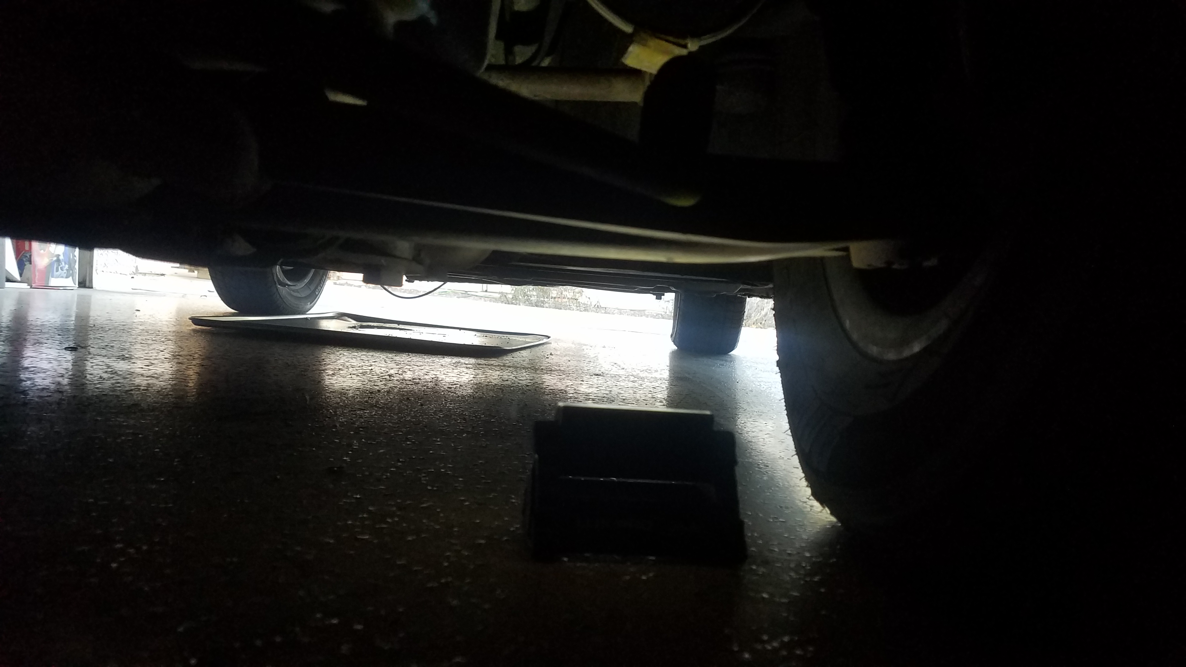

Here are the suspension and tie rod angles. Everything is basically level.

In the picture of the torsion bar cap, you can see the the end of the cap attached to the bolt is up about as far as it will go without hitting the metal around it. It was in the middle of the range and now it is up near the top. To go any lower I would need to re-index the torsion bar. I didn't want to do that and I am happy with where it sits now.
I didn't count the turns and honestly, I turned it the wrong way to begin with and had the front WAY up in the air.
It drives a lot better. It feels more stable and I didn't feel any bump steer.

QUOTE(DRPHIL914 @ Feb 13 2020, 09:53 PM) *
Thanks! Last question , counter clockwise to lower?
Yes, If you are under the bolt looking up at it, counterclockwise to lower the car. You want the end of the torsion bar cap connected to the bolt to be moving up vertically toward the top of the car. The end of the torsion bar cap goes up and the car goes down.
This picture is upside down as well.
