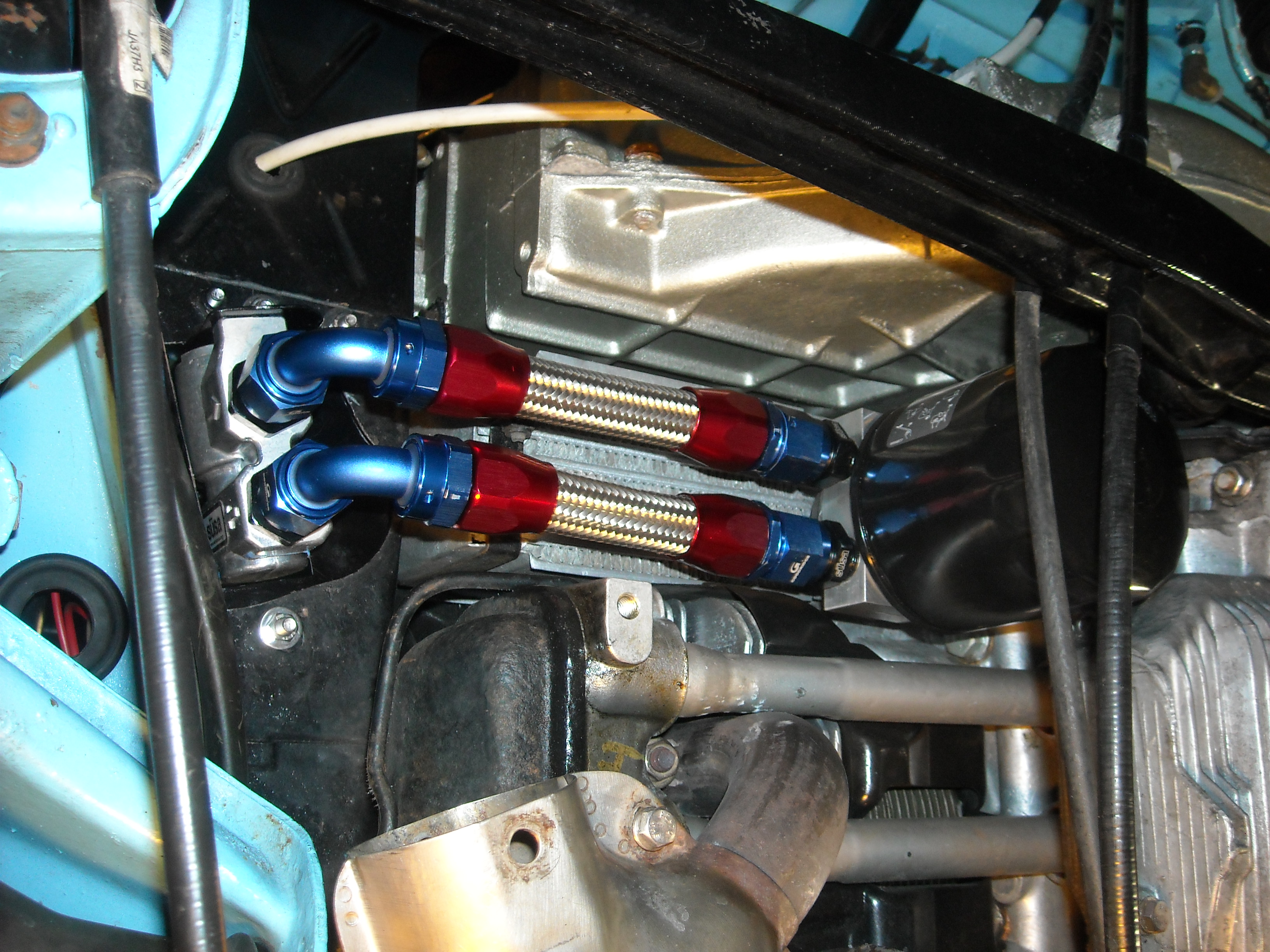

Had a slight weep at one of the AN lines coming off the oil filter sandwich adapter.
Just enough to leave a few drips on the floor.
Took that apart, added some Teflon tape to the pipe threads, tightened it back up. every thing seems good now.

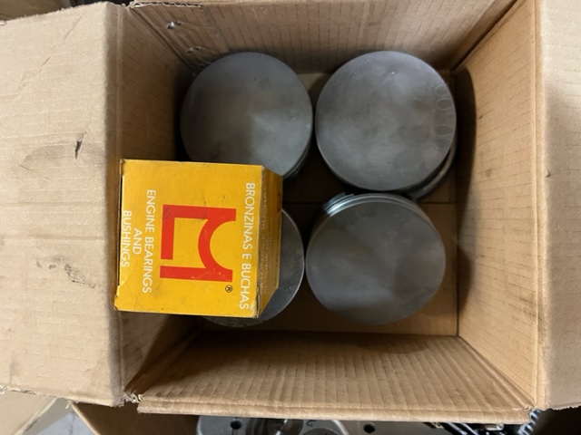

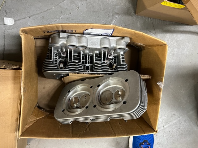

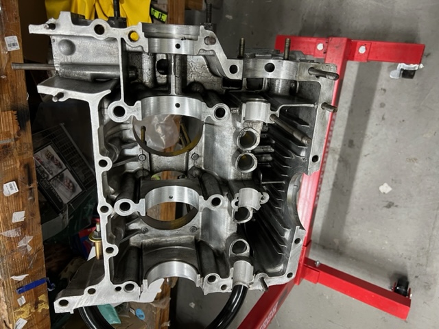

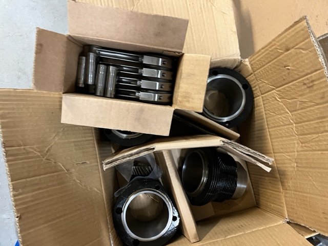

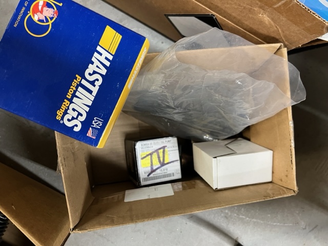

Parts and machine work of the worn out RAT built eng 2170 back from The Machinist. Everything is done. Align board. Valve job, New valves on The HAM RAT heads, new high performance cam all the parts. Now to assemble the whole thing.
-----The machinist is your best friend-----
I am not going to put all the pictures in but ready to go. 170 HP
Bob B Burton and Mark Sonners
Attached ImageAttached Image

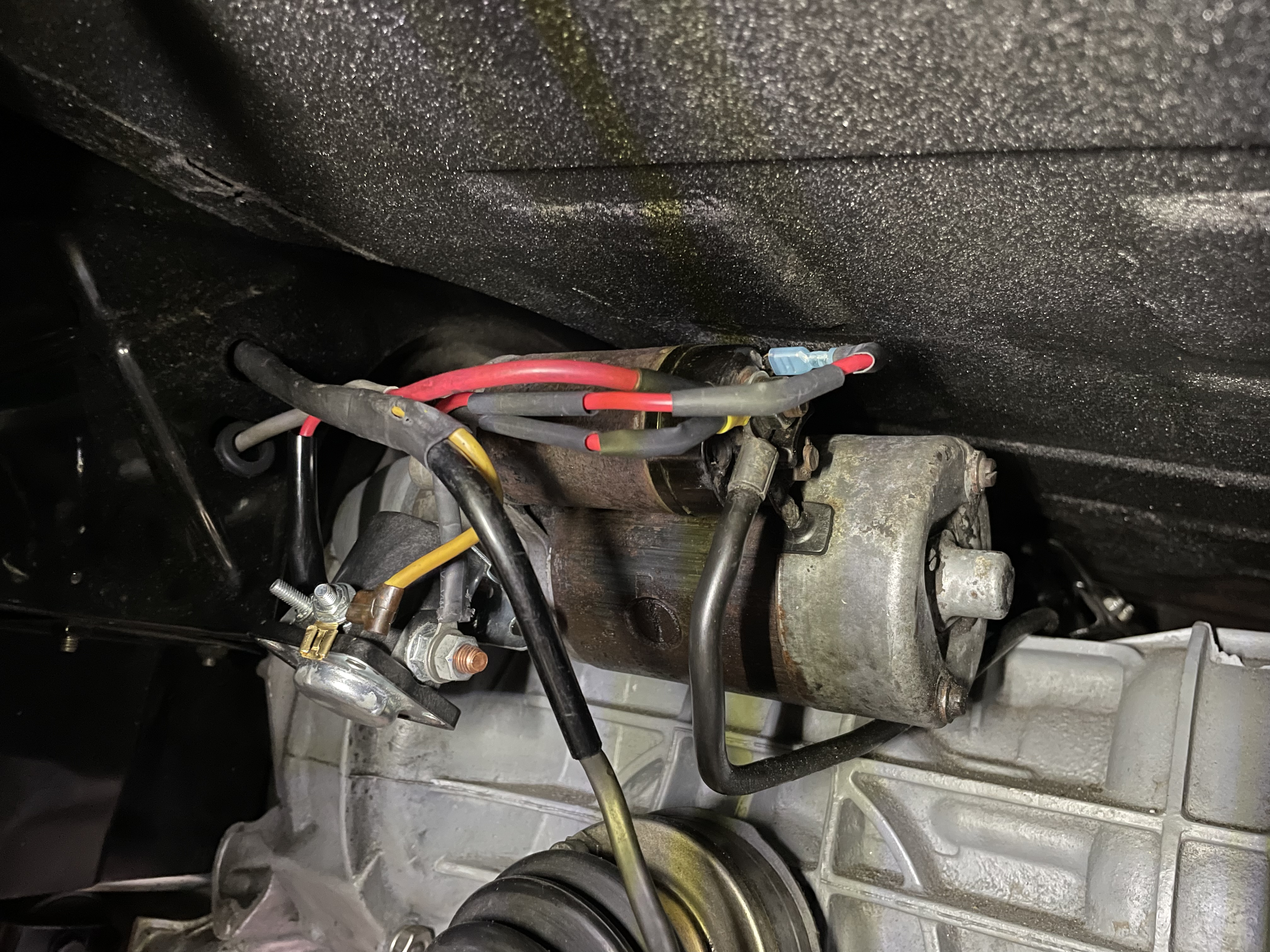

So i just installed the ford relay but what i don’t know is, from the pictures in the thread by Mark, i can’t tell if there are supposed to be 2 or 3 cables on the solenoid post?
on the stock set up there are 2, the one from the harness that is red and the black one from the battery. question is, do they both stay on there or not? i have the solenoid wired and connected just like he shows but what i can’t te from his pictures is if the red wire from the harness is removed or stays? i know the battery cable stays on along with the new wire from back side of the ford solenoid to that post.
maybe @markhenry will comment thanks

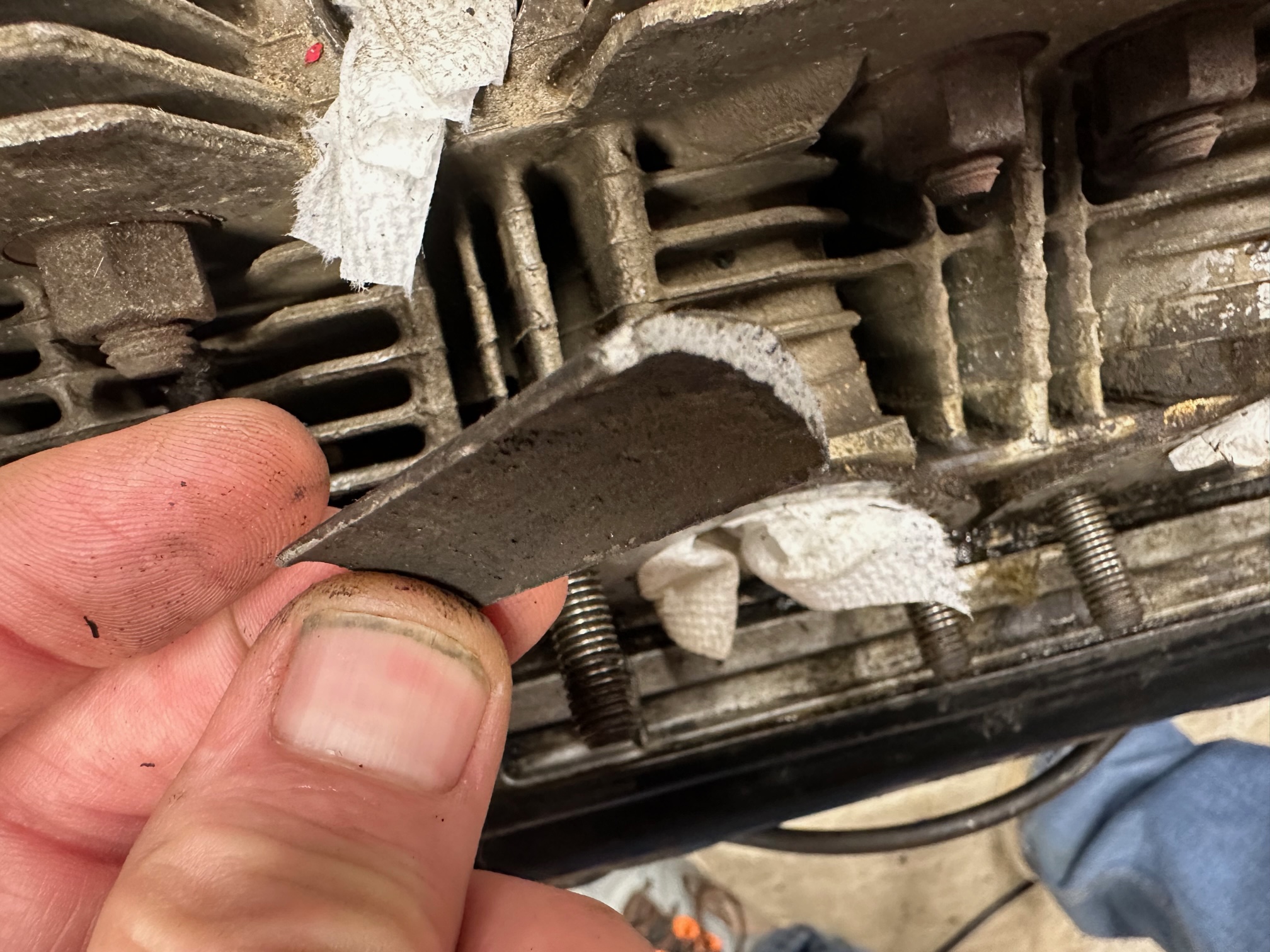

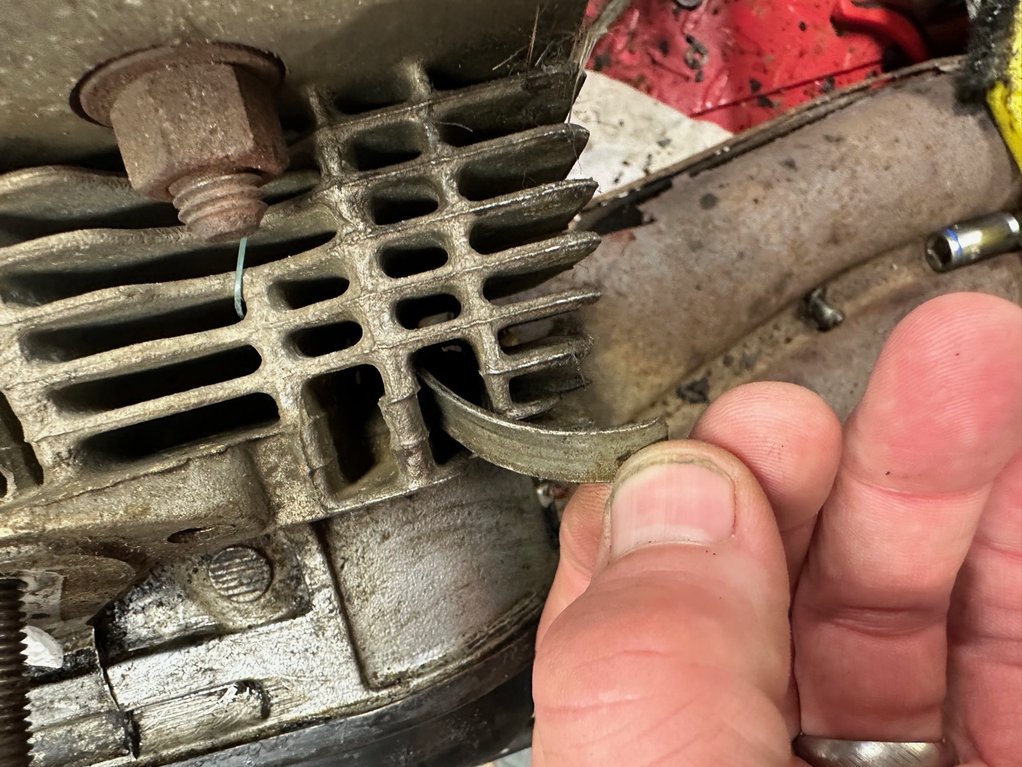

I found two oddities when tearing down my 1.7 today- a piece of curved sheet metal tucked in between some fins on the head of cylinder 3, and a broken piece of casting around cylinder 4. Any idea what they are?

QUOTE(DRPHIL914 @ Aug 7 2023, 08:20 PM) *
here is the current state of affairs
it shows the new relay with the 3 wires on the power in post of the stock solenoid,
1. big black battery cable +
2.
one wire from the ford solenoid, ans the one from the harness that is gray and red, comes in from the harness, i think it goes to the alternator ?

QUOTE(vintagethunder @ Aug 7 2023, 05:22 PM) *
maybe a fin off the cooling fan

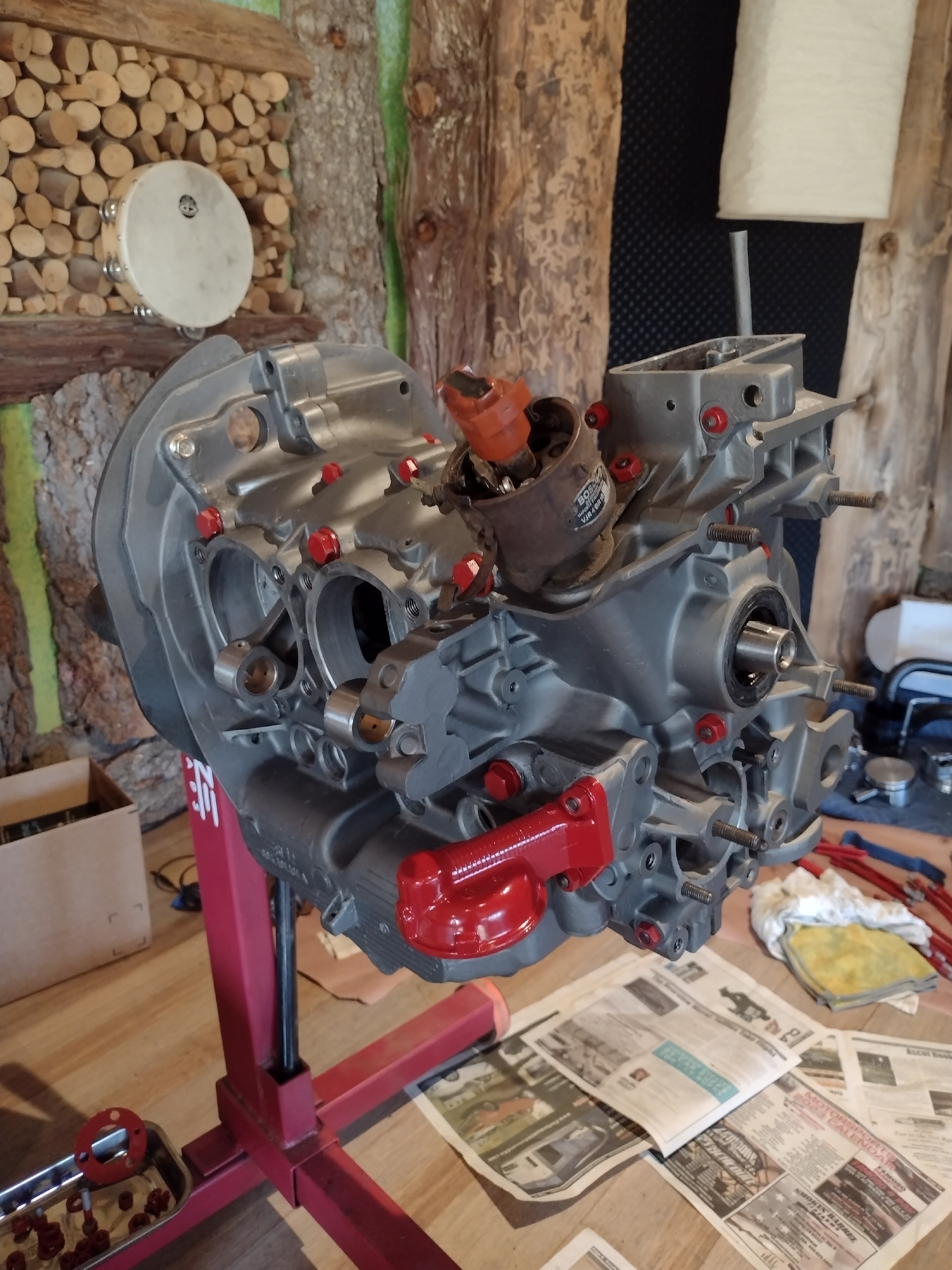

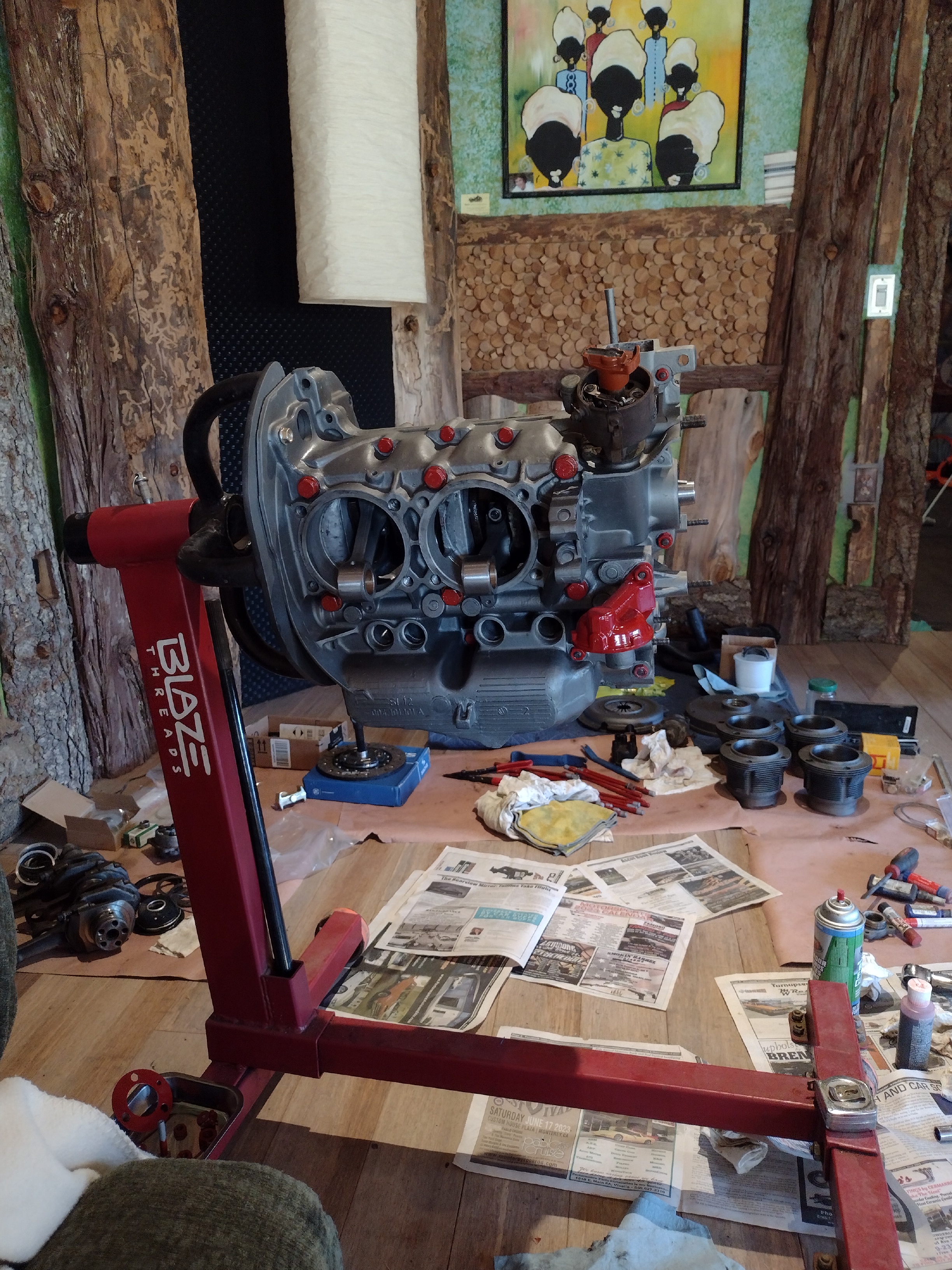

Bolted together my case! (IMG:style_emoticons/default/piratenanner.gif)

QUOTE(cassmcentee @ Aug 8 2023, 05:28 PM) *
@cassmcentee
Did you paint your case or is that a thermal transfer coating?

QUOTE(cassmcentee @ Aug 8 2023, 07:27 PM) *
I hope that is tape over the oil cooler seal holes and not epoxy......

Yes, That's the Cerakote Transfer Gray... some tape is still on there!
Good eye
