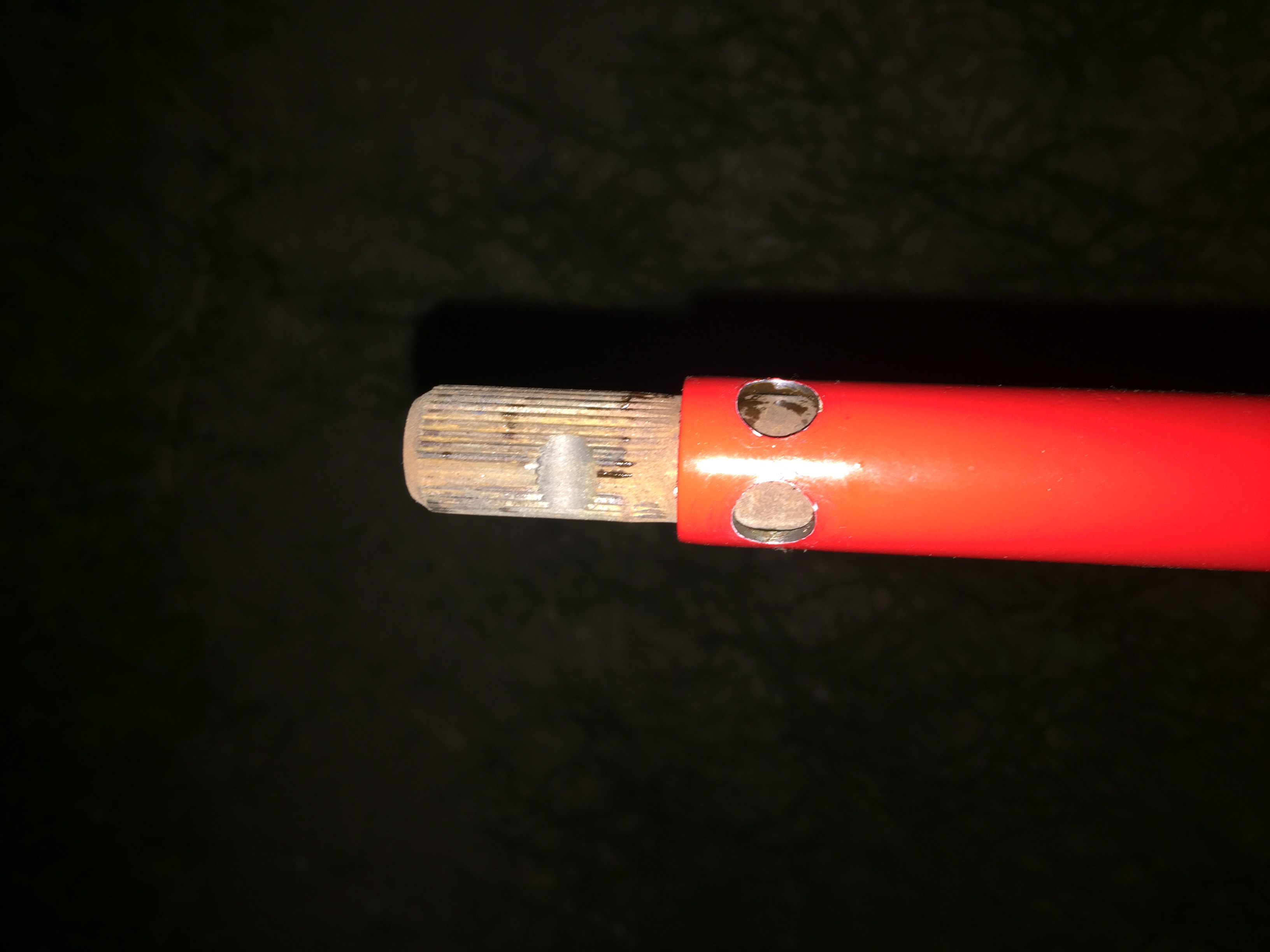

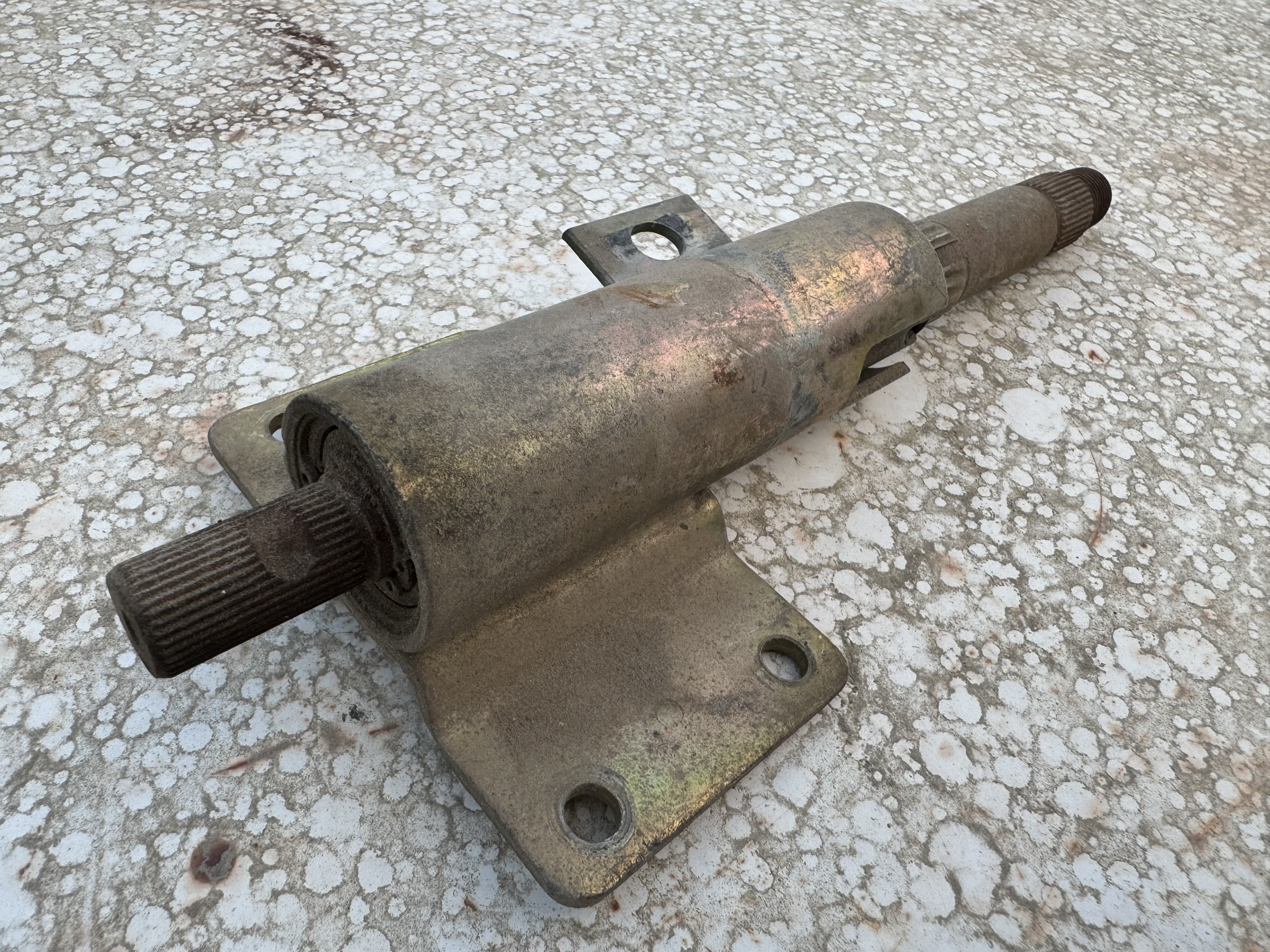

Finished the shifter mods, time to move to the next step. Drilled out the old piece tonight and I’ll weld in this new end tomorrow that will accept a steering shaft u-joint.

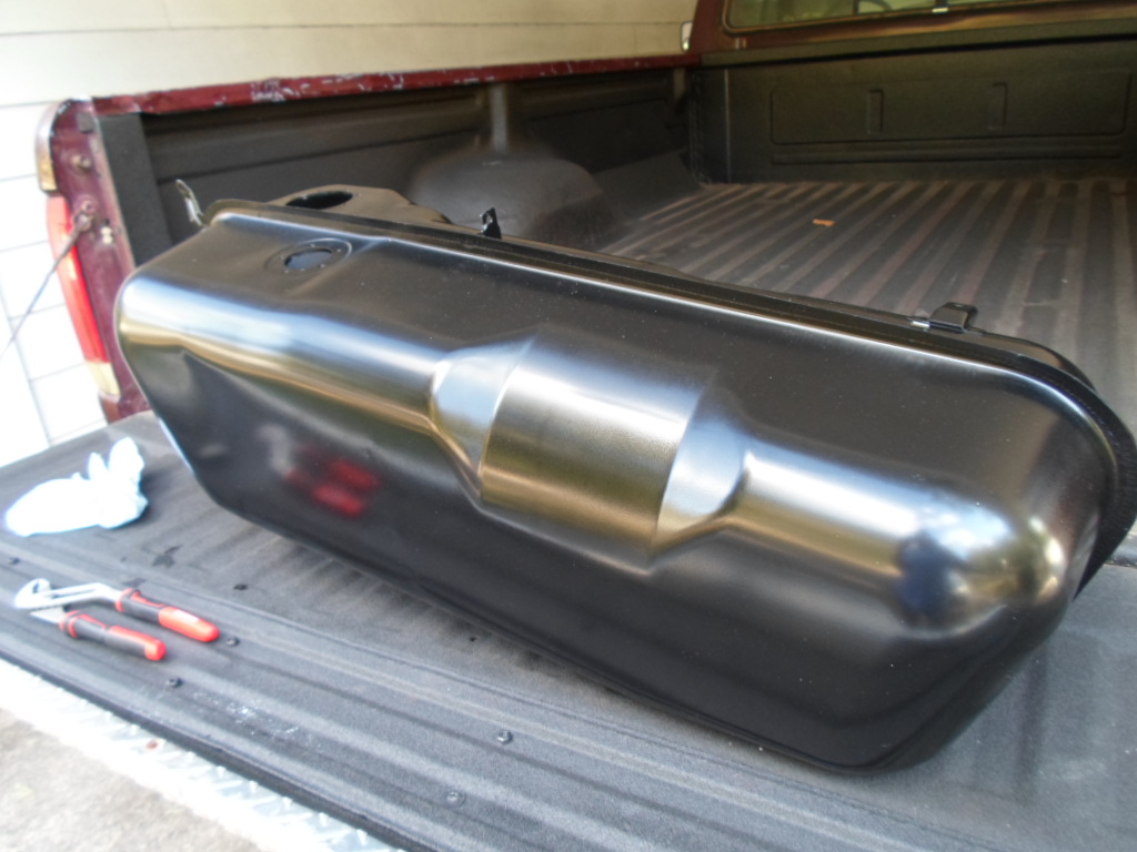

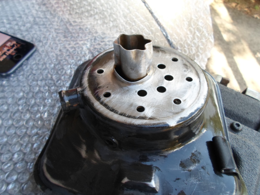

The guy at the radiator shop said it would cost $350-$400 to clean and seal my old tank, so bought a new one and had it shipped x-country....total cost tax, tag, title.... $250. Got it today. Of course it came with 2 bent tabs which I had to bend back.
Also started working on getting the rust and debris off the old filler neck. Hope to finish tomorrow and get it into primer.

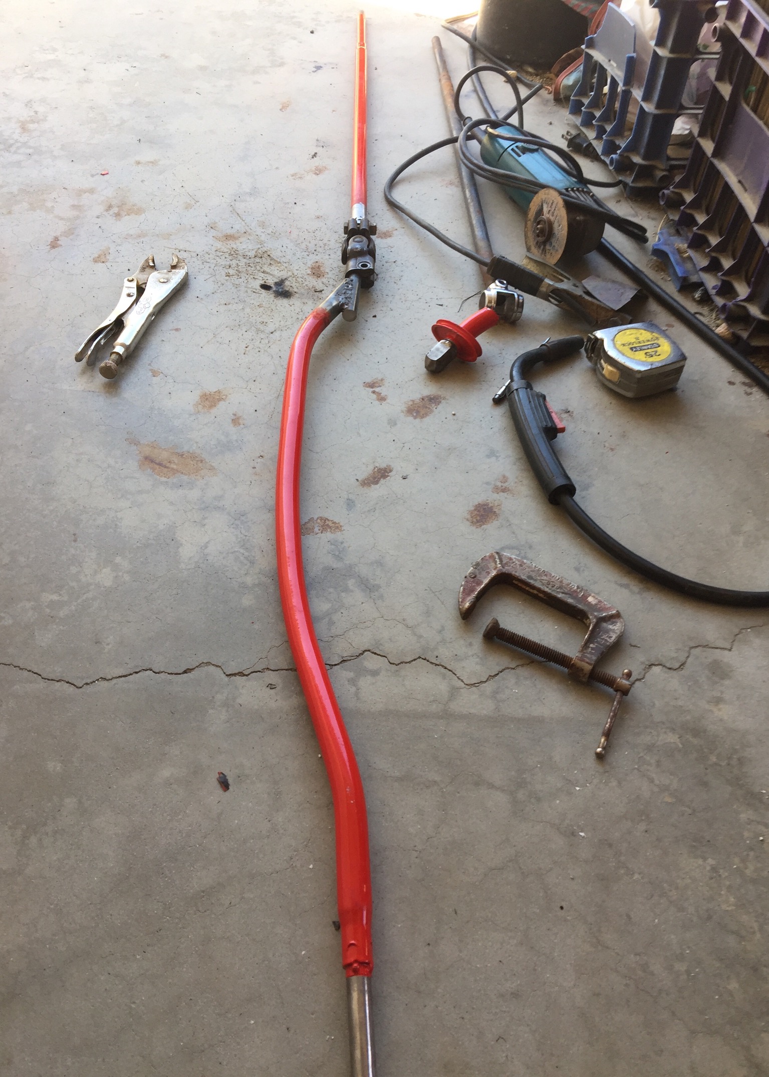

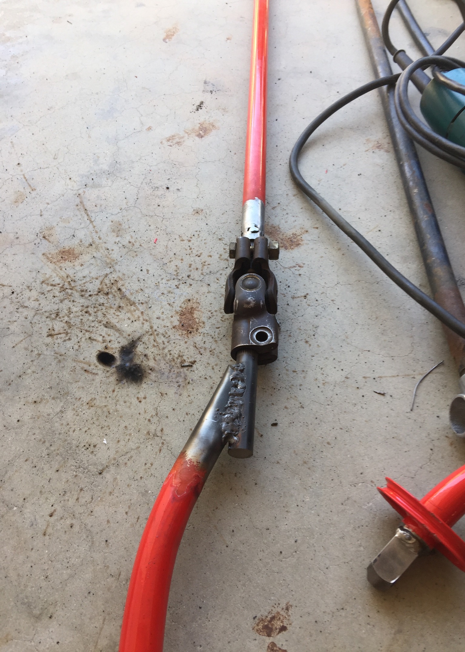

And done. Moving on to the next step

Why didn't you just weld the splined end into the shift rod? The U-Joint will bend, and everything will still work great.

I took all the stock parts and laid them on the ground and marked where everything was from the factory
Beginning of the rods, end of the rods, curves of the rod. I then laid out the project parts on the drawings on the ground with the ujoint in place. To get the best angle on the ujoint and keep the rods in place, That was how I did it. I had no car with a sideshift bar and trans to fit to, so I had to keep everything in its place. As well as I could anyway. Plan is to make my shift console with a seperate rod and add a second ujoint, but it will be long enough to run it stock if I change my mind. That console shaft will not be cheap.
@DRPHIL914
Well, I'm at a point where if I can't make it, fix it or modify it to work, I will find a used one good enough to fix. I've had over 40 years to dream up stuff to do to this car. Saw my first mid-engine buggy long ago and the first thing I noticed was the linkage.
A true tail shift owner. lol
Thank goodness I have most of the parts to remedy that.

You will find the seam on that new tank sits up too high for the retainer strap to fit properly. test fit the little plastic retainer first by grinding that seam down by half.

Thanks for the heads up. I'll test fit it in a couple days and see what I need to do. I rather be grinding before I put gas in it. Seems like they should have foreseen that issue.

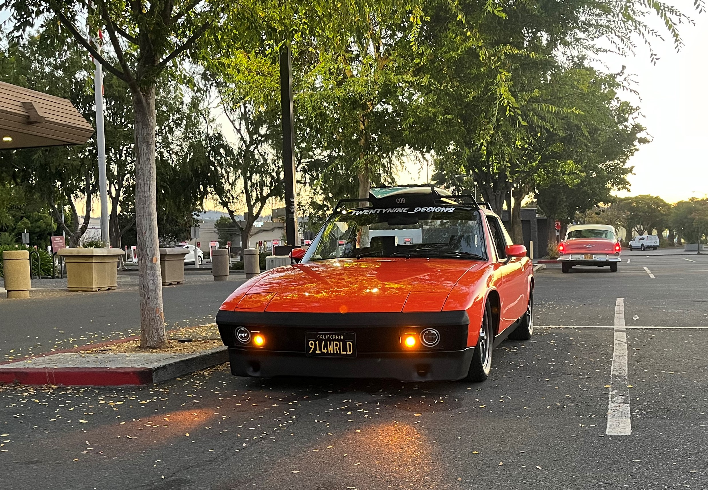

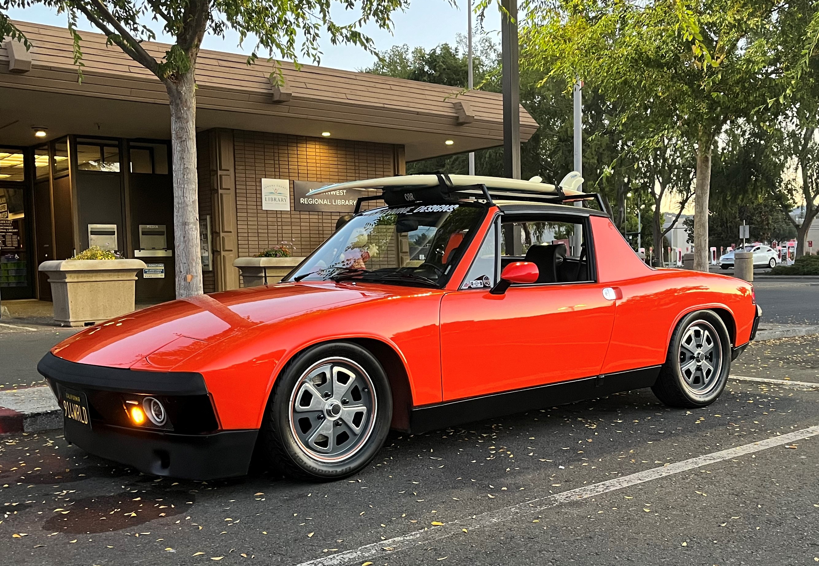

Early AM Santa Rosa Cars and Coffee.

That is very pretty... (IMG:style_emoticons/default/beerchug.gif)

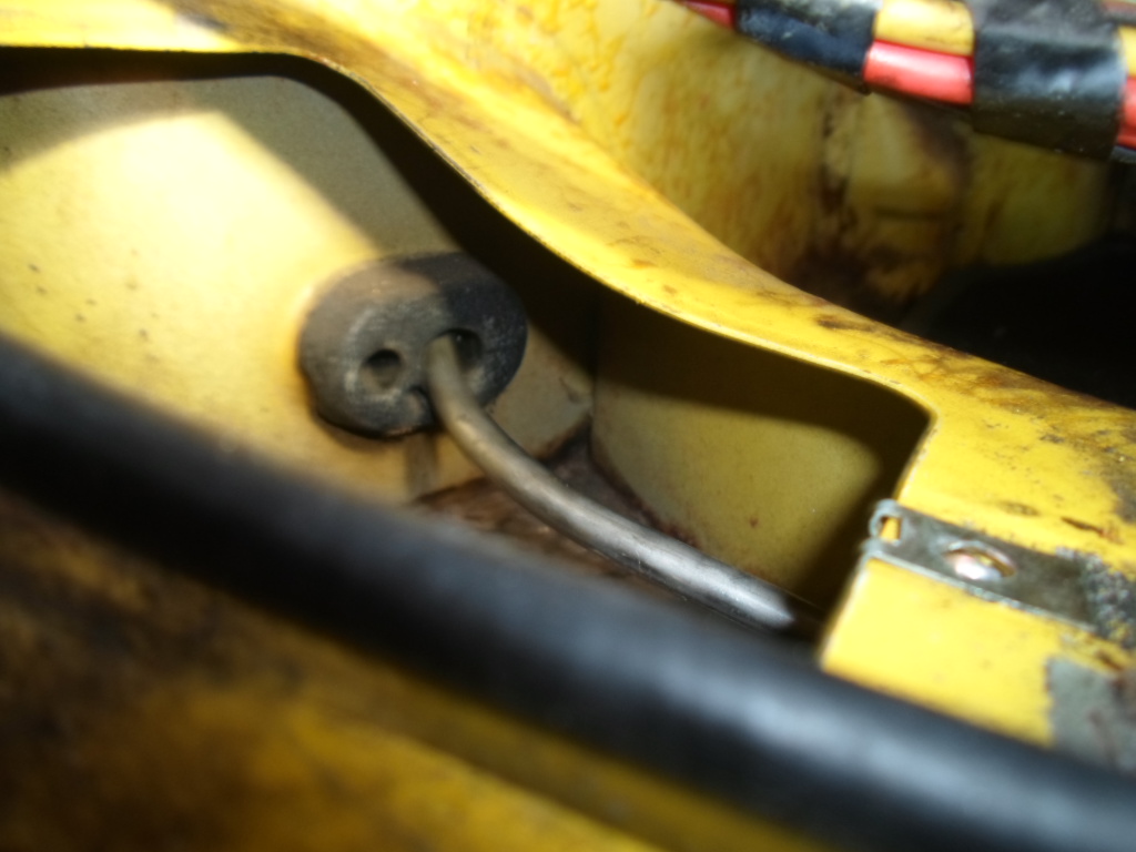

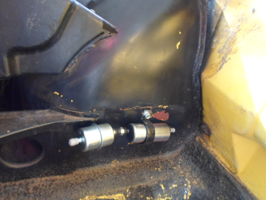

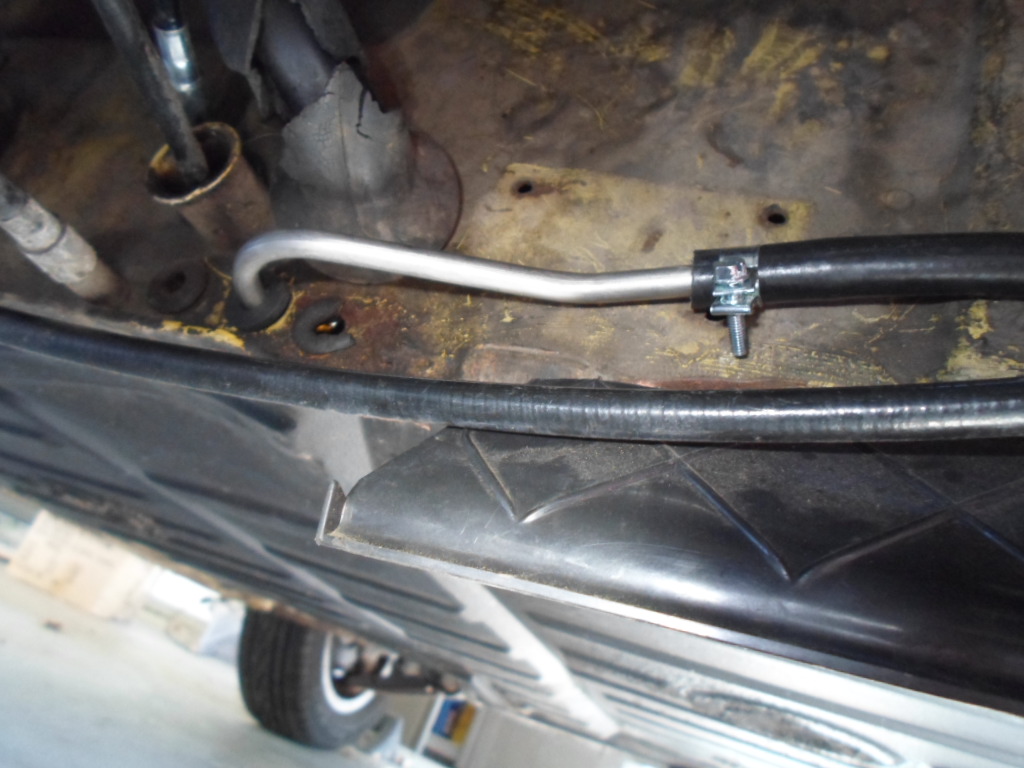

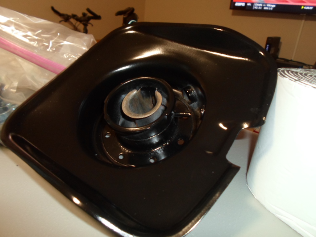

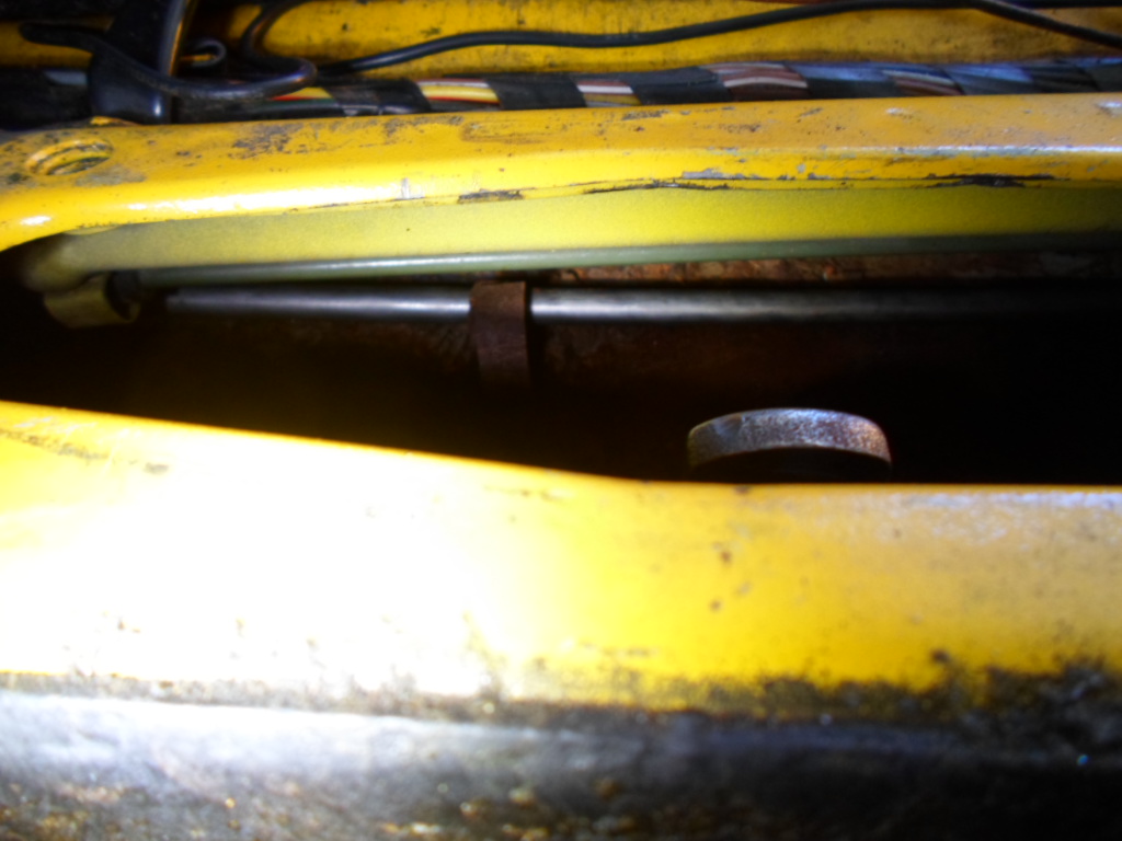

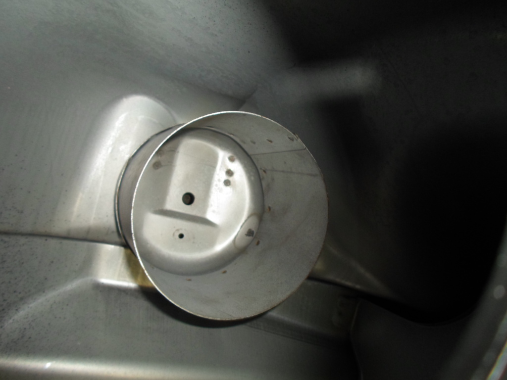

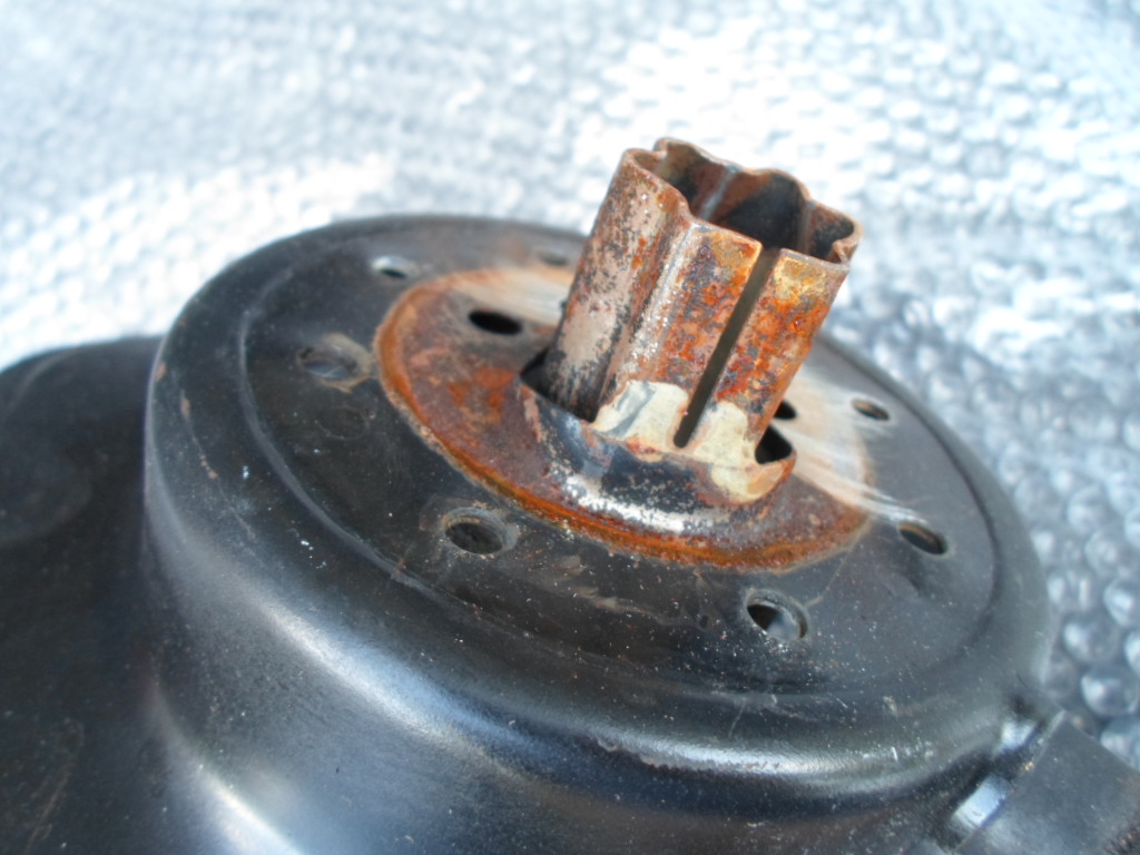

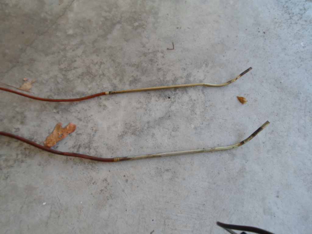

Finished painting the filler neck...
Removed old plastic lines & fuel pump....
Installed Tangerine's SS line...I have carbs so I'm only installing the supply...
Mocked up new location for new filter & pump...

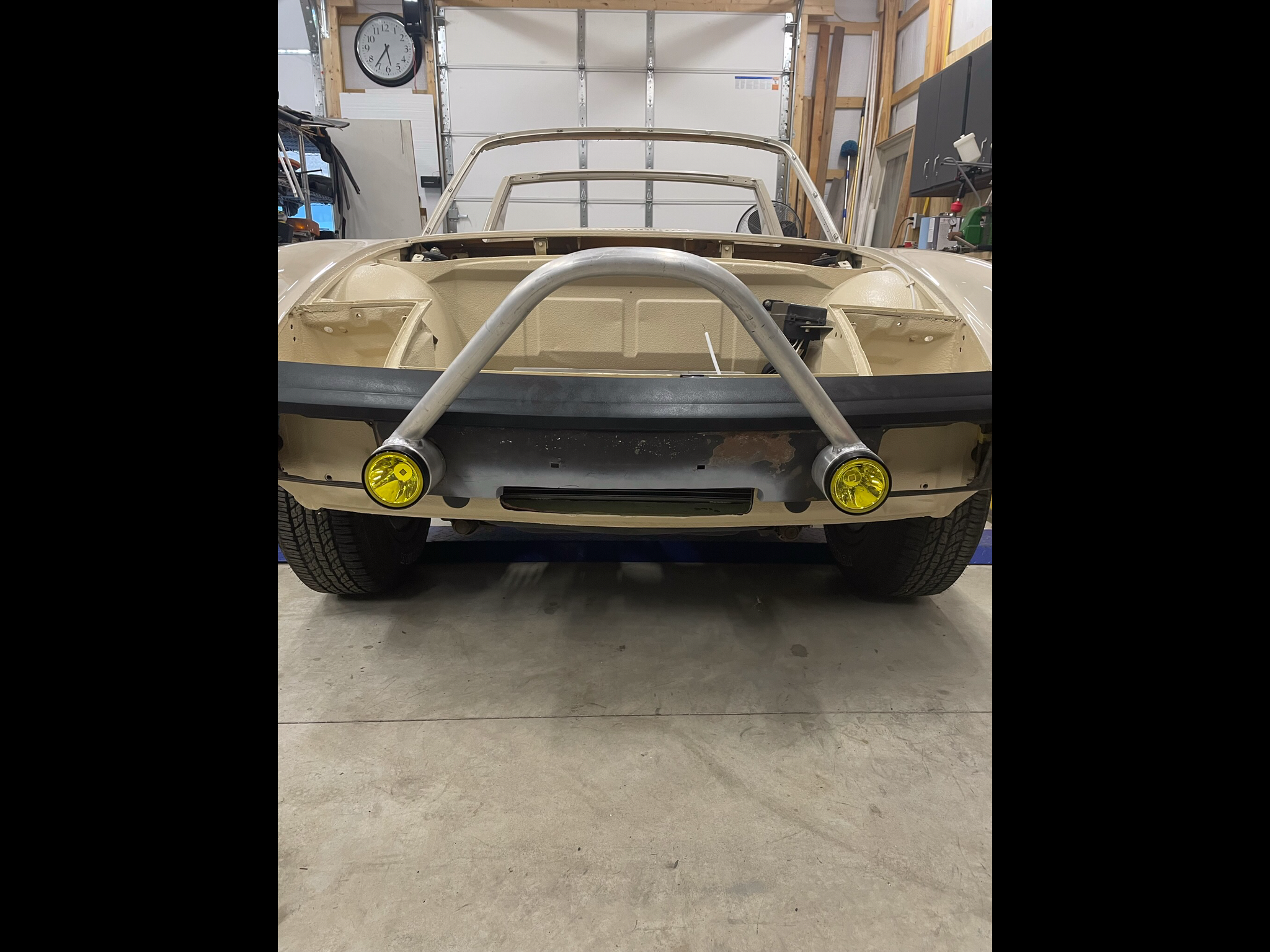

Mounted my driving lights into my Safari bar today and added Duetch connectors for tying into my lighting harness. The lights mount with a 6mm countersink screw on each side, so you don’t really even see the mounting screws.

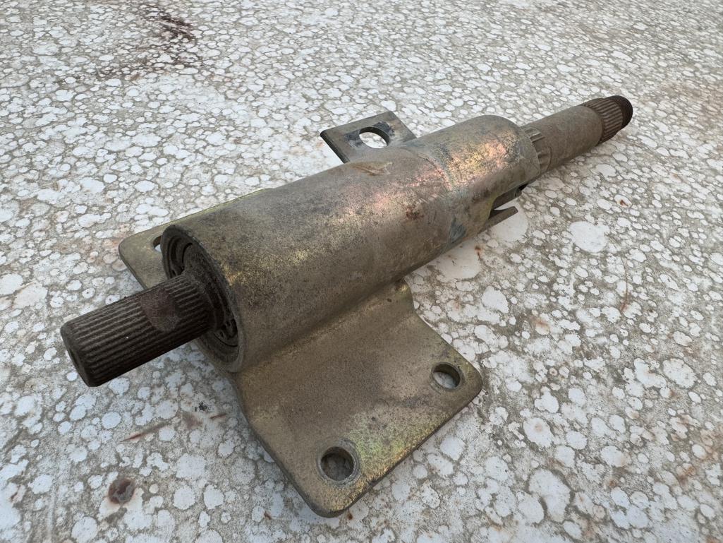

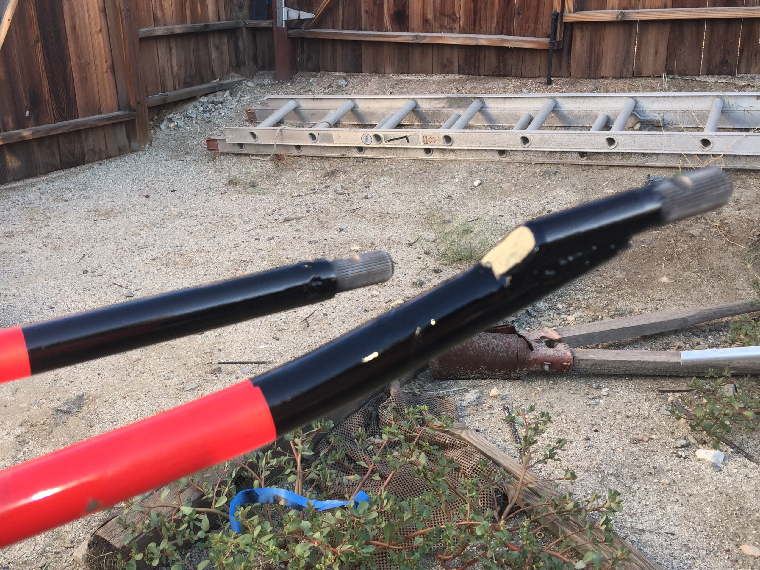

Looking through a parts box and found the short shaft I need to do a side shift console mod. Even has the right end on it for the u joint. So it just needs to be turned down and drilled for the cone screw…when I know where that needs to be drilled.

@mikey63 did you make your own ski rack/surf rack?

Dr. Phil, I did make it.
