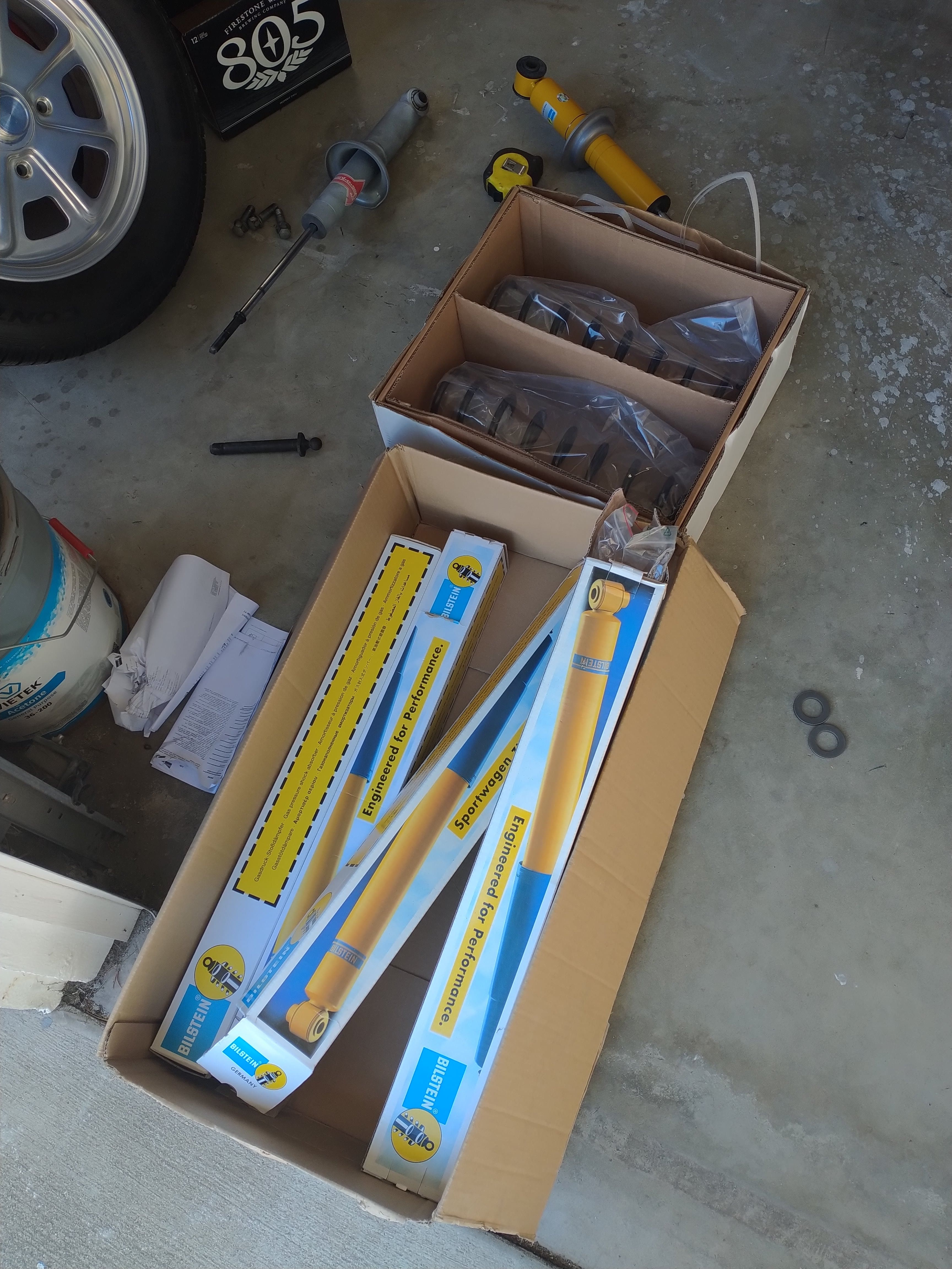

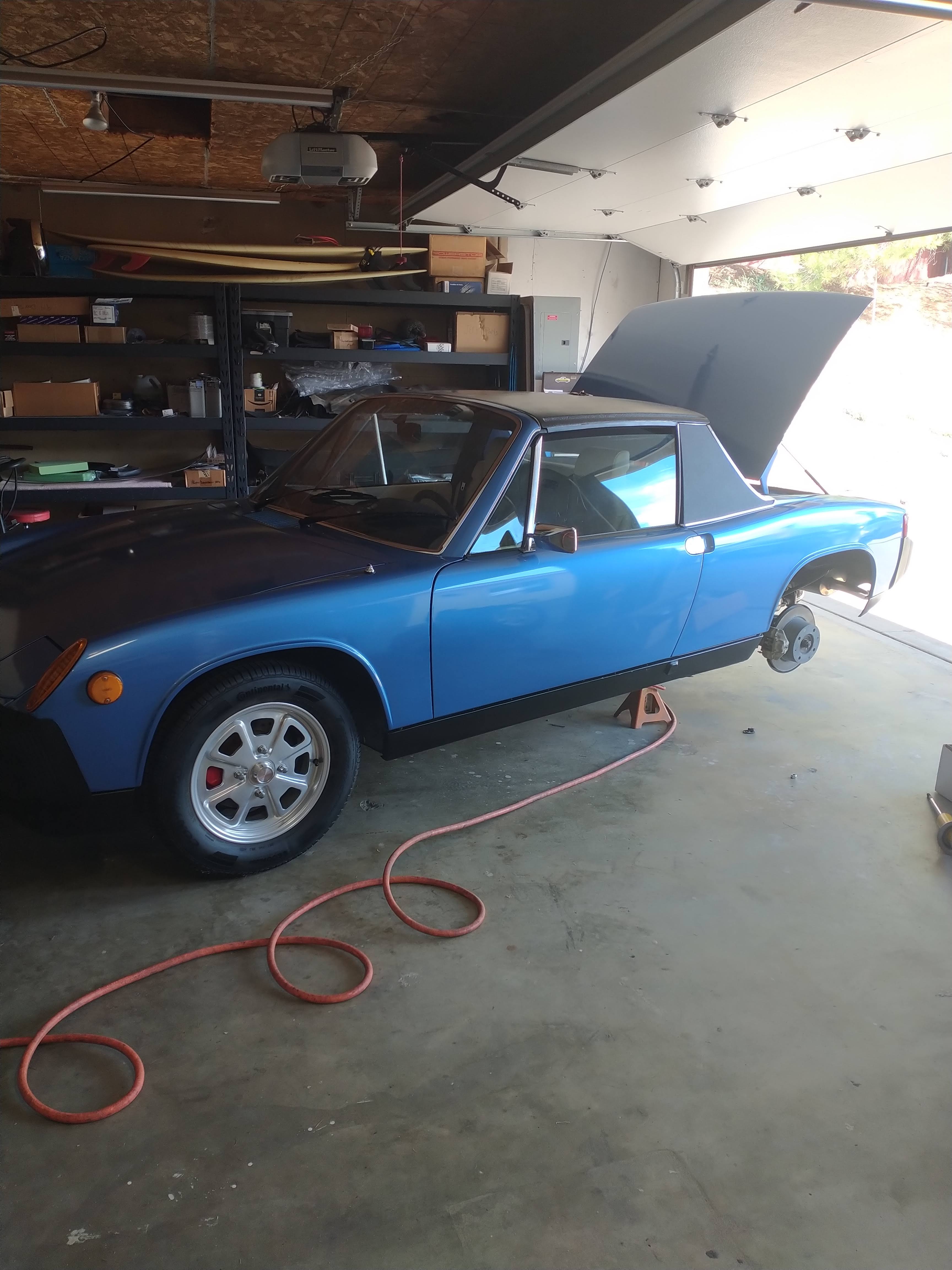

Installed new Bilstien's all around and pulled out the KYBs. (you really get what you pay for) Should make a substantial ride difference. Also replaced the rear springs with new ones from 914rubber.
My 17 year old daughter actually did all the work, while being instructed how to do things by my son-in-law and myself.
Spent pretty much all day and we had a great time!

Did you get 100 lb. or the 140/160 springs? You will be happy with the Bilstein's.

I got the 100lbs springs. I put the same setup in my 74 and really like it so I'm hoping to have the same experience here with the 75.
Excited to get out and drive it. I've only put on a few miles on the car since the rebuild.

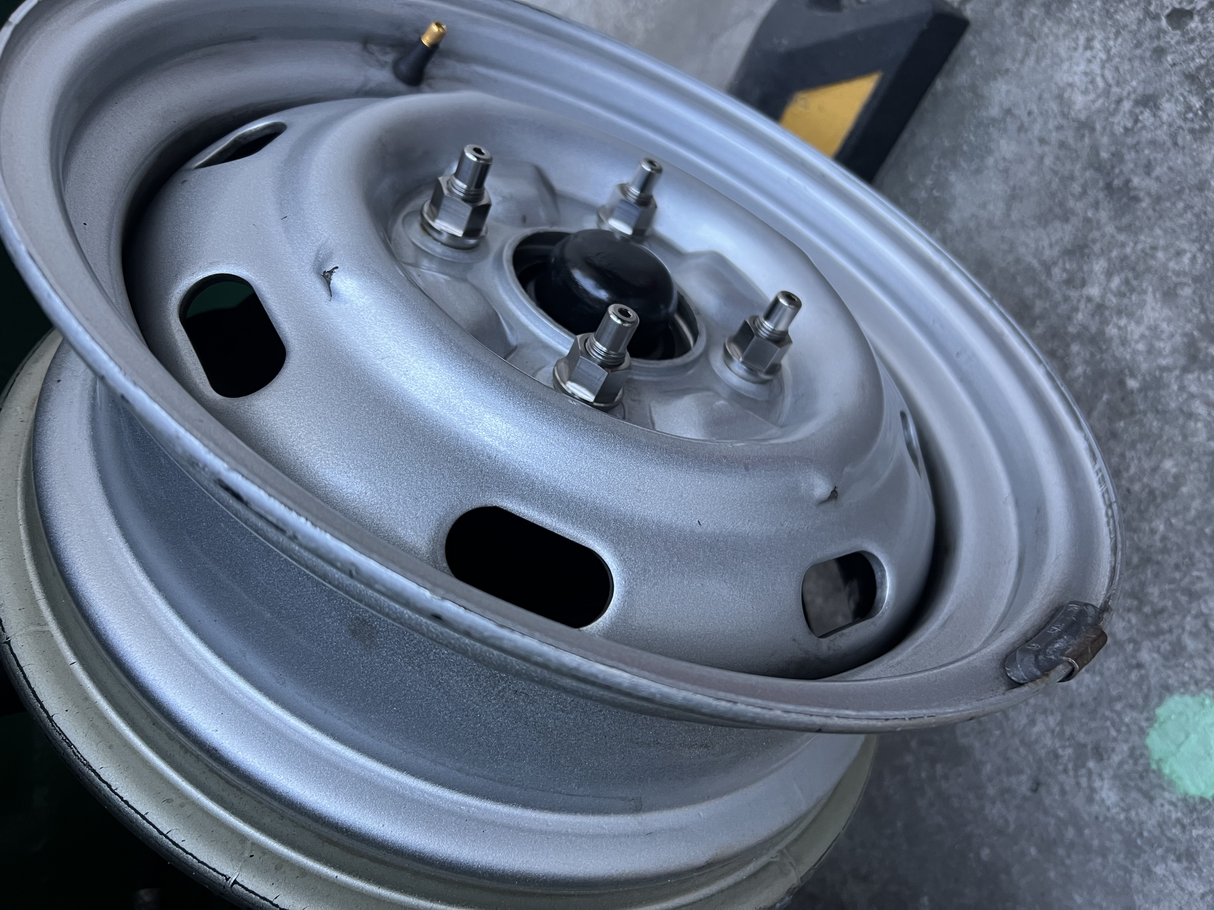

Test fitted some spacers in the front, titanium nut and bolt, in preparation for my new wheels.

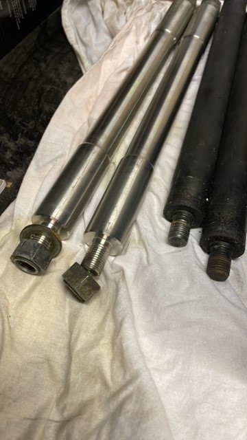

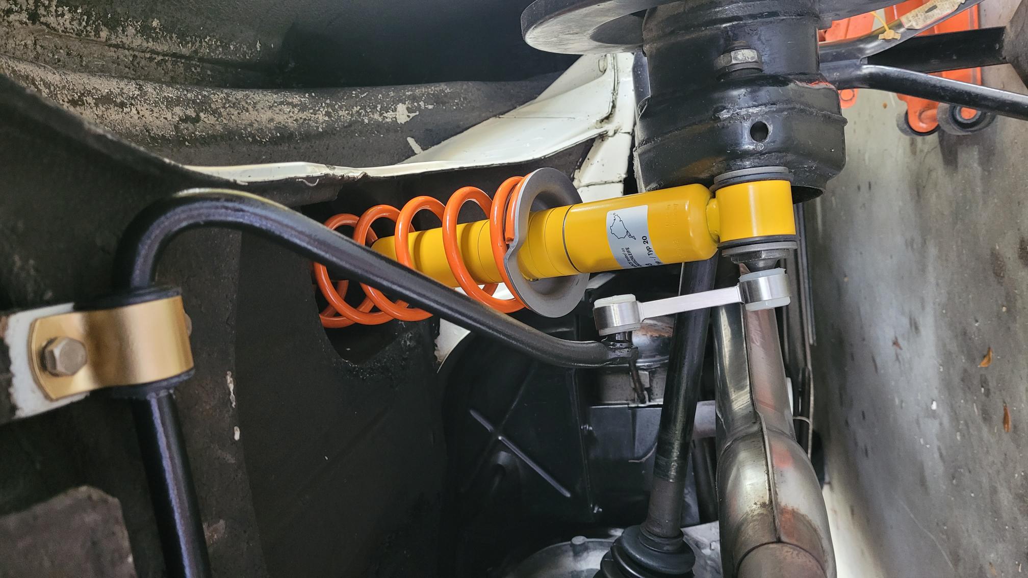

Replaced the rear Bilsteins. 25 years old and shot. Lost a sway bar link on the test ride (bushing was shot, but I thought it would still be OK). Had my machine shop at work make replacements out of stainless. Replaced the bushings. Did drill a small hole in the back of the bushings to aid install. Great tip from the forum here.Attached Image

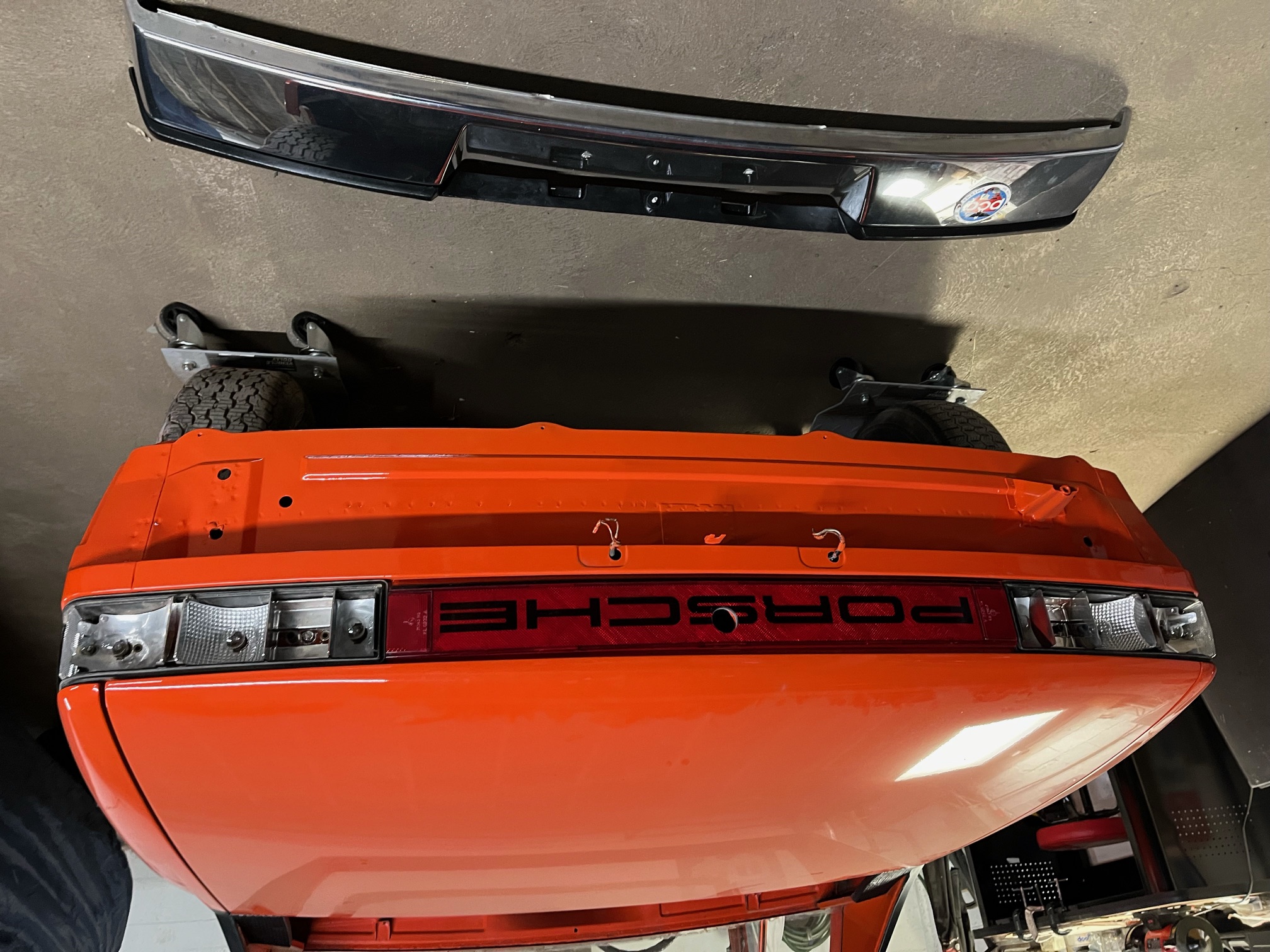

Re-assembly underway after Tangerine respray!

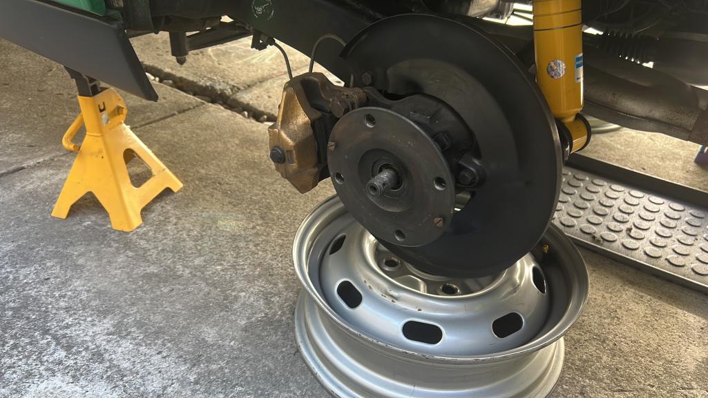

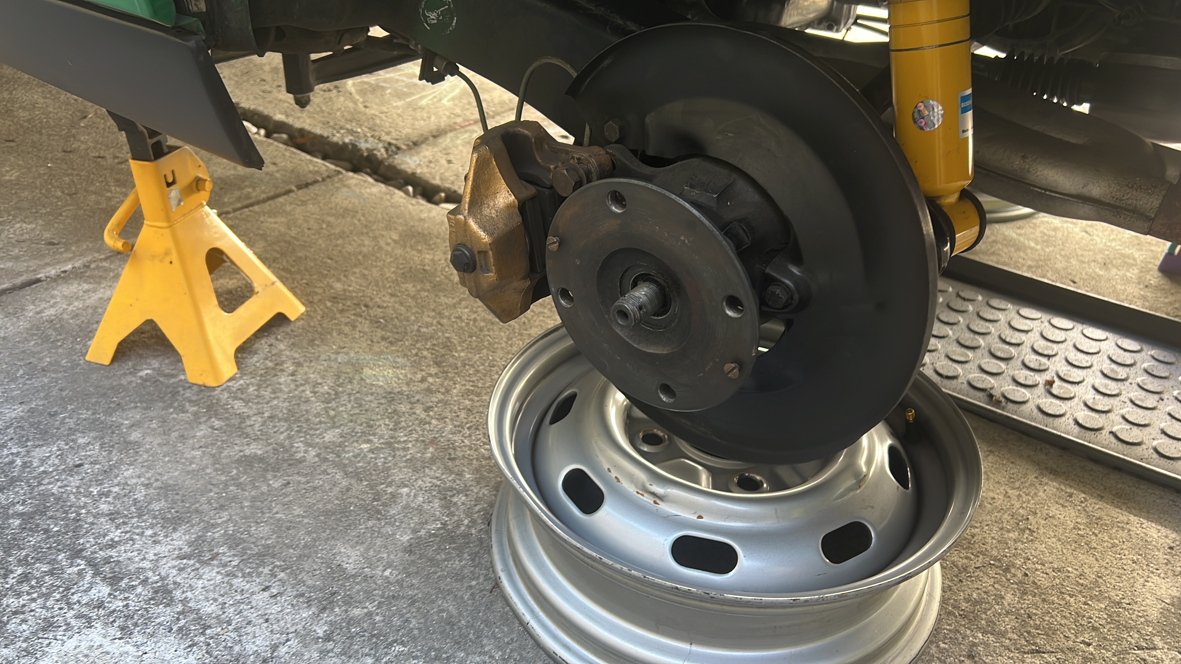

Tomorrow will be a tricky day, I will try to remove the rear hubs, in my garage, to send them to PMB, for a refurb and 5 lug reconfig.
Wish me luck. (IMG:style_emoticons/default/screwy.gif)
Good things coming

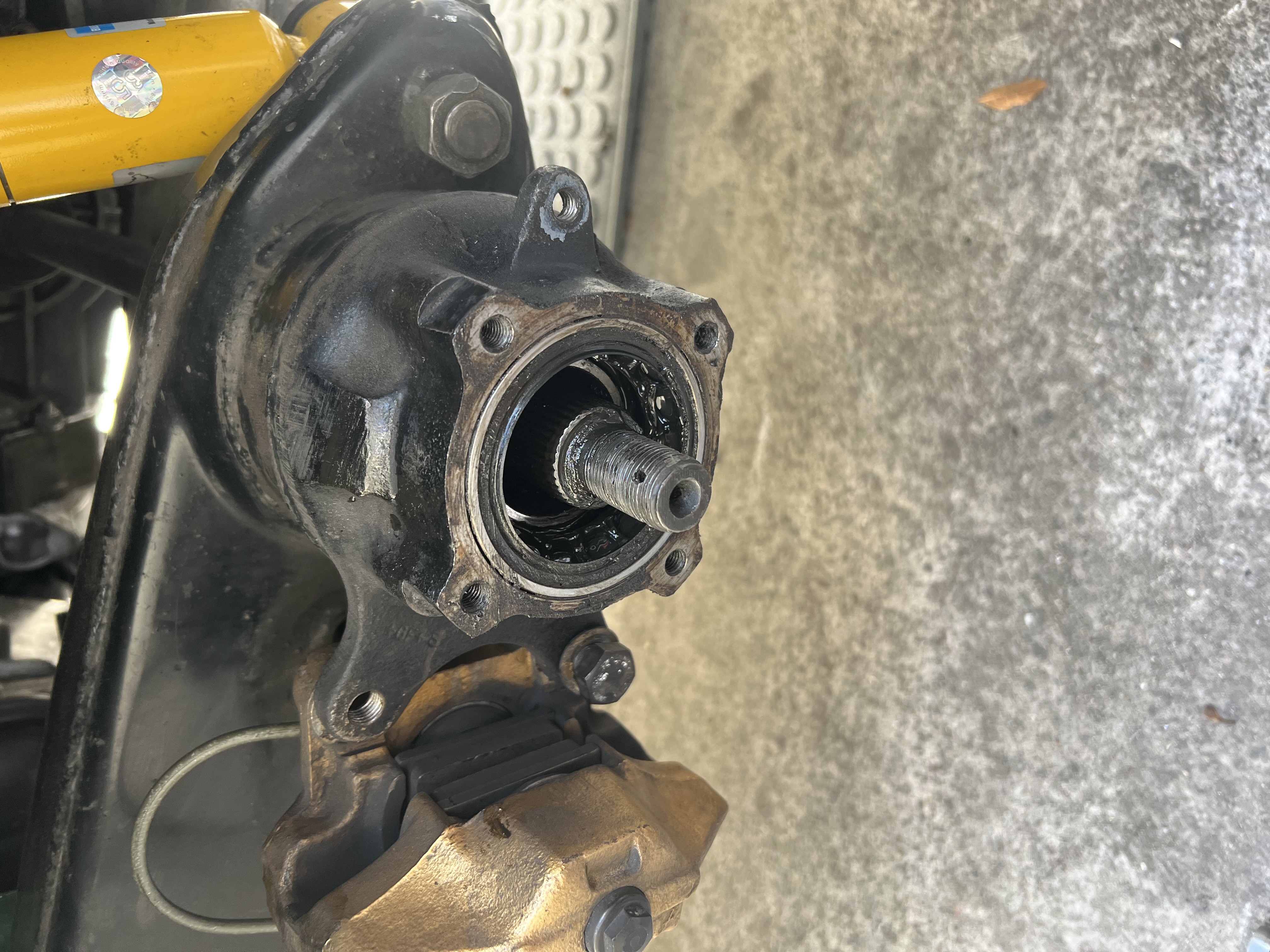

Miserable fail, I was only able to do one… the other side was too much for me.
And the bearing is still in. (IMG:style_emoticons/default/headbang.gif)

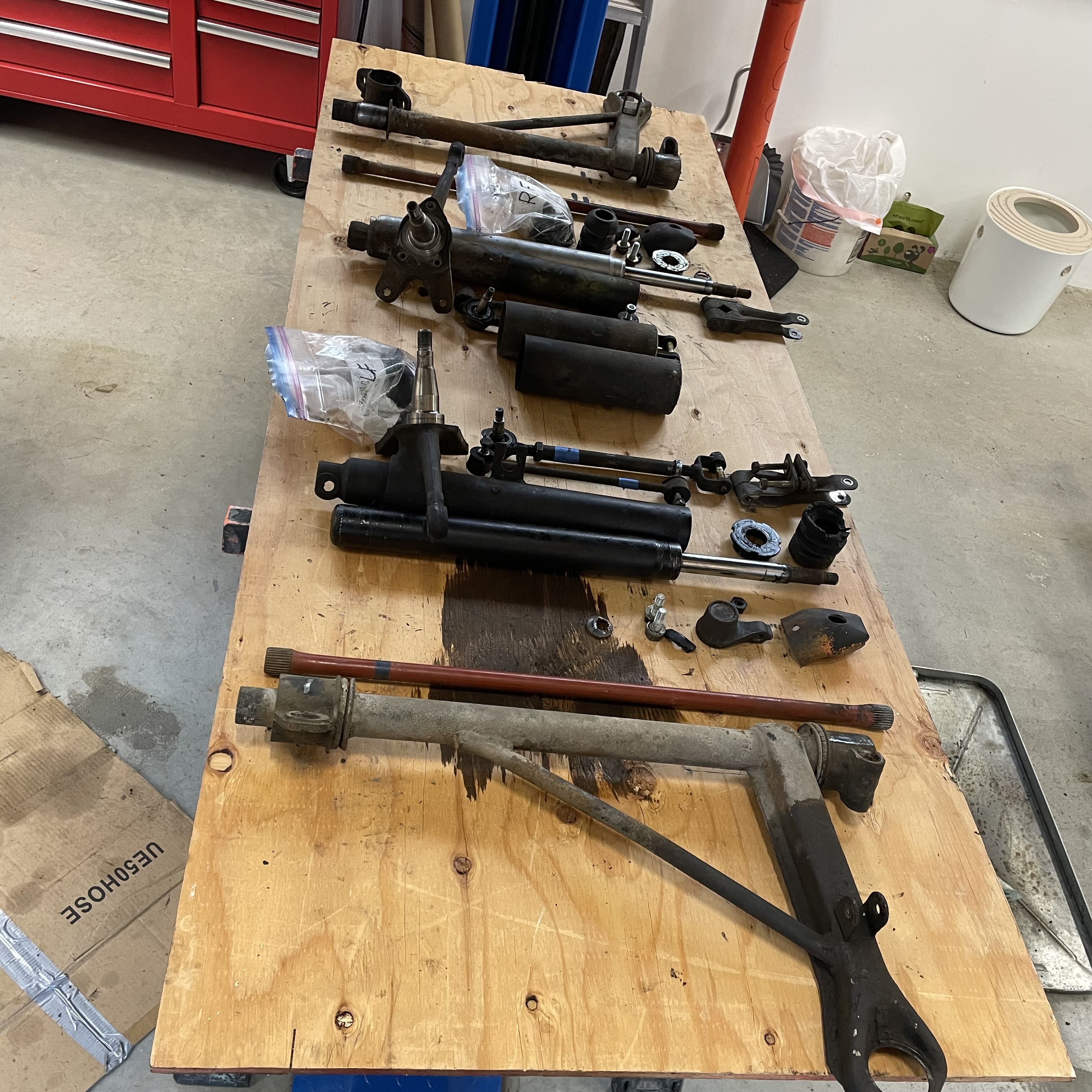

Front suspension is pulled! Fought with the torsion bars and had to learn what a pickle fork is (for the tie rods) but the rest went pretty well.
Debating whether to pull the rack and do those bearings and the coupler "while I am in there".

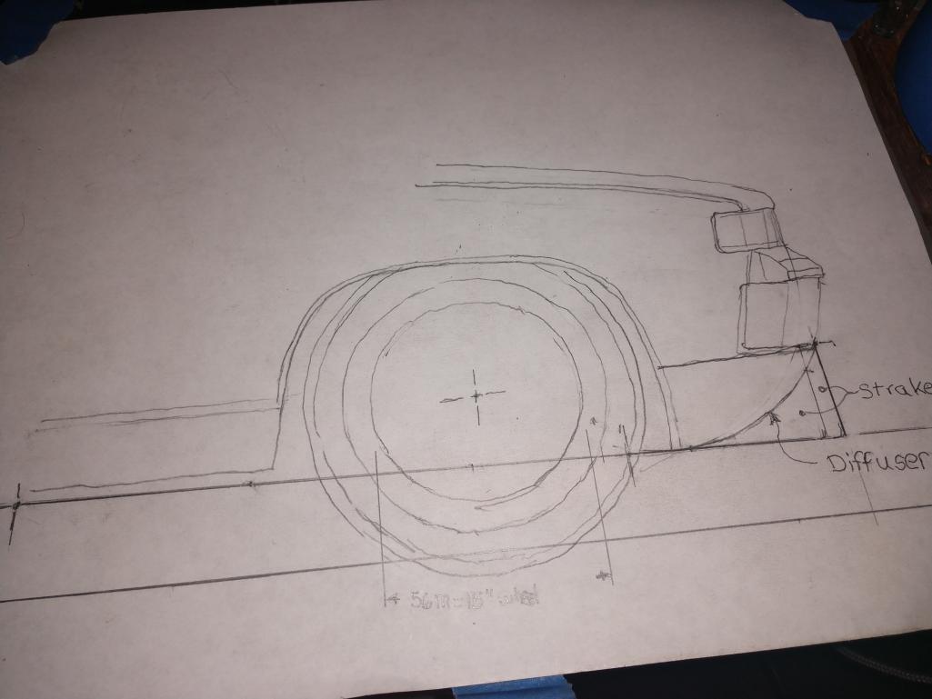

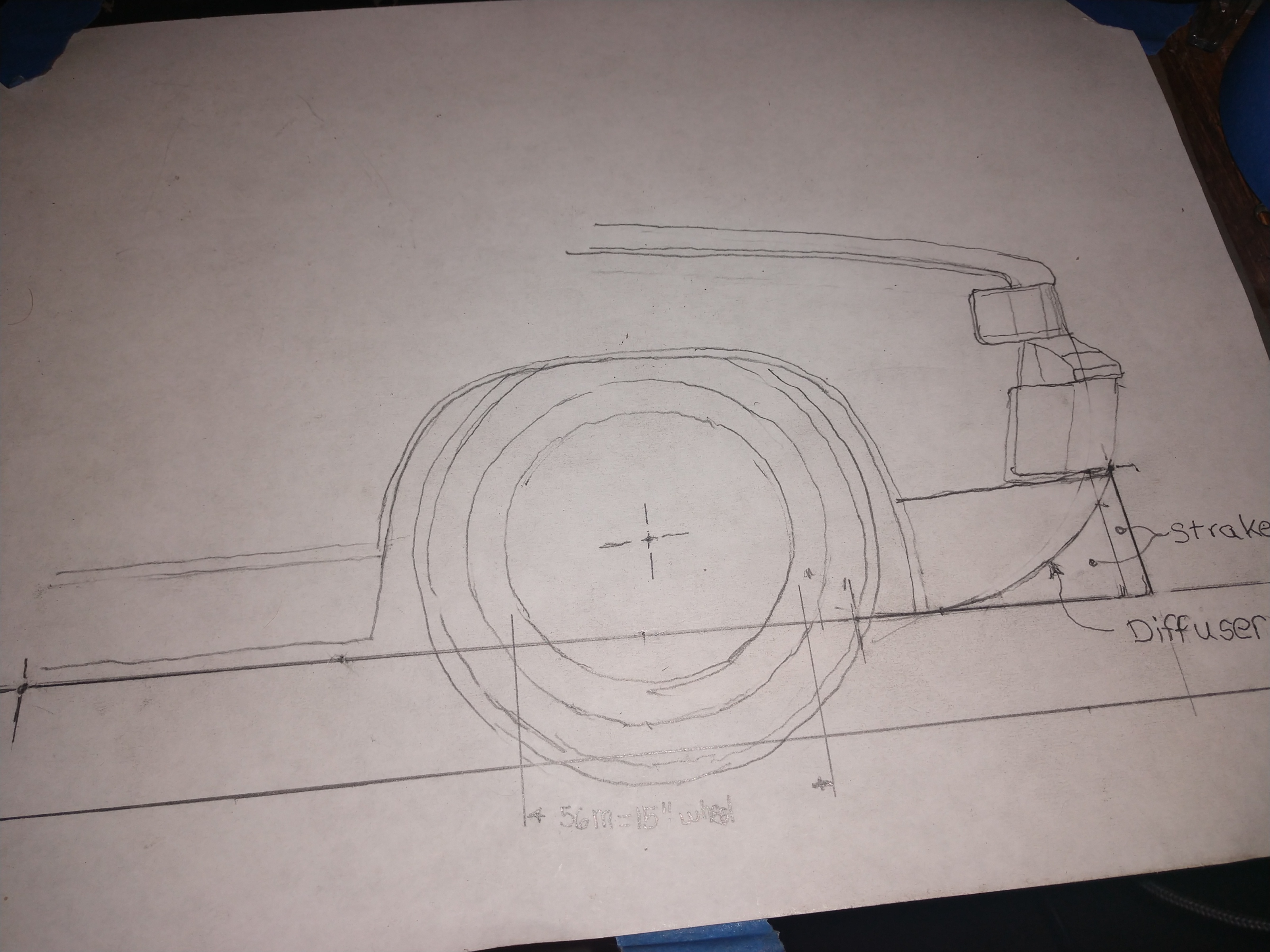

My build thread went over 65,000 viewers today and I started planning the fabrication of my diffuser. I try to practice the KISS system but that doesn't always work for me. Thinking about hanging it from the muffler bracket in the front and the bumper on the rear. Still no idea what's going on behind the rear tires.

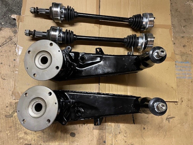

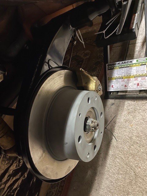

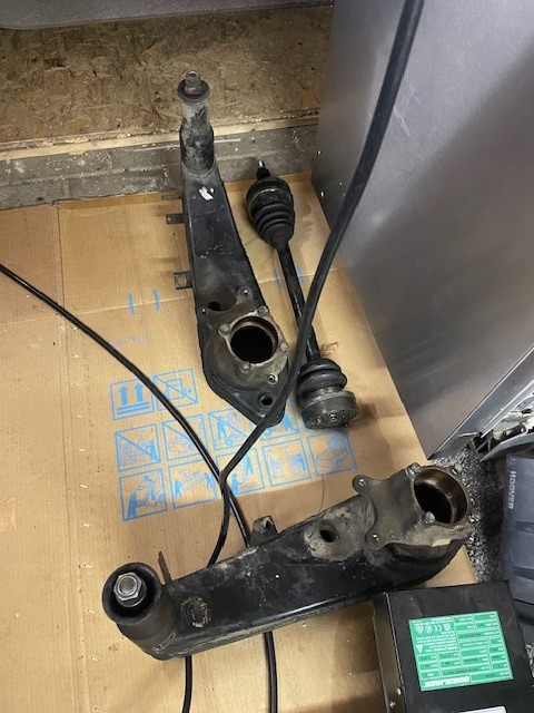

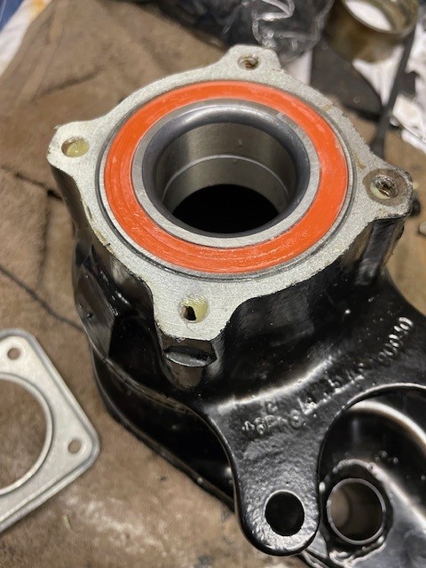

Now it's winter here I took the time to refresh the back end of my 74. Removed the trailing arms and got them stripped, 2K epoxy and repainted. Ofcourse renewed the wheel bearings.
The new pivots and bushes were a pain ... the prekom rubbers are too soft so ended up ordering the 914rubber ones.
Axles were also stripped and repainted. After inspecting my cv joints I found some wear and decided to order and install the kit fm PMB
"while I was in there" I also installed new discs, pads, steel brakehoses and new hardline. Adjusted brake venting clearance. Luckily my calipers are in good conditions and adjusting was easy.
All clean and ready to go.
Next job : new upper and lower bearings in steering column to get rid of the play in the steering wheel

Looks like the work paid off, nice job!

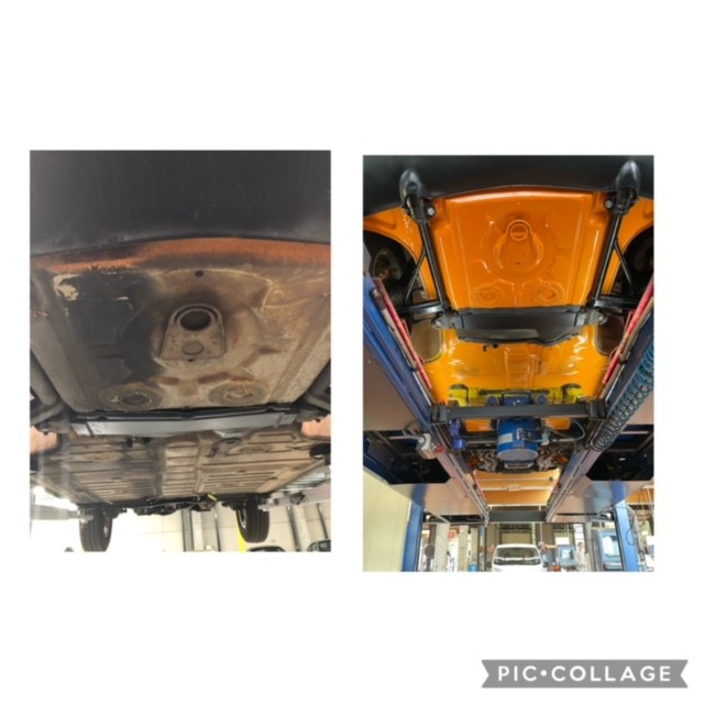

Just found these pictures on my cellphone. Job was done last winter but still surprised how different a clean bottom (IMG:style_emoticons/default/biggrin.gif) can be....
I was lucky to have a car without sealing... it was all dirt, oil and it looked like it was sandblasted after nearly 50 years on the road. Cleaned, degreased, 2k epoxy on and new paint. This was done "while I was in there" (refreshed A arms with new bushings and new paint). I always start with a "little" job but usually end with a lot more ...
