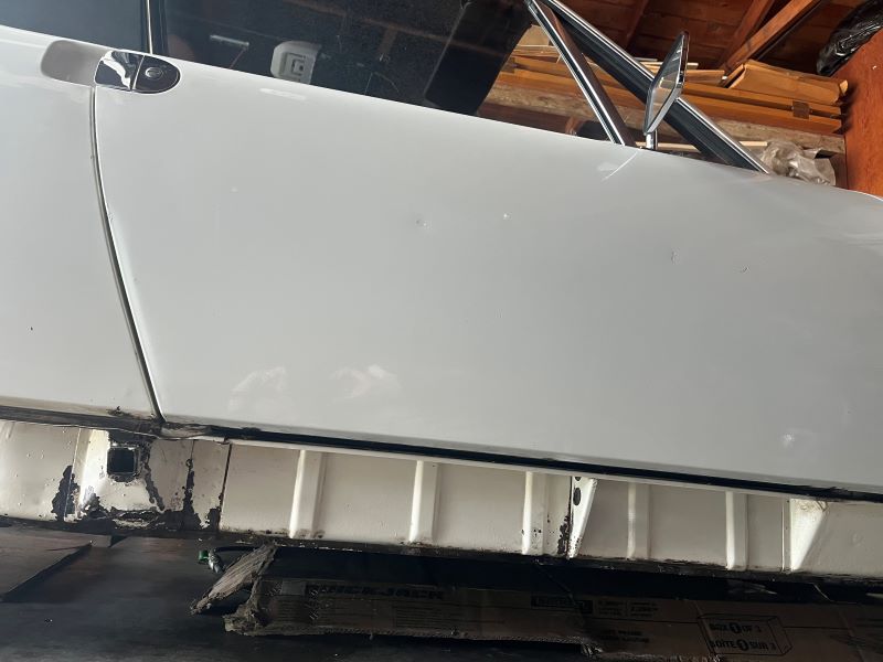

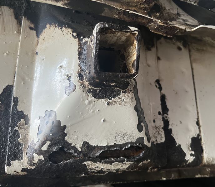

Last week I pulled off the outer rocker panels which were rusted and dinged up as well as full of dried mud, sand etc. Today I cleaned everything up so I could get some photos before putting on the new panels. The metal behind the jack plate although rusty is solid (a screw driver does not go through it). The hell hole only has slight surface rust. Hoping I can just treat the metal and put the panels back on. Is that wishful thinking?Attached Image Attached Image

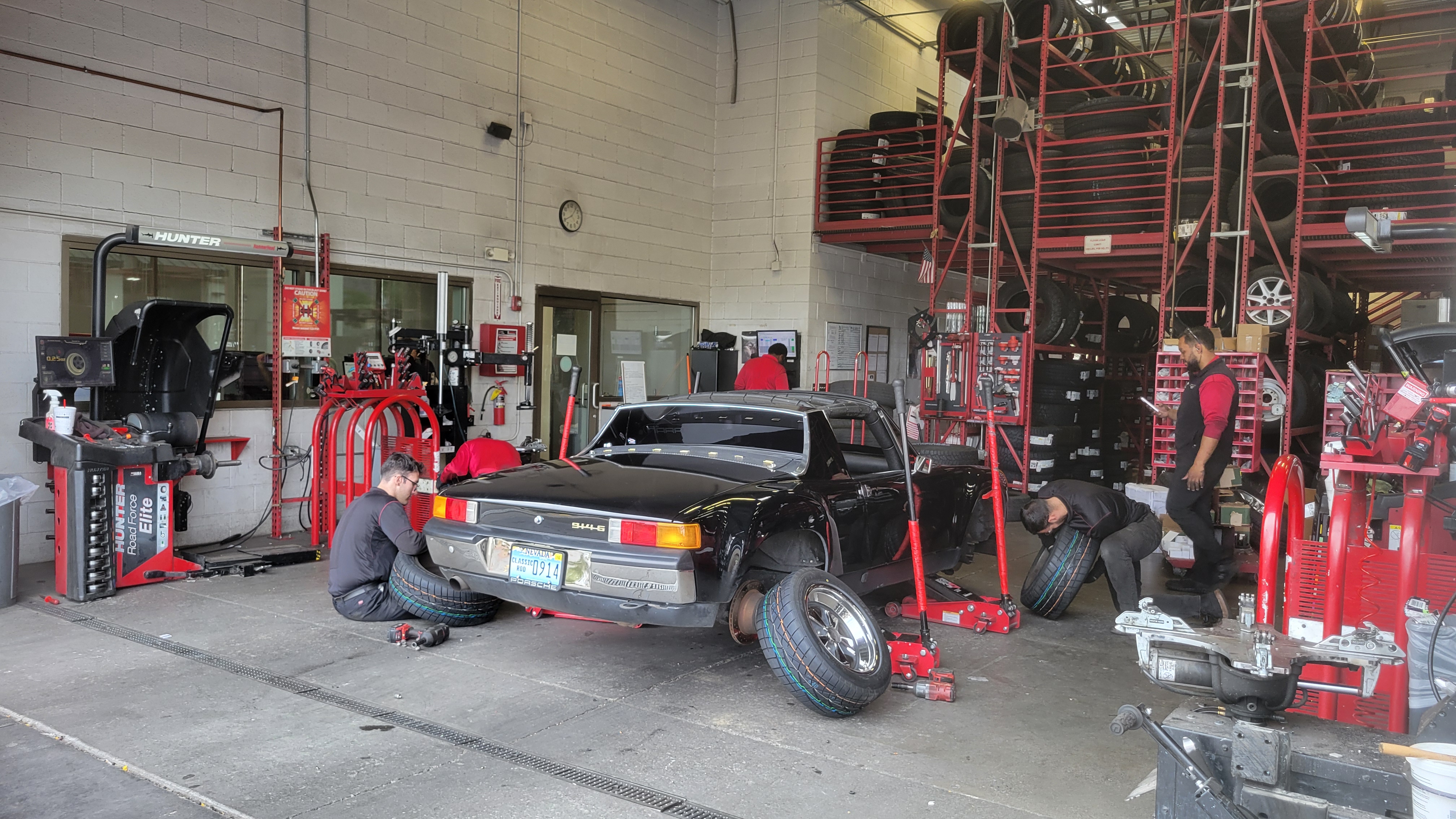

Took advice from @bkrantz and replaced all four tires. (IMG:style_emoticons/default/biggrin.gif)

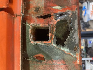

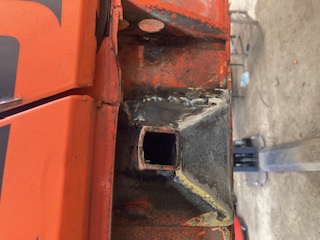

Worked for me

I would at least patch the lower part as they rot out when the drain holes get blocked in that area but be aware they rust from the inside out ,cheers.

You let the tire monkeys at Discount tire touch Elvira?!?!?!

Trust me. I supervised them every step of the way.

(IMG:style_emoticons/default/welcome.png) If that's the worst of it you have a winner.

Toyo Proxes R1R.
They have the best wet traction I have found for street legal race tires. YMMV

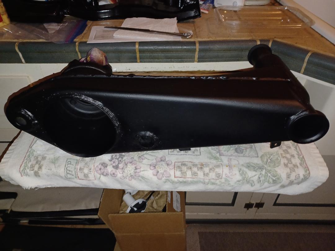

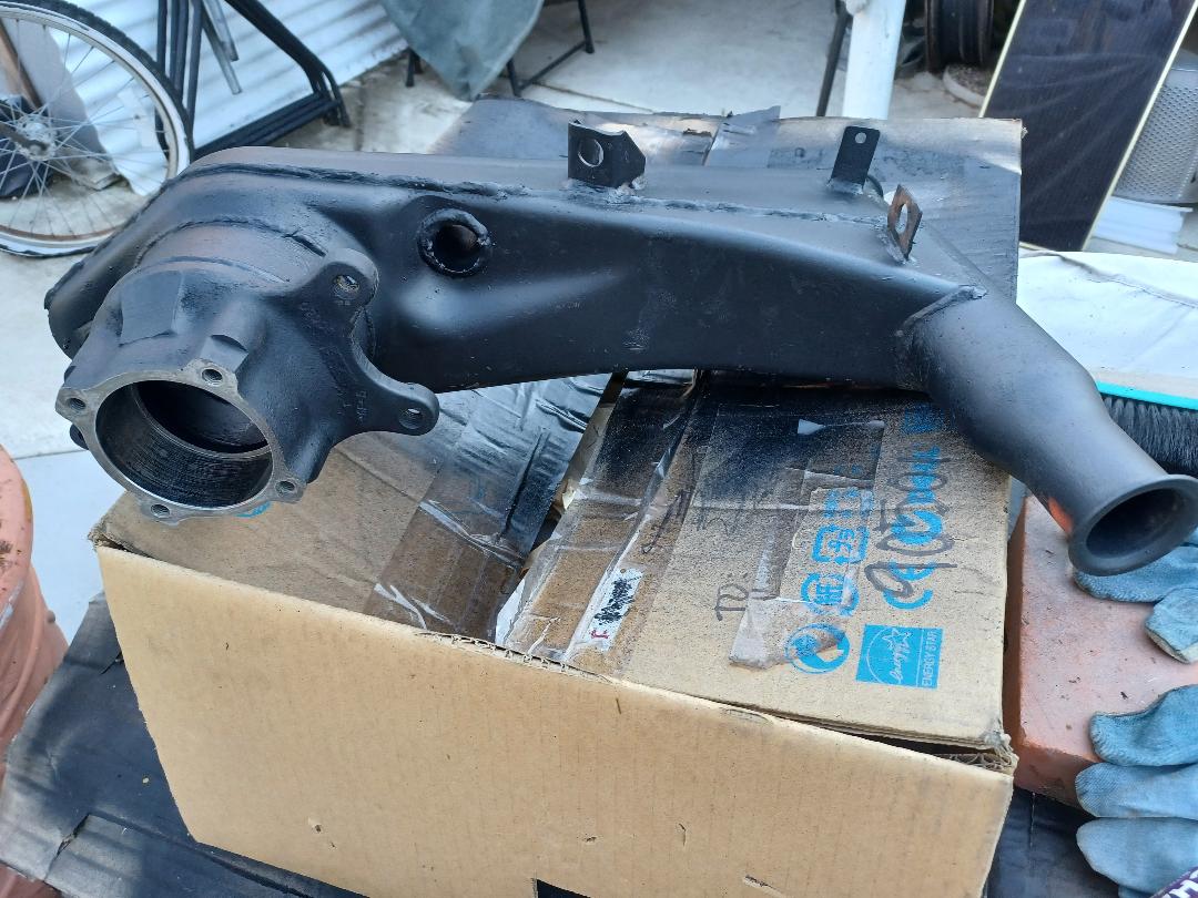

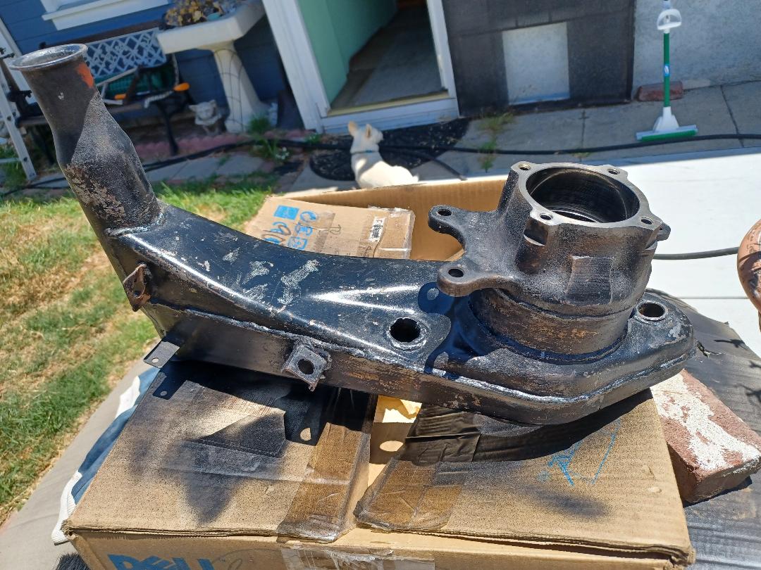

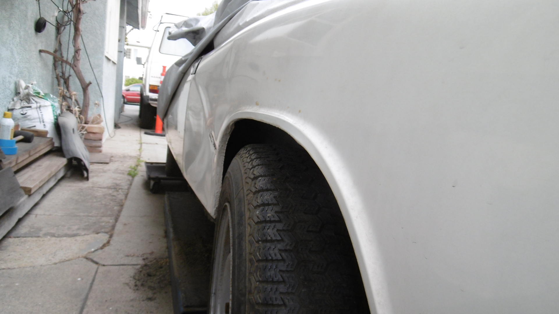

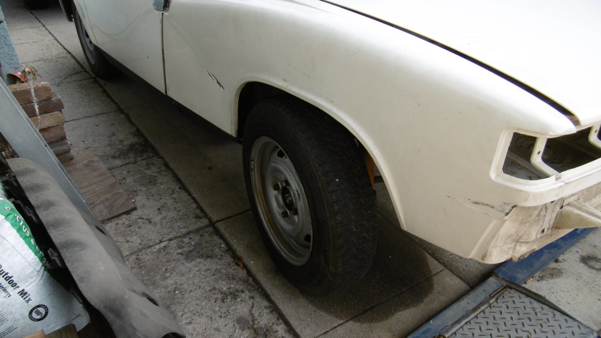

My friend Tommy stopped by and took a peek at HOWARD's issue(s) and said he'd like to tackle it.
I called Bruce Stone and asked if he had a spare L/R trailing arm to replace the 'bent' one, and met up with him at Callas Rennsport a couple days ago.
De-greased it and shot some black primer on it ...
... then we'll jack HOWARD up, remove the bent arm, swap all the necessary parts and install it to see if it cures the issue (IMG:style_emoticons/default/confused24.gif)
