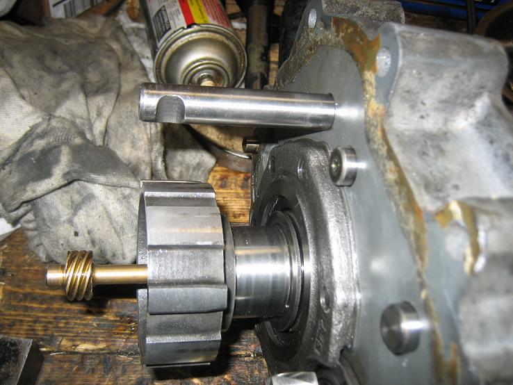

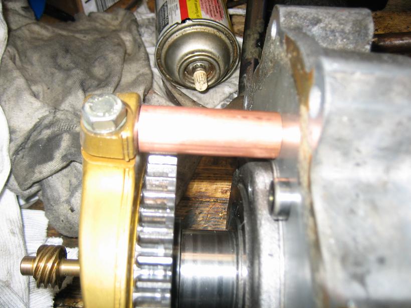

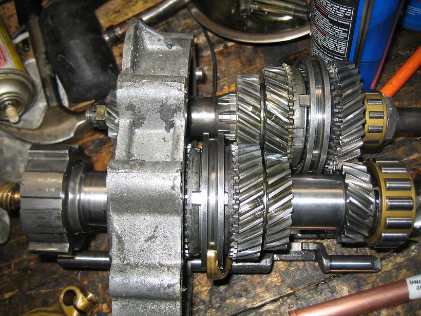

Here is the latest gearbox I am building for someone. It is an F-N-X-HBf box and I wanted to show how easy it is to lock out 1st in a 4 speed box. I have heard that there are people that charge a chunk of change to do the same thing....I think that is wrong as it is way easy. All you need is a rear gasket, tubing cutter and a section of 3/8" copper tubing (1/2" shown as I bought the wrong size).
Here is the FNXHBf stack (Ooo, purdy).
Here is the shift rod end for 1st that needs the sleeve to lock it out. I removed 1st gear completely other than the gear on the input shaft as you need it for reverse.
And here is the section of ~2" copper tubing. You need to keep the slider for revers. It looks like the sleeve will hit the slider, but it is just the angle of the pic. Attached Image

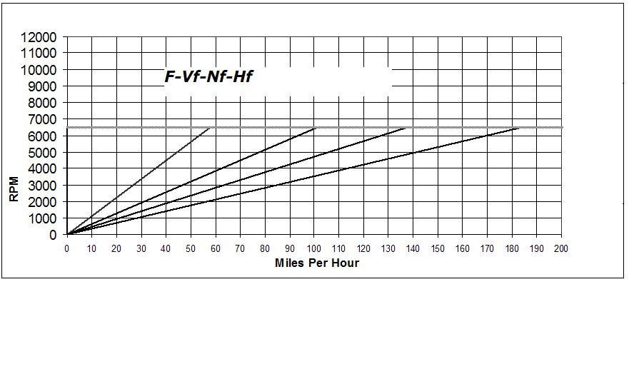

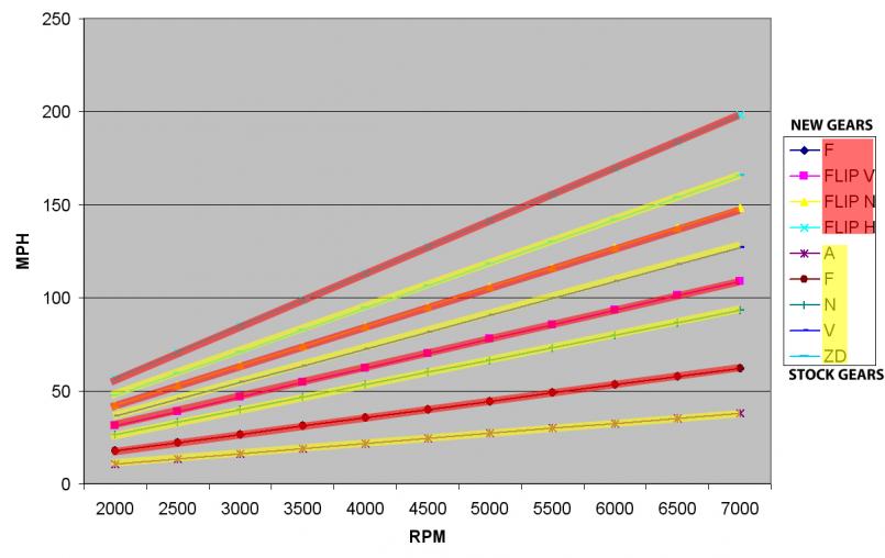

Dr Evil   When you guys say that you flipped other gears, wh...   Feb 25 2008, 06:44 PM
marks914   When Brad Mayeur did mine, he said it was no big d...   Feb 25 2008, 07:35 PM
Dr Evil   That seems like a tight grouping in the upper gear...   Feb 25 2008, 08:09 PM
Dr Evil   That seems like a tight grouping in the upper gea...   Feb 26 2008, 08:47 AM
michaelt55   Looks good to me Mike.... thanks.. Michael ...   Feb 26 2008, 09:04 AM
rick 918-S   What tire size are you using in your charts? 245/5...   Feb 25 2008, 09:22 PM
Dr Evil   Tire diameter of 25"   Feb 25 2008, 09:29 PM
Andyrew   So based on this info, with a 26" tire, and a...   Feb 26 2008, 12:37 AM
Dr Evil   So based on this info, with a 26" tire, and ...   Feb 26 2008, 08:24 AM
Andyrew   So based on this info, with a 26" tire, and...   Feb 26 2008, 07:53 PM

Dr Evil   Never an issue. Toss 1st gear, keep the race as a ...   Feb 27 2012, 03:42 PM
matthepcat   For those of us running a locked out first gear an...   Feb 27 2012, 03:48 PM
Dr Evil   Very easy. No special nothing needed.   Feb 27 2012, 03:57 PM
slothness   Thats what I hoped, I'll give it a try. Thanks...   Feb 27 2012, 05:36 PM
