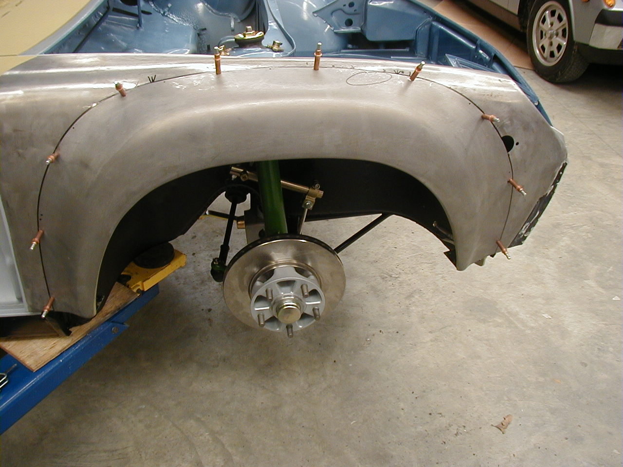

What i do is carefully positon the flair in the correct locaton, and fasten it with Clecos.
IronHillRestorations

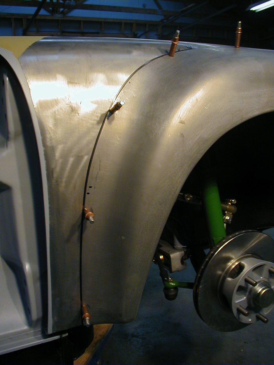

And like this

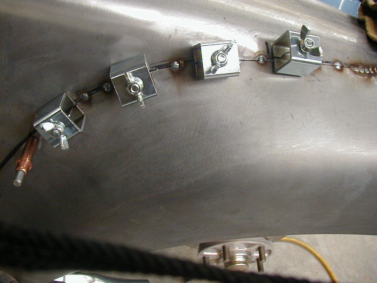

I don't have a pic of the actual cutting, but I use an air powered body saw, that's like a jigsaw. I barely cut the edge of the flair and the underlying fender at the same time, so you have a perfect seam. Then I clamp the two pieces, as I cut, with some panel clamps for butt welding panels together, and tack weld the flair on to the fender following the cut line.
post Jan 6 2007, 06:18 PM
I. I. R. C.
Posts: 6,958
Joined: 18-March 03
From: West TN
Member No.: 439

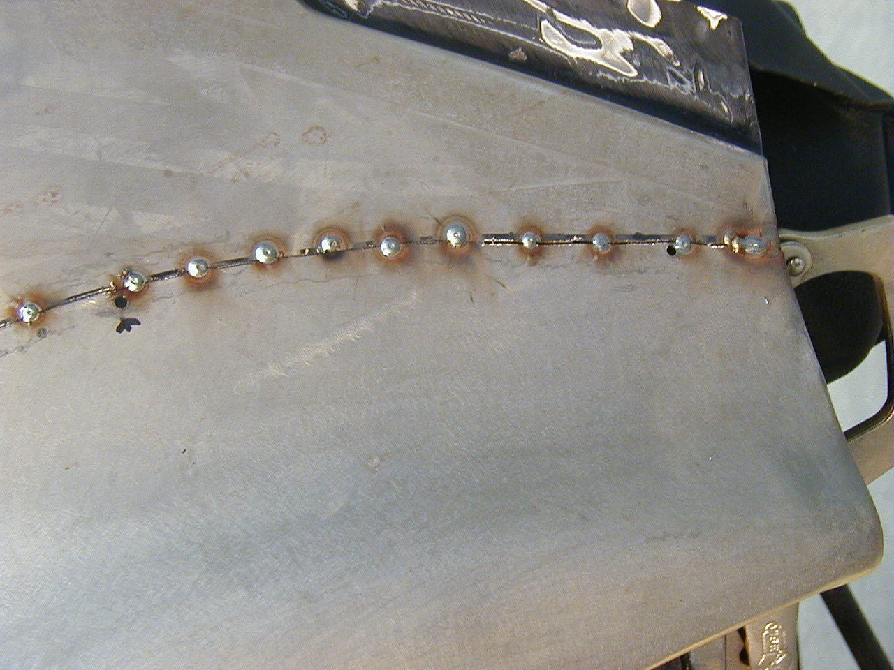

Here's what it looks like after it's cut and tacked all the way around. The small tack beads are as large as I weld. I just make small beads all the way around, using a copper spoon on the back of the weld seam to defer heat and keep from blowing through.

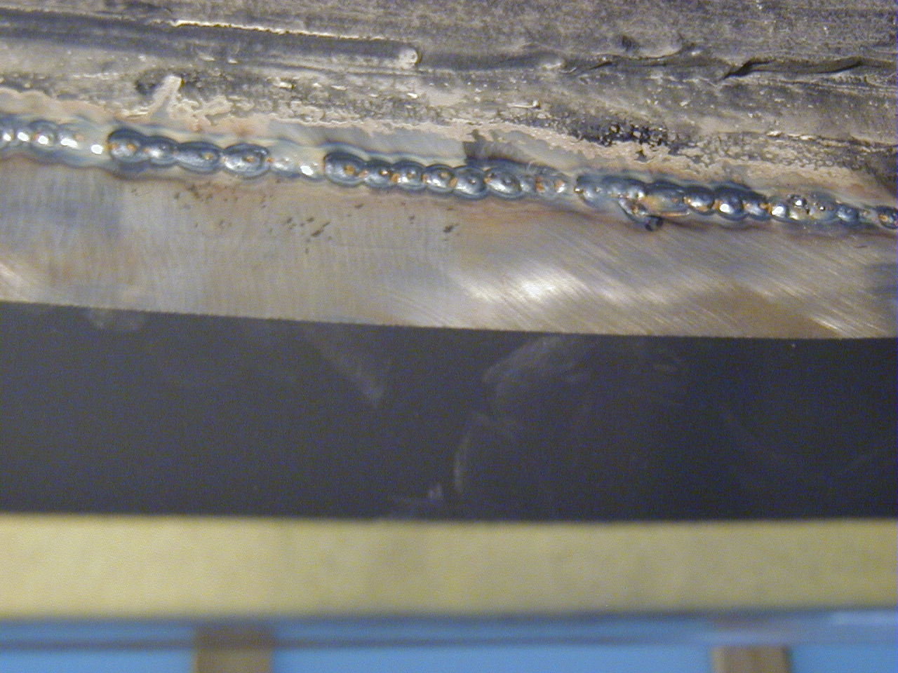

I didn't take a pic of the top side of the flair with all the small tack welds, but here is what it looks like from the underside, after it's been tacked solid all the way around.

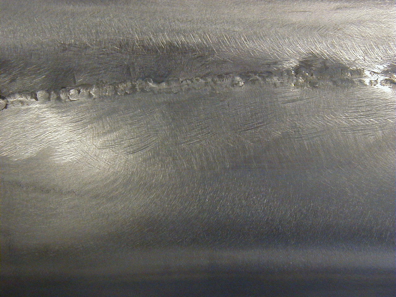

After it's all welded up nice and solid I carefully grind the welds with a flap wheel type grinder. If you use a hard wheel grinder you'll make too much heat and end up with warpage. Grind a little and move on to another area. I also use a spot light under the fender to find any pin holes. When you get done it should look something like this.

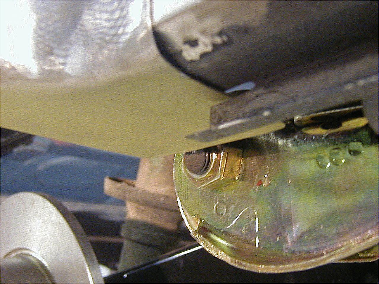

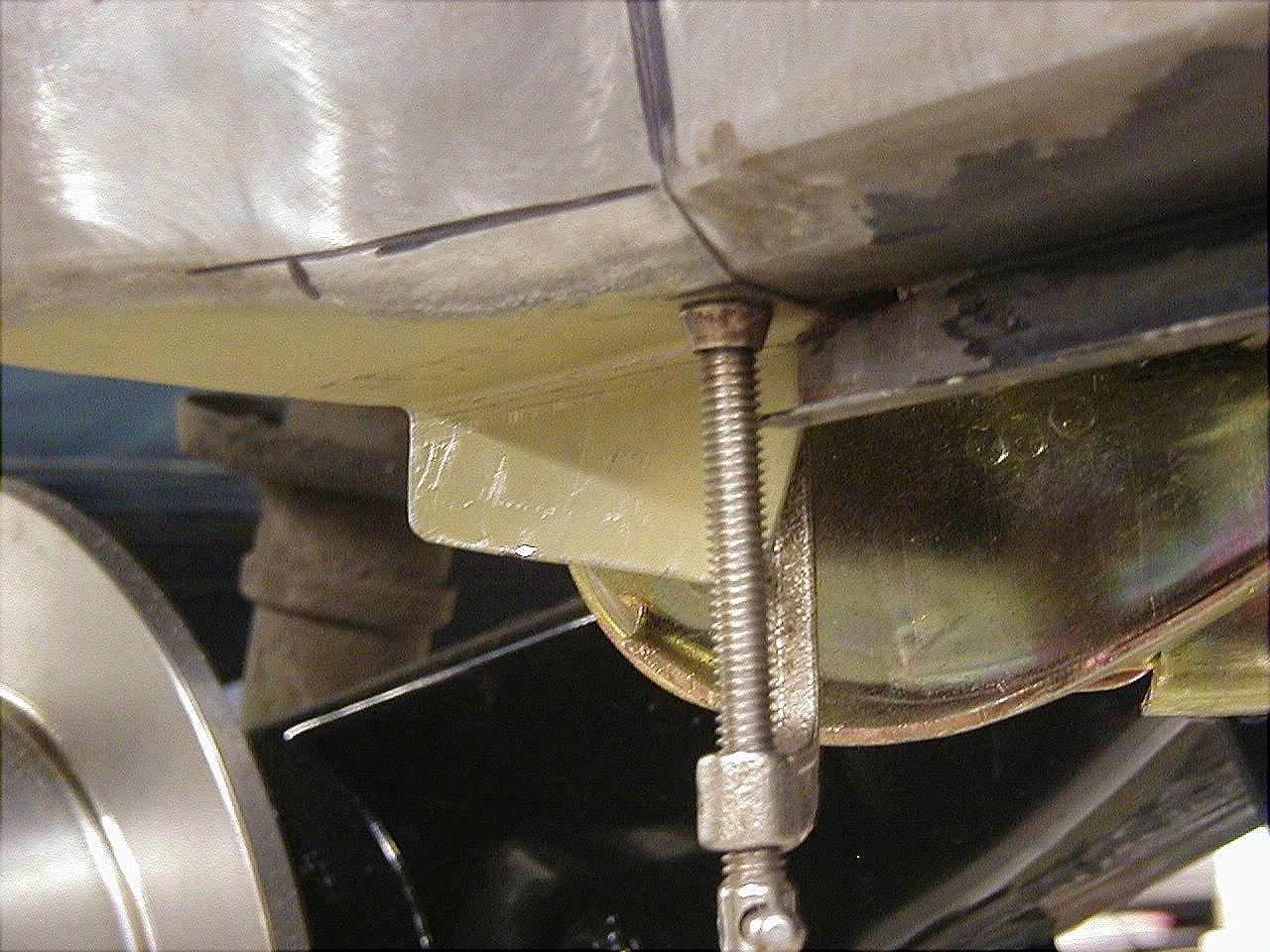

I've never installed an AA set, but the factory flairs don't fit right at the bottom, and require some work to fit good. The factory flairs aren't a great fit in general.
Here's the bottom of the factory flair before any work was done. The bottom edge of 914 panels have a 45 degree bevel, that the factory flairs do not have. I don't know if AA flairs have a bevel or not.
post Jan 6 2007, 06:45 PM
I. I. R. C.
Posts: 6,958
Joined: 18-March 03
From: West TN
Member No.: 439
Here's the bottom of the flair after some work.

The pics are great. For some reason I thought the flares were welded "on" the fender skin not butt welded. Do you dress the tack welds on the underside or leave them as is? Do you prime and paint the underside only or do you add undercoating? So you do end up welding the entire seam but it is done by spot tacks and you move around the flare to keep the heat down. Is the copper spoon something that can be purchased at welding shops? Thanks

Yes, I do go over the welds on the underside with a grinder and/or carbide burr, and then it gets self etching primer, primer, and then paint.
Yes, the entire weld seam is made of small tack welds, and yes it's to keep warpage to a minimum.
I got my copper spoon from Eastwood, but they may be available elsewhere.
