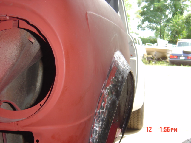

For you guys looking for a price, I obviously can't answer for Perry but my guess being in this line of werk would be around 40-50 hours to fully weld and metal finish the flares correctly. Figure on a MINIMUM hourly rate of $50.00 and depending on the region and shops rep. as much as $100.00 per hour. I personally wouldn't do it for less then $1500.00 fitted,welded,metal finished. BTW nice job Perry (IMG:style_emoticons/default/clap56.gif) I had close to 40 hours in these 2 front flares alone, but obviously was quite a different process
scotty b

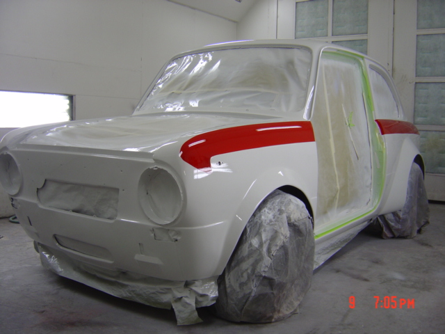

These were hand hammerd not welded on so it took a bit longer. Car after I painted it

That is one awesome car....Fiat 600?

Thanks. Yup 600. The owner wanted to clone a Mostra 1000 which there were only 5 built (IIRC) All I had to go by was a Japanese book on Italian race cars. (IMG:style_emoticons/default/blink.gif) I took the pics of the real car and scaled everything up to size using a pair of calipers to measure the pics and used the taillight as my piece to scale everything up to. Kind of a pain in the ass but fun at the same time. I enjoyed the 'challenge" (IMG:style_emoticons/default/smile.gif) Here's a link to some more pics and also a pic of the real deal Mostra. I unfortunatly had to leave that job this past summer due to a lack of steady werk. Va is a bad area to specialize in such oddball autos (IMG:style_emoticons/default/sad.gif)
