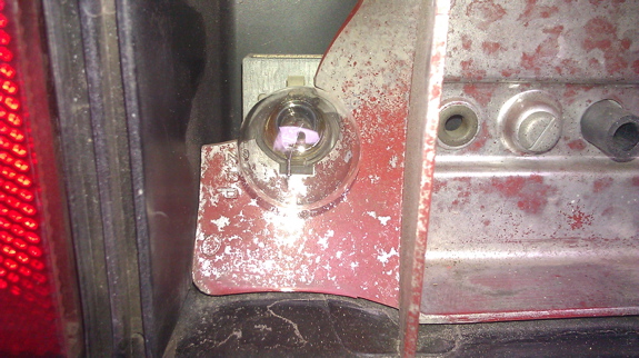

Its flaking off and the red plastic underneath is revealing itself. At first glance it looks like red over spray. I can't get a photo now they are in my attic. Is this common? Time to replace or can the be painted/plated?

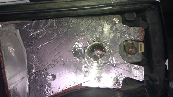

DanT
post Mar 8 2011, 06:58 PM
Going back to the Dark Side!
Posts: 4,300
Joined: 4-October 04
From: Auburn, CA
Member No.: 2,880
pretty typical Andy.

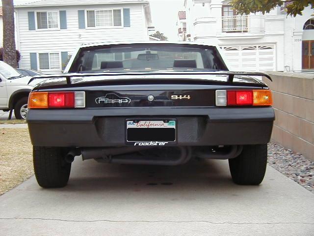

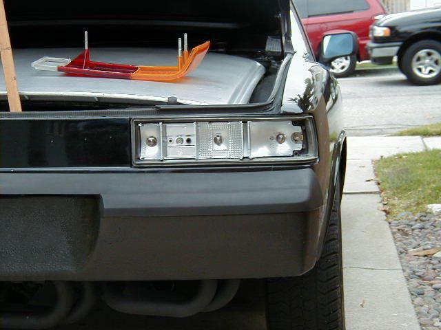

look like this?
I used Aluminum Foil Tape on mine and it worked well.
Other folks spray them with Chrome paint etc...

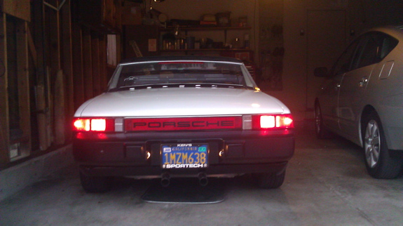

I painted mine with the 'chrome' spray paint (to code) (IMG:style_emoticons/default/laugh.gif)
... never dawned on me to use foil tape (IMG:style_emoticons/default/idea.gif) ... good idea.

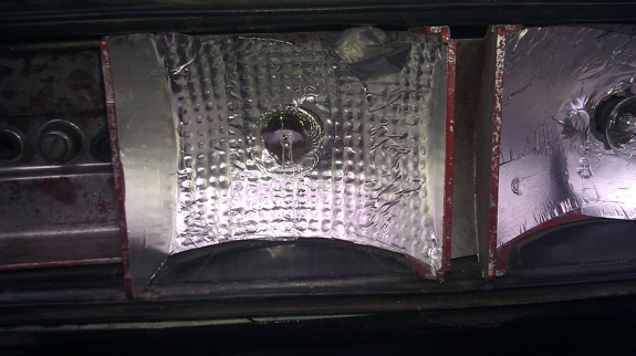

DanT
post Mar 8 2011, 08:11 PM
Posts: 4,300
From: Auburn, CA
Member No.: 2,880

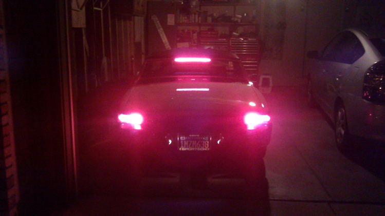

roll of aluminum foil tape was about $5. No toxic fumes and took about 1/2 hour to apply to both sides.
And it is definitely more reflective than the old silver paint/red plastic (IMG:style_emoticons/default/smile.gif)
here is a pic of just the running lights after redoing with aluminum foil tape...brake lights are much brighter (IMG:style_emoticons/default/smile.gif)

Wow Dan thats friggin bright. Tape it is.

The pic of mine may not look as bright as Dan's for a couple of reasons ... could be ambient light, or maybe someone's standing on the brake pedal? (IMG:style_emoticons/default/unsure.gif) ... they're definately much brighter than they were when I got the car.
I think the tape might hold it's brilliance for a longer period of time than chrome paint would. Either method will yield better results than doing nothing (IMG:style_emoticons/default/shades.gif)

DanT
post Mar 9 2011, 04:51 PM
Posts: 4,300
From: Auburn, CA
Member No.: 2,880

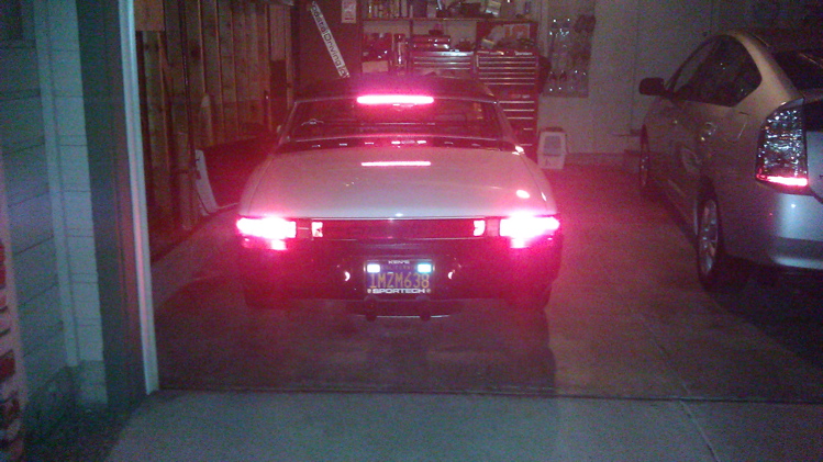

definitely the pic above of my car was just the running lights...
here it is with brake applied (IMG:style_emoticons/default/biggrin.gif)
