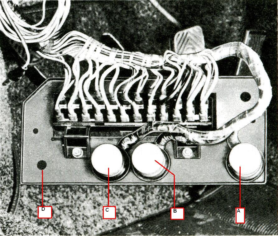

Does anyone have a picture of a 914-6 fuse panel they could post? I'm re-installing mine after replacing the harness and new style fuse block. I've got 4 relays (3 round ones and 1 square one) and 4 mounting holes on the fuse panel. But I'm not sure which relay goes in which hole. My manual only shows a 914-4 fuse panel.

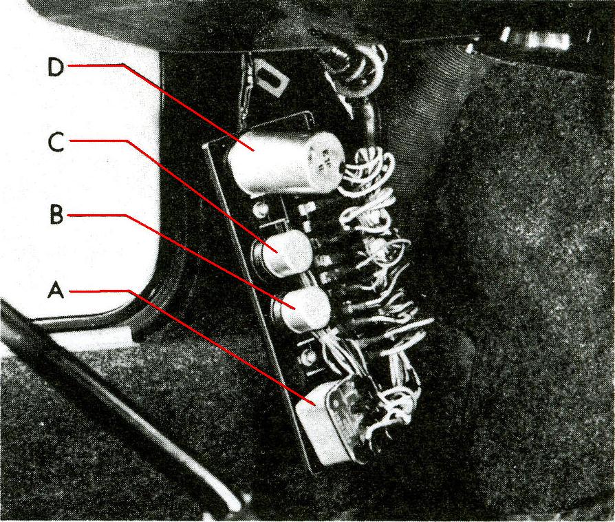

not sure if this helps, this is out from the factory repair manual:
914-4
A - low beam
B - fresh air blower
C - additional high beam
D - buzzer
(I hope my translation is correct (IMG:http://www.914world.com/bbs2/html/emoticons/rolleyes.gif) )

914-6:
A - buzzer
B - fog lamps
C - horn
Gustl

I added both types because you wrote about 3 round and 1 square relays - and this is shown only at the -4 board (IMG:http://www.914world.com/bbs2/html/emoticons/huh.gif)
Thanks Wolfgang!
Hmmm, I think I'm more confused than before.

The picture Wolfgang sent agrees with what I saw on a local 914-6 yesterday. However, I have an extra square relay (?) that I don't know where to mount.

The Diagram I have that matched your ignition Question, shows ;
1 addtional headlight relay .
2 headlamp flasher.
3 horn relay,
4 square turn indicator and hazard warnig flasher unit
Will it go in location D in Wolfgangs 6 pic.?
