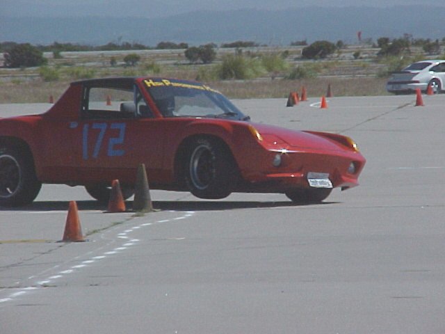

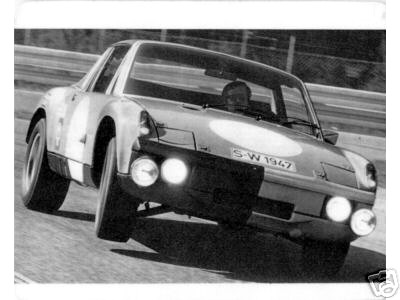

proof and pudding and all that ...
you may want to copy that suspension setup below, it must be superior, after all, that's how the factory ran that GT ... (IMG:style_emoticons/default/poke.gif)

Andy,
Didnt your car have that suspension setup?
I seem to remember a pic of your red car in a very similar pose....
Rich

QUOTE(r_towle @ Jan 18 2007, 07:14 PM) *
yes, it did. just like any other stock 914. NO swaybars ...
then i started throwing money at the suspension ...
point here is, if porsche had put a lot of "engineering" effort into the GTs, you really think that car in the pic above would have looked the way it does?
(IMG:style_emoticons/default/smile.gif) Andy

QUOTE(r_towle @ Jan 18 2007, 08:12 PM) *
just teasing...I always remember that pic...
Please post it again...it was awesome..
here you go. NO rear bar and front bar disconnected ...
just like the real early GT's !!!
(IMG:style_emoticons/default/thumb3d.gif) Andy

Yeah those GTs were really just cobbled together. Truely. BIG Fuching tires. NO areodynamics. Brutal Go-Karts pretty much.
It seems so logical to revise the (barely functional) "behr" airbox to exhaust right there in front of the windshield. The areodynamics would practically draw air out b/c that is a total low pressure area.
edit- Porsche wasn't attune to airflow until the 70s. Look at the early 917s even- they sit up a foot off the ground!
