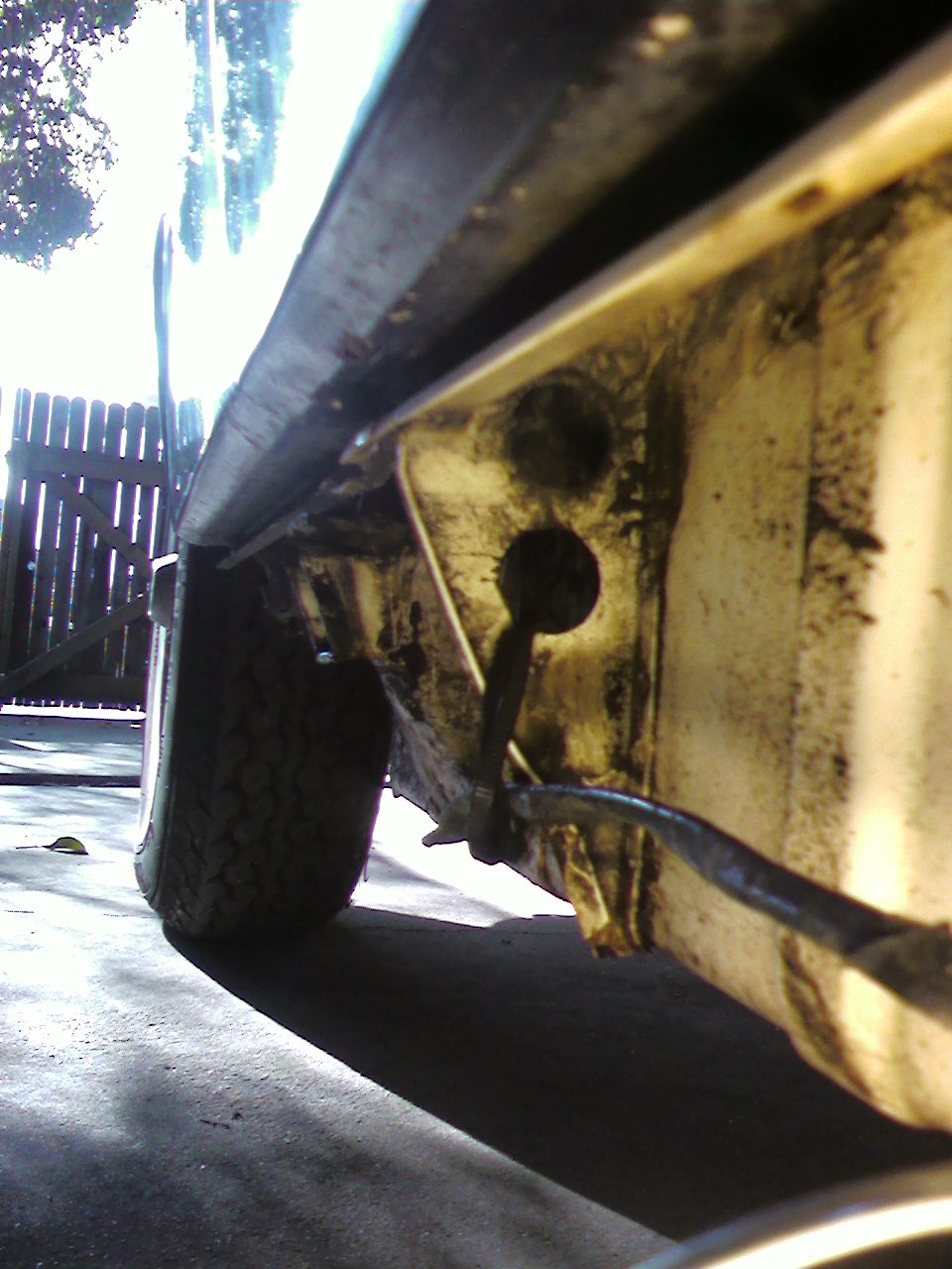

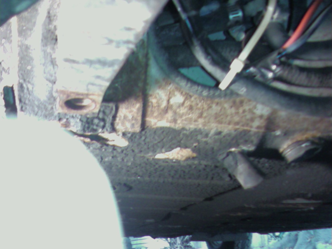

That said, here in SoCal/Southwest the fuel pump relocation is a good idea for long drives in 90+ degree days, unless you like sitting in a Denny's for 3 hours waiting for it to cool down (I did in Blythe on the way to the CO River once on a 110 day, then had mine relocated & not a problem after that). Porsche relocated them on 75-76 MY 914s to a cubby-hole under the fuel tank accessed from the front trunk, & issued a service bulletin for a relo to the front for 70-74 MY's.
AA sells a FP relo kit & the factory bulletin locates it on the front lower bulkhead next to the center tunnel access hole where the fuel lines daylight, which is up behind the steering rack & accessed by removing the steering rack underbelly cover. Wiring for power can be run along behind the passenger side rocker cover, or through the tunnel if you're really ambitious.
Here are pix of mine done back in the late 70's -
FP location after relo -
FP wiring along passenger rocker space for relo -

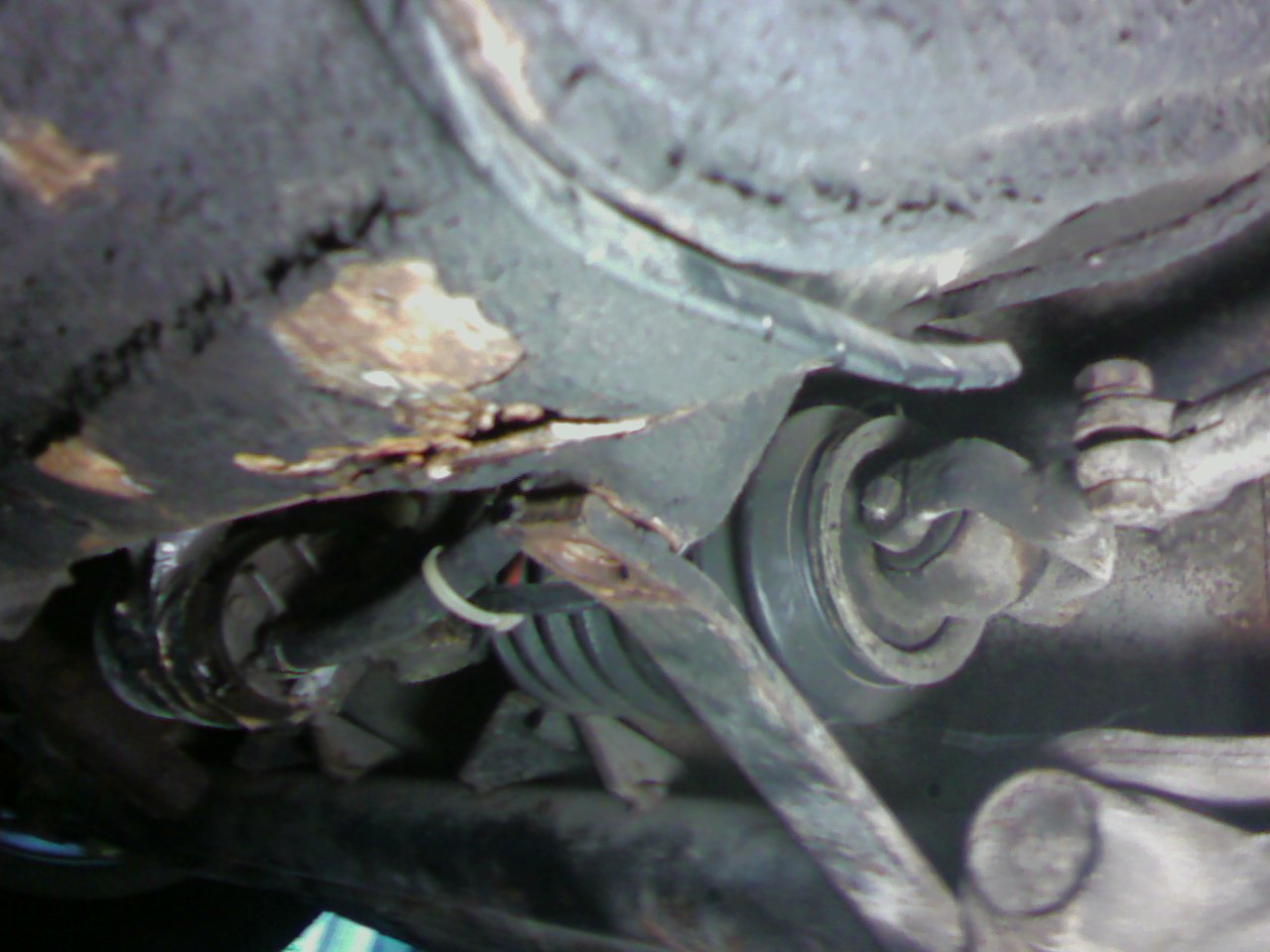

TomT; it looks like the pump is exposed to road grime. Is there a cover or am I looking at it wrong?
post Nov 22 2010, 07:24 PM
Resident German
Posts: 42,244
Joined: 21-January 03
From: Oakland, Kalifornia
Member No.: 179
QUOTE(76-914 @ Nov 22 2010, 05:02 PM) *
Better be as he's missing the rear bolts to hold his cross-member in place!!!
I really hope the pan (and bolts) were only removed to take pictures ... (IMG:style_emoticons/default/shades.gif)
