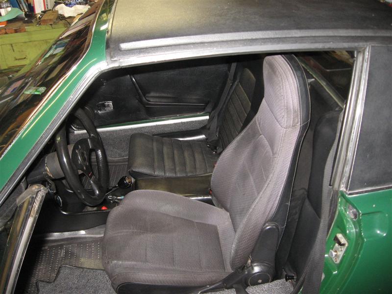

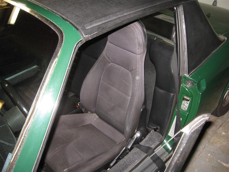

Pictures: This is on the 914 seat rails, but not bolted to the floor. I'm outta time tonight.

Those look pretty good. Not sure if they are faded or just the pic, but you can get some Rit dye from Rite-Aid, mix it to the desired color, and spray them with a spray bottle. Did my carpets that way, and a old seat I had with pretty good results. The trick is to mix the dye light, then go darker as needed. And you may want to either shampoo them afterward or sit on a towel for a while.

the seats are a bit faded, but for $30 for 2 seats w/o tears was a good deal. I am/was not sure how they would work. If I decide I really like them I will look for better seats.

The style of those seats go reasonably well with the 914. It's difficult to tell in your photo; is the seat bottom of the Miata higher than the stock 914 (passenger side)?

Yes the bottom of the seat is higher than the stock 914 seat (both passanger and driver). My car is a '70 so it has the early passanger seat that is fixed and I think it sits a bit lower than the stock 914 driver seat. I can take a side by side pic of the stock and miata seat this afternoon as well as the stock seat reinstalled.
