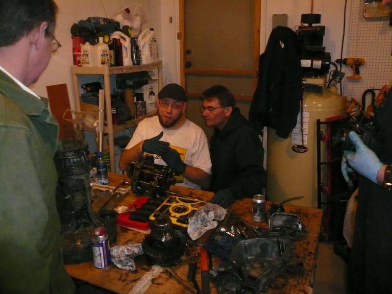

Hey,
I was cleaning out my camera and found these pictures of some guys trapped in an enclosed space and high on brake cleaner.
Fortunately we had a coupla doctors in the house who recommended alcohol as a cure.

QUOTE(kwales @ Jan 26 2010, 05:25 PM) *
Hey,
You would never know by looking at that first picture that my transmission held 36 quarts of oil, all but 10% of which landed on Andy's floor...
Sorry Andy!
