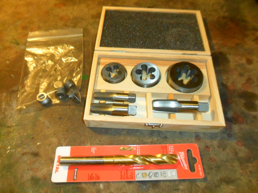

Picked up everything I needed today for the five main galley plugs:
I figured out afterward that there is a kit available for slightly less money than I have invested in this task. (IMG:style_emoticons/default/dry.gif) Here it is in case anyone else is looking:
http://www.germansupply.com/home/customer/...productid=16842

are those steel or Alum. plugs?
saigon71
post Feb 3 2016, 08:10 AM
Posts: 2,031
Joined: 1-June 09
From: Dillsburg, PA
Member No.: 10,428
QUOTE(rdauenhauer @ Feb 2 2016, 11:10 PM) *
Steel.

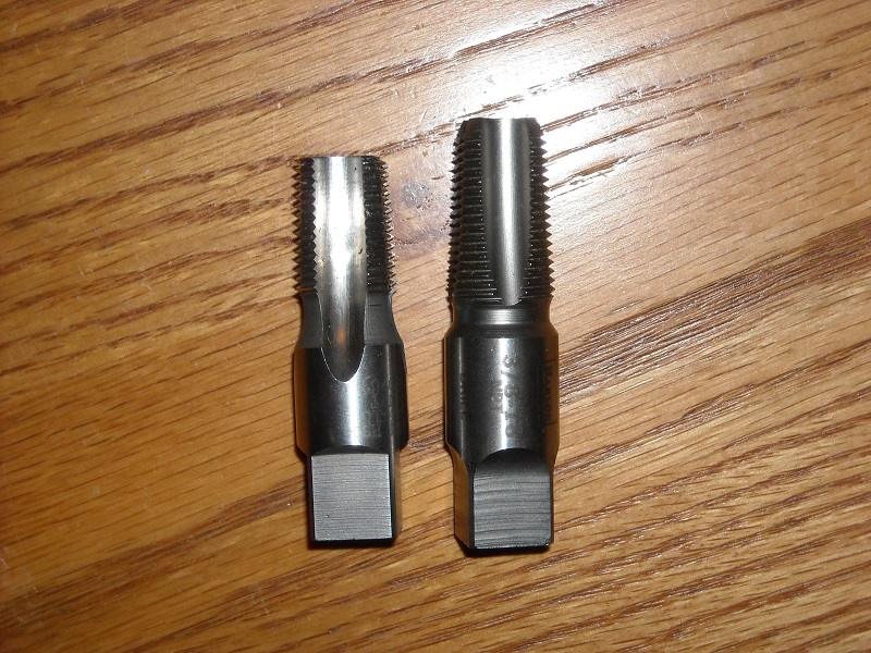

When I did mine I got an extra tap and ground the bottom of it to use as a bottoming tap. I started the threads with the regular tap, then ran the bottoming tap in.
That way I was able to thread the plugs in without having to drill deeper.

When I did this the 1st time, I had got some 3/8" NPT plugs from mcmaster-carr and they were way thicker (would have to be run deeper) than the ones I ended up using which I got from rimco. I don't think they would have worked for the outer one by the oil cooler.
I was able to use 1 tap and just ground it down alternately to running it, like it became a bottoming tap by the time I was done. You just need it for that one by the oil cooler.
