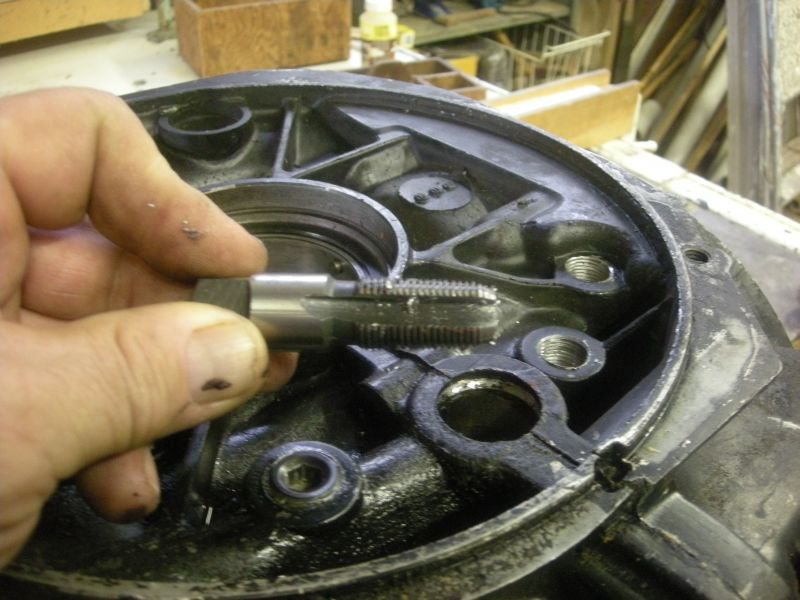

Mark Henry   3/8" NPT pipe tap, 9/16 drill bit use steel p...   Jan 19 2016, 08:15 AM
r_towle   3/8" NPT pipe tap, 9/16 drill bit use steel ...   Jan 19 2016, 08:29 AM

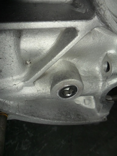

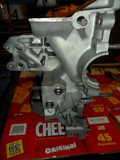

saigon71   Thanks for the responses and recommendations. :b...   Feb 2 2016, 08:29 PM
rdauenhauer   are those steel or Alum. plugs?   Feb 2 2016, 10:10 PM
saigon71   are those steel or Alum. plugs? Steel.   Feb 3 2016, 08:10 AM
Olympic 1.7   When I did mine I got an extra tap and ground the ...   Feb 3 2016, 08:30 AM

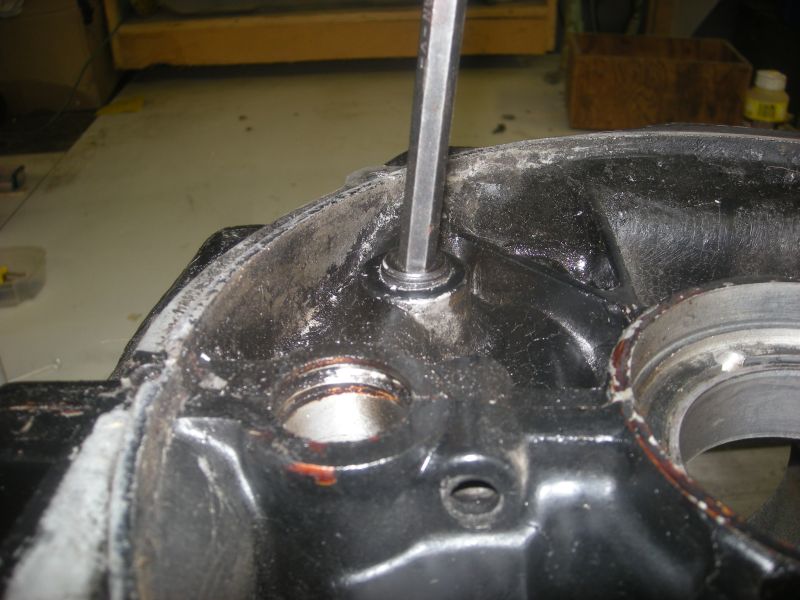

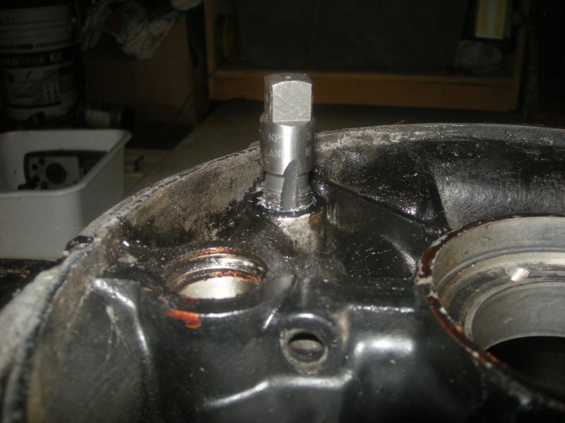

McMark   :agree: A second tap is handy. Also, when drillin...   Feb 3 2016, 08:35 AM
Mark Henry   :agree: A second tap is handy. Also, when drilli...   Feb 3 2016, 10:20 AM
McMark   Oh yeah. That for sure! :agree:   Feb 3 2016, 12:58 PM
nathansnathan   When I did this the 1st time, I had got some 3/8...   Feb 3 2016, 05:14 PM
Mark Henry   When I did this the 1st time, I had got some 3/8...   Feb 3 2016, 08:38 PM
nathansnathan   When I did this the 1st time, I had got some 3/8...   Feb 4 2016, 12:03 AM
Mark Henry   [quote name='Mark Henry' post='2298151' date='Feb...   Feb 4 2016, 07:38 AM

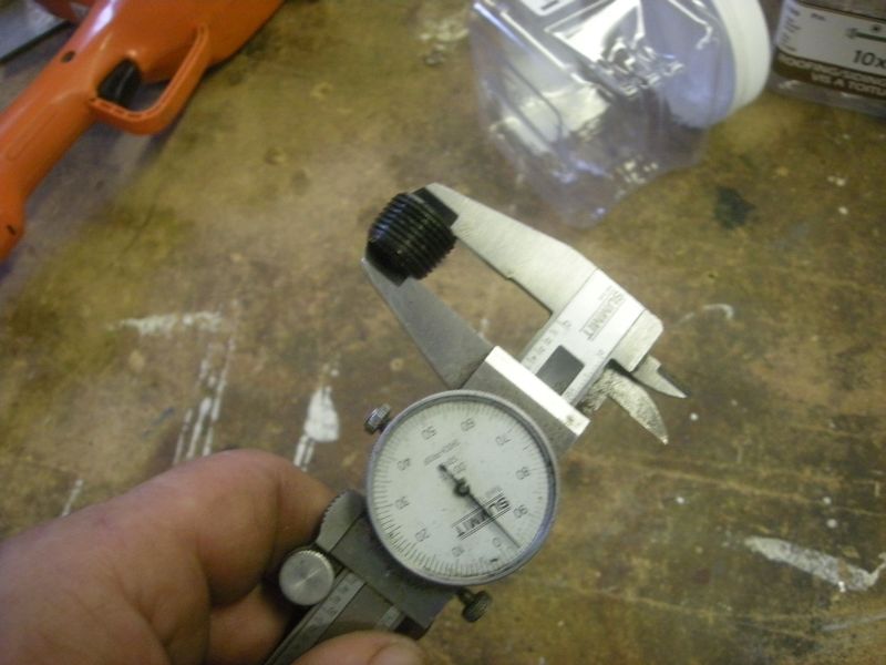

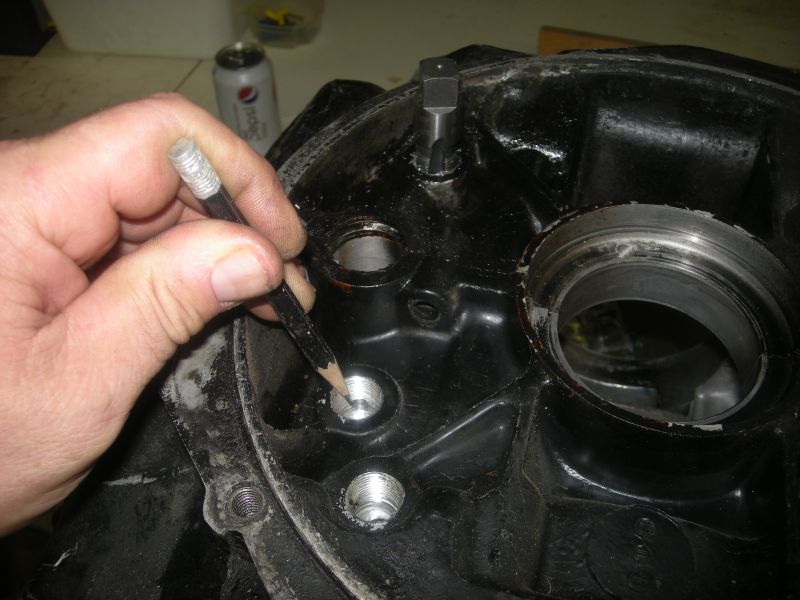

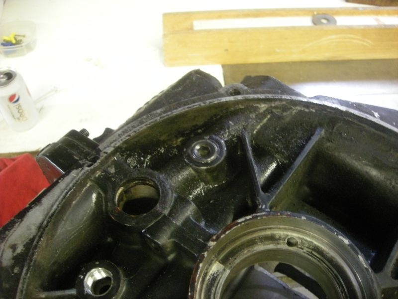

Mark Henry   Now I have it pretty well flush, BTW I'll be d...   Feb 4 2016, 10:23 AM

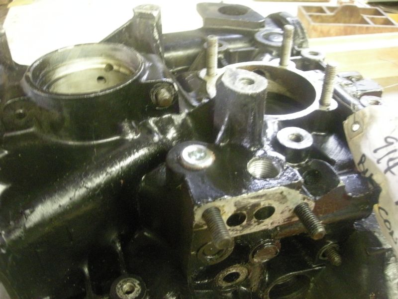

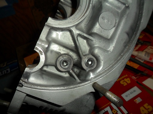

Mark Henry   This came out good :) This show the one plug you ...   Feb 4 2016, 10:31 AM

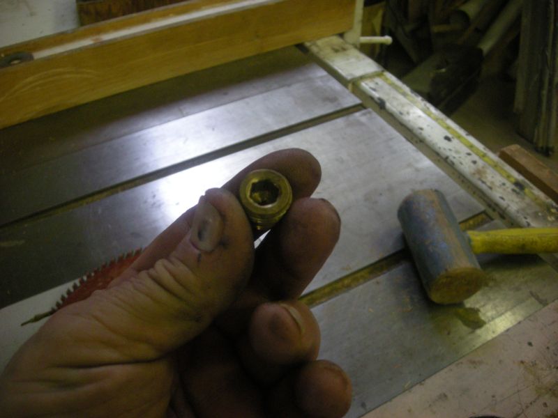

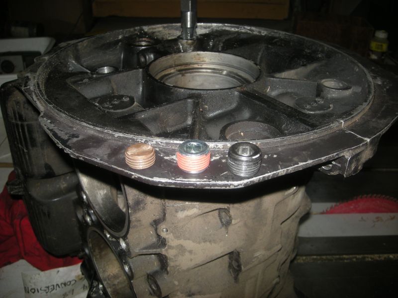

Mark Henry   The last pic shows 3 different steel plugs. The on...   Feb 4 2016, 10:43 AM
