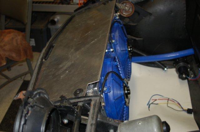

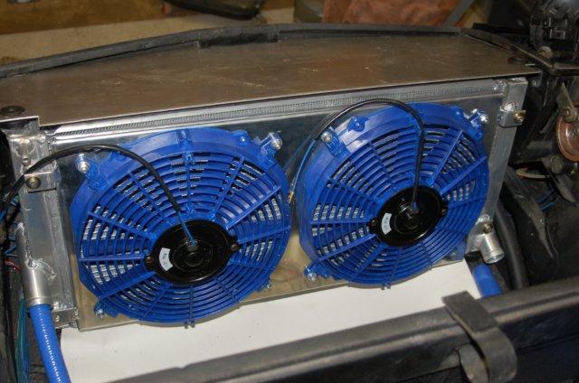

I did a build thread a couple weeks ago.. Renegades cooling setup.
Some fairly decent photos of the rad setup.Cools nicely.

Yes,its free floating.No shrounding to the rad in the front,but they provide everything to encapsulate the rad in the front trunk.They provide a filler neck,but no puke can(overflow tank).That can be found in a zillion different sizes/configurations at the FLAPS.The hangers they will provide,but your better off just getting them yourself.Look for 1.25" conduit straps.
Mine works well.It was easy.I have yet to duct the air from the bumper to the rad,but I will.

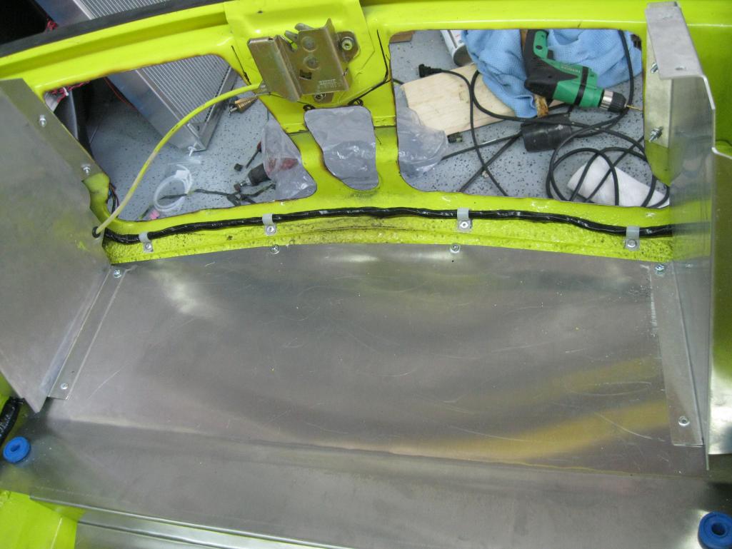

I've got the Renegade system also, and I'm very satisfied with it. The radiator has a couple of pegs welded to the bottom that fit into special grommets in the aluminum floor that's provided, so that locates it on the lower edge. I elected to secure the floor on the forward edge of the trunk compartment in a couple of places, so the springiness of the rear edge of the floor (where those pegs are) allows the radiator to float nicely.
I kept the battery in the stock location and ran a 10-gauge wire up front for power. It seems that the dual fans spike the current draw at right around 40 amps when they kick in (somewhat less when they're running), so you'll want about 50-60 amps' worth of fuse protection. I had a 40-amp fuse in there for quite a while, but it ultimately blew, so that seems to be the threshold. The Spal fans are pretty quiet for the amount of air they move!
Here's a couple pics showing the aluminum trunk floor, some of the side shrouding, the grommets (blue) and the re-routed wiring harness.
mittelmotor

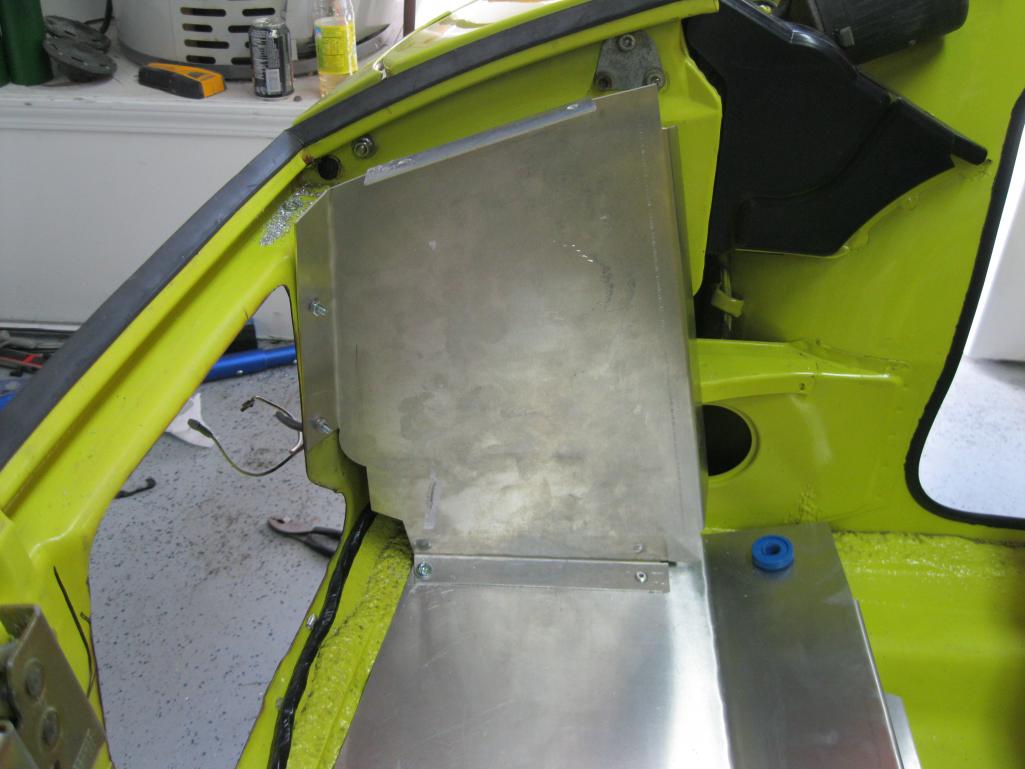

second pic:

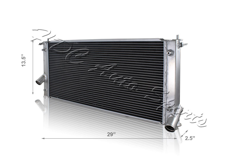

I have been doing a little research on this subject, trying to come up with some options... Found this today. It's a perfect fit, and about 1' wider than the Renegade set up. Some folks also make shroud's for this radiator, but the fans seem cheap. Cost for the radiator is about $120 shipped.

I believe Renegade has done some research and found a dual pass better than a single pass. Radiator shown is a single pass, right?

Yum, undetermined...
Labeling states "Dual Two Core Aluminum Radiator" -

Ebay. Search 00-05 Toyota Celica Aluminum Radiator

Here ya go A celica radiator. This is the one Thom is talking about. This is going in a Subaru conversion that I'm helping D914 with. I really like the way this mounts up. The welds look good and seems to be a bargin at the price with fans and shroud.
