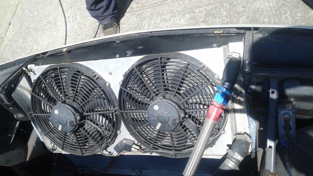

Meizere electric remote mount water pump 55 gms biggest dual pass aluminum radiator you can stuff in nose with two of the biggest fans sucking 3000 cfm through the radiator at iddle. Basically that is what the Renegade set up is LOL. Oh inlet shroud very important so the fans suck all the air through the radiator.

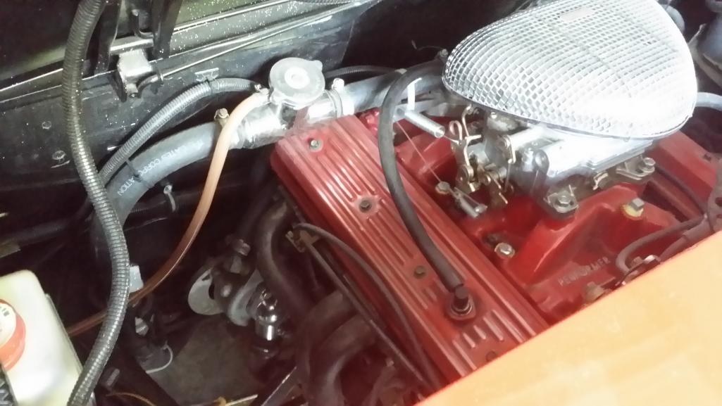

The radiator you have should be good. Lets see some pictures of where you fill the system.

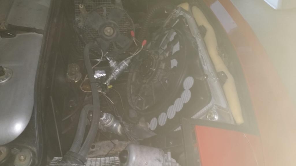

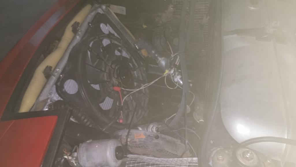

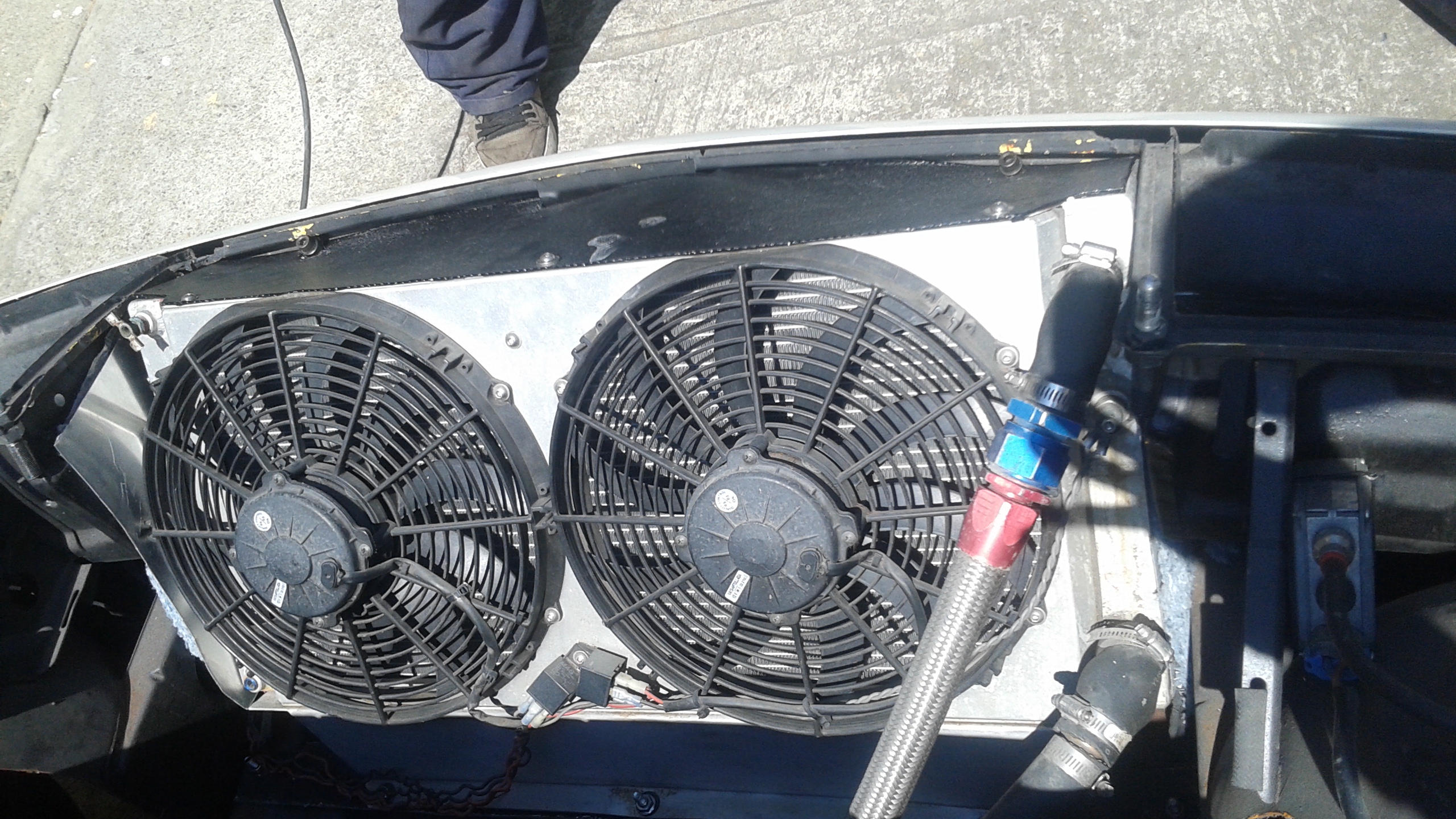

Here are some pictures I took today.
The holes in the shroud are new... as a test top see if it made a difference. I think it did because in the past (with no holey shroud), it did not matter how cold it was outside; the temp would always go to 200 and beyond (have a 160 t-stat with bleed holes drilled and the fan is set to turn on at 180). After cutting the holes in the shroud, the temp would stay at around 180 (acceptable) although it was when it was cooler outside. Now in this 100 degree weather... it does not matter... it still get to 200 and beyond).
The extra fans are from a Toyota 4-Runner AC condenser units and were mounted there temporarily to see if they made any difference in assisting the main fan exhaust air from the front area (they were wired to push air out). They did not work.
Also; my temp sensor is mounted in a port right next to the t-stat/intake manifold.

What if I could stand the radiator up more vertically... might that help with a larger cavity in front of it?

The holes in the shroud are making the fan inefficient. Is that a dual pass radiator. Where is your expansion tank connected to the fill.

The expansion tank and fill in the rear looks good. I think it's your radiator and pump combination

Renegade using Ron Davis RadiatorAttached Image

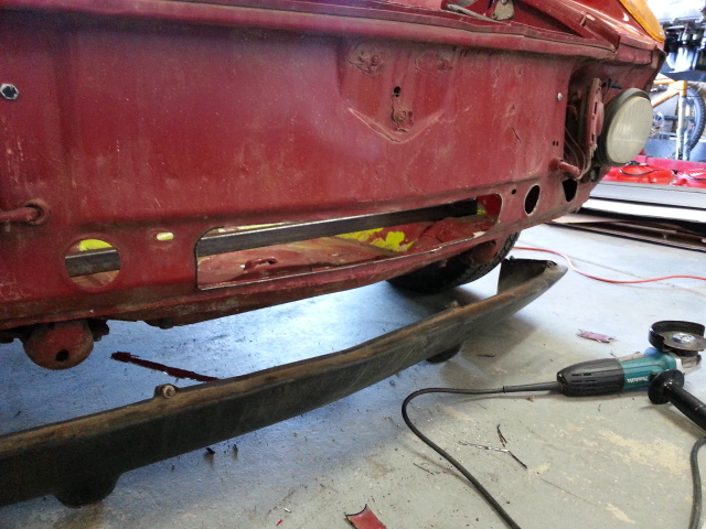

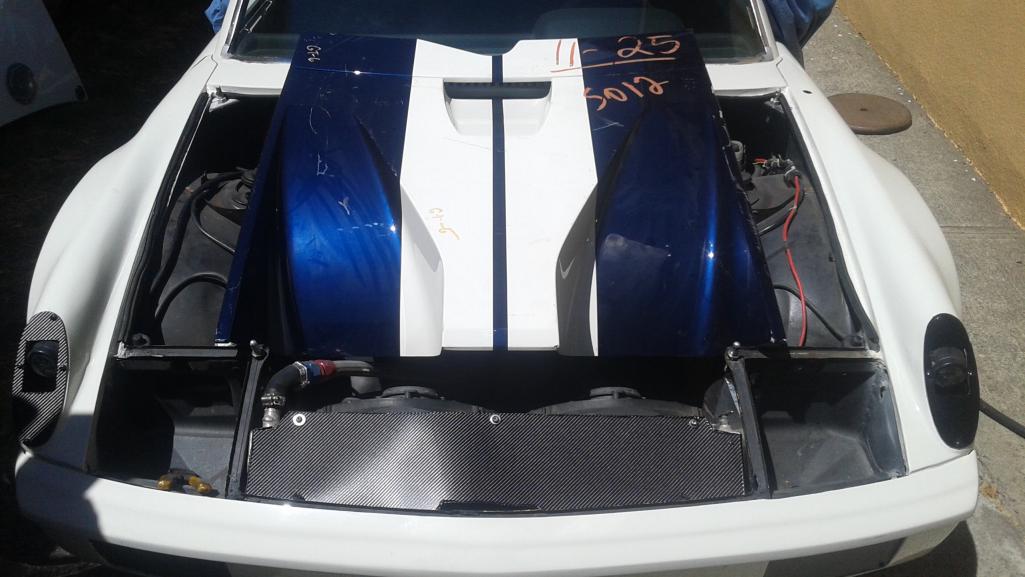

If you have access to a MIG and are willing to fab a bracket and cut some sheet metal you can have a radiator assembly for a little over two hundred bucks. I put mine together using the Toyota Celica GT radiator off of eBay. It cost $167 bucks and it comes with fans and shroud. I have a 2.5L Subaru in my car and it runs 190 degrees even in 95 degree heat.
I found that it that it doesn't take a large opening to provide more than enough air to keep things cool.

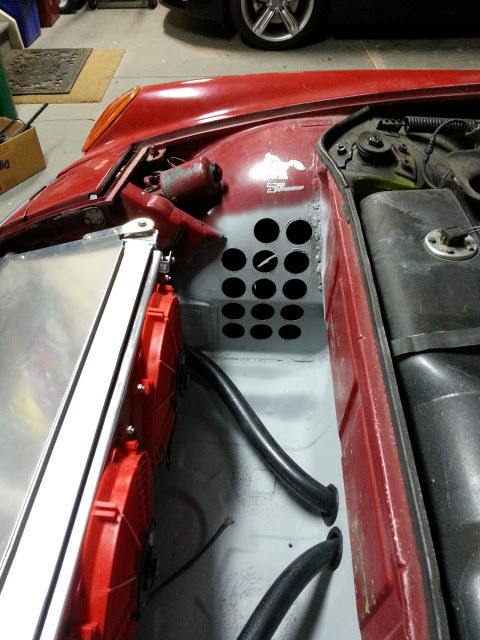

My opening is maybe twice that size of the pic above but I found on 6cyl it does not take a large opening as the v8. The larger the opening the more air through the radiator at speed. At idle is where a good set of fans and shroud do the work.

In the works as we speak because the wheel well exit is really inefficient and prehistoric. I'll send more pics when it's finished. The damn gas tank bar which ties the two shock towers together is our major obstacle at the moment, but making progress. (IMG:style_emoticons/default/mad.gif) Attached Image
