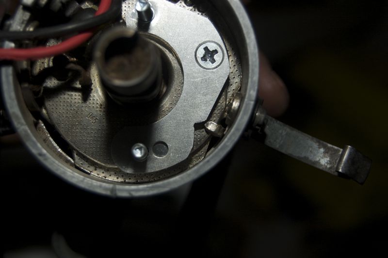

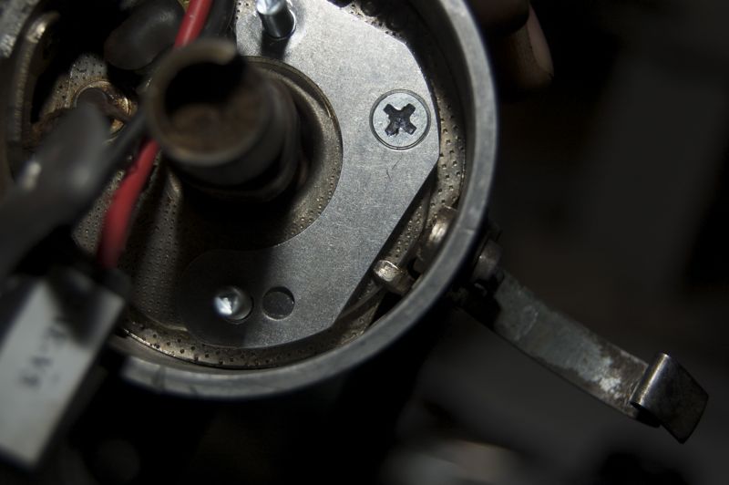

I rebuilt a distributor today and installed a Pertronix unit, and ran into a problem that I never had/noticed before. This was a 039xxx205A distributor and the problem was that the little 'finger' in the bottom right was running into the Pertronix mounting plate. This interference was completely eliminating any vacuum advance.
5 minutes with a file and it was all fixed.
If you've got a Pertronix, this would be something to look for and should be visible simply by removing the cap and rotor and jumping in the engine bay with a flashlight.
Always learn something new. (IMG:style_emoticons/default/shades.gif)

McMark   Well, since this was just a distributor rebuild, I...   Dec 31 2010, 11:09 PM
