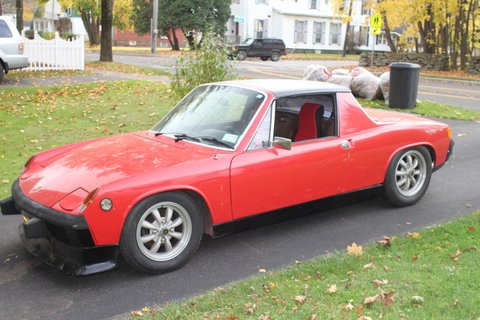

crappy muffler, replace it.
Front spoiler is waiting to die a miserable death as a street car, fiberglass won't last long if you hit a rock, curb, dirt road, speed bump or snow.

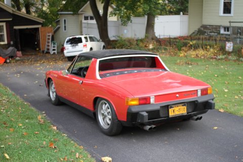

The car looks to be in decent shape. It's still got the mirror and the flap on the visor. Sign of a cared-for car. Someone has installed European front and rear lenses. The door gaps look good. The muffler isn't very good and the spoiler is ugly.. Those things are easily replaced. If you get that car for $2500.00 or less, you can't lose. Of course there will be rust on the underside of the car. If it's been garaged in the NY winters- (where is it- near Binghamton/Oneonta?) it may not be too bad. Go for it and have it shipped to you. It'll be a fun car.

Cool random plate

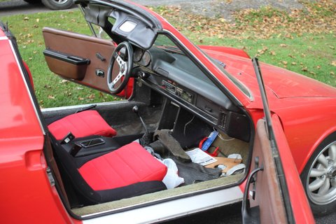

So it is a 74. I think it is a 1.8, but I can't make out the badge for sure. Dash looks to have no cracks, euro lenses, empi (?) rims, after market steering wheel....... Like others have said already rust is the BIG issue. Battery tray, area below it, jack post area and up into the rear suspension area, trunk floors, and floor. Looks to be a non appearance car (no center console, no sway bars, no fog lights)

You will regret it if you don't buy it. Heck, your mom may even take payments! I would clean the mess out of the inside and get rid of the red seat covers. The original interior looks like it was brown and who knows what the original exterior color was?

It doesn't appear to have fog lights but doesn't it look like it has a console, just missing the gauges? I'm waiting on ether photos and the VIN#. I've already told my mother I'll buy the car. Trying to figure out the easiest and most economical way to get it home to Louisville
