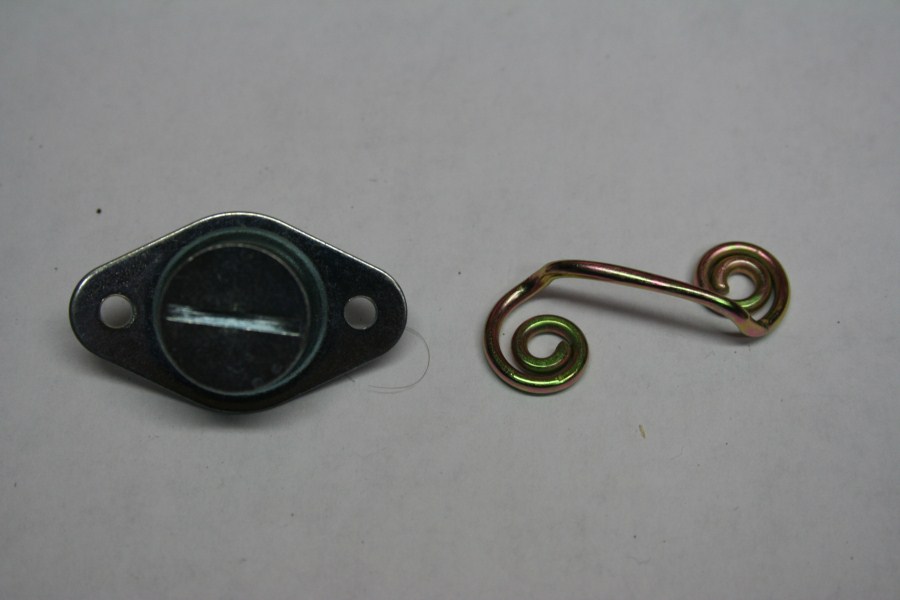

It has taken a little massaging to get the fenders to fit and I expect I'll do a little more. For what it's worth, I think the Sheriden kit on the Yellow Zonker was made a little better. These are the Dzus fasteners I'll be using.

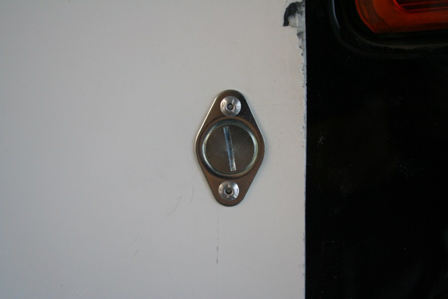

Elliot Cannon
post Jan 29 2013, 08:14 PM
Post #36
Group: Retired Members
Posts: 8,487
Joined: 29-December 06
Member No.: 7,407
One down. About 31 more to go.
stateofidleness
post Jan 29 2013, 08:26 PM
Post #37
Posts: 810
Joined: 1-September 07
From: Canyon Lake, Texas!
Member No.: 8,065
QUOTE(Elliot Cannon @ Jan 29 2013, 08:14 PM) *
At the risk of looking like a complete idiot (which I'll gladfully assume), what is that and what's its purpose? (IMG:style_emoticons/default/confused24.gif)
Dave_Darling
post Jan 29 2013, 09:16 PM
Post #38
914 Idiot
Posts: 15,364
Joined: 9-January 03
Member No.: 121
That's a Dzus button. A quick-release fastener, so that the fender can be pulled off by turning a few fasteners one quarter turn.
BTW, micro-balloons are to provide lightweight filler. They're mostly air, so they don't weigh much. They take up space nicely, and when you mix them into the appropriate "goop" they can be used as body filler that builds up nicely and sands well but is light.
--DD

rgalla9146
post Jan 29 2013, 09:28 PM
Post #40
Posts: 4,997
Joined: 23-November 05
From: Paramus NJ
Member No.: 5,176
QUOTE(stateofidleness @ Jan 29 2013, 06:26 PM) *
How much space will there be between he panels created by the protruding rivets ?
Won't the rivets rub on the opposite rivets or the metal fender constantly ?
An additional picture or two might help.
I want to use some Dzus fasteners myself but don't understand how the panels can be tight ( contacting ) to each other.
Thank you
