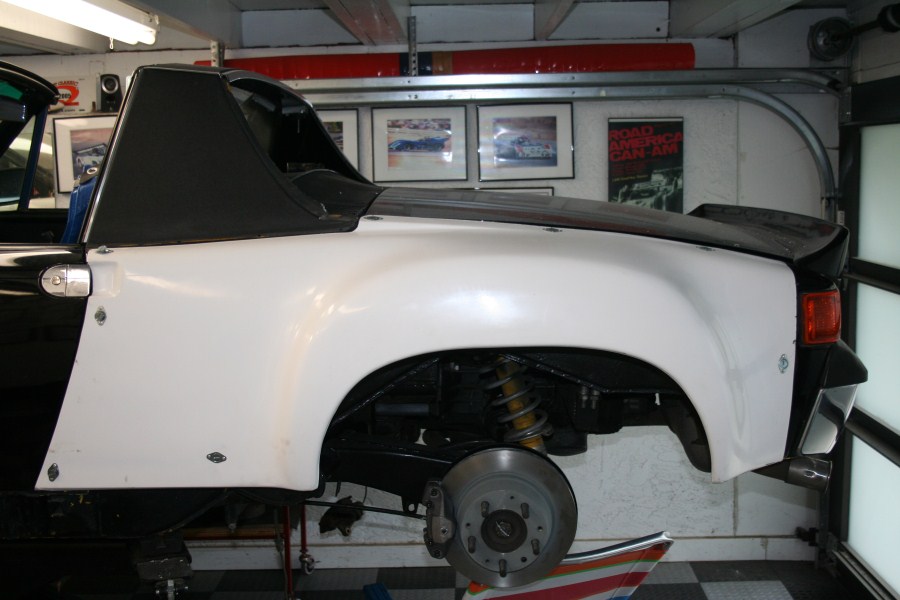

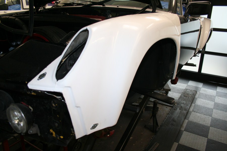

All the "Dzus" fasteners are installed. All four fenders are fitted up and after a little more sanding and cleaning up will go to the paint shop. Soon I hope.

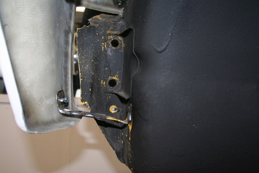

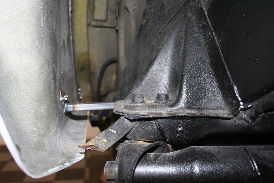

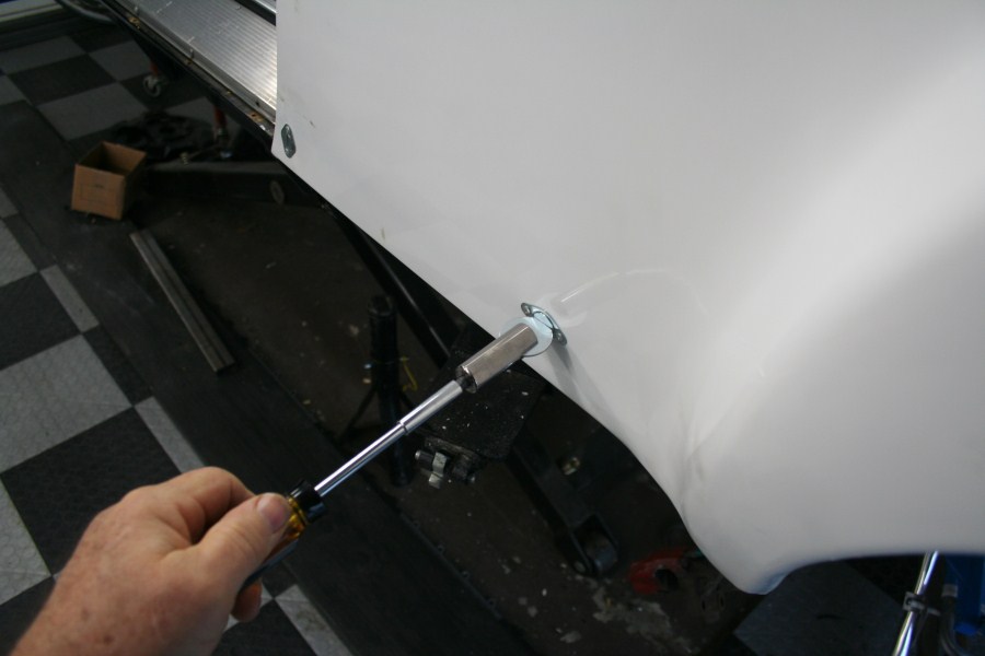

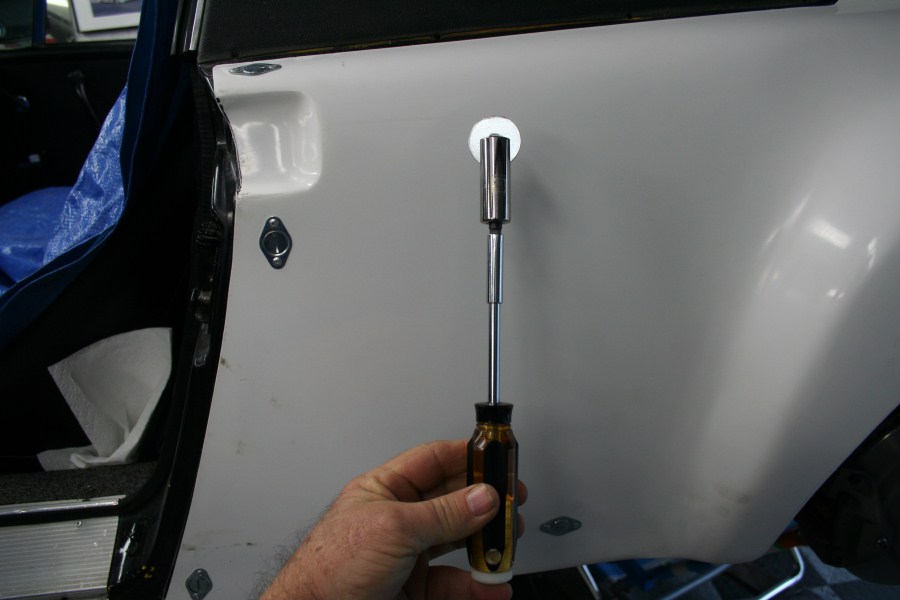

I had to fabricate some "struts" to make the fender a bit more secure. The front one I used part of the existing support and the rear one I used some 1/2 in square tubing. I also made a dzus tool with a 1/4 inch drive 13mm deep socket.

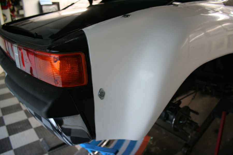

I had to do a lot of "massaging" to make the QRS fenders fit up OK. I could have trimmed more from the bottom of the fender but then it wouldn't blend too well with the rocker panel. I haven't installed either of the rocker panels. More pics when I do.

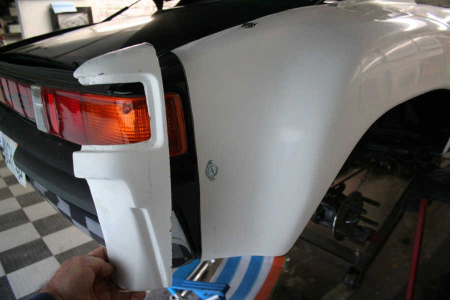

I cut a lot off the back of the rear fenders because it made it a bit... Umm... Easier to fit. A LOT easier. (IMG:style_emoticons/default/smash.gif) (IMG:style_emoticons/default/sawzall-smiley.gif) I can't wait to get them painted because it will look mucho better when they are. (IMG:style_emoticons/default/biggrin.gif)

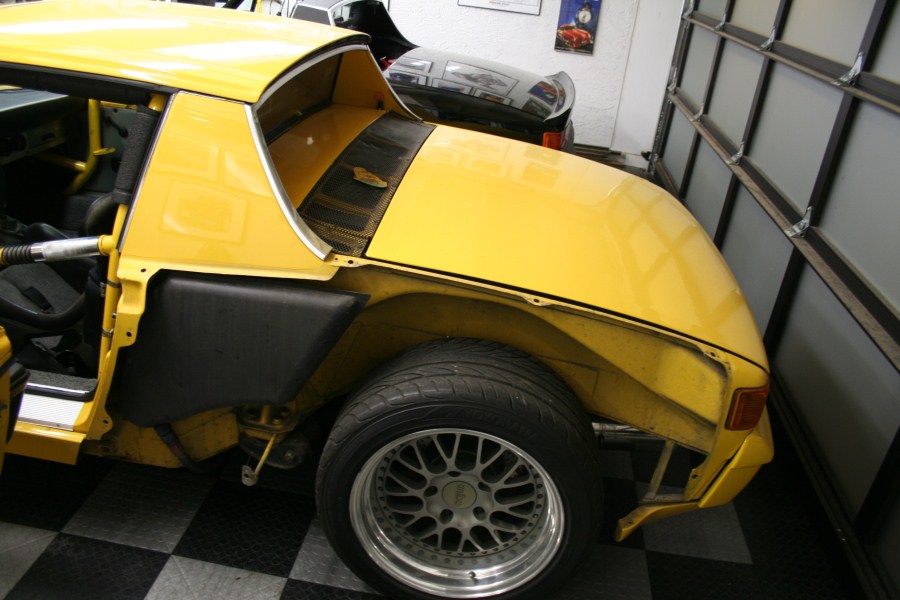

montoya 73 2.0

I called Jeff at QRS Fiberglass today to see about a rear valance to match my GT flares. I learned that the GT's didn't have a rear valance. (IMG:style_emoticons/default/confused24.gif) At least this one doesn't. Something about aerodynamic drag. I guess I won't have on either. (IMG:style_emoticons/default/biggrin.gif)
