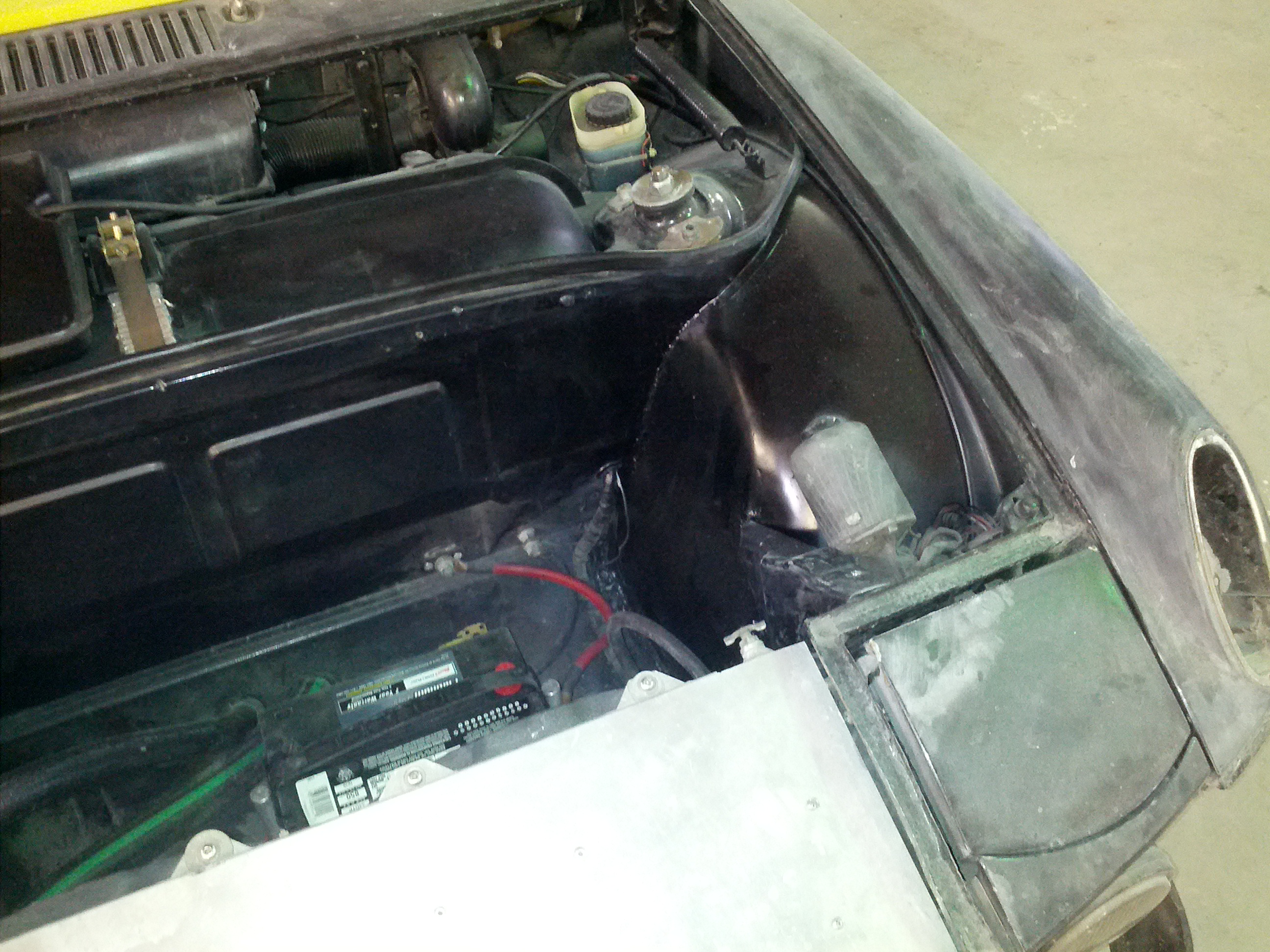

here is an old picture of mine.... multiple 1.5" holes with chamfered edges.
Looks much better than chopping out a gaping hole in the wheel well IMHO. Attached Image
