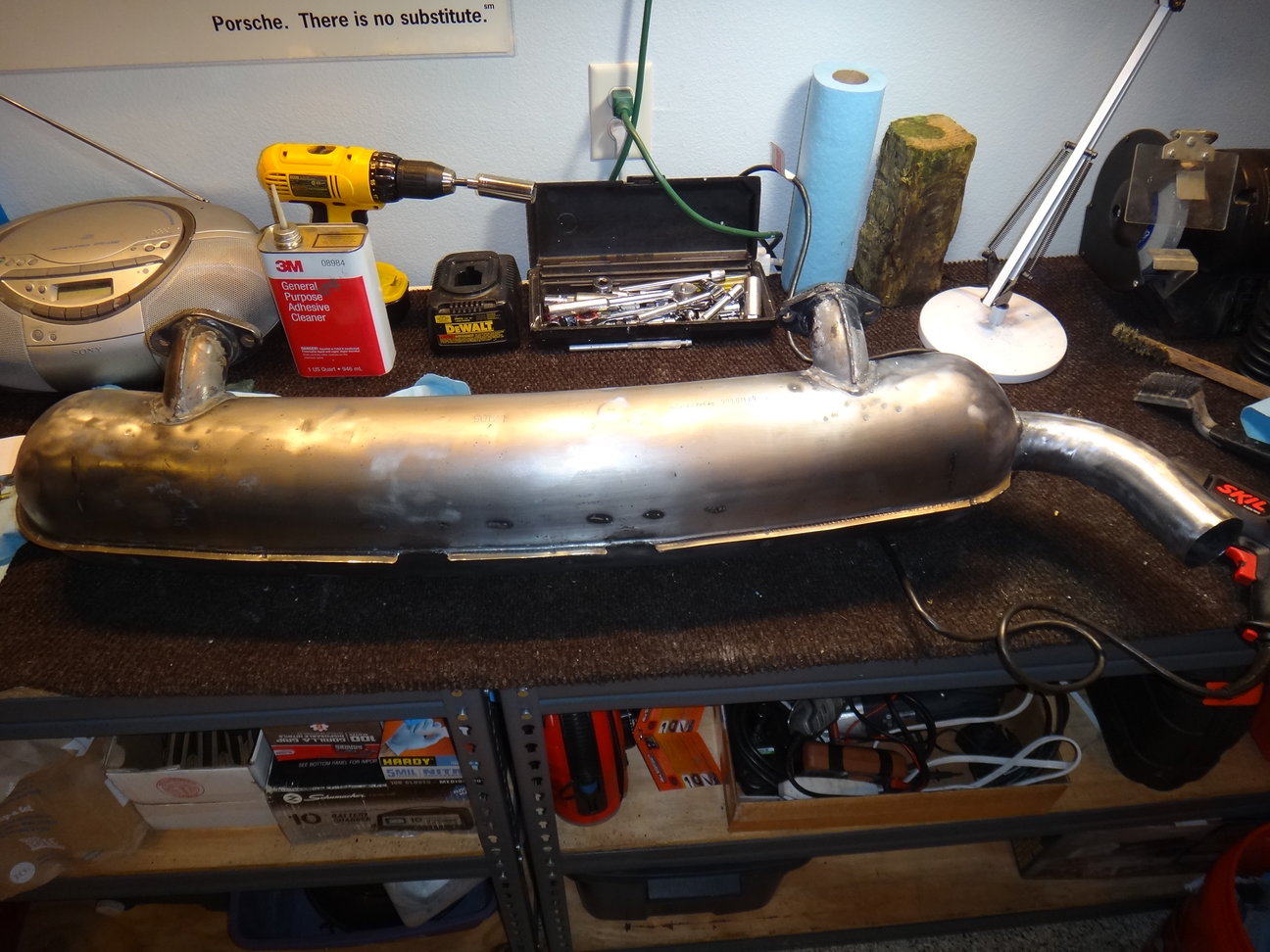

Recently purchased a 2nd hand Leistritz muffler.
Decided to put a more sturdy coating on it than the existing paint that was pealing off in many places.

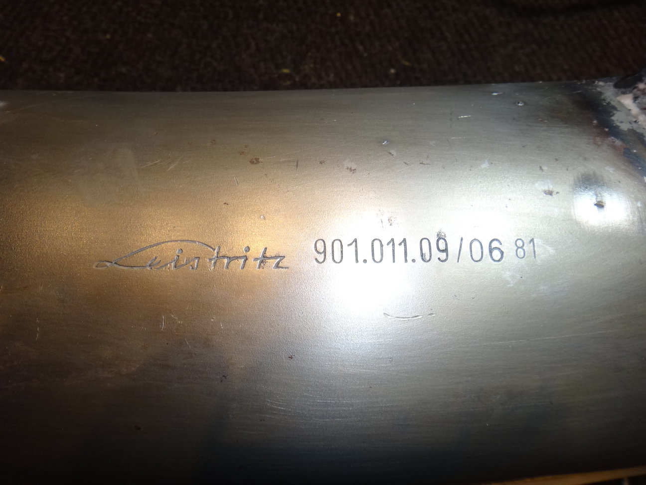

Lestritz is the muffler of choice for early 911's and 914-6's.
Their build quality and sound are 2nd to none.
They are tough to find as new ones have not been manufactured since the 1980's and the prices of early 911's has gone stratospheric.
Paint remover, scotch pad and wire brushing got me to this stage...bare metal.
Truly an authentic Lestritz.

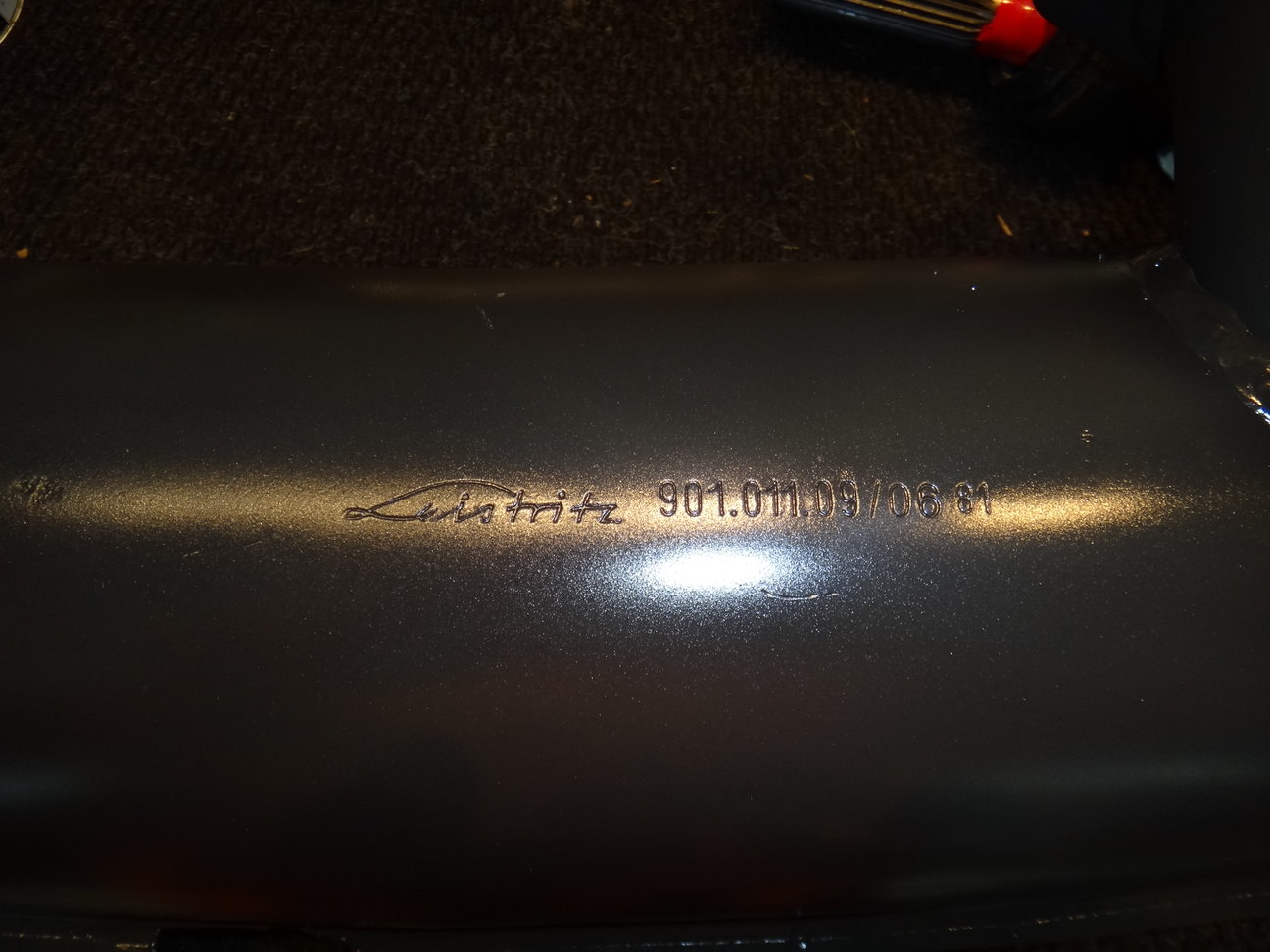

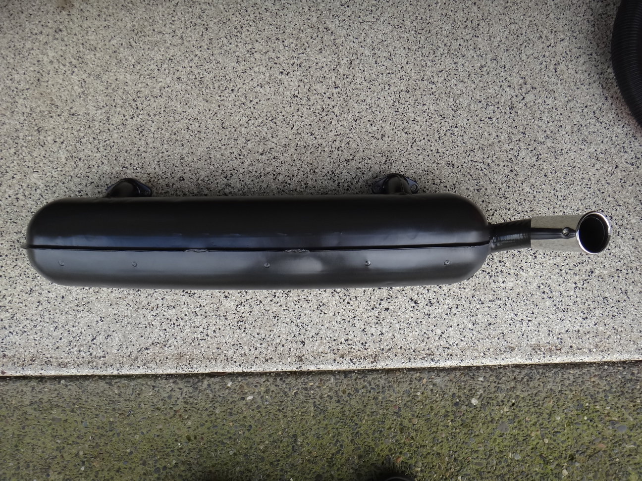

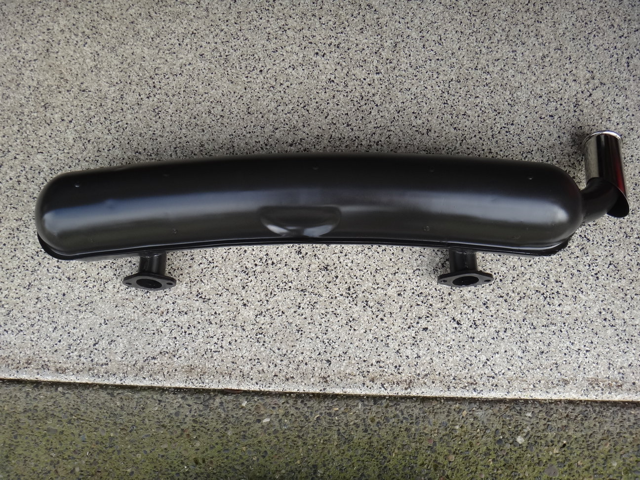

Back from the coaters with a titanium colored ceramic applied.
Just thousands of an inch thick, but basically good for the life of the car.
Won't discolor with heat.

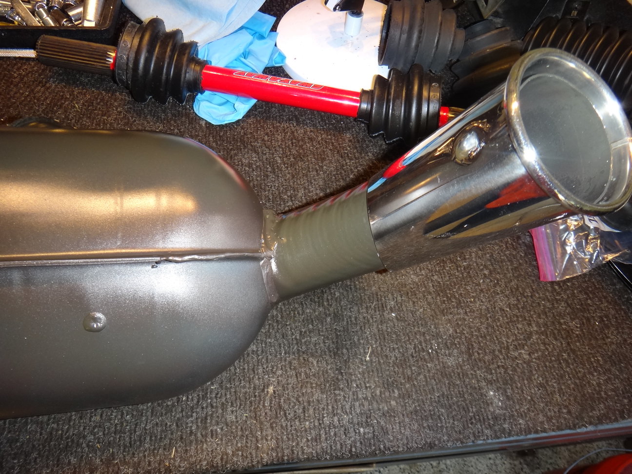

Found a nice stainless steel muffler tip on Ebay for a great price.
One more thing that won't easily rust on this car.
The ceramic coating is so thin that all the lettering on the muffler still easily shows.
