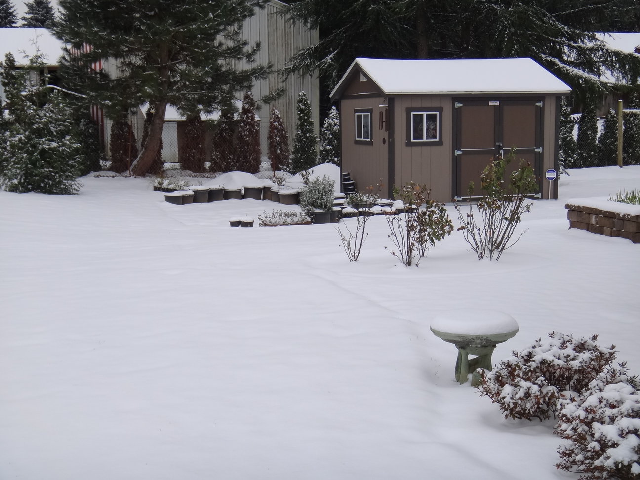

We've recently had a good amount of snow here in the Portland area.
Nice time for some inside projects?
What's a person to do?
Could make miniature snowmen with the wifey? Or....

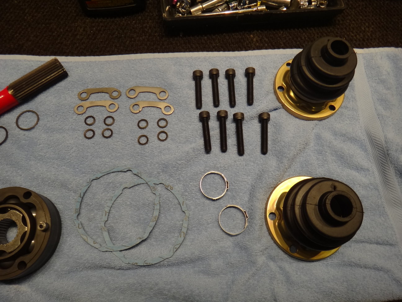

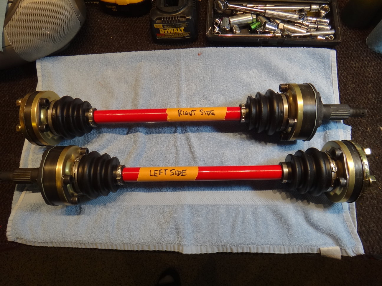

Finally get around to putting this mess of parts together!
Doing the PMB classic high hp axle build up.
Purchased the Sway-A-Way axles, located a good set of 2nd hand 911 axles, got everything cleaned up & replated, purchased the necessary new items and I was ready.
New CV boots and gaskets off Ebay.
Belmetric sent me the Oetiker ear clamps (74mm and 35mm), M10 zinc plated Schnorr washers, and the Grade 12.9 M10x50 CV bolts.

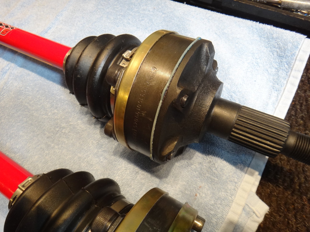

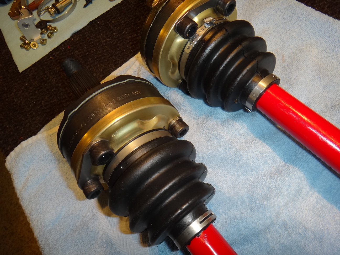

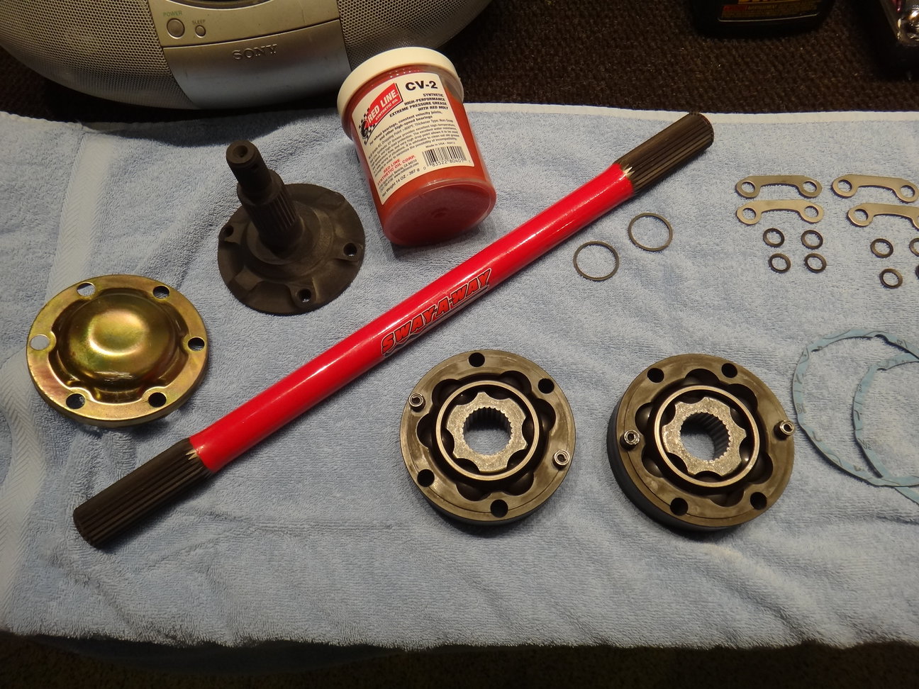

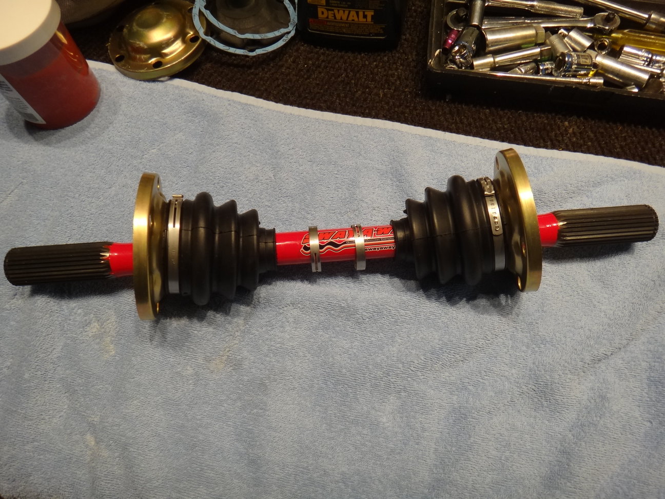

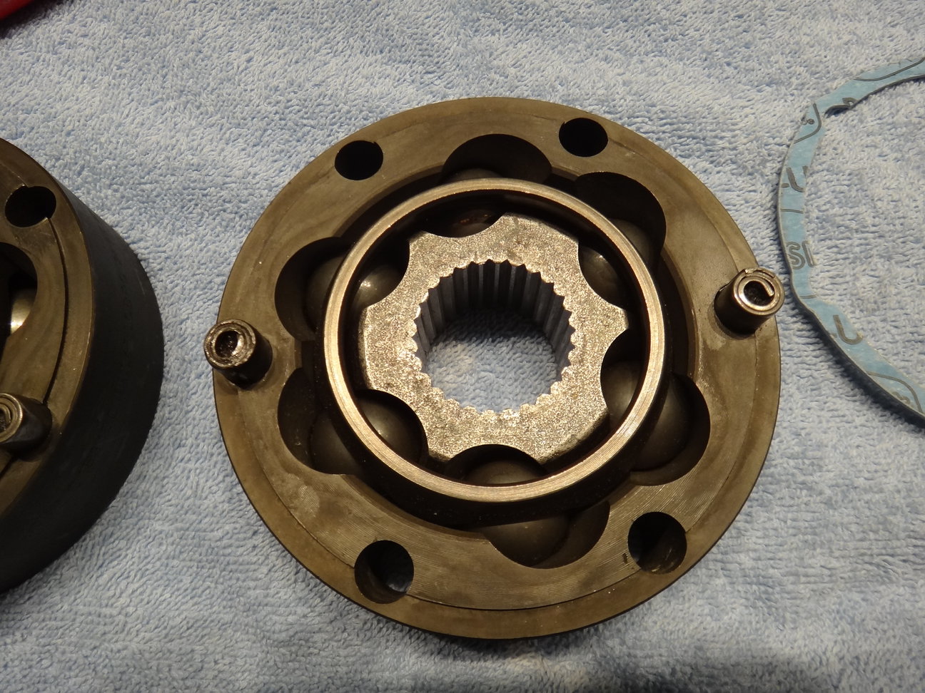

The 911 CV joints were cleaned and inspected (in great shape) and put back together in the correct manner....short to long.
Install the boots on the newly plated flanges, tighten up the big Oetiker clamps and slide the boot assemblies on the axles (not a trivial undertaking) with the small clamps ready to go at a later date.
After loading up the CV joint with plenty of Redline CV-2 high performance extreme pressure grease, I started to assemble the CV joints onto the axles.
A ring clip goes on the end of the axle.
New black phosphate coating on the 911 stub axles and new gaskets evident.
Also the M10x50 bolts are just the right length to barely come out the back side of the stub axle.
Freshly replated boot flanges, new boots, clamps, bolts and washers all make for a nearly new looking axle assembly.

Finished product goes on the shelf with other parts for later installation.
I'll torque them up later
These should handle the 200+ hp that my 911 engine will be putting out....at a much later date.

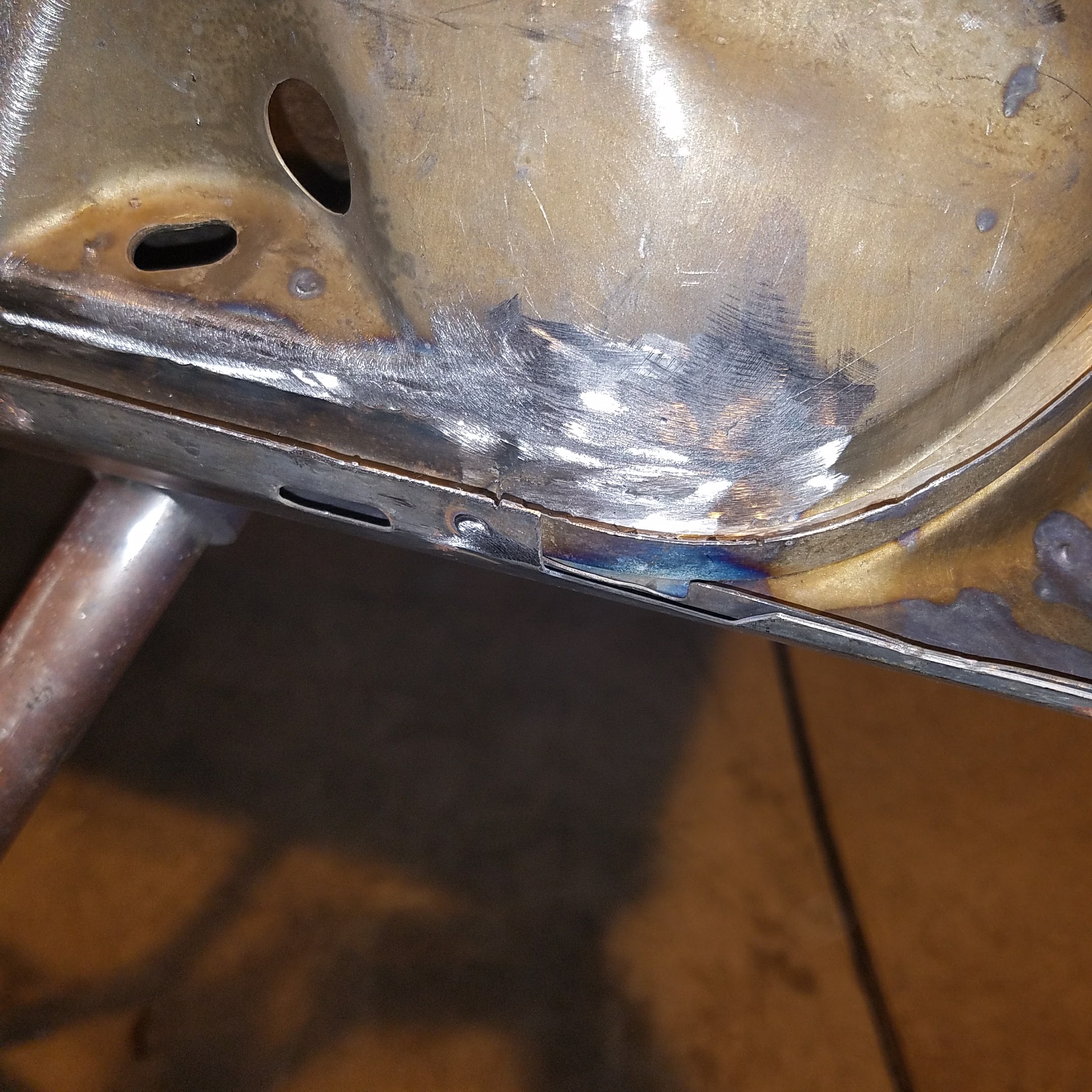

Went to work on the damaged upper portion of the speaker hole on the right door. I don't get why it had all the hammer and punch marks too. Oh well, we'll just fill them in. Super In Law cut out the patch in two pieces. It's been a while since we used the shrinker/stretcher.
Next on to surveying the rust damage to the seal channel. Once again, I'd like to say how nice it is to work on this stripped door. Best I could tell the metal under the channel wasn't damaged. So I decided to remove just the channel flange.
The only issue was figuring how to cut the section out. So I decided to go old school.
Drilled a starter hole, just like you would for a jigsaw cut. Except being metal I can weld the hole and slice closed.
Once again I cut down the spot welds with the cutting disc on the mandrel. We'll start calling it the Johnny wheel. After cutting it almost down to the parent material I pop it off with the narrow wood chisel.
Then onto the other end.
End cut.
First patch was in a double layered area. (IMG:style_emoticons/default/mad.gif) I delicately cut open the outer layer.
Using the same method to cut out the rusted sections. This will allow me to make smaller patches.

I did also weld up a split out hole that holds the inner window seal.
Doug stopped by right before lunch to check on the progress.
At the end of the visit we kind of came to the consensus that I'll probably be doing the blasting/stripping myself. Looks like I might be ordering a Texas Blaster.
https://www.texasblaster.com/index.php?disp...p;product_id=25
I guess we'll be giving my new air compressor its first test.
Doug also brought a couple brake dust shields that had split out bolt holes. Welded those up so he can get them powder coated.
