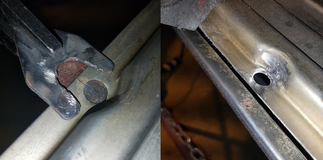

1st. order of business was to spot weld in the first replacement door seal channel.
Gave the bottom of the channel patch a shot of weld thru primer. Should be good for another 50 years.
You'll notice the plywood backer against the door skin to keep from dimpling the skin.
Then I welded up the split/cracked window seal fastener hole on the right door.
Doug, I found another drilled hole on the left door ................ (IMG:style_emoticons/default/idea.gif)

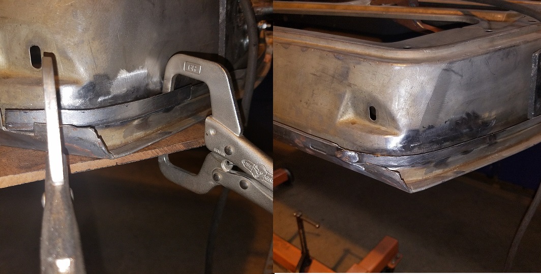

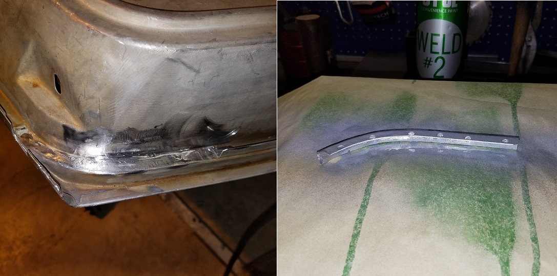

Then I cut out the 5th rust spot. This time the seal channel is in the way. (IMG:style_emoticons/default/mad.gif)
At the end of the day I started tinkering with seal channel patch #2. Looks almost like a roller coaster ................ Follow the yellow line.

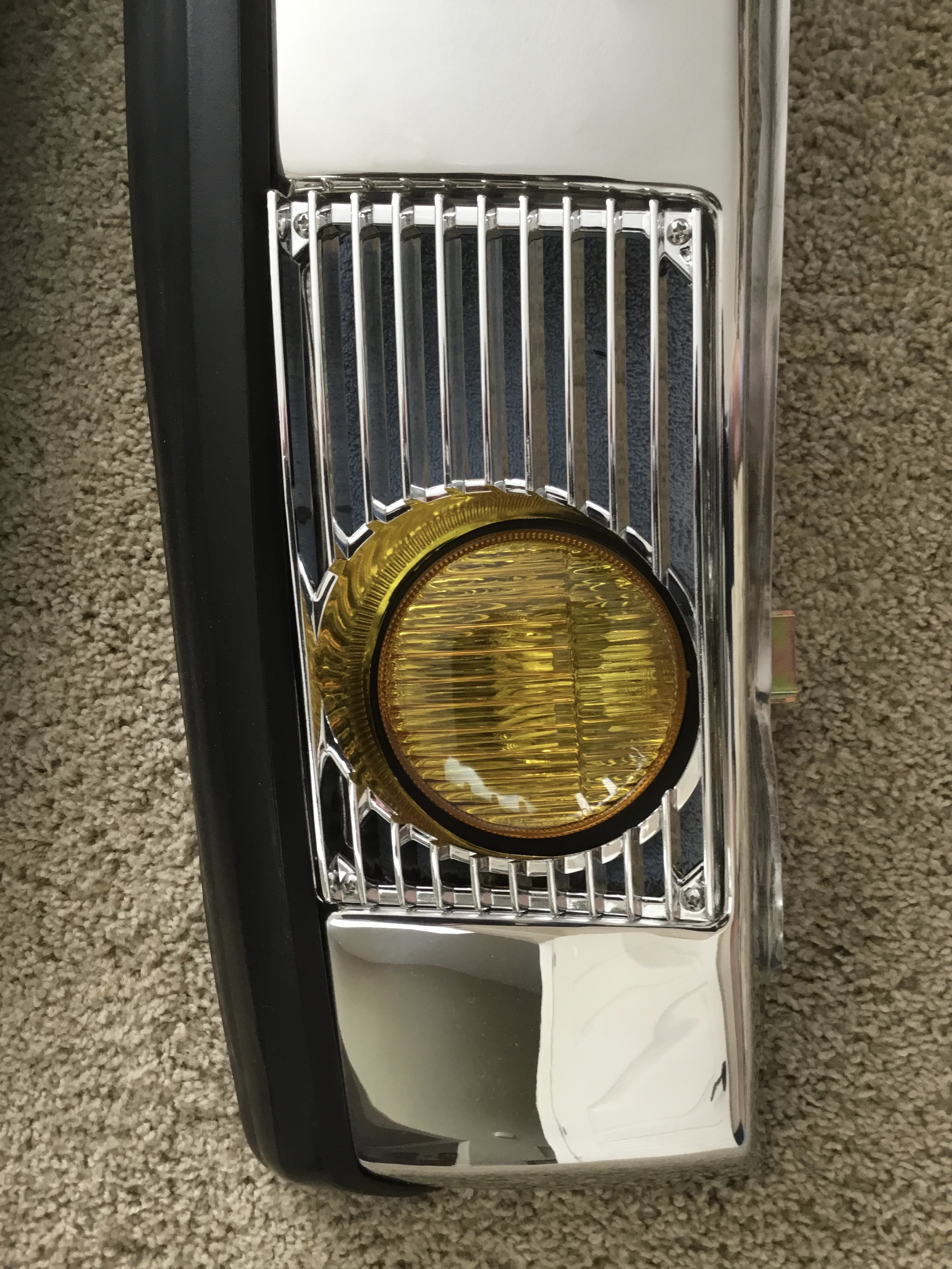

Received my stainless steel bumpers. Minor filing needed to fit the 914 Rubber fog light grills and the license plate bracket speed nuts.
The yellow fog light lens look pretty sharp.

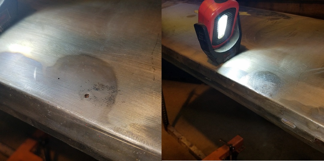

Forgot I do have one section of Rembrant work to do.
The radius's don't match. (IMG:style_emoticons/default/sad.gif)
Later radius is smoother.

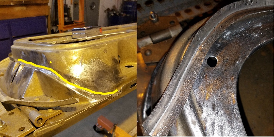

Then on to the left seat belt retractor. Next task was putting the flange on the pocket so it will lay behind the firewall for strength.
https://www.harborfreight.com/air-tools/spe...-tool-1110.html
Lots of Rembranting to get a nice fit. The half a dozen long reaching Vise Grip clamps came in handy again. I worked on this while Super In Law was creating the jack point sheet metal patches. The indent for the tube had to be pressed/hammered in.
Blasted and weld thru primed and ready to go for tomorrow. I'll clean off the weld thru primer with lacquer thinner prior to respraying with epoxy primer.

Could have welded just a smidgen hotter for flatter rosette welds. The upper weld on the tube is a bitch with the fender attached. First shot was in the upside mode. NOT.
Ended up full power and a long stick out. Don't forget to turn up your welder when you get the the tube. (IMG:style_emoticons/default/dry.gif)
Biggest issue was the inside fender 4 rosettes. 1. Next time tape off the area prior to spraying epoxy primer. I need a longer and wider belt sander. Getting that area down to bare metal was a bit of work. Tomorrow I'm going to try the 45 degree die grinder with a 3 inch disk. 2. I didn't want to take the time to pull the readers out of my Miller Face mask so I left hand welded it with my eyes closed.

Reusing the tube I didn't like the way the radius met the bottom of the long so I straightened it and rebent it.
I weld in the vertical rosettes first then hammer it down.
Back in business ..................
In addition to the longer belt sander I'll need to find a magnetic mirror so I can see the hole on the last 2 holes.
In the future I might tinker with using the Panel Spotter in this spot. Need more practice.
