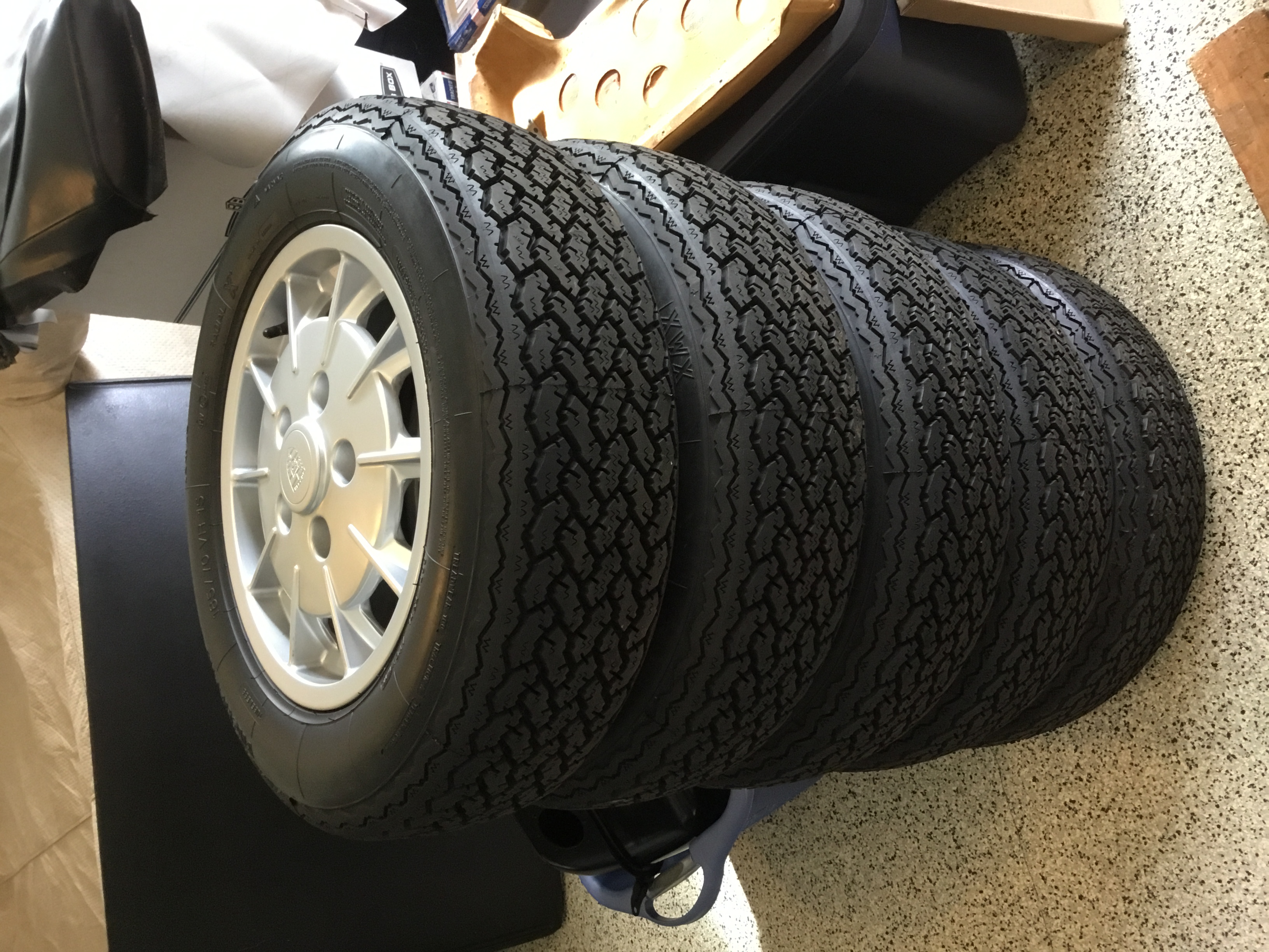

New shoes for the car.
A set of ultra-lite Mahle gas burner wheels that have been repainted.
Shod with Michelin XWX 185/70VR15 tires.
These will be my everyday running around set up.
Pretty amazing how light this tire/wheel combo is.

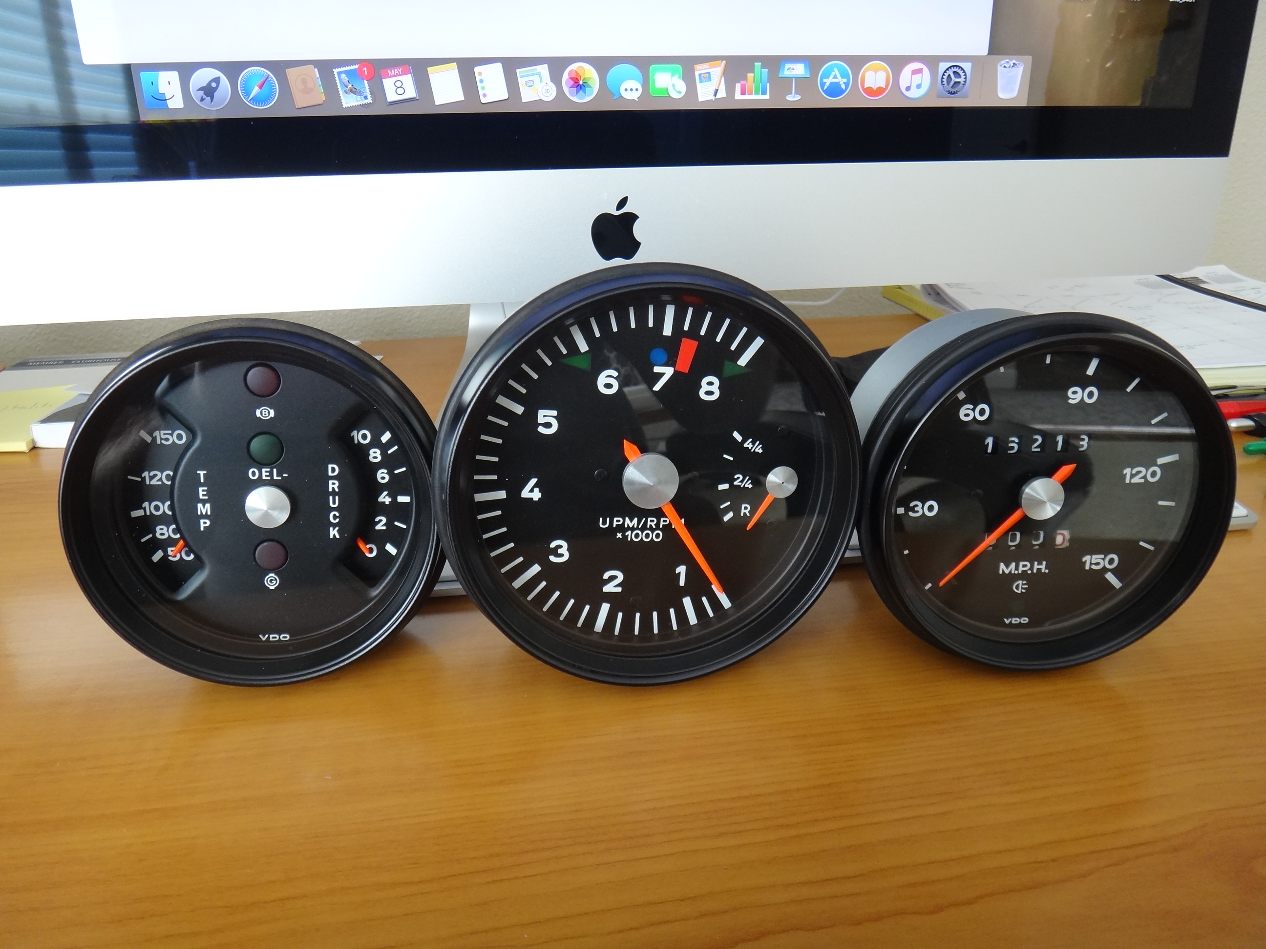

Also just received my gauges back from North Hollywood Speedometer.
This took some time....nearly 10 months, but the wait was worth it as they always do a great job.
Not inexpensive, but I wanted a few special touches, so they were my choice.
Converted the 911 multi-gauge to all metric or Euro? Druck (oil pressure) in bars and the oil temp in C.
The speedo was given the later 914 look as the early 914 speedos just have too many numbers for my taste and look too busy.
Finally the tach was rearranged with the addition of the fuel gauge as well.
All new bezels, glass, pointers, center buttons, etc.
Gauges look flawless.

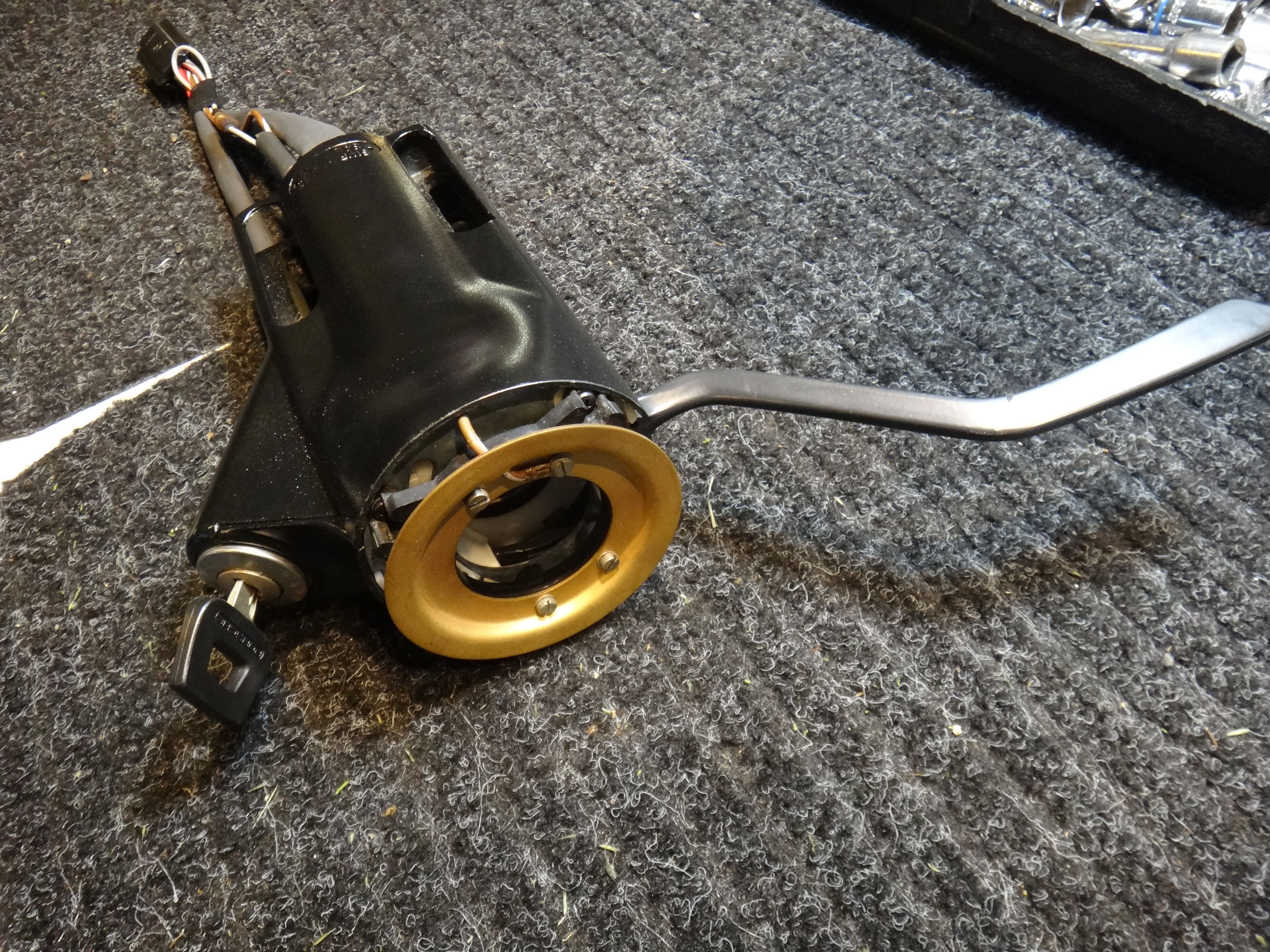

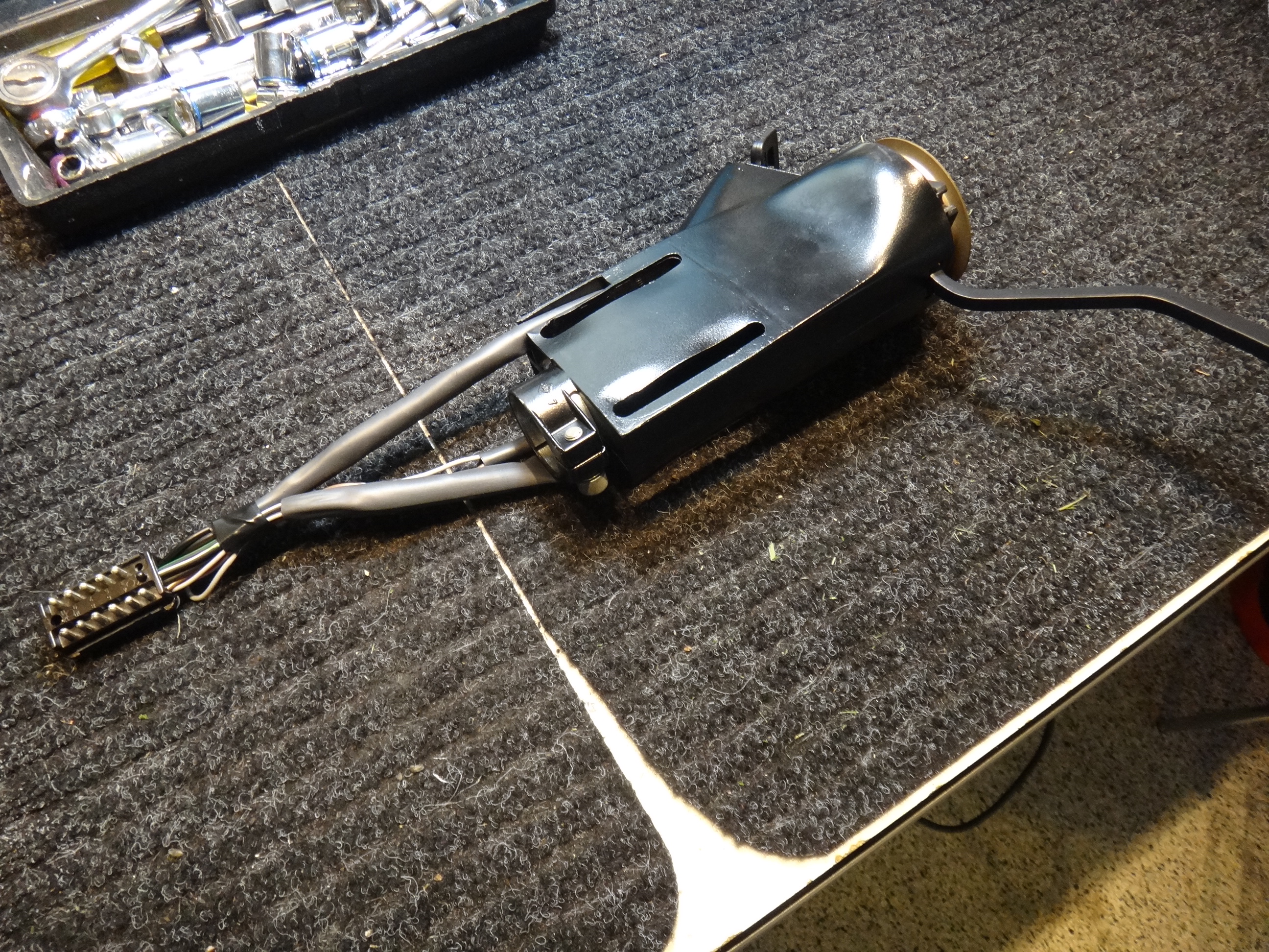

Rebuilt the steering column today.
Repainted the housing, installed a new turn signal switch, new ignition switch, rekeyed ignition lock all with new shrink tubing and a 12 pin connector.
Talk about a fiddly job.
Routing the wires so you can get the whole mess through the very tight opening in the housing, soldering new male pins on all the wires, checking and rechecking wiring diagrams from various sources to make sure I understood what every wire was and where it was supposed to go.
It was a total hack job when I disassembled after purchase.
The previous owner(s) had been naughty and lazy folks in replacing the ignition in the past.

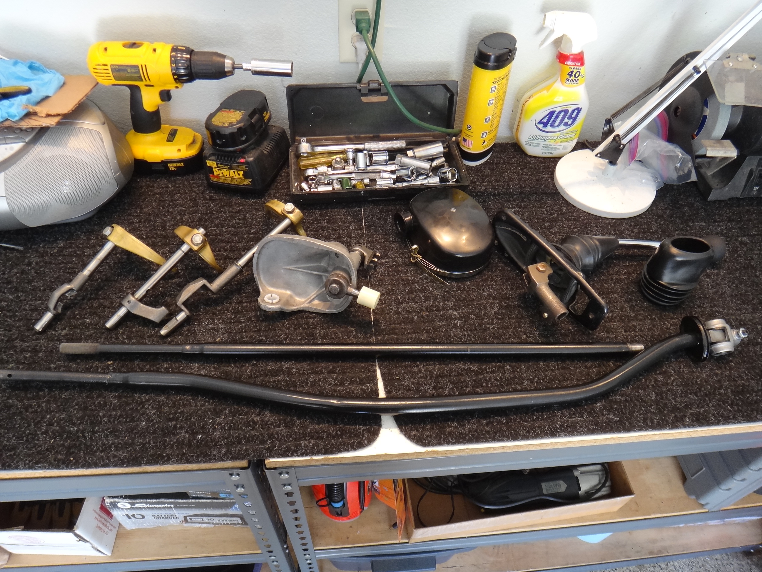

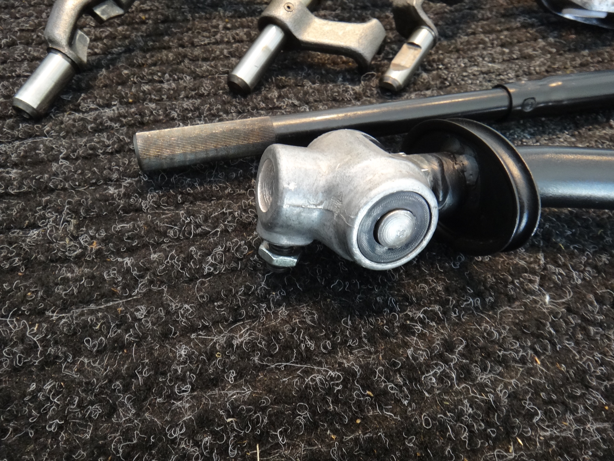

Obtaining/reconditioning parts for the side shift conversion.
Purchased the shift forks, rear console, rods and shifter from a couple of 914 World members. All the parts were in great shape. Just needed some cleaning and new bushings for the most part.
Cleaned and repainted the two shift rods.
The rod bushings on the rear rod had turned to the consistency of candle wax.
Completely shot.
So replaced those with a set from 914 Rubber.
Also purchased a new rear console cover with band from 914 Rubber as well.

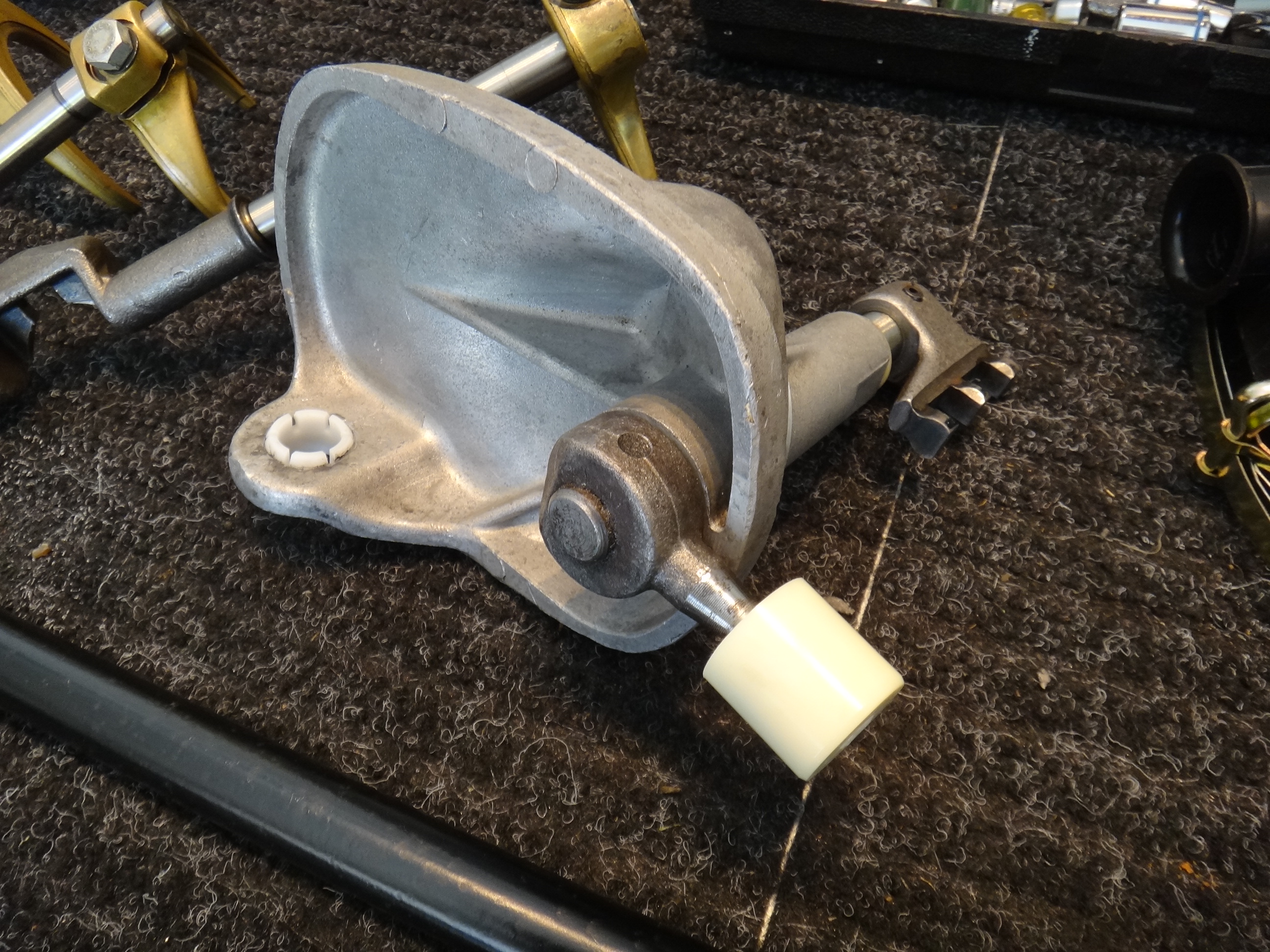

Close up of the new shift rod bushings.
Your friend is a vise when driving out and replacing the locating pin.
The set screw has a locking nut which is really slick.
Comes from JWest Engineering.

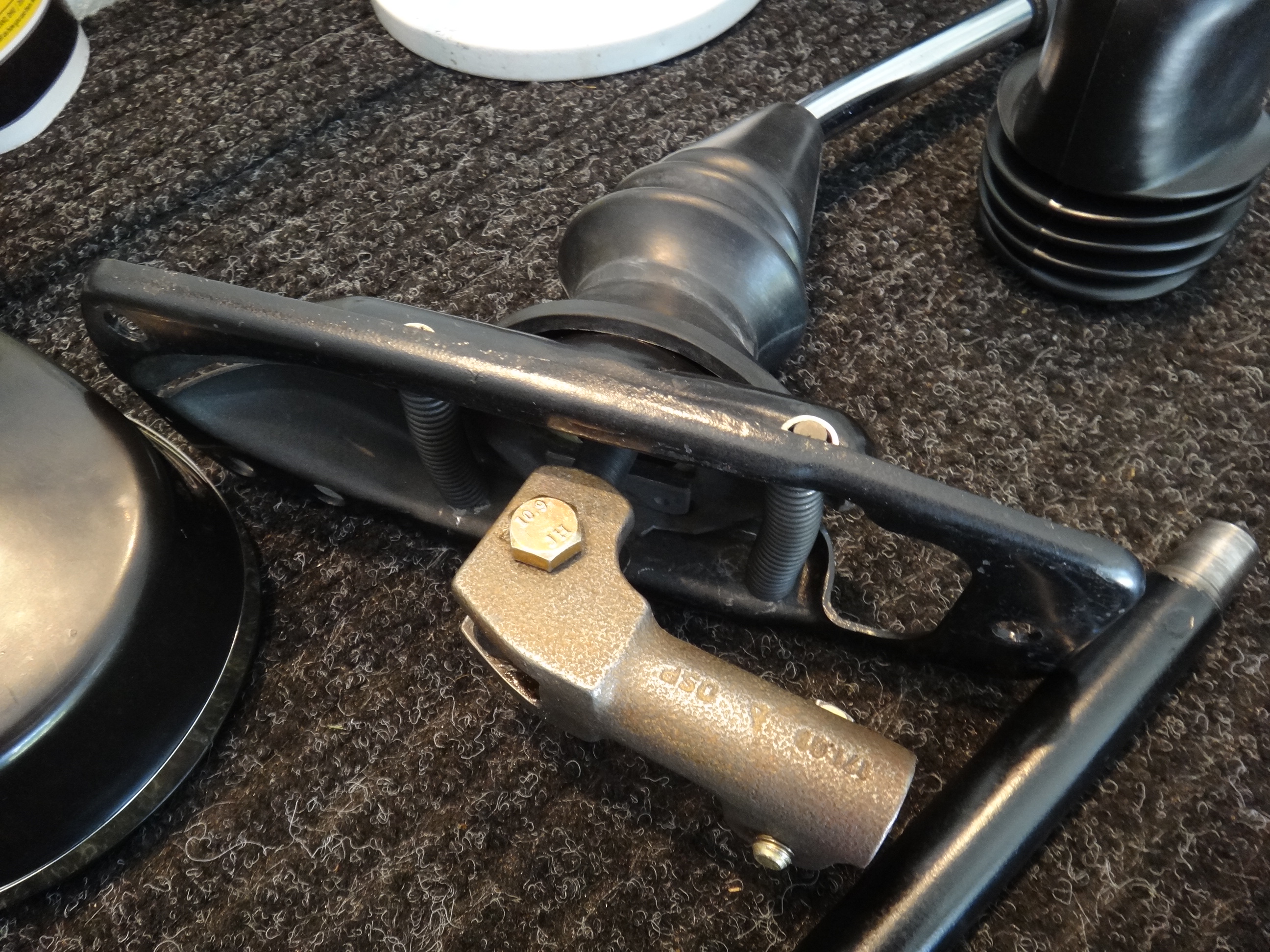

Pulled the shifter apart to clean it, paint it, inspect the components.
Everything looked great including the two plastic pieces on either side of the spring up inside the housing.
A new coat of paint and reassembly was all that was needed.
Getting those two long springs back in place was a minor battle, but I won in the end.
Some new hardware, boot and shift knob...and this job was complete.
