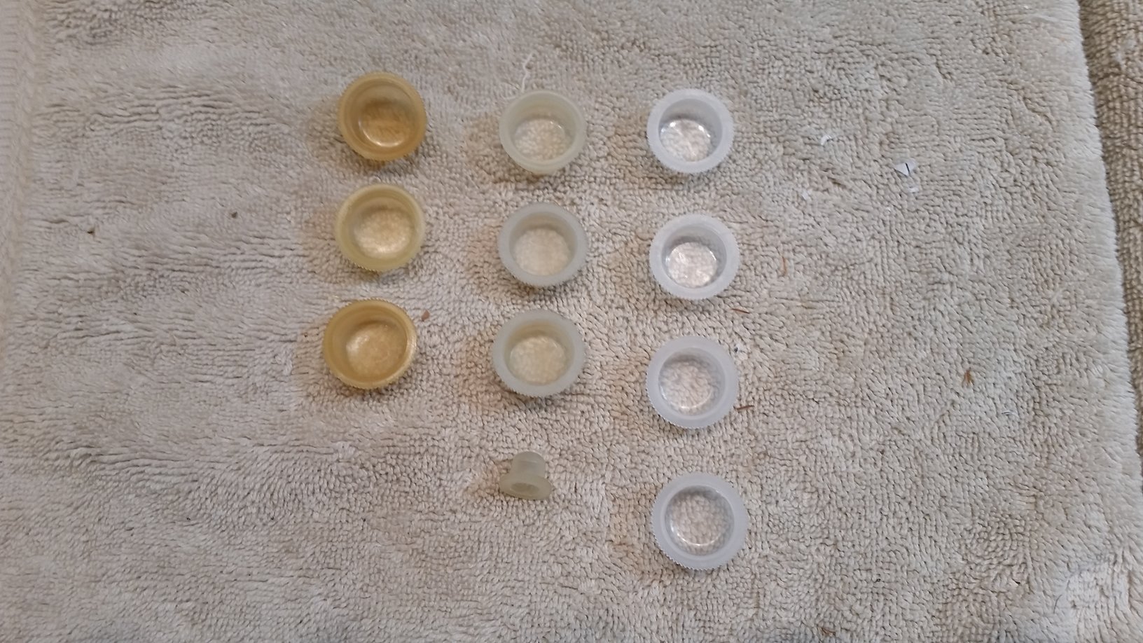

A bit of show and tell.
Parts, tools, etc.
Fun stuff.
Below you'll see some of the common plastic plugs found in the rear trunk of the 914.
On left are the original ones that have come out of the car after 46 years of dirt, oil, undercoating...you name it.
Your typical yellowing that this type of light colored plastic picks up from aging.
In the middle, is a set of these original plugs that have been left in dilute bleach for a couple of weeks.
Cleaned up nicely from the original, but still a bit dingy for my tastes.
Last column are a new set of 19mm plugs I purchased from Aase Sales. About a buck each.
I know which ones will be going back in my car after all the body/paint work. (IMG:style_emoticons/default/wink.gif)

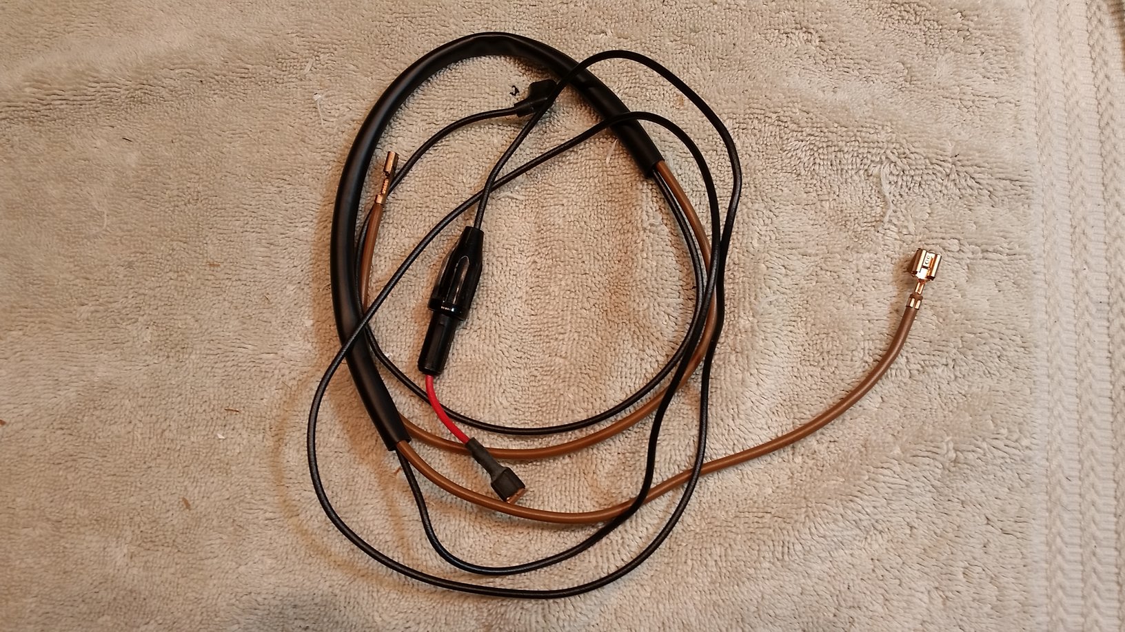

Next is an NOS radio wiring harness I found.
Just the ticket for wiring up my vintage Becker stereo when the time comes.
I already located the special speaker connectors needed for the radio.

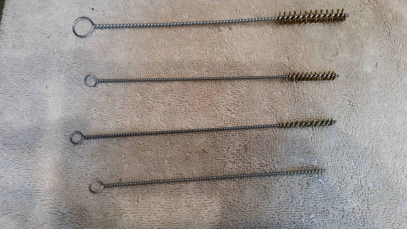

Founds these small specialty brass brushes on Ebay.
Some sizes are very useful for cleaning out the terminals in the socket where the round relays go.

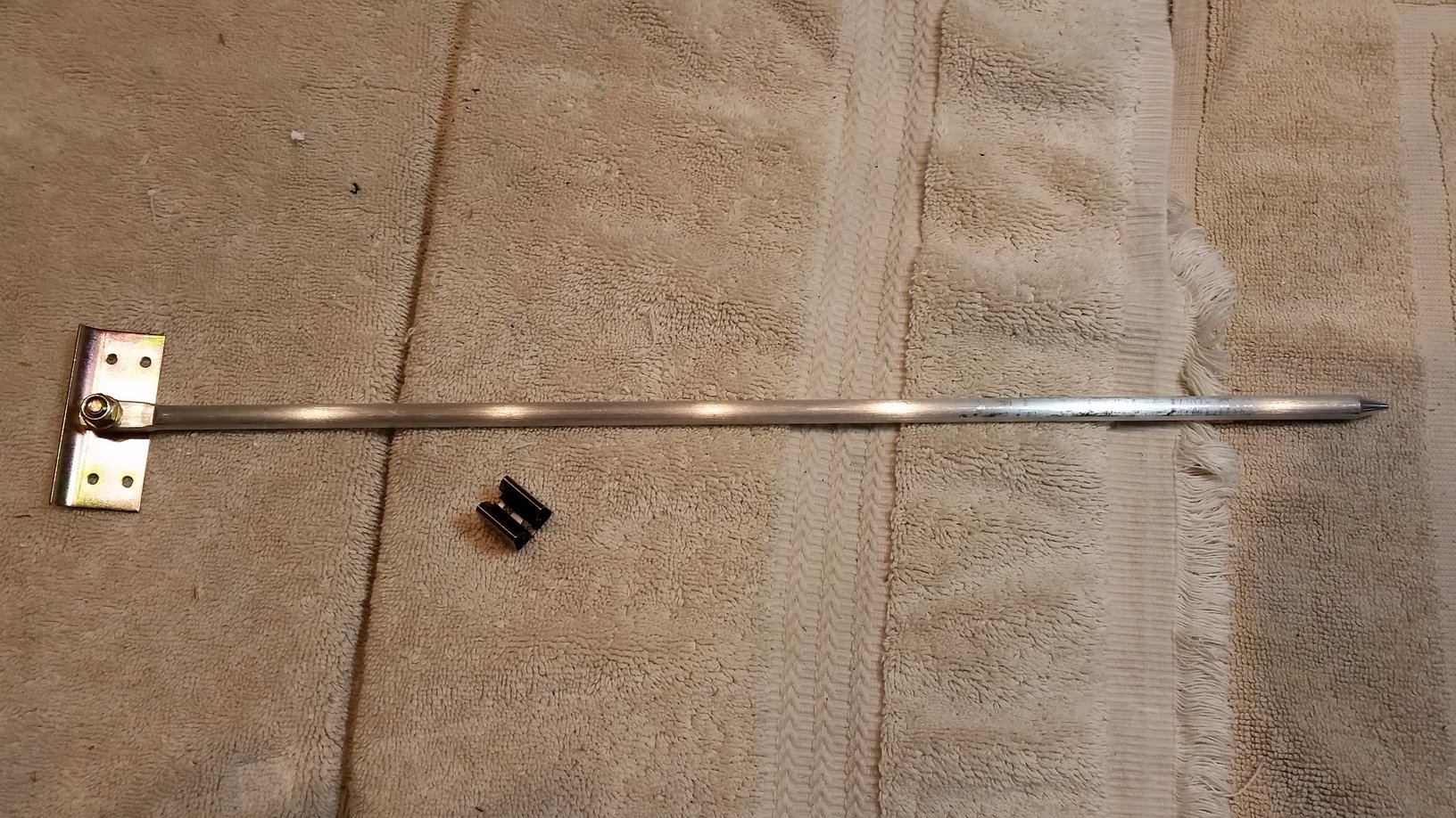

Guess this next guy is called a 964RS (993RS) hood prop rod.
Porsche part numbers and not all that expensive.
I'll be using at least one for my rear fiberglass GT bonnet.
I'm up in the air for the front trunk lid.
May use the same as here....or get a more proper GT hood prop put together.

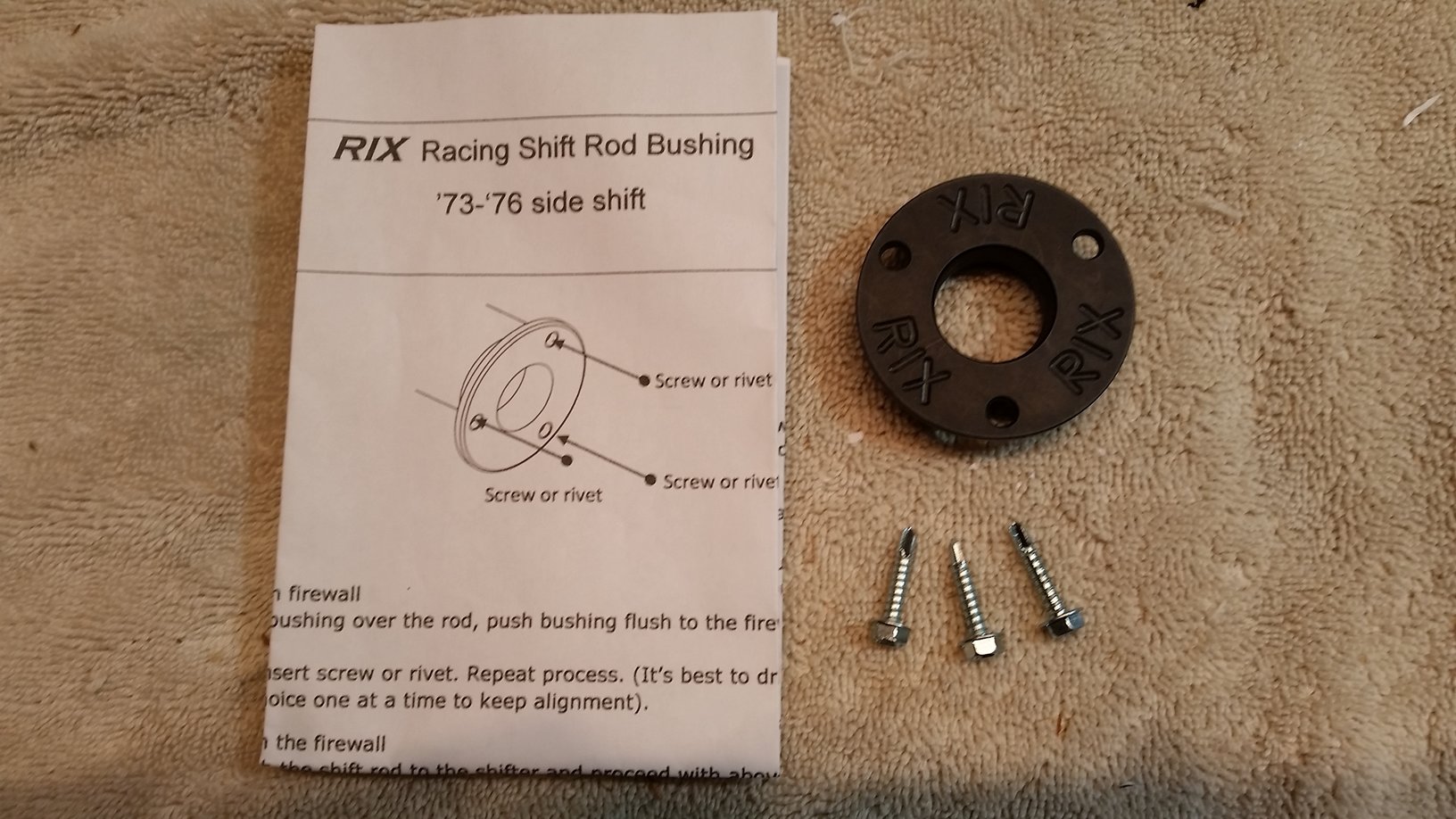

Purchased a nice shift rod bushing that gets attached at the firewire.
Necessary for the side shift conversion the car will be getting.
Not sure if I'll sheet metal screw it in (screws provided) or simply rivet it in place.

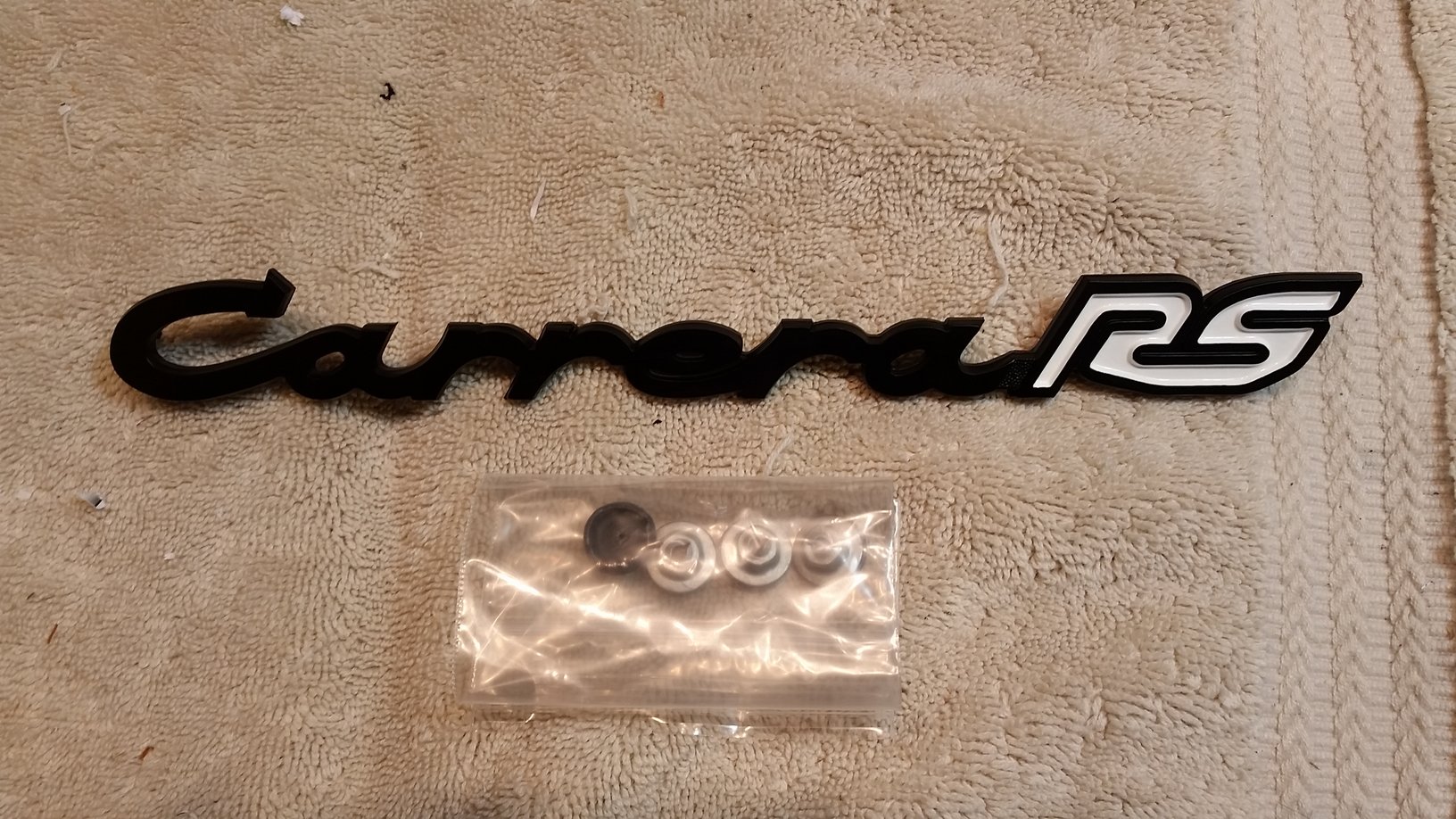

Last but not least....for my other P car, so really OT here I would think.
I have a 1973 911 that over the years has been converted into an RSR hot rod.
The ducktail I have came from GT Racing has never fit well, but I've lived with it for over 25 years.
I've asked Santa for Christmas a very special replacement ducktail with an aluminum base that will fit much better.
Instead of reinstalling a new set of Carrera RS decals on the tail, I'll be going with this metal emblem instead.
A few of the original cars had these instead of the decal.
Think it gives a much different look to the car.

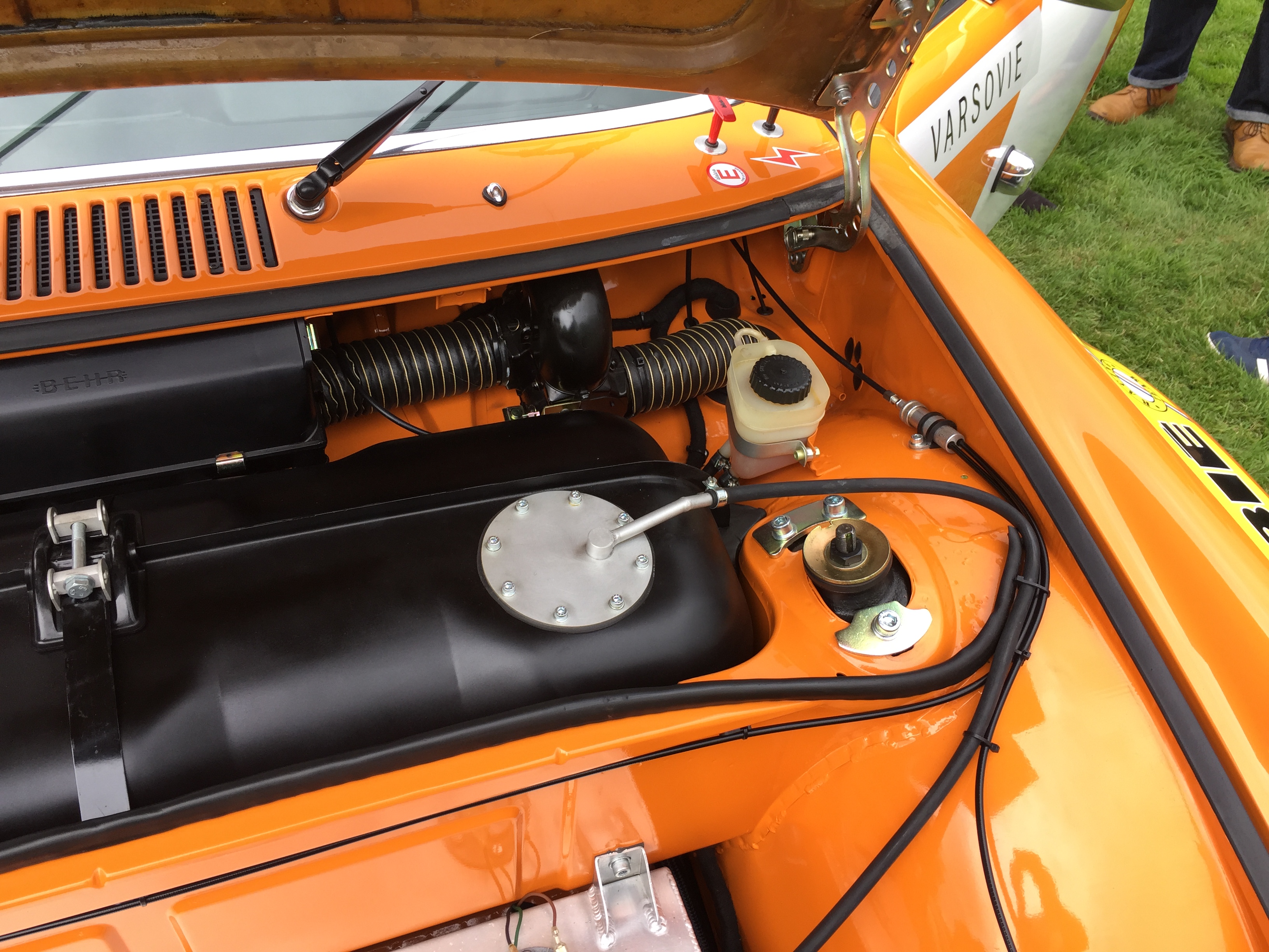

Alternative idea for the prop?
I've never seen this method of hood prop before but it seemed to work well on this GT ('71 car #0137)
Not the best picture but if you zoom in to the hinge you should be able to see a knurled pin that goes through the hinge and into I think the kidney shaped bracket. Pins on both sides & wind can't catch the lid
Car is looking great BTW & your going to love MFI although if she ever refuses to start or is hard to start dont overlook the removeable fuel output spigot on the MFI cold start assembly. It has a very small check valve and after so many years of service mine gave up the ghost after a winter lay up. Insufficient pressure to start the car / fuel just circulates back to the tank. Had me and the AA guy totally foxed. Swapped in a shop and the 911 now starts on the button every time whereas before it took some cranking

I could be mistaken but those small brass brushes look to have come straight out of a gun cleaning kit. They are great brushes.
