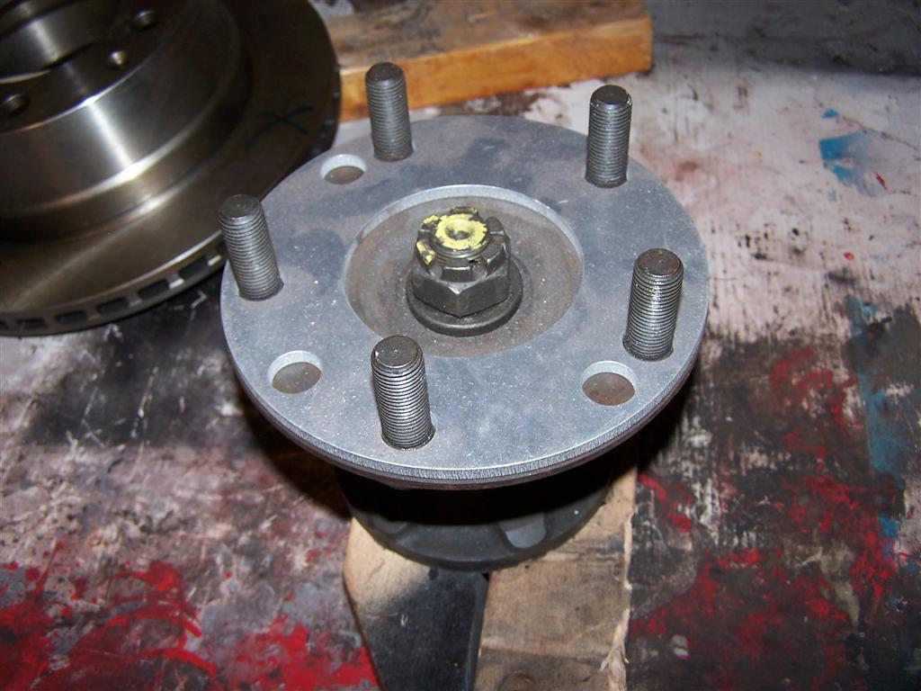

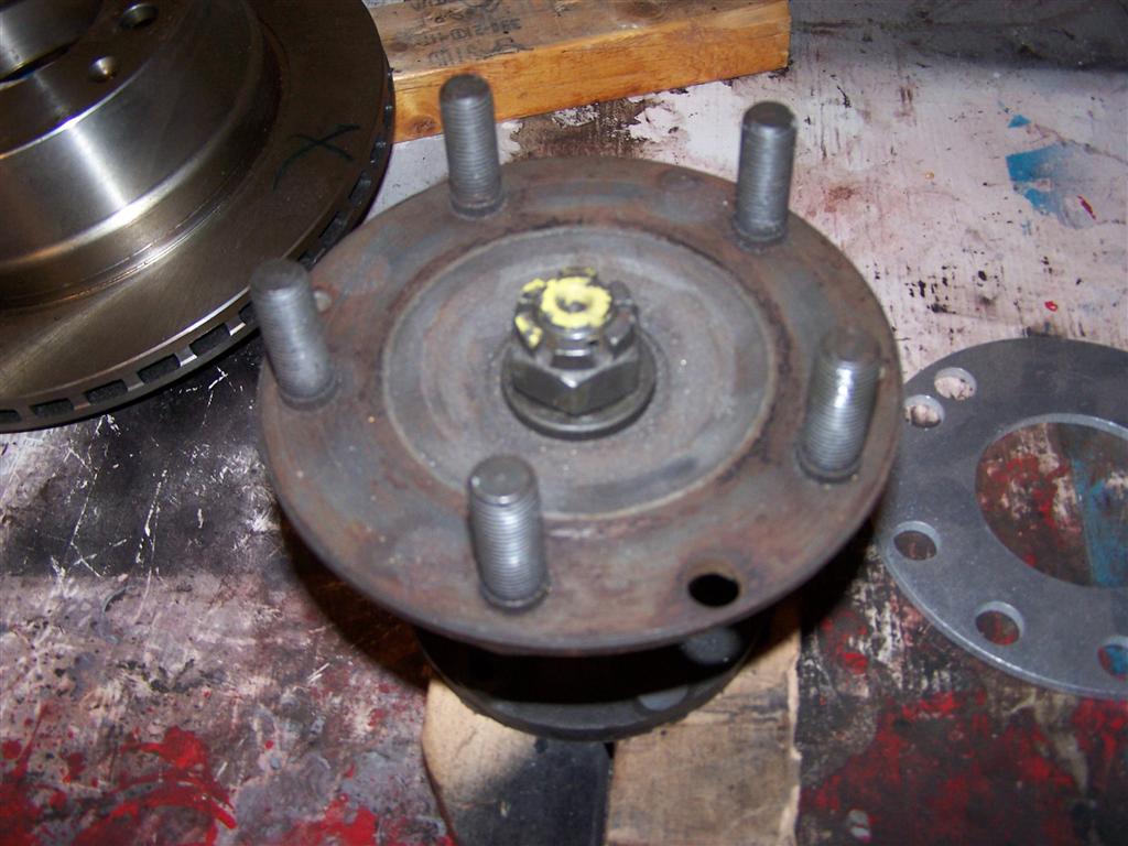

The next project for my 914 is converting to 5-lug suspension. I have the front struts and rear hub from a 1972 911 to start with.
The rear will have vented rotors. I have some questions about doing this part of the conversion.
Two questions:

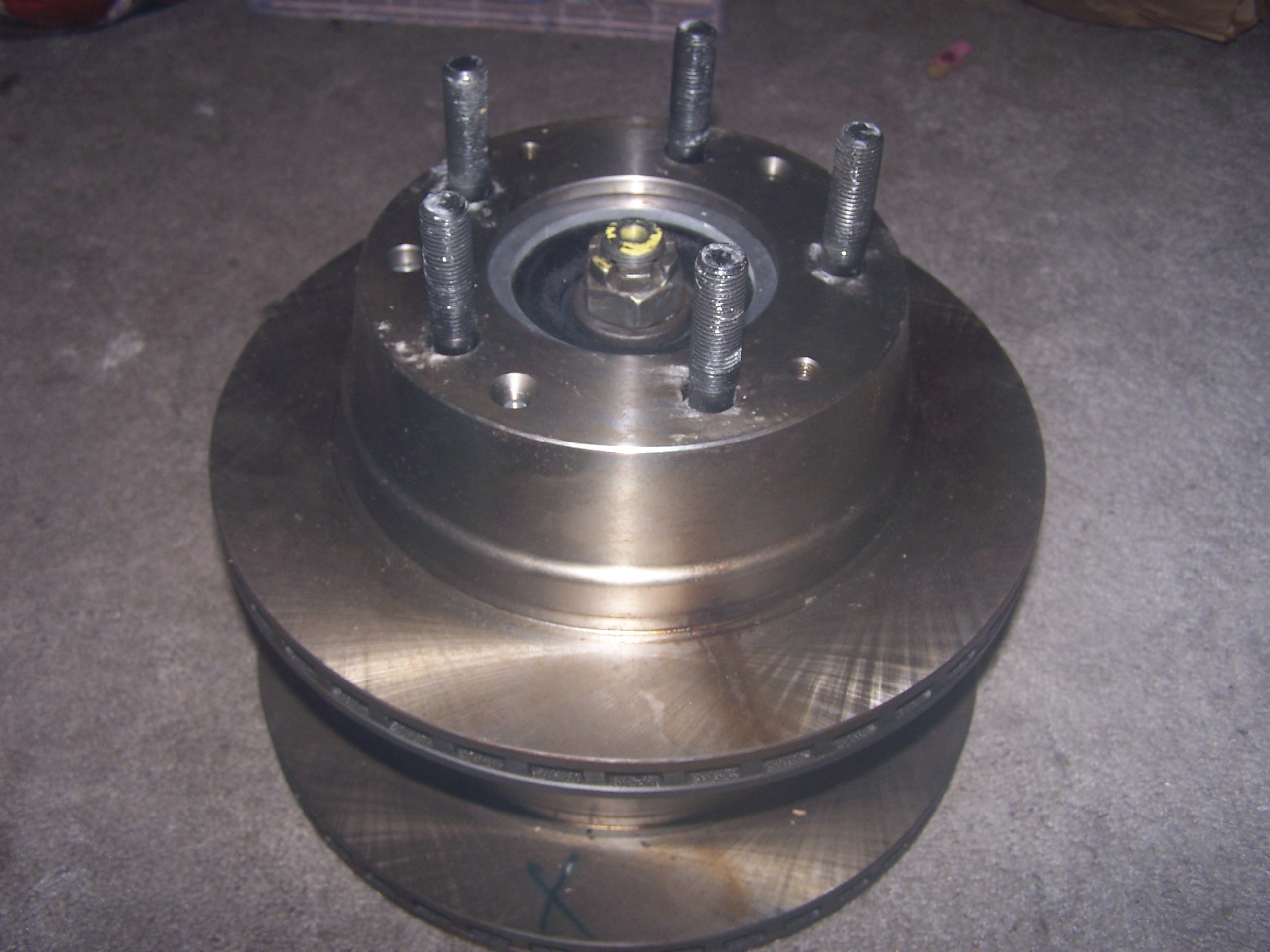

1) Will I need longer studs in the rear? Before adding the spacer, a lug would catch with 11 rotations on a stud. After adding the spacer, a lug catches with only 8 rotations.
2) When I add the spacer, the rotor is no longer centered perfectly on the hub. How do I center the rotor on the hub?
911 Hub
Hub with spacer
Hub with spacer and rotor. 911 rotor has been cut by Eric Shea. Thanks E.
With the spacer, the lug only catches with 8 revolutions, down from 11 in its stock state. Is this enough or do I need longer studs?
With the spacer, the rotor lip that centers it on the hub now misses the hub because of the spacer. How do I center the rotor now? Do I use just the 2 little hold-on screws to center?

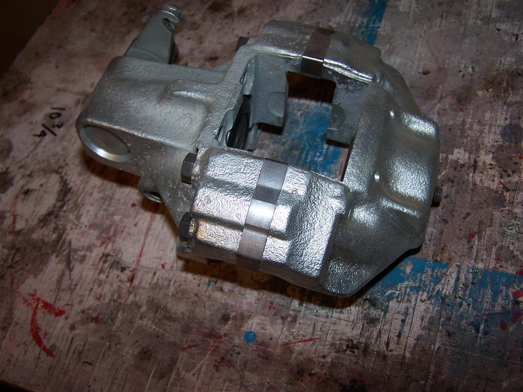

One of the calipers that will be used.

The spacer always goes on after the rotor. Unless you need it to space the rotor to match the calipers.
As far as stud length goes, my guideline is to use open end lug nuts and as long as the thread is at least flush with the outside of the nut, i call it a day.
If not, i use longer studs.

This spacer goes under the rotor. It is to make up the difference in the width of the caliper 1/2 spacer.
Just install the spacer and use longer hold down screws... I have the same spacers on my car.
Mark the holes on the 911 hub onto the spacers and drill them through.

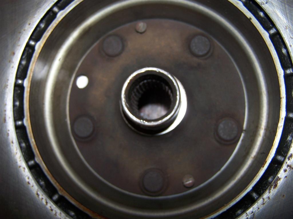

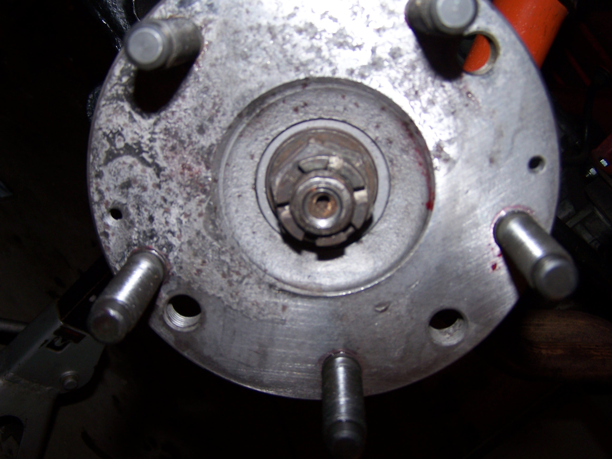

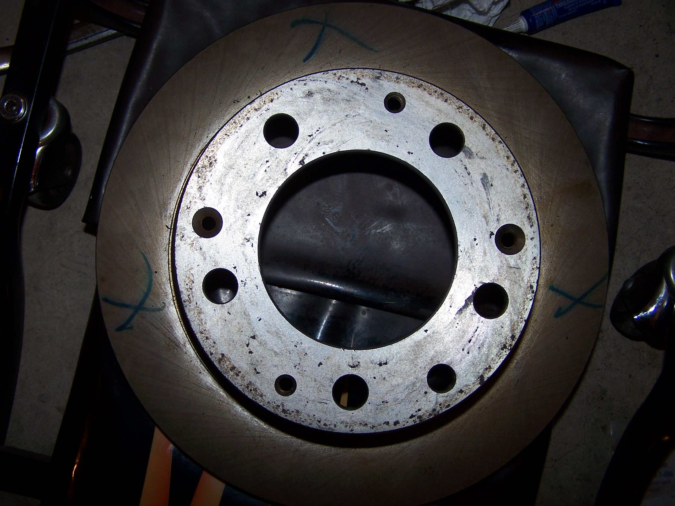

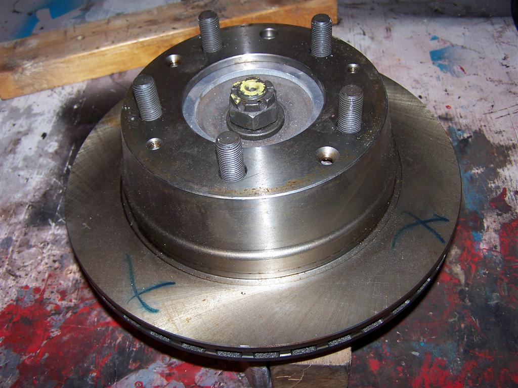

I opted to stay with re-drilled 914 hubs instead of the 911 hubs.
I am running into a problem centering the rotor. The rotor is a cut-down 911 vented rotor.
To center the rotor with a 911 hub, the idea was to use the rotor hold-down screws to also center the rotor.
But on the 914 rotor, the hold-down screw holes are not in the same place as the 911 rotor.
See the pics. The 914 hub has the hold-down screws centered about the axle. The 911 rotors are offset and not centered about the axle.
Any ideas on how to center the rotor?
The only thing I have come up with is spacers around the studs to take up the slack between the studs and the stud holes in the rotor.
Spoke
post Nov 18 2012, 07:26 PM
Jerry
Posts: 7,370
Joined: 29-October 04
From: Allentown, PA
Member No.: 3,031
I made a couple of spacers out of 10mil brass sheet and put a spacer on 2 lugs. There was no play in the rotor but the rotor has .01 inch end play as measured on the edge of the rotor.
Not too bad but the spacers are pain in the ass.
I think I'll try removing the spacers and center the rotor by measurement and using lug nuts keep it in place while I drill and tap hold-down screw holes to match the 911 rotor.
Anyone have any other ideas?

Just tighten the lug nuts down on the rotor ,Indicate the radial runout adjust with soft hammer, drill and tap your holes for CS screws.
Eric_Shea
post Nov 18 2012, 08:06 PM
PMB Performance
Posts: 19,304
Joined: 3-September 03
From: Salt Lake City, UT
Member No.: 1,110
For a permenant solution, install the rotor on the hub with 2-3 lug nuts, they should center the rotor as they tighten onto the rotor face.
Use a new sharpie to mark the location of the 911 holes. Use a 5mm drill and drill two new holes in your new hubs. You might even want to start those holes with the rotor still in place. Then tap with a 6x1 tap.
Remember, if you have spacers under the rotor hat, you'll need to grab 4 new (longer) M6x1 screws commonly available in the HD or Lowes "metric drawers".

QUOTE(Eric_Shea @ Nov 18 2012, 09:06 PM) *
I just finished one side using this method. I held the rotor with 5 lugs and adjusted the fitment until I had about .005 inch of play.
I drilled the holes by starting out with a drill just the size of the hole in the rotor. This gave a centered hole through the spacer. Then I used the 5mm bit to drill through the hubs and tapped with 6x1.
There is just a bit of runout and I can adjust it by loosening the screws and retightening.
Bought longer screws at Home Depot for $0.99 a piece. What a ripoff.

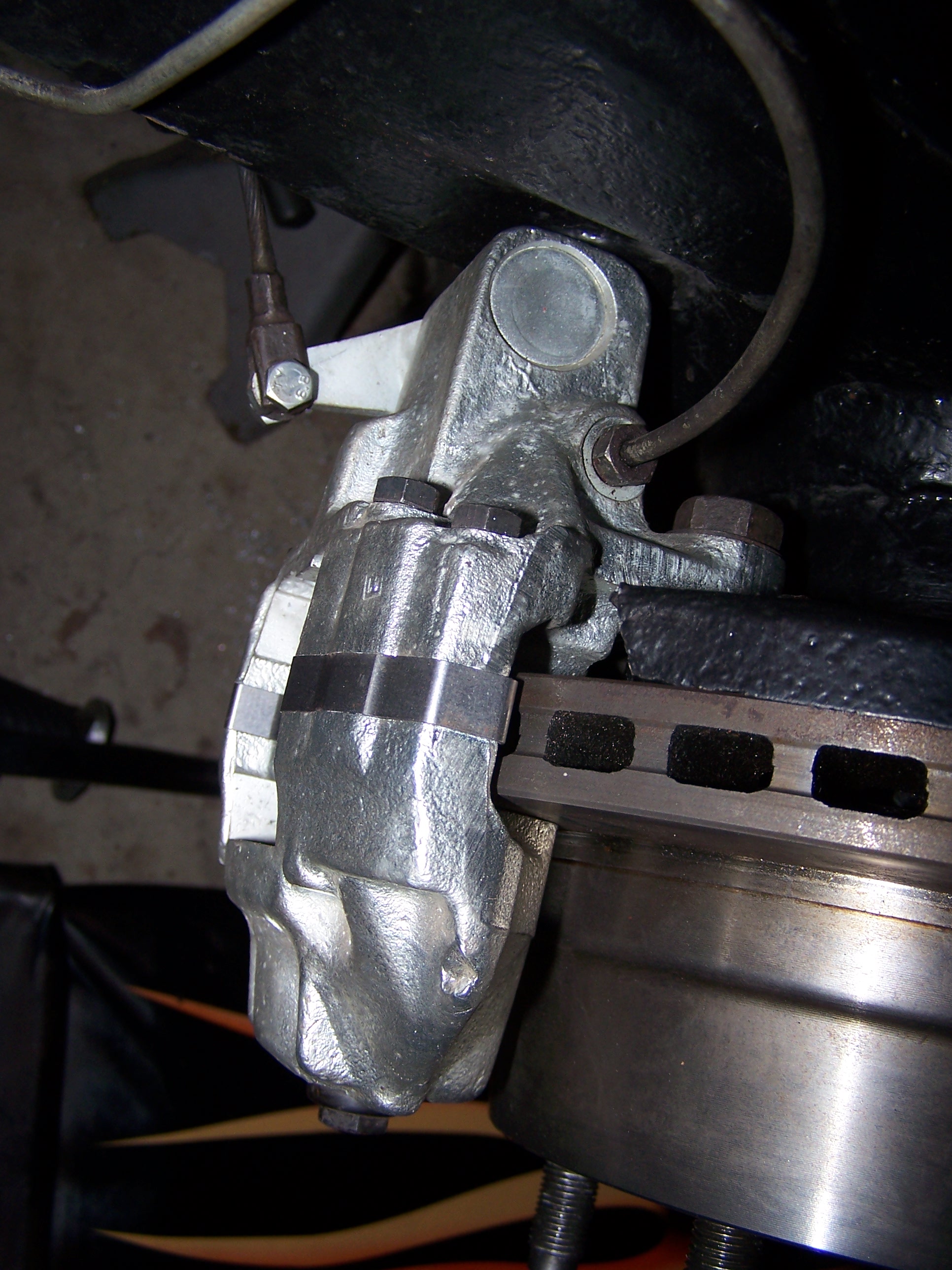

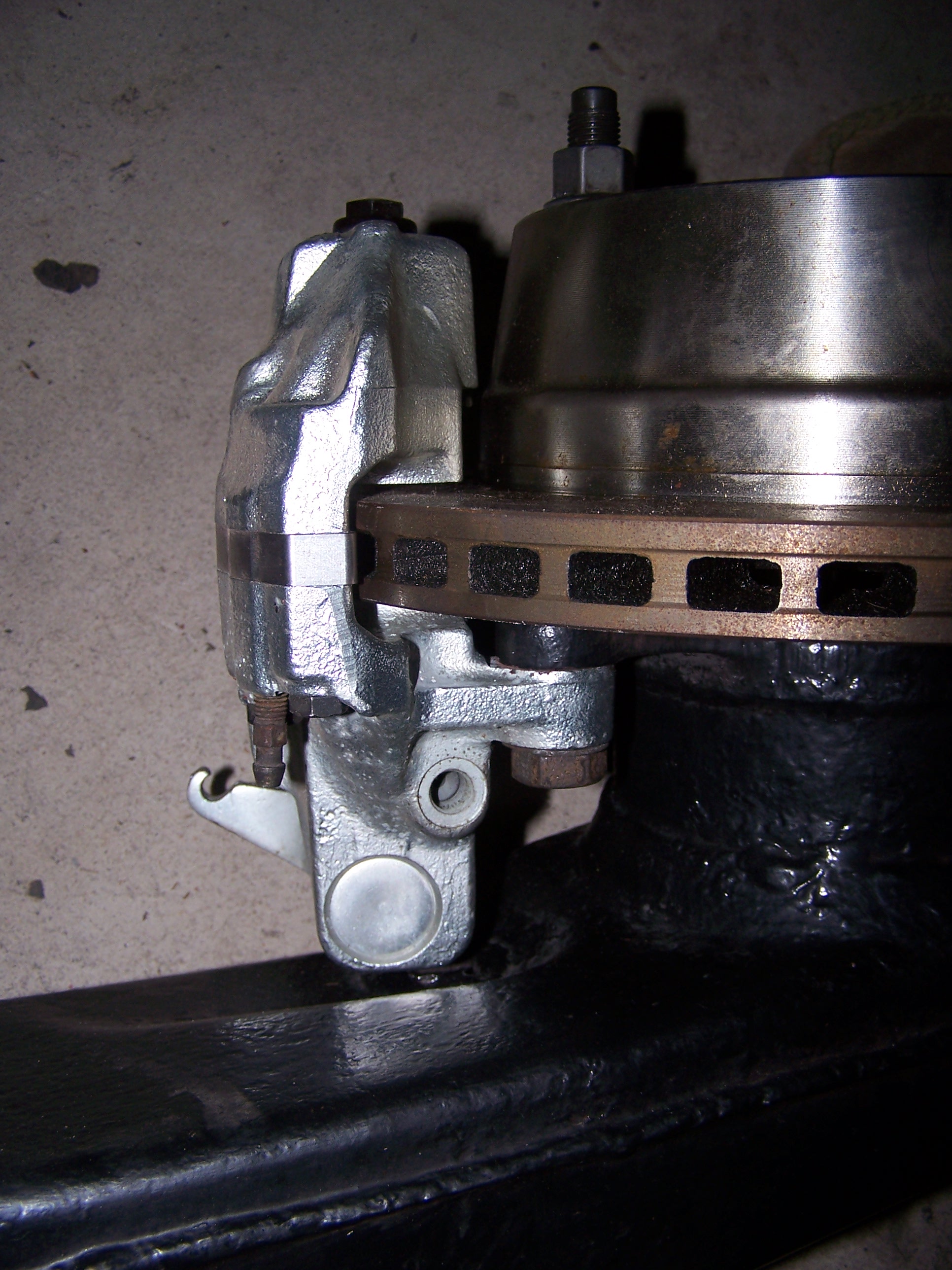

One more question:
Does the spacer assume that a rock shield will not be used?
There seems to be a fitment issue when the rock shield bracket is in place under the caliper mounting tabs.
W/O the rock shield, the caliper is perfectly centered.
With the rock shield bracket, the caliper is a bit askew towards the inside of the car.

Yes.
