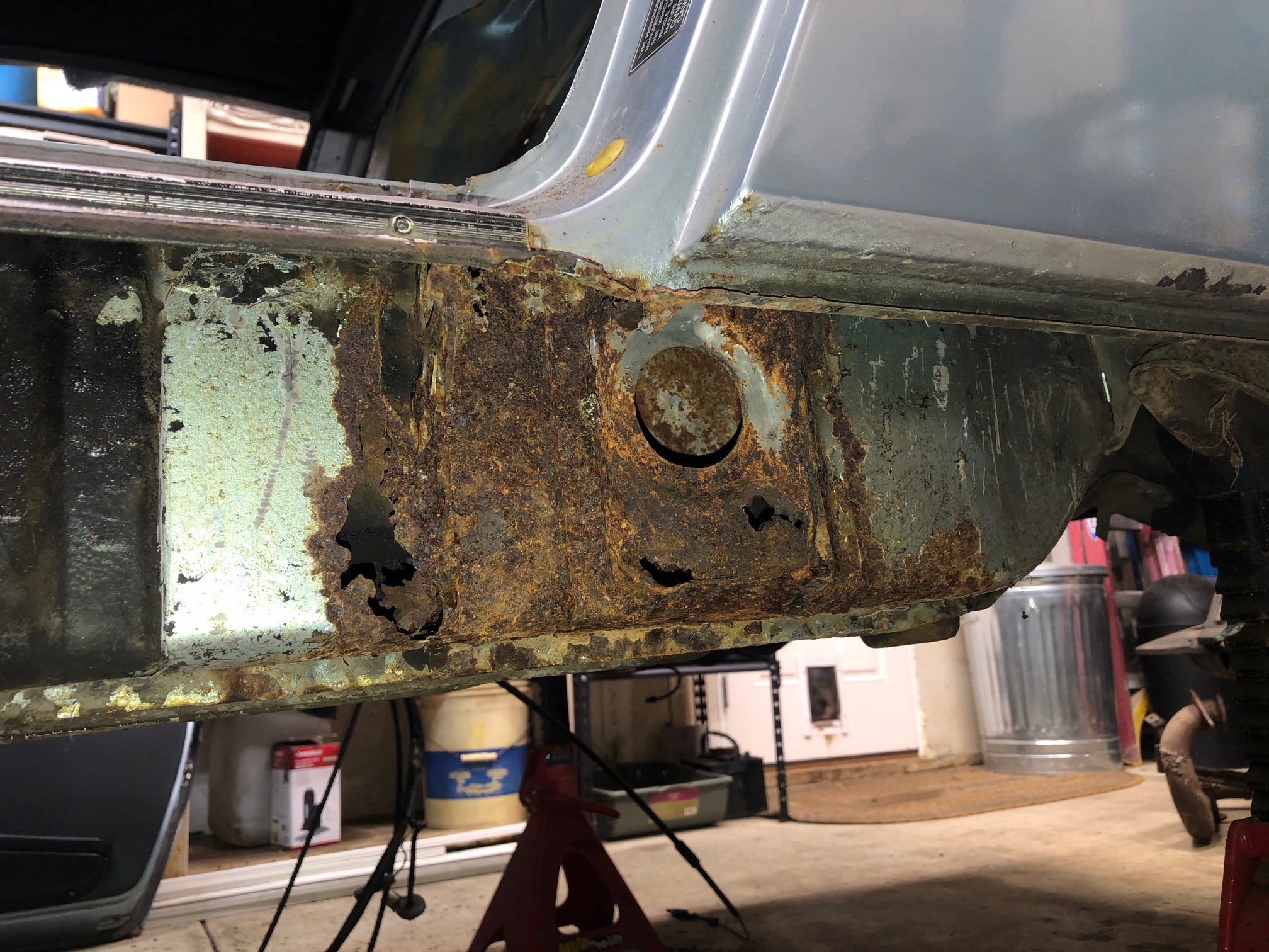

Pulled my rocker covers today to inspect for rot. Unfortunately I found significant rust on both jack points and the driver’s side long has a good size rust hole. I’m going to cut and patch the bad spots in the longs, but I’m trying to avoid a complete resto right now and I don’t want to get into exterior bodywork. The rear fenders are in pretty good shape but they seem to block access to the top flange of the jack point plate. Does anyone know if the jack points can be replaced correctly without cutting out a lower portion of the rear fender?
Lilchopshop   Replacing rusty jack points   Mar 10 2020, 04:31 PM
IronHillRestorations   You'll probably have to cut a section off the ...   Mar 10 2020, 04:44 PM
dlee6204   It is possible to replace the points without cutti...   Mar 10 2020, 05:38 PM
flyer86d   I’ve done it by cutting out the lower couple of ...   Mar 10 2020, 05:59 PM
Superhawk996   Uh, what what do you intend to weld to? Can’t w...   Mar 10 2020, 07:07 PM
bbrock   Yeah.... I'm afraid you are beyond being able ...   Mar 10 2020, 07:13 PM
cary   Yes you can. But you can only do 3 rosettes on the...   Mar 11 2020, 08:45 AM

Lilchopshop   Thanks to all for the responses and opinions (neve...   Mar 12 2020, 05:55 AM
jagalyn   Everything else looks really good... Seeing the ye...   Mar 12 2020, 06:31 AM

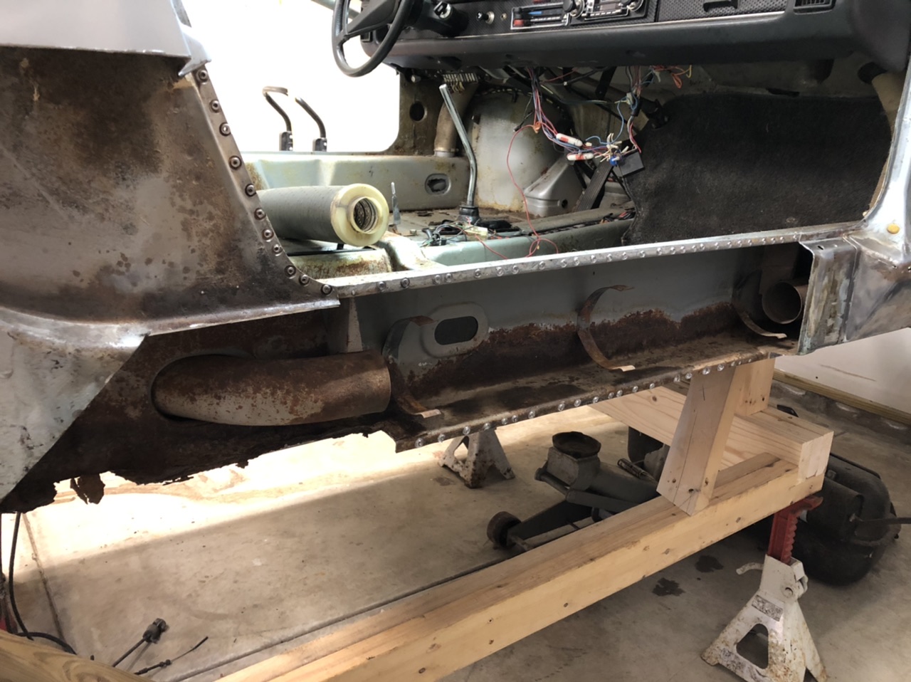

Lilchopshop   So, this happened this week... going full restora...   Mar 19 2020, 06:00 PM
Superhawk996   :sawzall: Way to dig in! :welder:   Mar 19 2020, 06:09 PM
dlee6204   :sawzall: Way to dig in! :welder: :ag...   Mar 19 2020, 07:01 PM
bbrock   Yes sir! Good job. It's clear that you m...   Mar 19 2020, 07:10 PM
bkrantz   Welcome to the resto club.   Mar 19 2020, 08:43 PM
Lilchopshop   Welcome to the resto club. Thanks! :beer2: ...   Mar 20 2020, 06:23 AM
Superhawk996   By "club" you really mean, "bunc...   Mar 20 2020, 09:09 AM
bbrock   By "club" you really mean, "bunch ...   Mar 20 2020, 09:30 AM

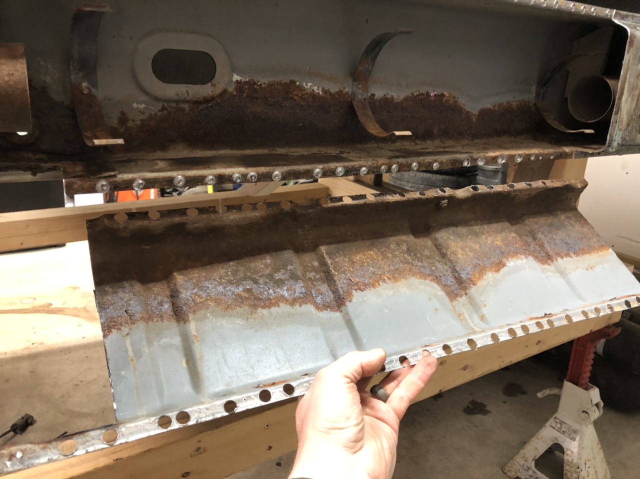

Lilchopshop   Peeled back some more of the outer long so I could...   Mar 21 2020, 04:08 PM
Lilchopshop   Scrolling through YouTube this morning and found t...   Mar 22 2020, 07:34 AM
Superhawk996   Yup, that hidden rust at the seat belt anchor coul...   Mar 22 2020, 07:46 AM

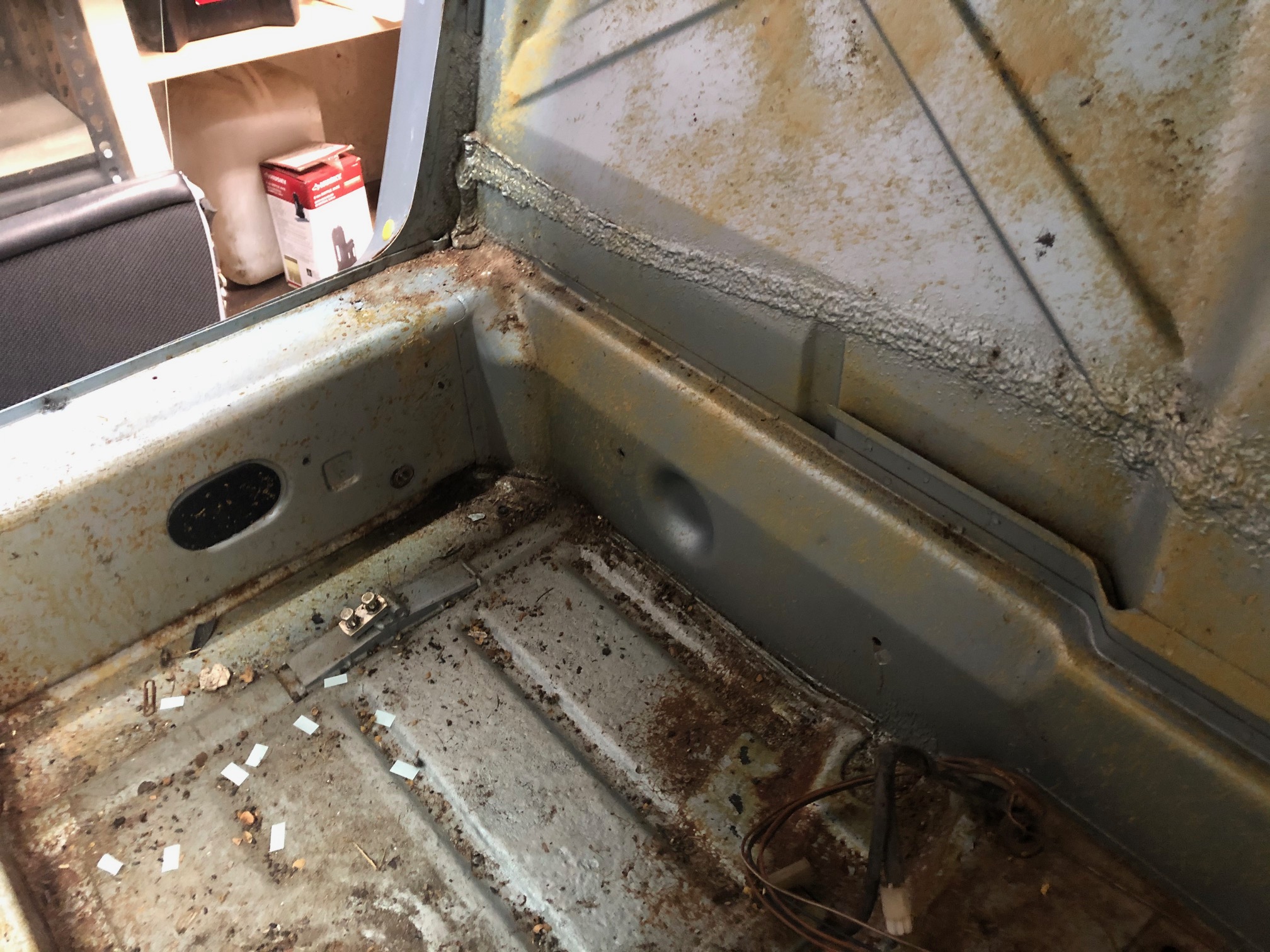

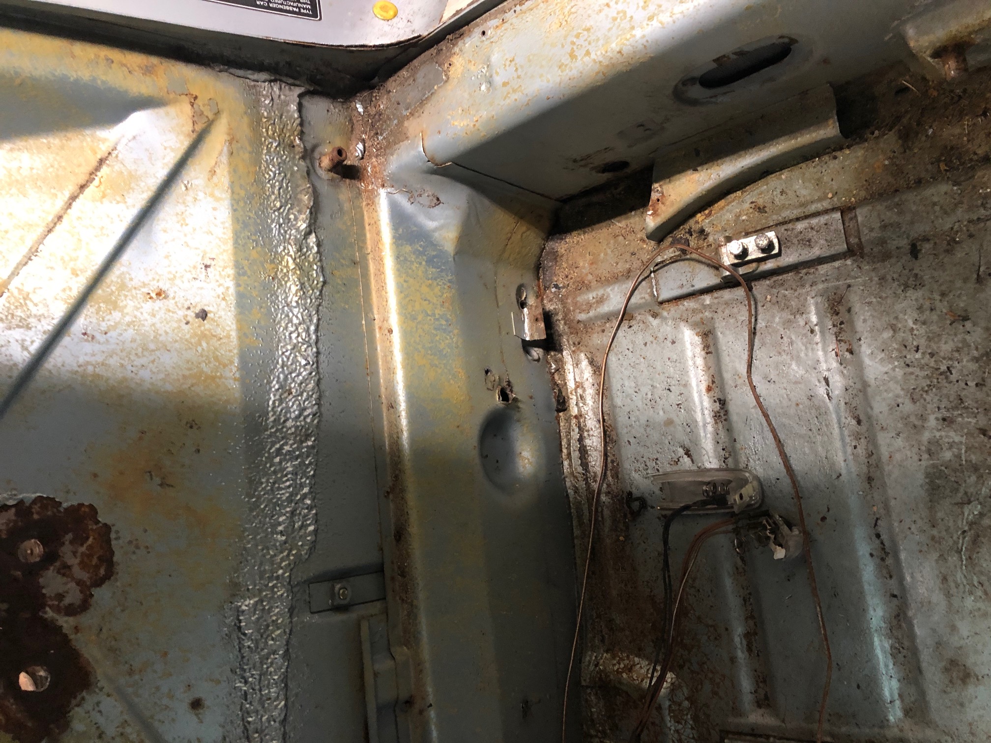

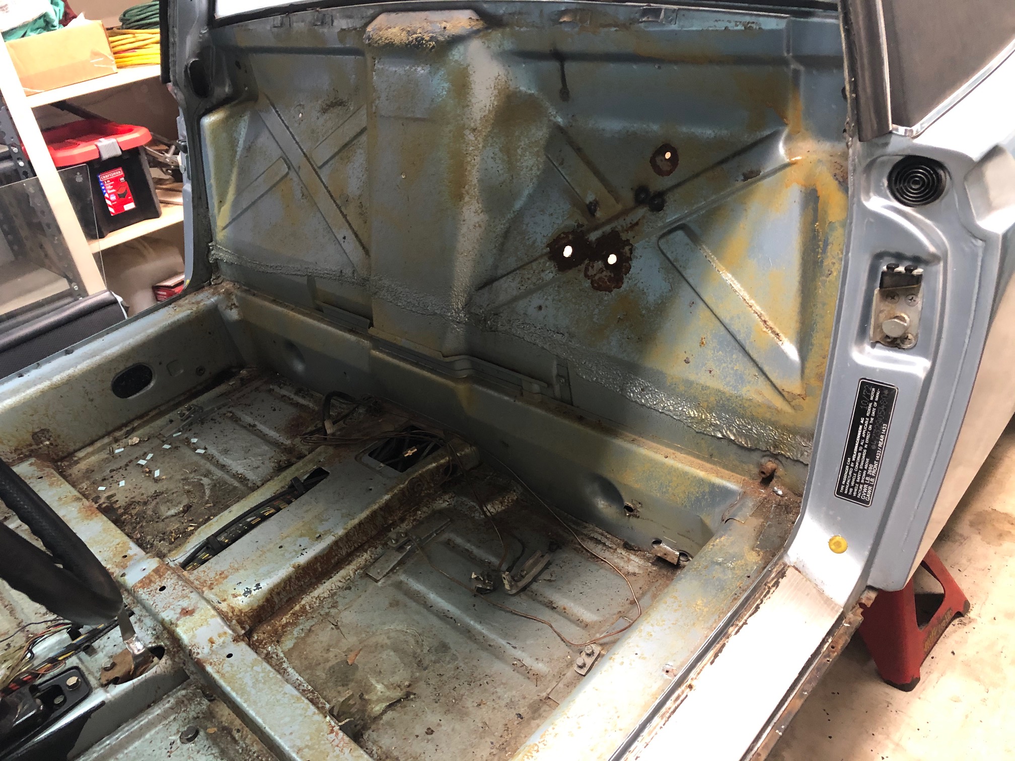

Lilchopshop   I’ve been chipping away at this project over the...   Apr 28 2020, 08:35 AM
euro911   I’ve been chipping away at this project over the...   Jan 7 2021, 07:23 PM
Lilchopshop   Finally got the passenger side long closed up and ...   May 16 2020, 10:21 AM
