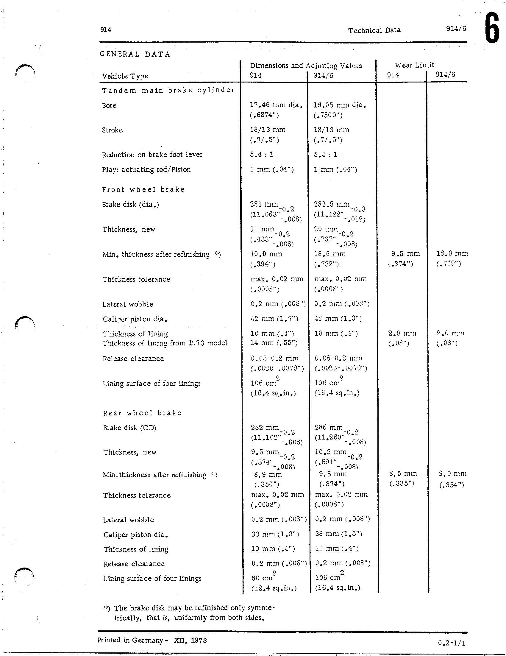

I mic'd a new (from PP/not OEM) rear rotor last nite and found they are a tad bit shy of the OEM. Haynes lists the OEM at .374" which I verified off the old rotor's outer rim. You know the part that never gets turned unless you specify that you want it turned, also. (IMG:style_emoticons/default/shades.gif) However, the new one mic'd .365". Hmmmm. Does anyone remember the min amount that you can take off an undamaged rotor?
76-914 Rotor Thickness Apr 6 2013, 08:51 AM
kg6dxn This is from the factory service manual...
