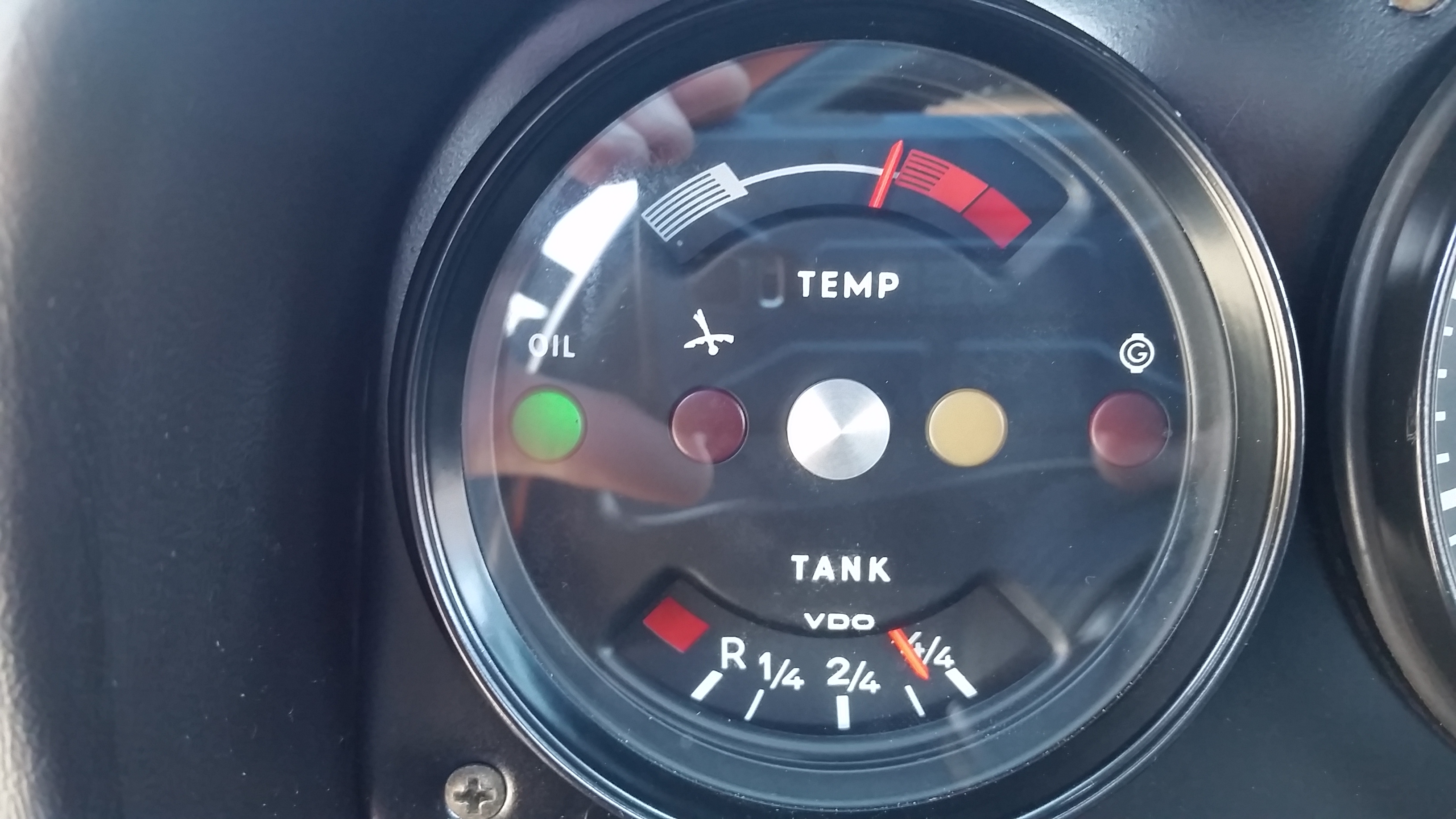

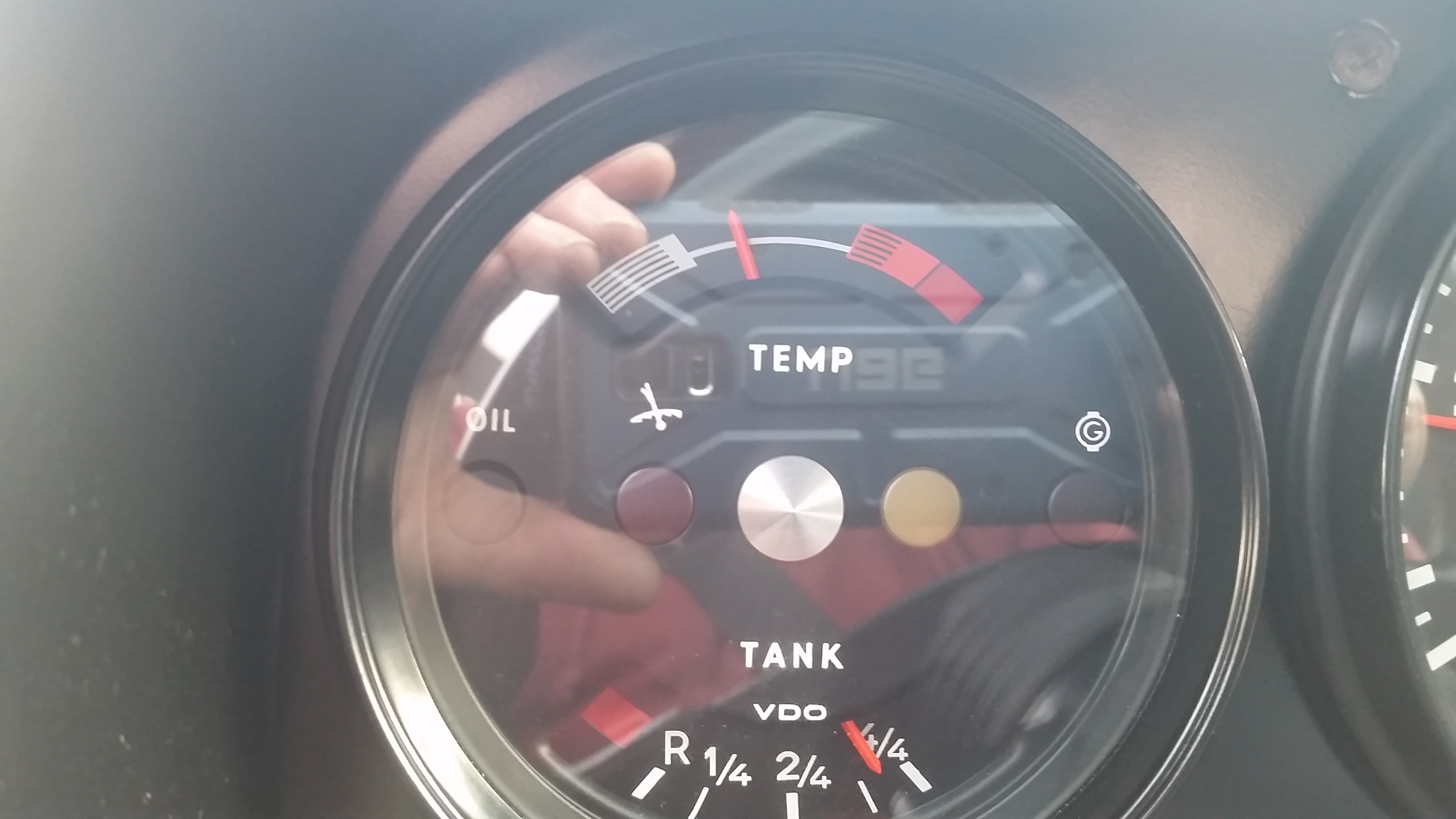

Here are the results...before and after. The first pic was taken on a 60 degree day a few weeks ago. The second pic was taken March 21 on a 58 degree day. The gas level is reading the same only by coincidence.

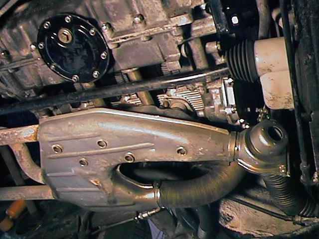

A picture (not my car) of a heat-exchanger with the proper connections. You can see the hose come down into the HE from the fan shroud. The air goes through the HE and exits at the diverter valve. With the engine running and the heat OFF you can feel engine fan air coming out of the doughnut-shaped opening....thereby removing LOTS of heat from the HEs.

(IMG:http://www.914world.com/bbs2/uploads_offsite/www.acousticgeometry.com-1110-1490141775.1.png)

When I pointed my IR thermometer at the backside of the oil cooler near the bottom I got readings near 300 degrees (after driving it) before I put the ducts to the heat exchangers on the car. After I installed the ducts (and driving again) that same area of the oil cooler read 235 degrees!!!!!!! The oil cooler is only a few inches above the exchanger. Imagine how much heat must have been radiating upwards onto the bottom of the cylinders..:-0
