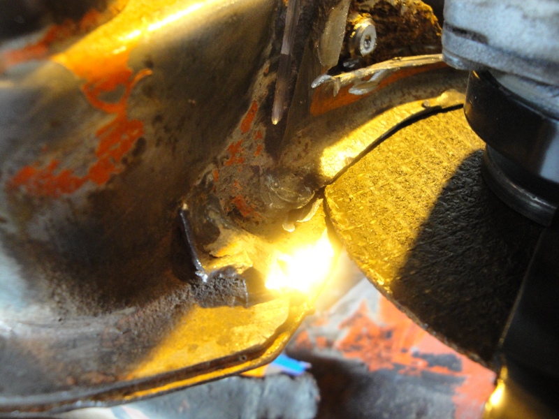

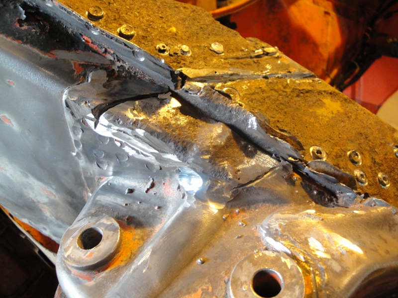

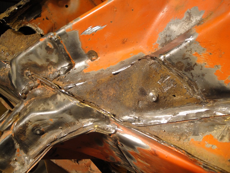

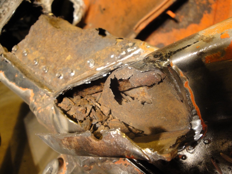

Started by going after the reinforcement pieces.
Followed the most common procedure. Cutting the reinforcement in half, right on the seam.

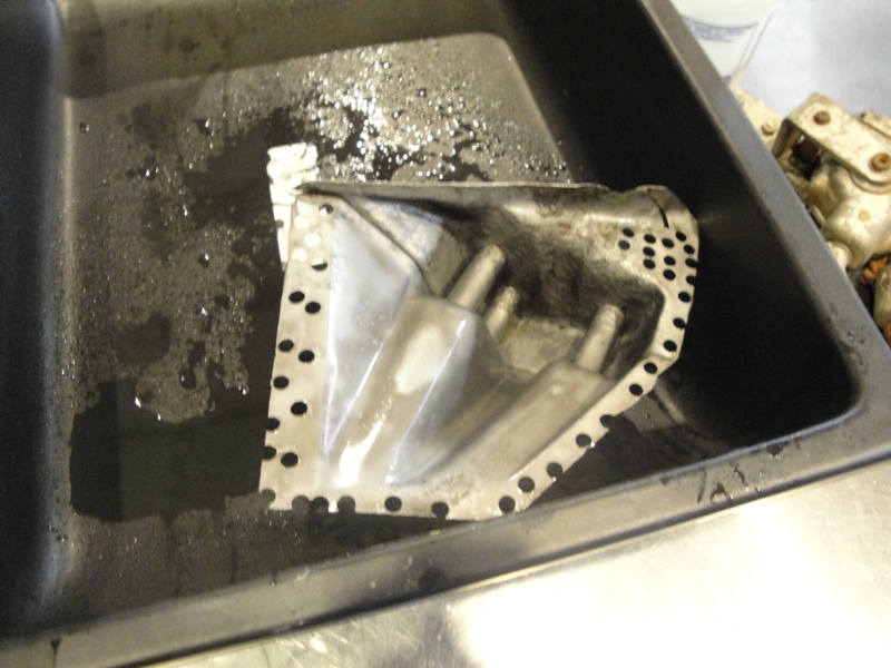

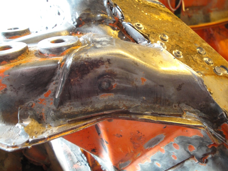

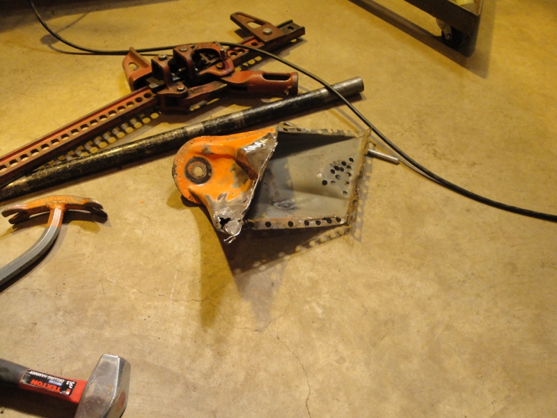

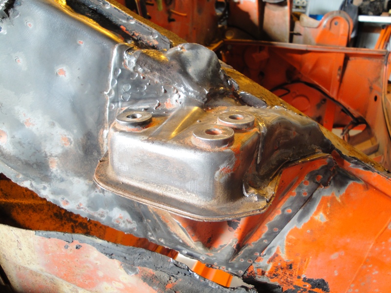

I now know why no one documents the suspension console removal.
Its kind of like doing a Civil War battlefield surgery.
Who wants to take pictures of that?
The console has been removed. Had a tough time finding the last few spot welds.

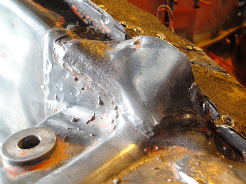

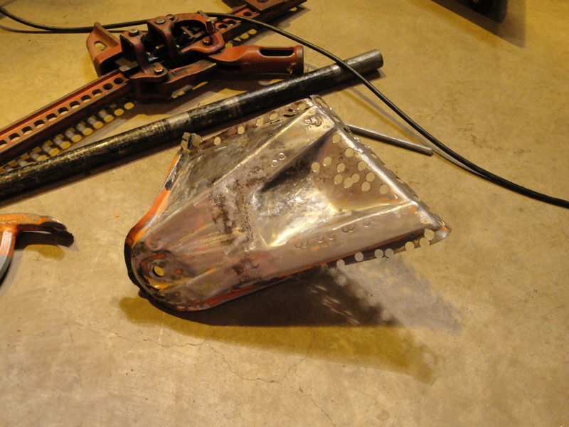

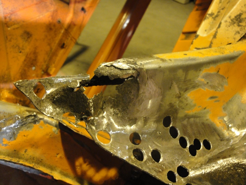

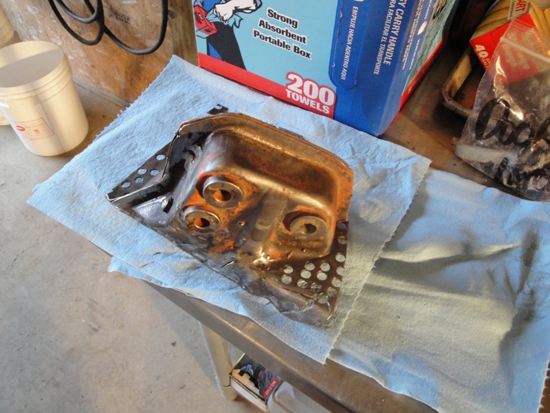

Not in too bad of shape.

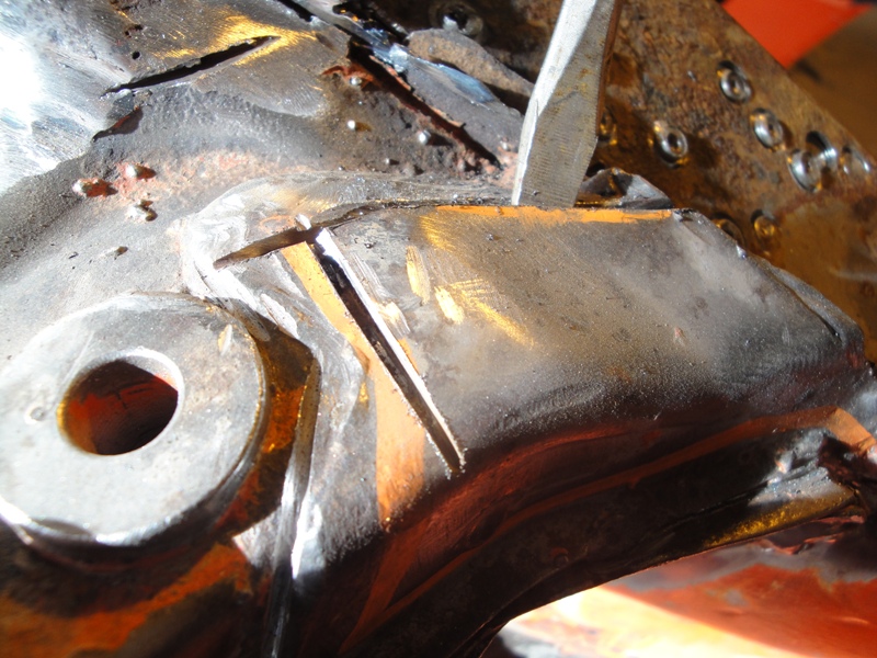

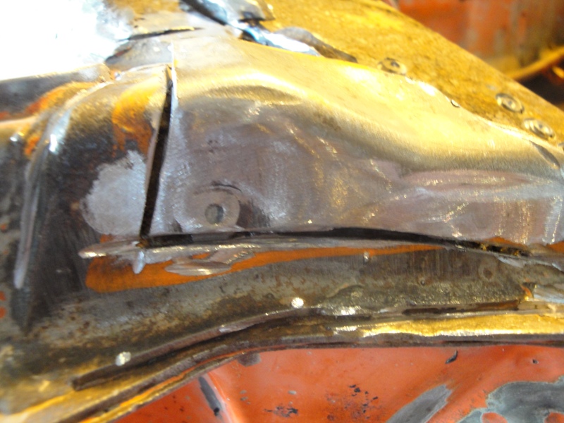

I was surprised how nice it looked under the console.
After looking at the wheelhouse. Surprised how bad that corner had rusted.
But I suppose that was the closest corner to the battery vapor run off.

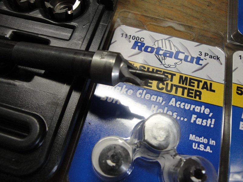

Off to more spot weld drilling.
Taking off the outer console today.
Hopefully my little tool store will have some 1/4, 5/16 and 3/8 replacements for my RotaCut spot weld cutter. If they don't, he'll order them for me.
They broke because I got pissed that my HF cutter wasn't cutting deep enough. So I tried to recut with the better cutter. Caught an edge and it snapped off. (IMG:style_emoticons/default/sad.gif)
It looks to be a copy of the Blair. He has Blair replacements for the standard (NAPA,HF) cutter on the shelf. So he can probably get both.

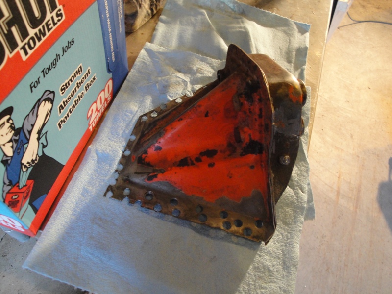

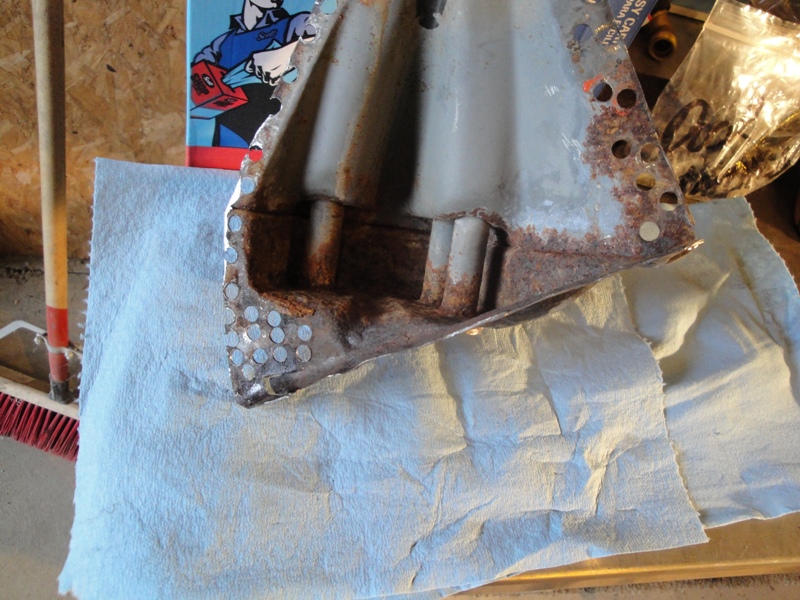

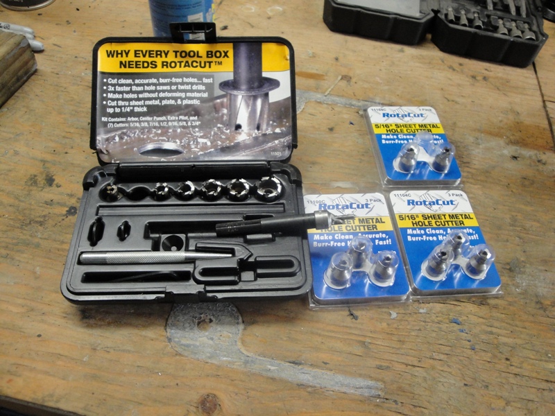

After the stop at the tool store.
Last picture shows the broken 3/8 cutter.
The shop was out of 3/8, but I did get the 1/4 and 5/16's.
Spent $20 on each package of refills.
If I remember correct. I think the original kit was about $80.

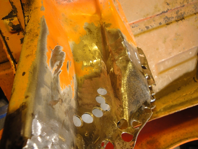

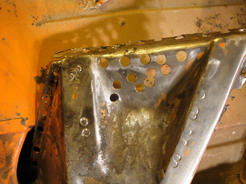

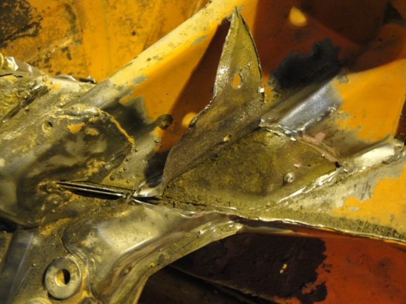

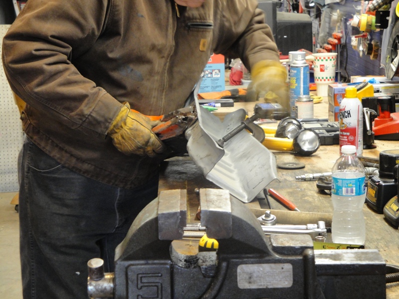

First reinforcement is removed ...........
What I found was, it seems its best to cut out the material. Then come back and cut and grind off the weld. The trick being not cut into the piece underneath. Missed a couple spots. But I'm getting the hang of it. Be patient.

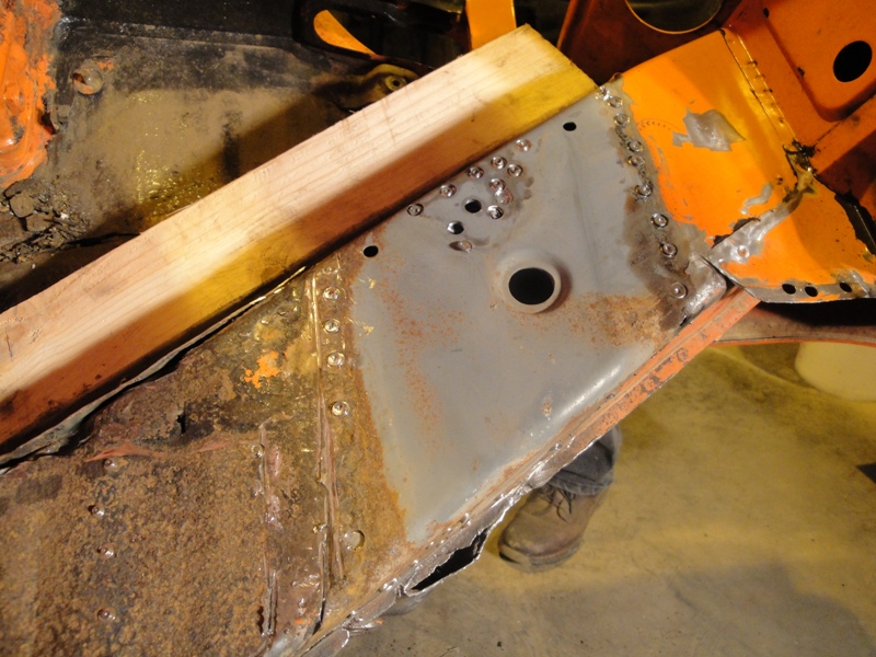

While I'm taking off the outer console.
Super In Law is working on the fit of the inner console to the new inner wheelhouse.

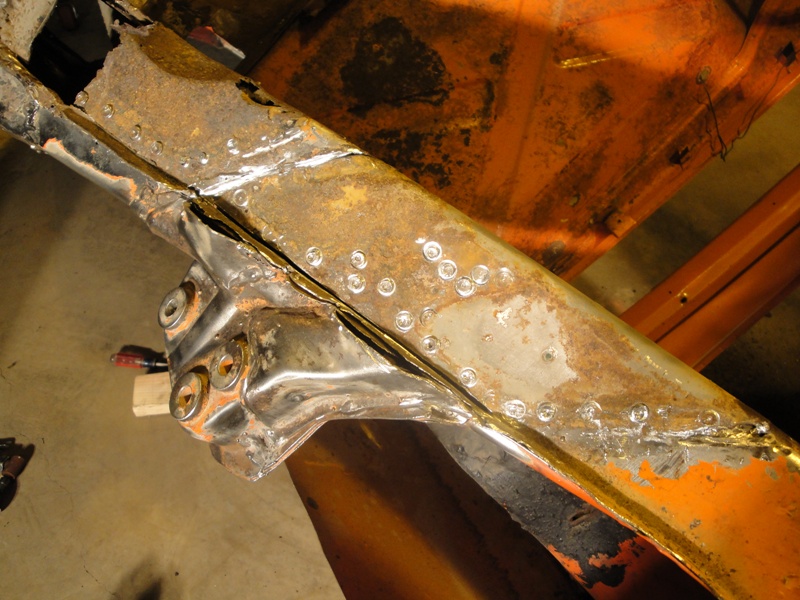

Well after about 3 hours of work the outer console is off.
I'm a little more optimistic after I found these two consoles in pretty good shape.
I left the outer console sprayed down with Ospho.
I'm real happy with the Rotacut spot weld cutter. I followed Perry's input. I dipped the cutter into a cup of cutting oil. Cut the hole about 1/2 way. Blew out the hole and the cutting tip. Then finished cutting the hole. It cut like it was a milling machine.
Real impressive. It was a good day ................

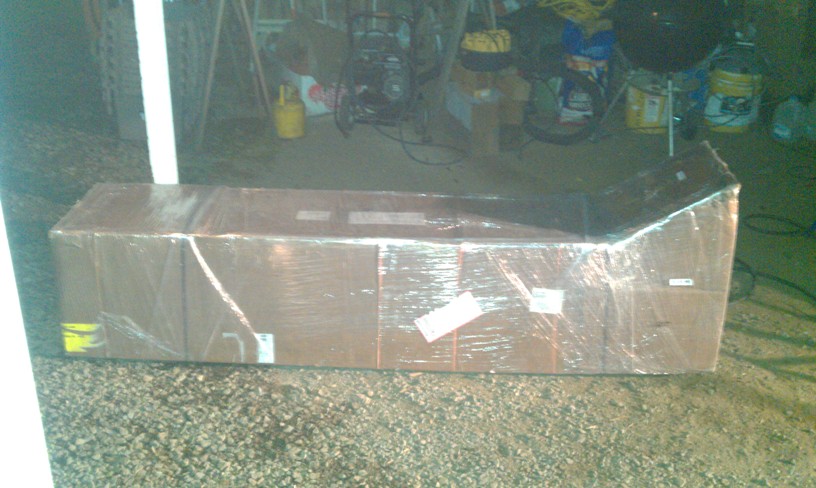

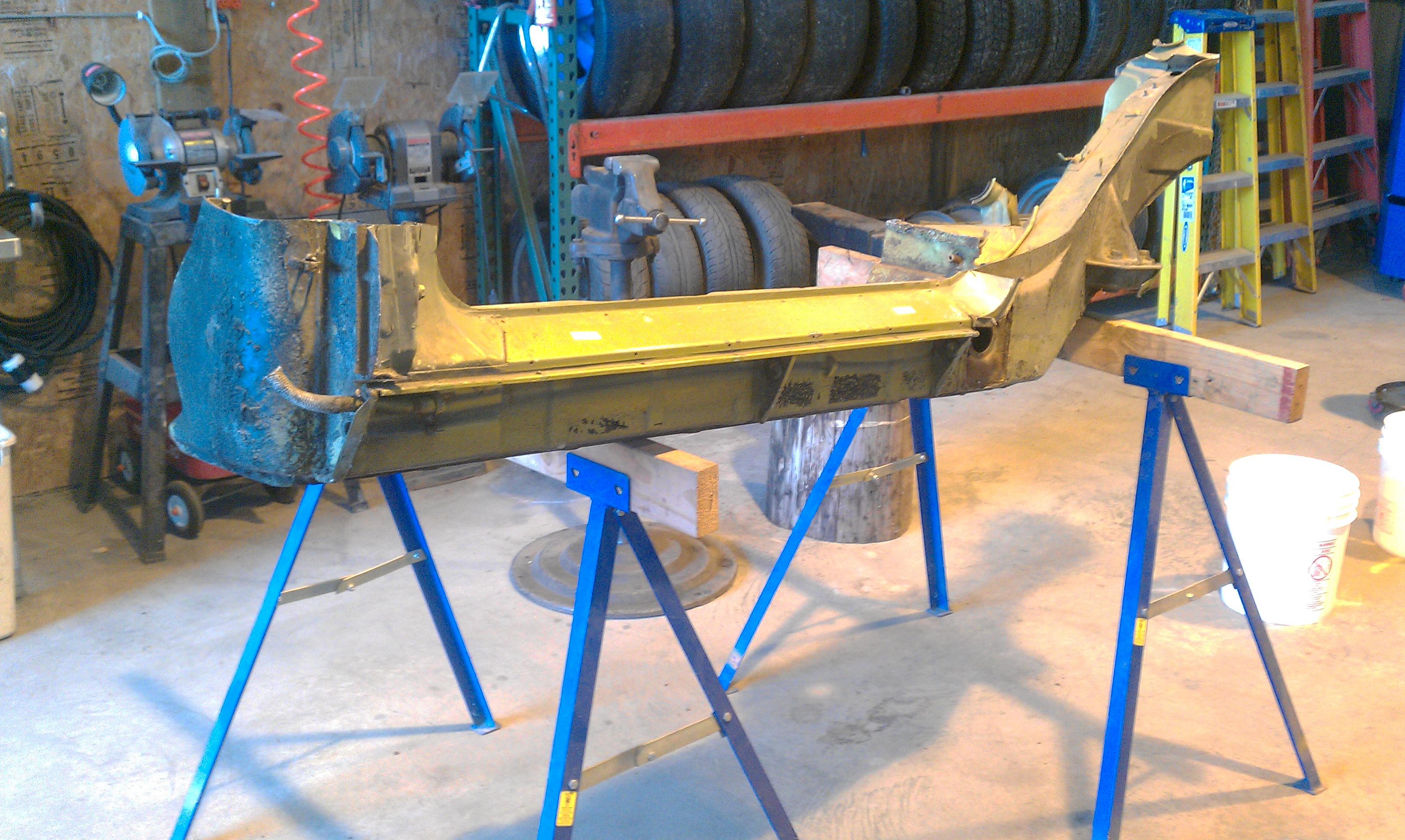

Perry's drivers side long has arrived.
jersey914
post Jan 5 2013, 08:56 PM
Post #119
Posts: 161
Joined: 6-September 12
From: Marlton, NJ
Member No.: 14,895
(IMG:style_emoticons/default/drunk.gif)
cary
post Jan 6 2013, 07:28 PM
Post #120
Posts: 3,900
Joined: 26-January 04
From: Sherwood Oregon
Member No.: 1,608
Here it is .................
Perry did a great job of packaging. It arrived safe and sound.
