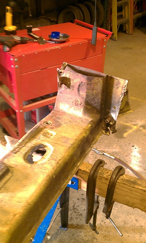

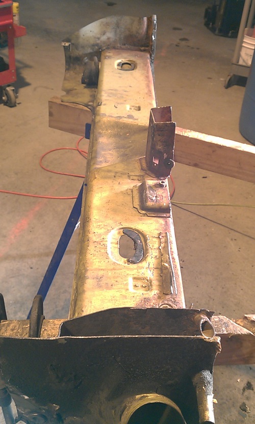

So back to dissecting the long.
Next will be to remove the engine shelf. I want to remove it totally intact so it could be used in the future.
Camera doesn't like the halogen lamps......
Taking off the backend with the end piece attached. No way to remove it without damaging the shelf.
Got it out in one piece. (IMG:style_emoticons/default/biggrin.gif) (IMG:style_emoticons/default/biggrin.gif)

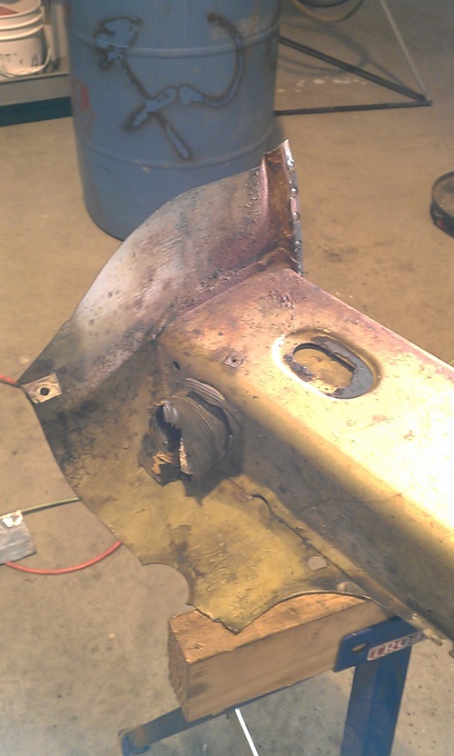

Here's the wheelhouse cut off with the plasma cutter.

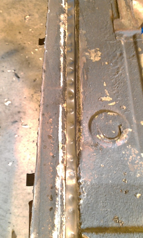

Next will be to remove the floorpan portion left on the cut out long.
Drilled the pilot hole completely thru. That way I wouldn't miss the location on the inside of the seam. Worked great.
That went real smooth .................easy deal. Still using the second 3/8" Rotacut spot weld cutter. (IMG:style_emoticons/default/cheer.gif) (IMG:style_emoticons/default/cheer.gif)

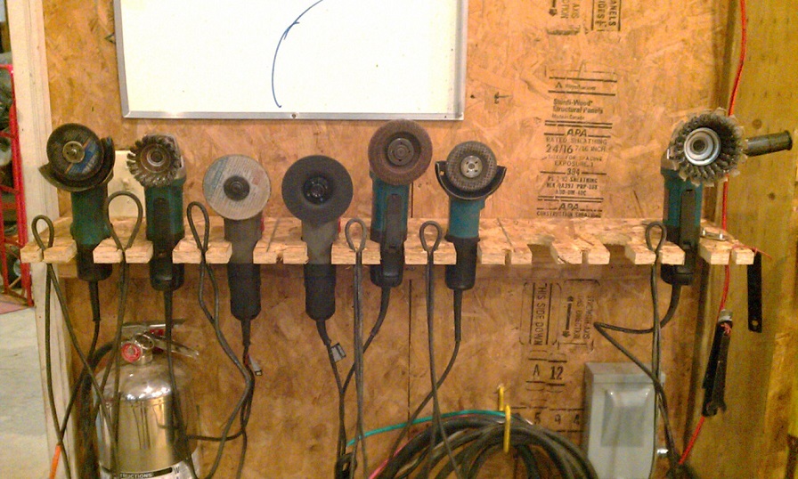

New weapon rack .................

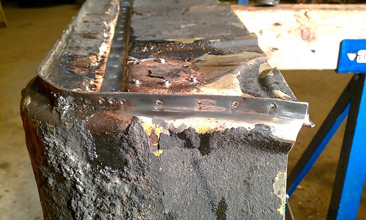

Now that I have it trimmed out.
Looks like I'll need a little patch under where the jack point was located.
Plus there's a small one inch crack right by the e-brake indentation.
All in all, she looks pretty good. But won't totally know until I can get it sand blasted.
Hopefully that will be next week.
IronHillRestorations
post Jan 29 2013, 08:35 AM
Post #145
I. I. R. C.
Posts: 6,947
Joined: 18-March 03
From: West TN
Member No.: 439
I've seen several cars with the crack at the parking brake indent. I'm guessing that would be a good place to reinforce ala inner long stiffening kit. Good to hear you are happy with the long. Isn't that Blair tool the shizzle?
